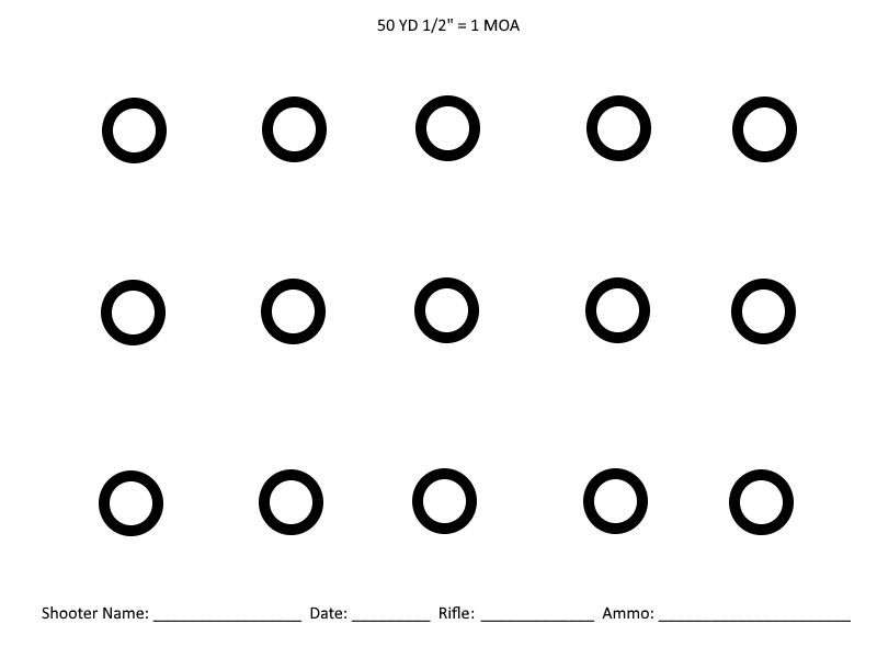

Here's a target I use - print on standard printer paper
1/2" @ 50 Yds = 1 MOA dots
