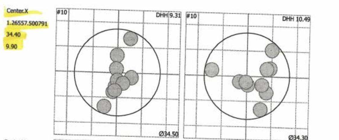

RimX vertical stringing from Lapua test center lot testing
Masojoh
Jun 29, 2020
247
259
I have a new to me RimX with a proof prefit straight contour barrel that is making its way back to me from the Lapua West test center. This is my fourth rifle that had been tested there, and is only slightly better than the Kidd Super Grade - but worse than both my Vudoo and B14R.

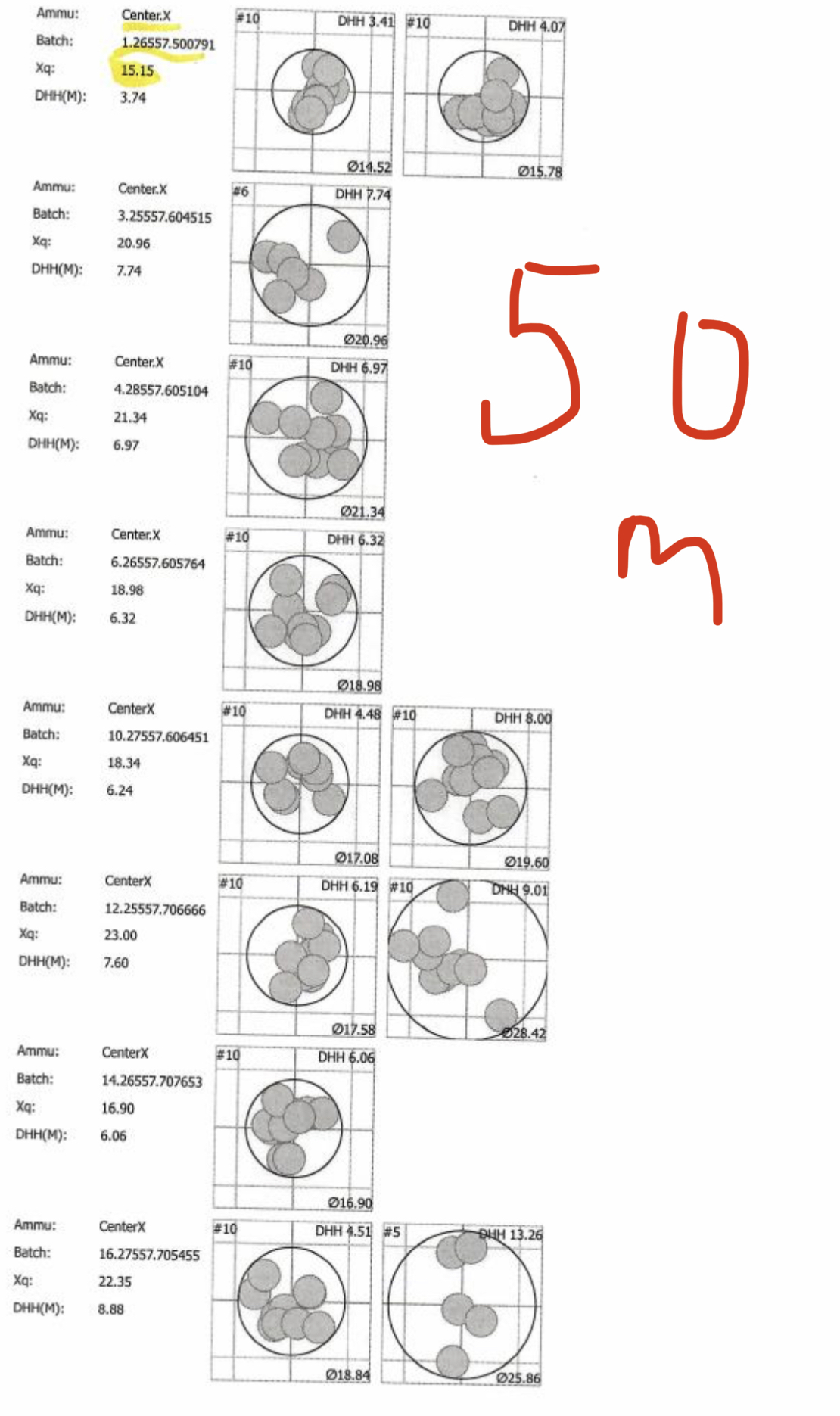

The lot that I chose has significant vertical stringing that is apparent in the group images. The overall group size was a hair larger than the “best” lot at 100m (33.2 vs 34.4mm, edge to edge), however as you can see below, the rounds had much great vertical dispersion than horizontal, especially for the left group below.
Question for the RimX owners - any ideas how I could address that vertical stringing? I have the tune up kit already from Zermatt that I will install as soon as I get the gun back. I have read that inconsistent firing pin strikes could cause stringing - assuming it’s not an ammo velocity issue. I also am toying with putting my tuner on, and seeing what I can see there. The tuner rode on my vudoo for a very limited time, but I gave up on it after finding my 50 yard results suffered when tuned for 200 yards.
Two other nuggets about the test center - despite shipping my rifle in the chassis, and asking it to be tested in the chassis multiple times, it was taken out of the chassis and tested in the fixture. This was quite a let down as the shipping cost was remarkably higher due to the heavier and longer package. Also, the operator said that my RimX results were consistent with what he has seen, and that the Vudoos still produce consistently the tightest groups, most in the sub 1” range. My gen 2 V22 was 5/8”.
I'm curious if this is because of the Proof barrel and chamber, or the action. I don't see how the action would cause such an inconsistency to cause this. I'm taking my Rim-X build to the range this weekend, granted it's just to get the first few hundred rounds through the barrel. I'll report back with whatever accuracy findings I have though.
Reactions: mccannicalbob

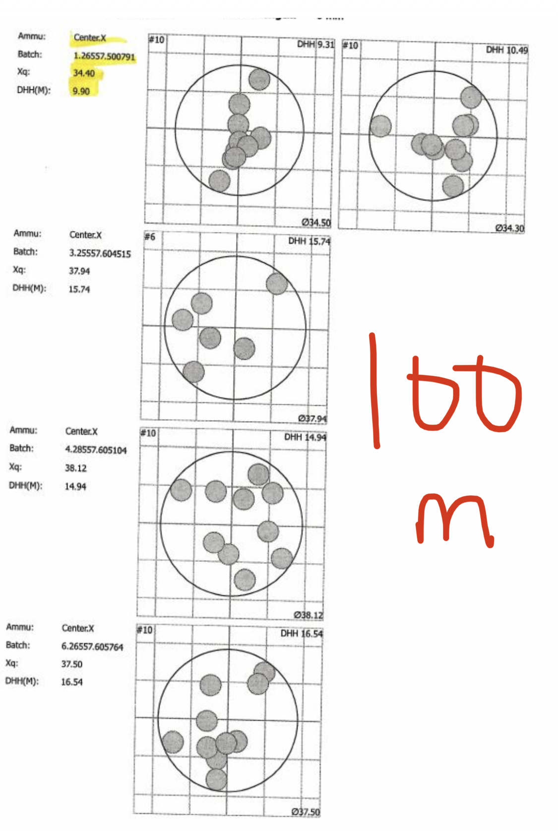

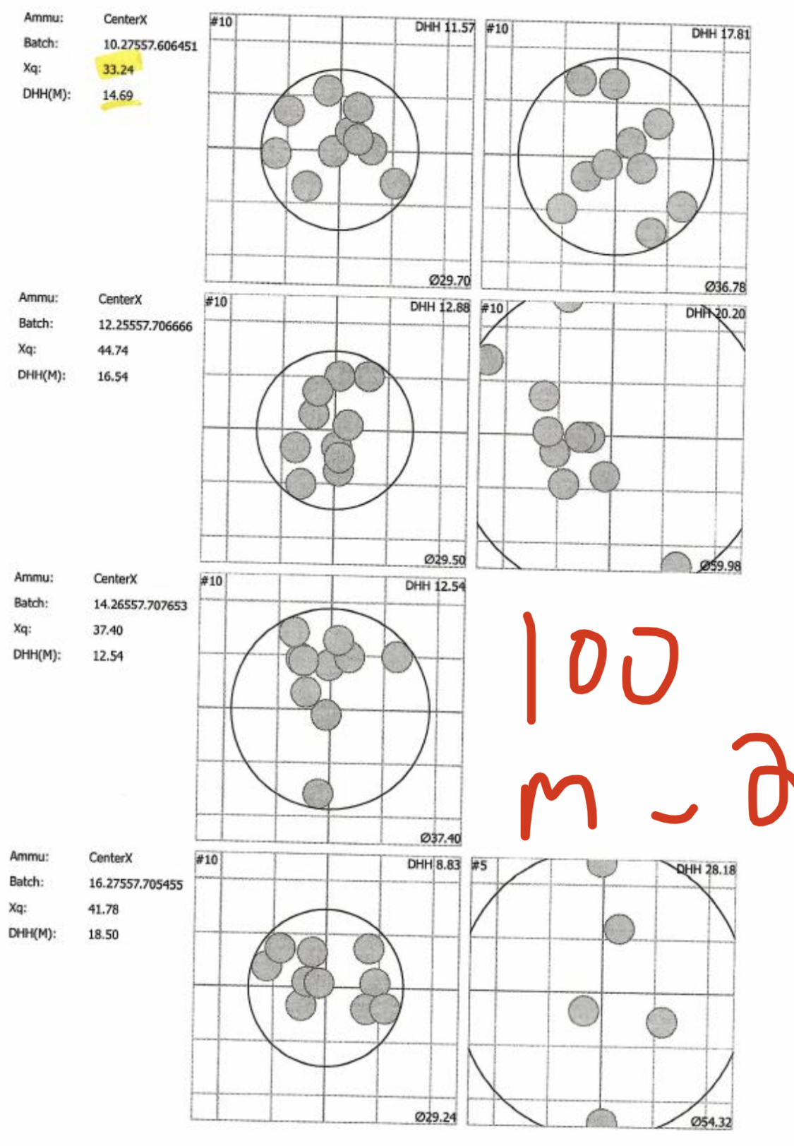

For completeness, here is the larger report of the group testing results.
I chose the lot ending in 791 for two reasons - the 50m groups were the tightest, and the distance between hits was the lowest. The lot ending in 451 had the smallest 100m group, but there was greater horizontal dispersion and my thought was that I would have a better chance figuring out the vertical.

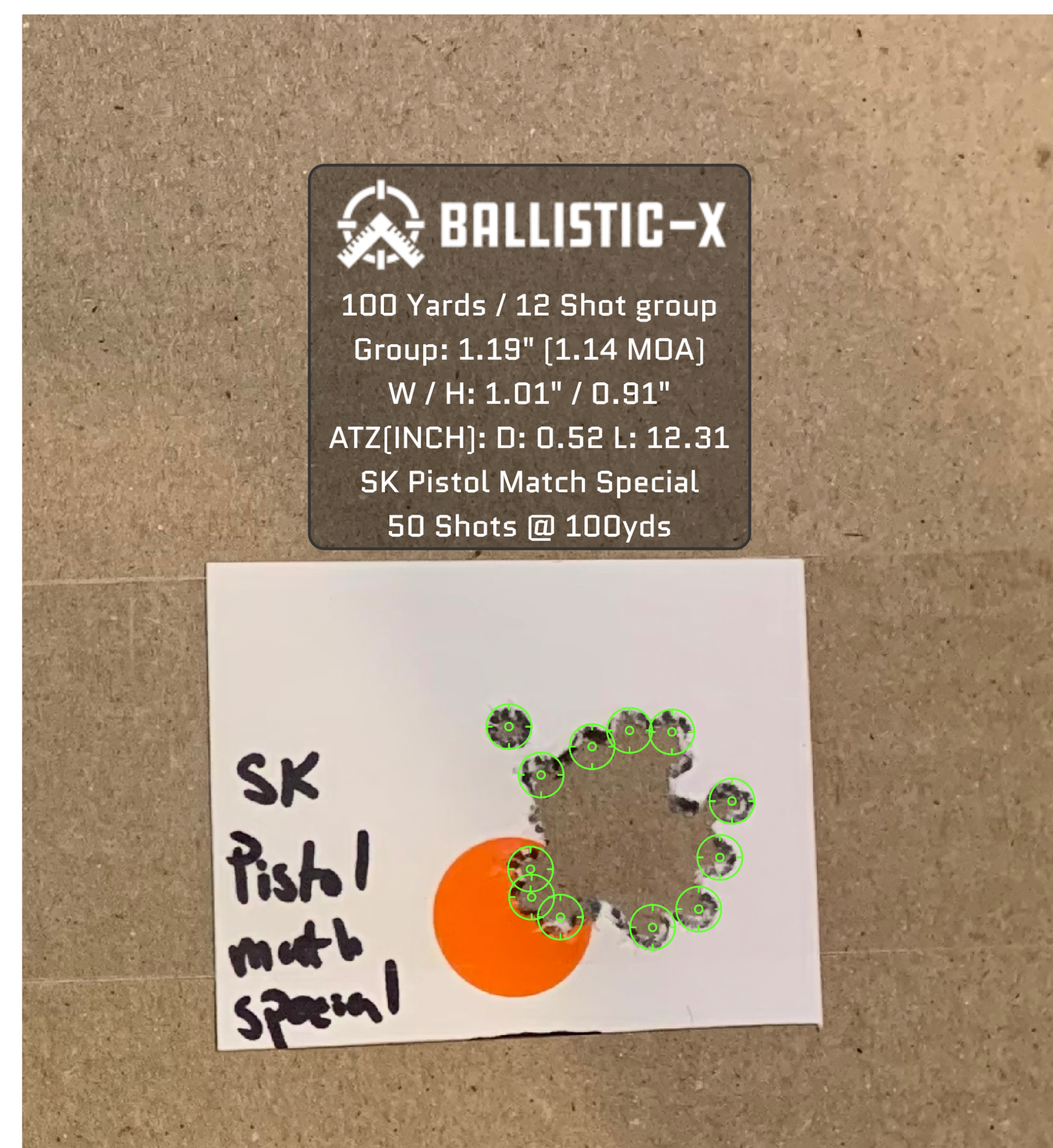

For what it's worth, I put 150 rounds through my rifle yesterday using Aguila Pistol Match (I have quite a bit of this and wanted to use a waxed bullet) to start the break in period to "season" the barrel. I didn't have any vertical or horizontal strings at all, they were grouping quite well, actually, but I did have a different problem. I was getting very random flyers. I wasn't trying to shoot for groups in particular, so I was shooting 10 rounds per target, and even mid-magazine would get a random flyer that would hit off POI if random direction. Now the ammo I was using was older, so I'm not going to read too much into this, but I plan to bring some of the Wolf Match and Lapua Center X this coming weekend to the range to see if that will change. The build consists of Rim-X action, Bartlein barrel chambered by Bison Tactical, cut to 22", Jewell trigger, MDT Elite Chassis.
After reading the other posts, I'm curious how much the trigger/sear engagement has to do with any of the .22lr rifle builds. TIL!

This is at 100?
The test center manager mentioned when I was asking how typical my results where, especially considering I have had 3 other rifles tested and know what is possible -
Unfortunately, in my experience, this is actually on par for the RimX action. I have seen very few RimX that will shoot “outstanding”, or keep up to the Vudoo expectation of 1-MOA or less at 100M.
Jerry
Flyers are to be expected shooting Aguila Pistol Match! You can't determine a guns accuracy level shooting crap ammo. Go with the centerX.

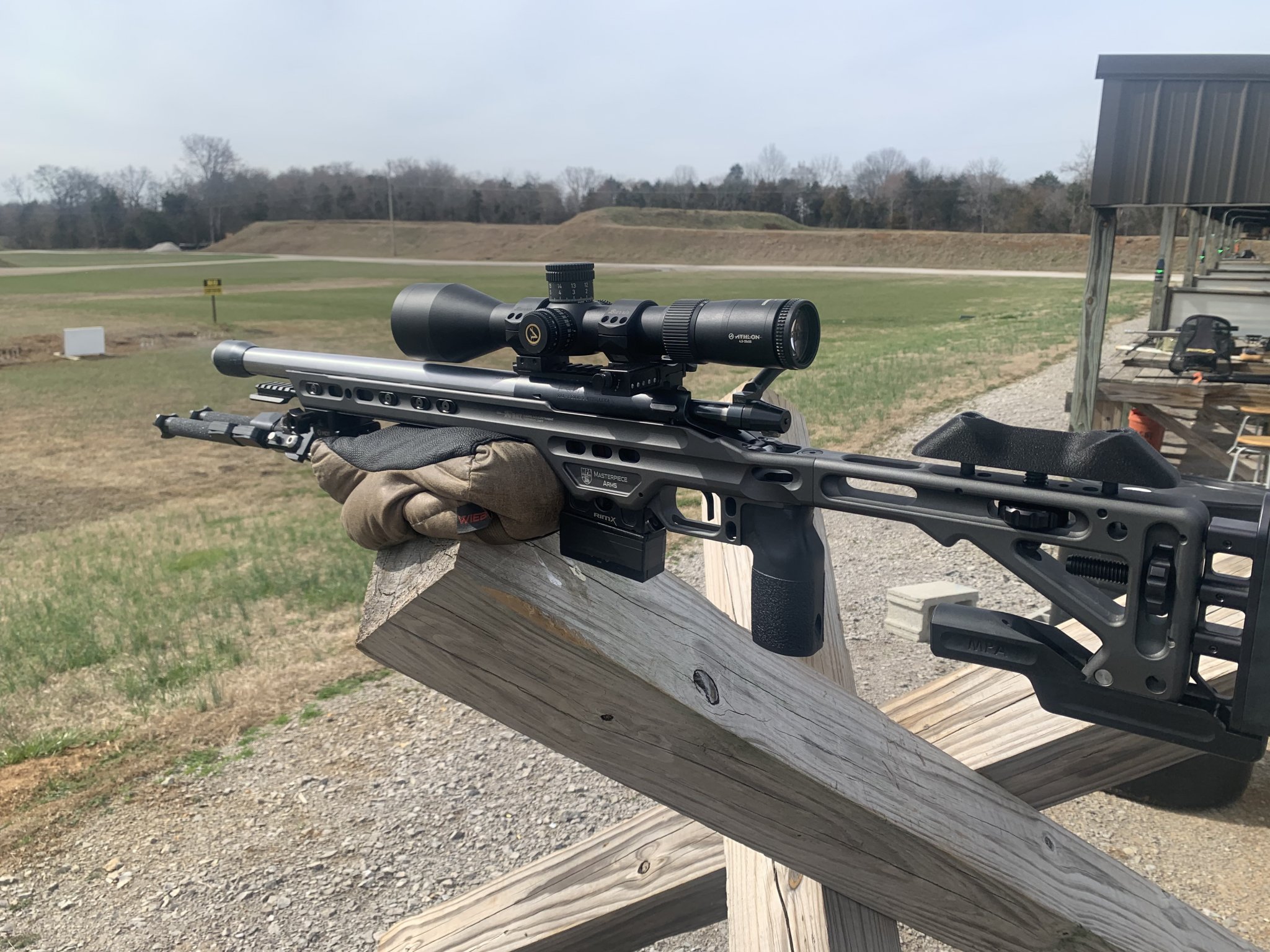

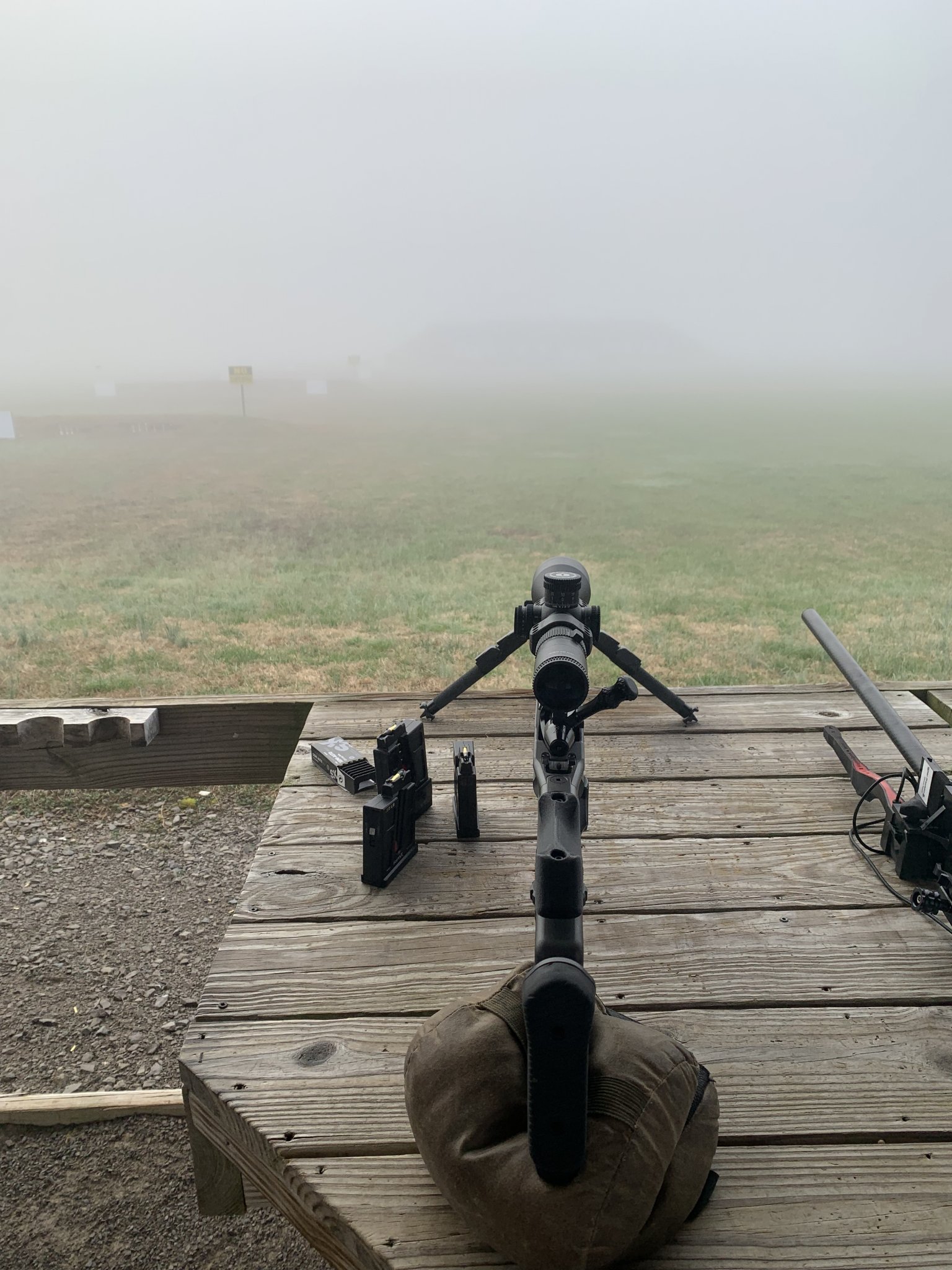

I made it to the range today, and took several different ammo types. I thoroughly cleaned the gun, which I will speak more to in a minute.
Norma tac-22 was what I used to zero. Groups were not nearly as impressive as when my vudoo shoots that stuff. No big deal, and no surprise. Switched over to sk semi auto for the Lapua/sk lube fouling. That ammo is crap (3” plus groups at 100), but it helps hasten the bore preparation. Moved on to the lot tested center X and saw what was shown in the test center results. It was gusting 10-14mph coming in from 10:30, so I didn’t sweat the horizontal - but the vertical was still there. I measured SDs of 10-11 on two boxes. Not impressed, but made note to return on a calmer day to play with my tuner and that ammo.
And then I tried two boxes of center X that came from my Kidd Super Grade lot, and holy smokes - we found a winner. Those were the groups I was expecting out of the new lot, but it clearly showed the gun capable of easy sub MOA groups. I shot out to 300 yards, and couldn’t have been happier. SD was 8-9 for that lot.
I switched over to some eley that I have, and was quite pleased with the Practice 100 rounds. Those are discontinued from what I can tell, but I do have 1.5 bricks. SD on the rounds was 5, and the groups were very impressive.
I got home to find my replacement bore scope (warranty) in the mail box. After I cleaned the rifle, I ran the scope down the tube to find the remnants of a carbon ring that was still there. Spent a few more minutes cleaning the chamber, and it is clean now.
I’m going to chalk the stringing up to the ammo. I have hope that the tuner will pull some of the vertical back in. I did shoot a box of the new CX lot through my Vudoo, and was not impressed there. My daughter and I plan to shoot on Friday, and I may have her shoot a box through her B14R to see if her gun likes it.

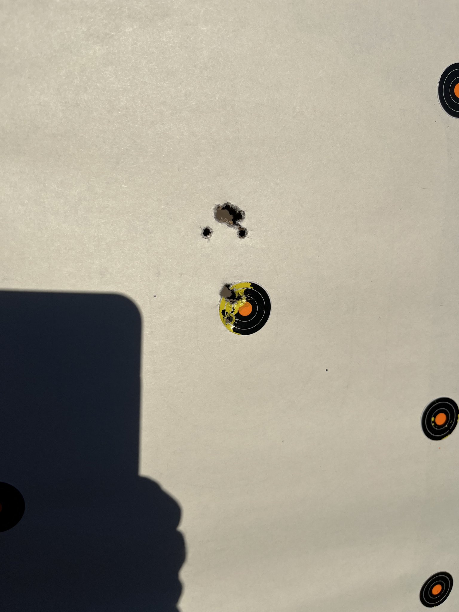

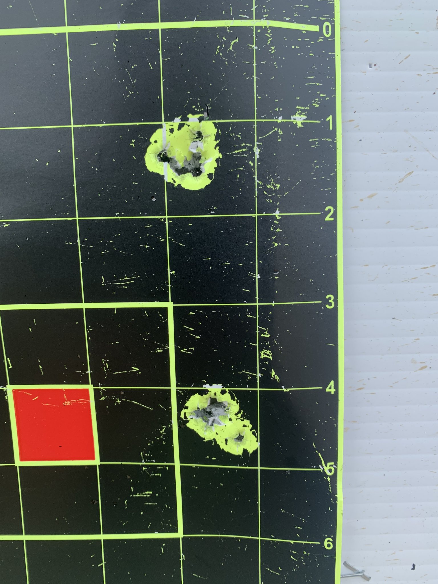

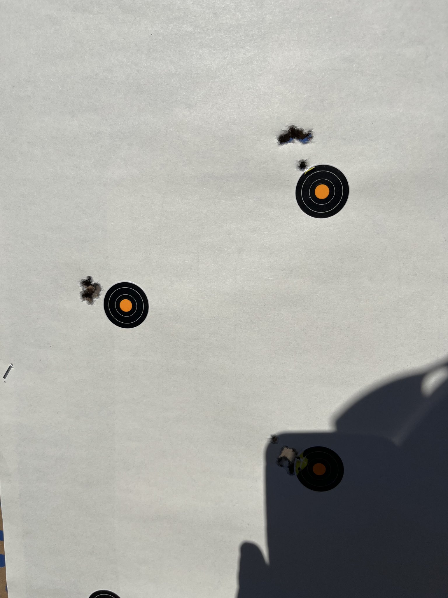

I headed to the range this morning with hopes of enjoying the 3mph winds, and was met with some exceptionally thick fog. I was able to wait it out, and work on my tuner using the RimX and the lot tested center X. The new trigger is still not here, so I was shooting the Timney Hit.
I followed one of the many write ups for finding the sweet spots by firing 2 shots at different aim points, and honing in on the ones where they are closest. At 100 yards, I found 3 or 4 settings that produced rounds that were nearly touching. Those were shot again with 5 round groups. When I landed on the best tune, I went back to a standard thread protector and fired a 5 round group, replacing the tuner one last time for a final 5 round group.
These were the end result. Edge to edge, they measure around 0.65”. I shot at 200 and 300, and even confirmed by 50 yard zero was still on point.
The moral of the story? While I’m not 100% sure, I think it was a carbon ring / dirty chamber and barrel. That’s all. The tuner helped bring things together
I switched over to some eley team that I wanted to try out, and practiced some from the tank trap and barrel.

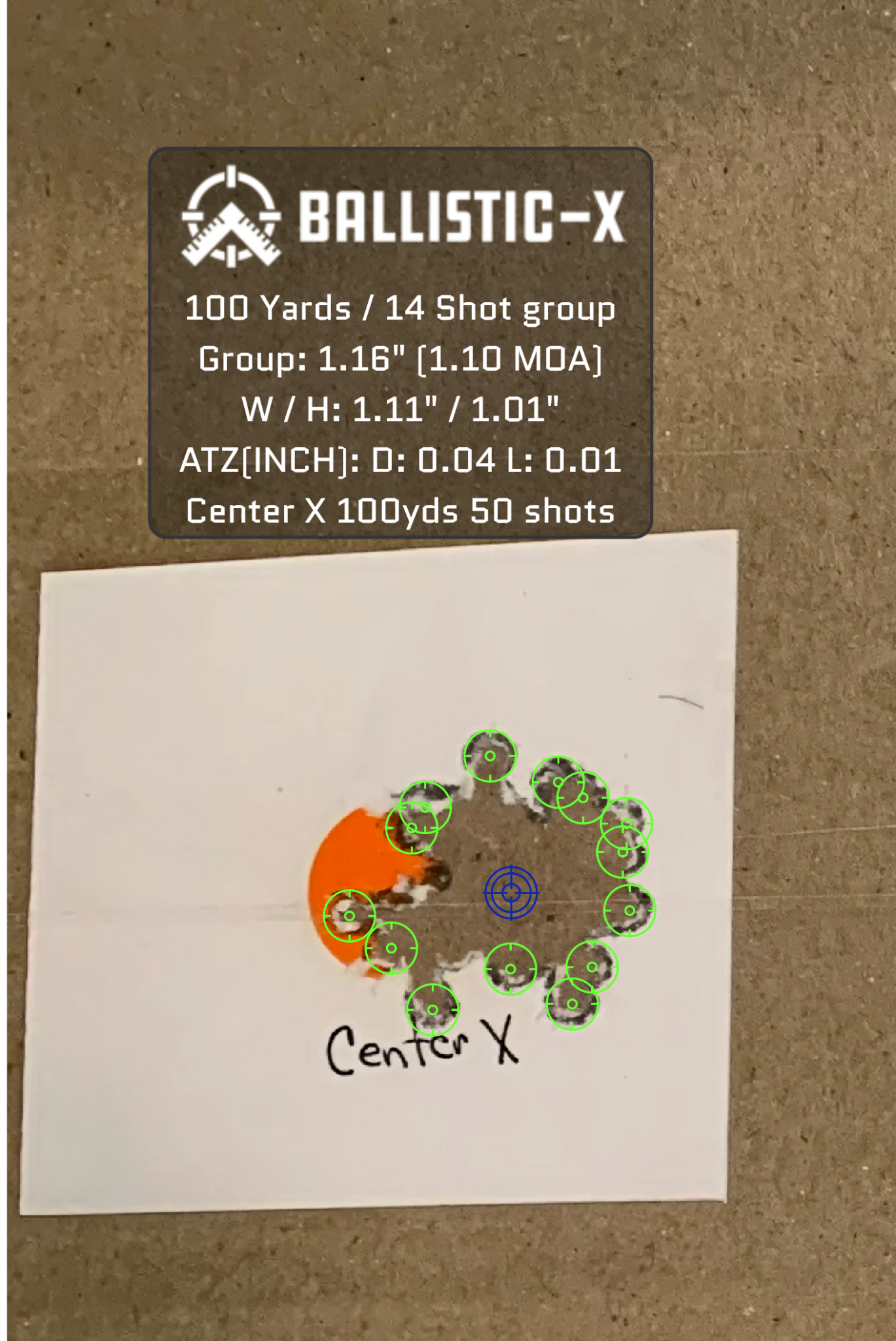

You really have to shoot multiple 5 shot groups or move to 10 shots. I shoot many 6x5s just to compare to the data on this site. My groups vary quite a bit. Maybe from .5” to 1.1” at 100. So I can’t shoot 1 group and say it’s the best tuner setting. My next rifle won’t have a tuner.
Reactions: BurtG
Why not? Just to not deal with it or you think it makes groups worse?
I wasn’t sold on the tuner as a solution, if I’m honest. But I had limited time before the wind picked up, and the one thing is sure - manipulating the tuner does modify the group size. I shot 18 or so 2 shot “groups”. The top contenders were either one hole, or within 1/8” of touching each other at 100 yards.
The last time I fooled with the tuner, I shot all my groups at 200 yards, and there were very clear improvements. Not everyone has access to a range like that, or the time to shoot in a day when there is minimal wind. The fog this morning forced me to get going at 100, which is where I stayed.
This is not me saying “hey y’all - go buy a tuner!” It’s me saying, for the vertical stringing I saw in my test center results, they appear to be under control due to a clean rifle, and a tuner. Your individual results may vary. I’m just trying to be sure that when I play the games I play, the gun doesn’t limit me.
