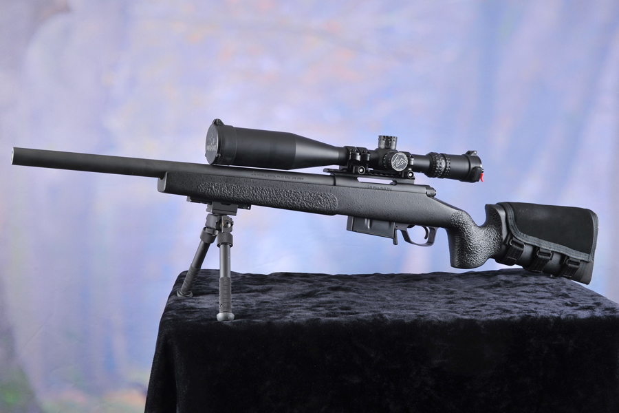

Do you have a picture of the chassis? Here is an old pic for reference of a mount .825" high with a 50mm objective and a 20 MOA base. So add about 3mm and you get the picture:

Here is a pic of a Surgeon action with Med Palma barrel and the 1.26" height rings. I run 1" height on other rifles but this one with the other barrel contours I have for it was too close with the lower integral 20 MOA base on the Surgeon. The 1.1" height should work fine for you and your set up.
This is in 1" height with a Badger 20 MOA base on a Rem 700 with a M24/40 contour barrel.
