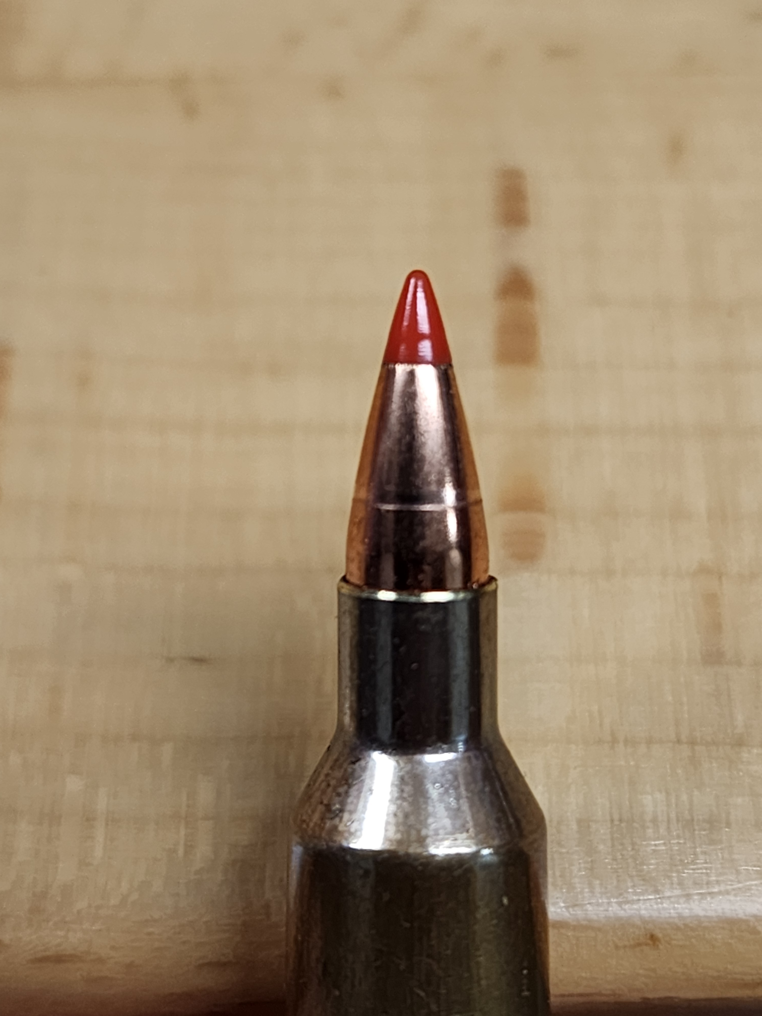

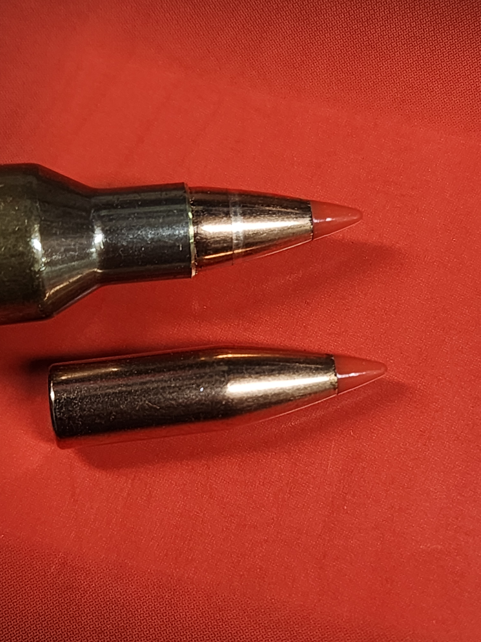

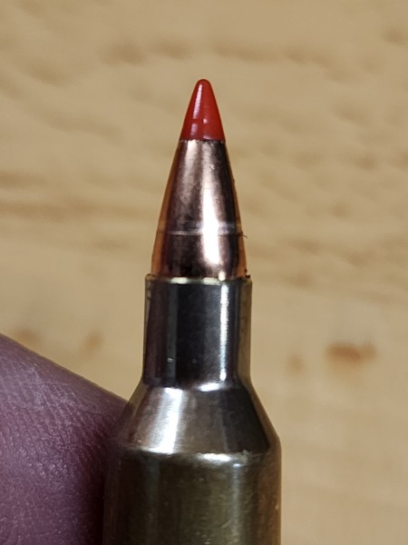

I started loading a new load today for my .22-250. I started loading a 60 gr Vmax on 31.5 gr of Varget. I am using a Forster Coax press with a brand new Forster Ultra Micrometer Seating Die on virgin Lapua brass. Max load is 34 gr of Varget. My C.O.L. is measuring right at 2.350. When I started the first 4 rounds gave an audible click when I lowered the ram after seating the bullet. The next 6 did not have the audible click but all 10 bullets now have a ring on the just above the case mouth. I cleaned the die prior to starting. I tried running a qtip through the seating die to see if there is a burr or something with no snags. I have never had this issue before. Anyone have any idea what is causing this.

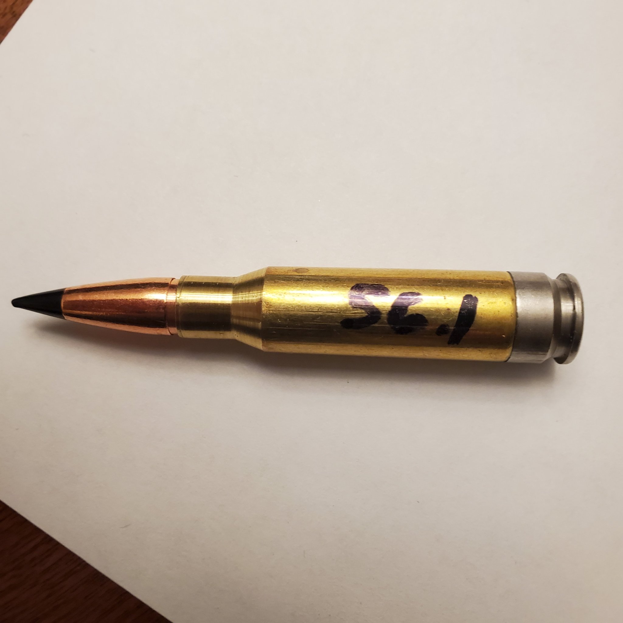

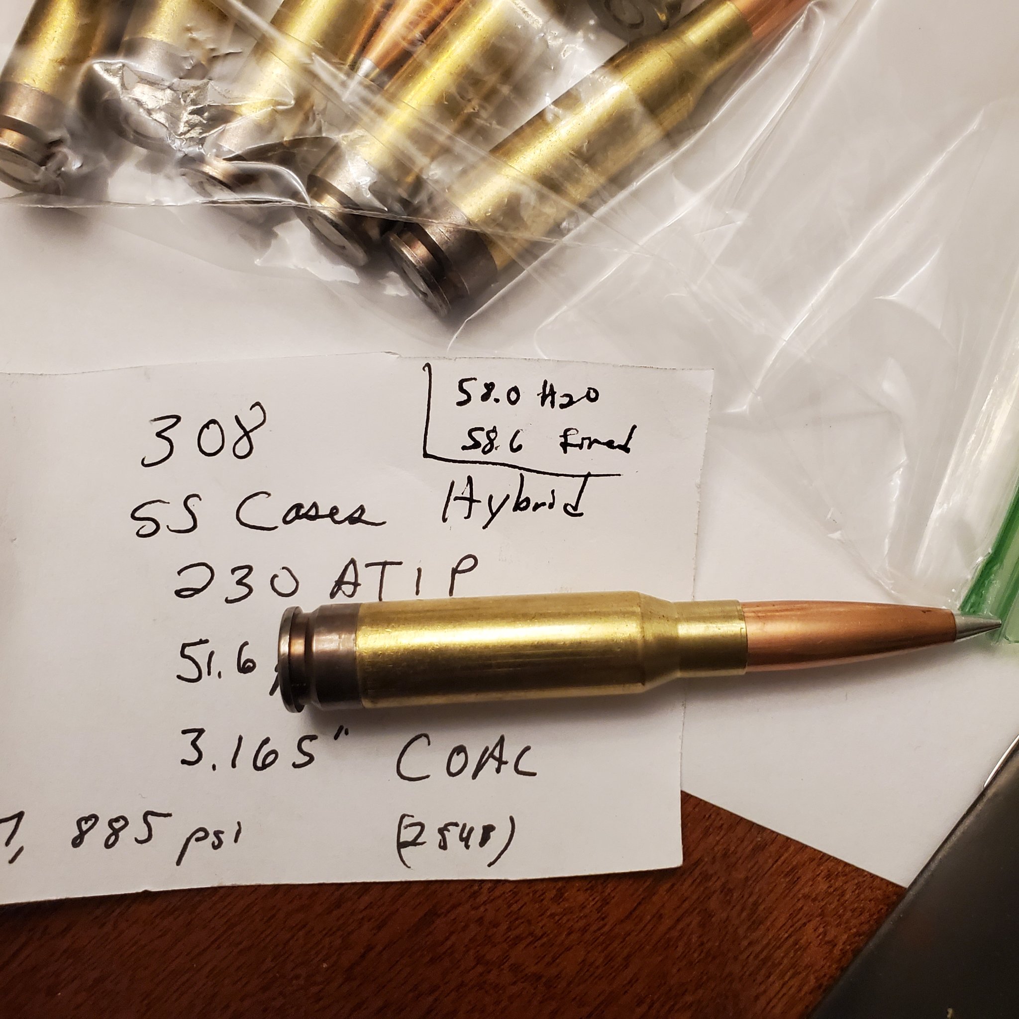

Especially when you shoot 250 gr Atips and my favorite 230 gr Atips at 2700 fps in your 308 with a case full of powder....ya might learn something about seating bullets.
Your normal procedure may not work here...like 56.1 grs under that barnes bullet.
Yes they are hybrid cases...with heavy powder charges.

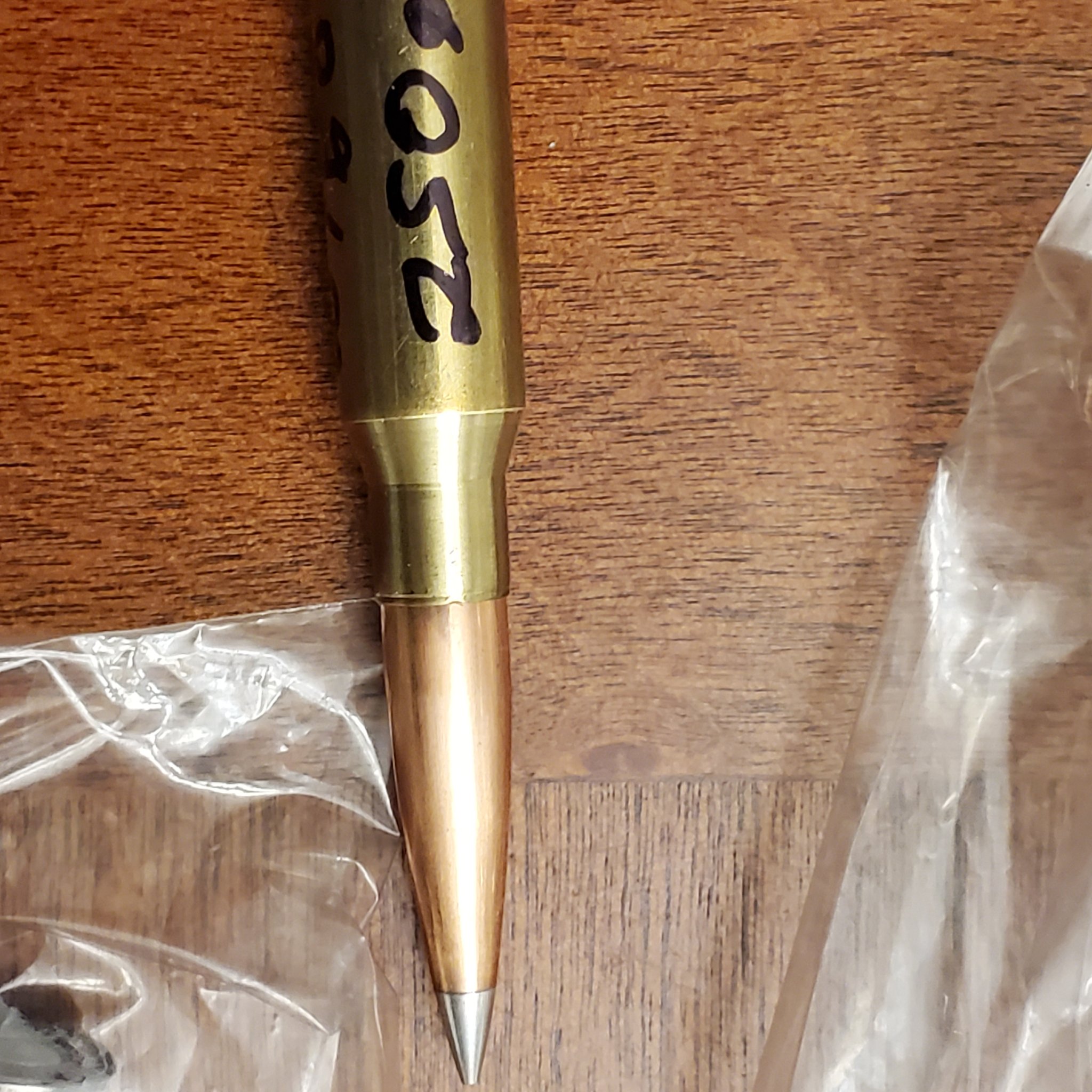

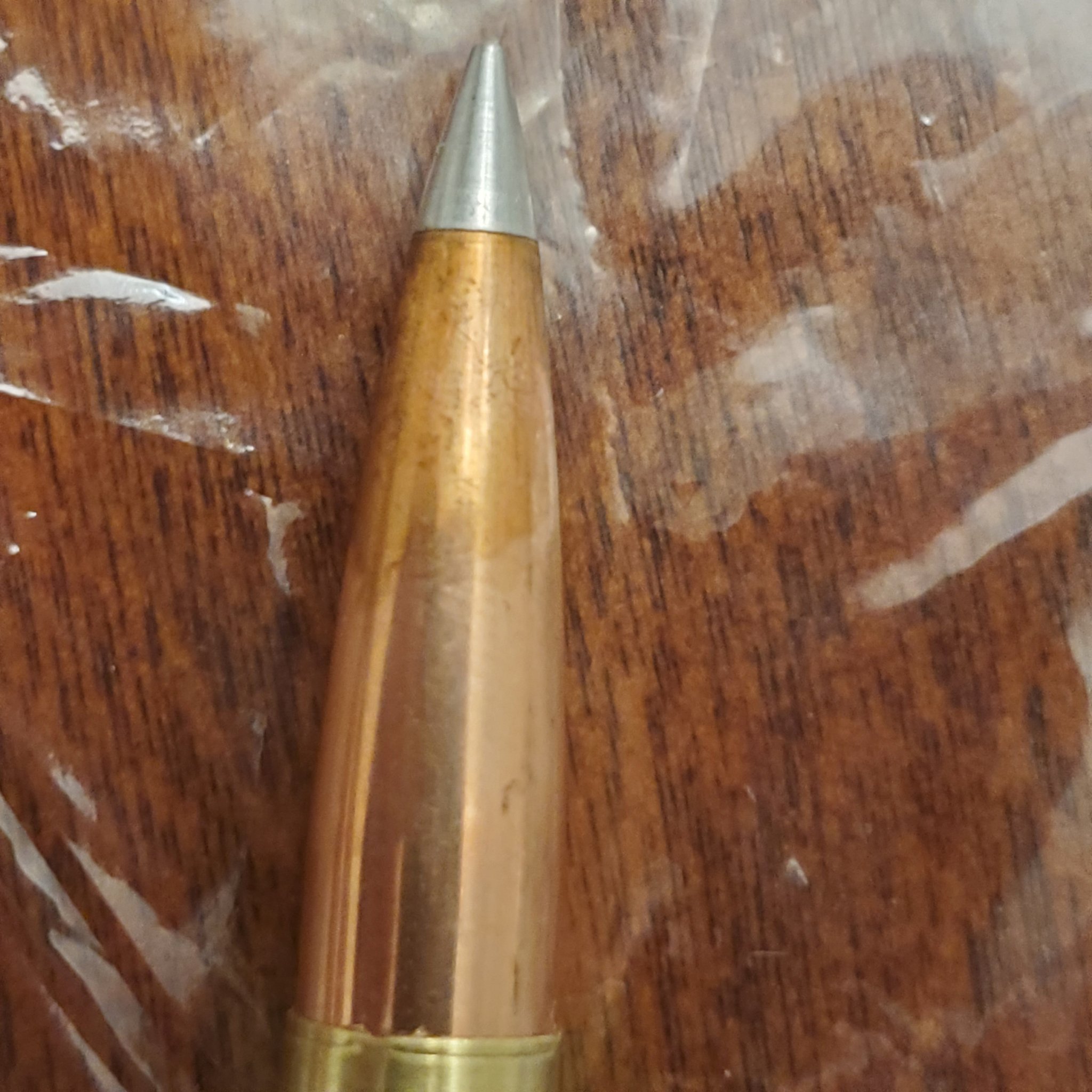

View attachment 8648197View attachment 8648198View attachment 8648199
