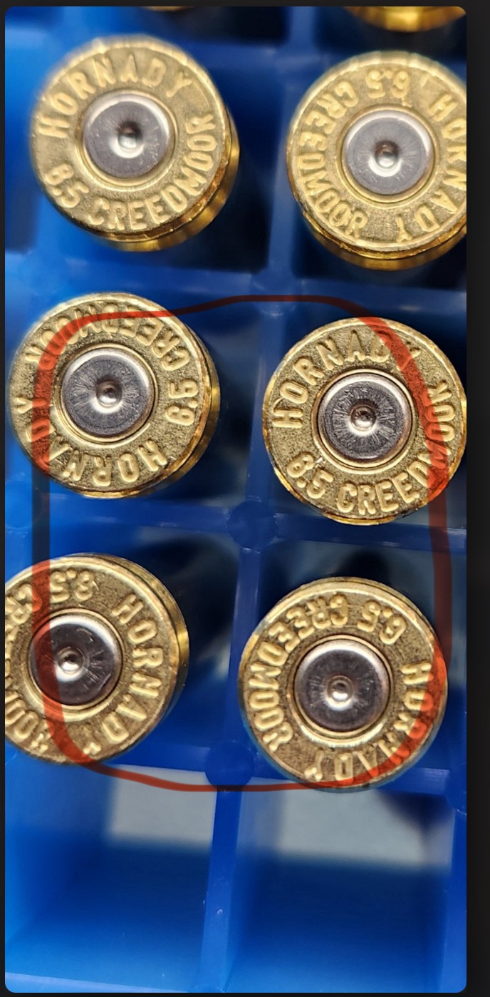

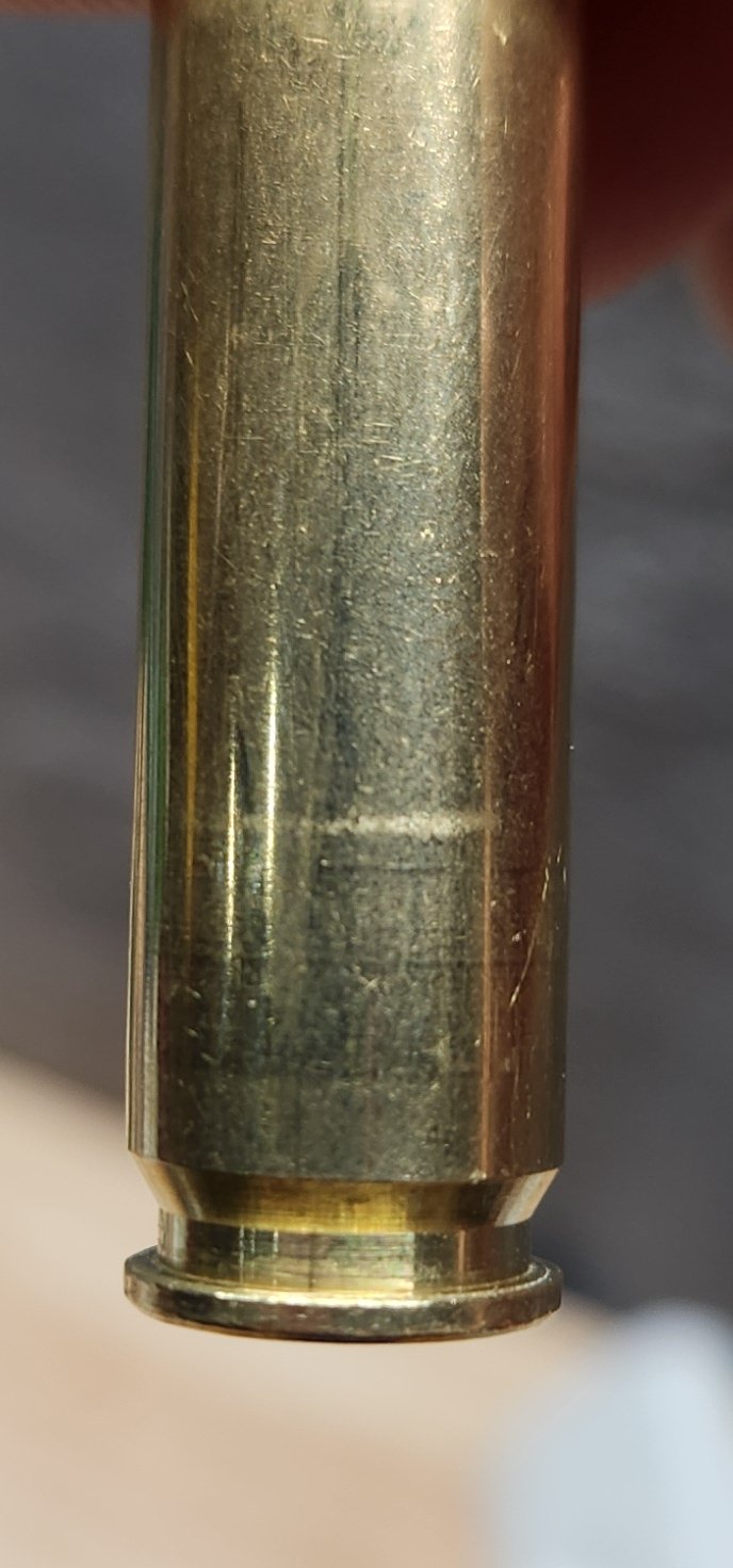

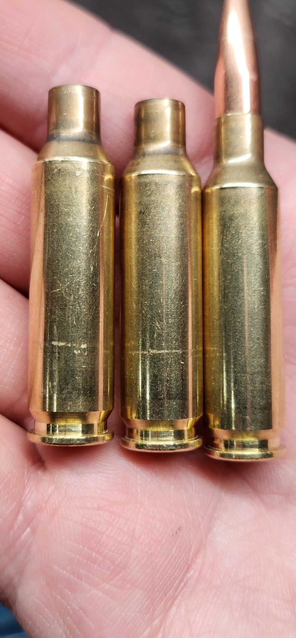

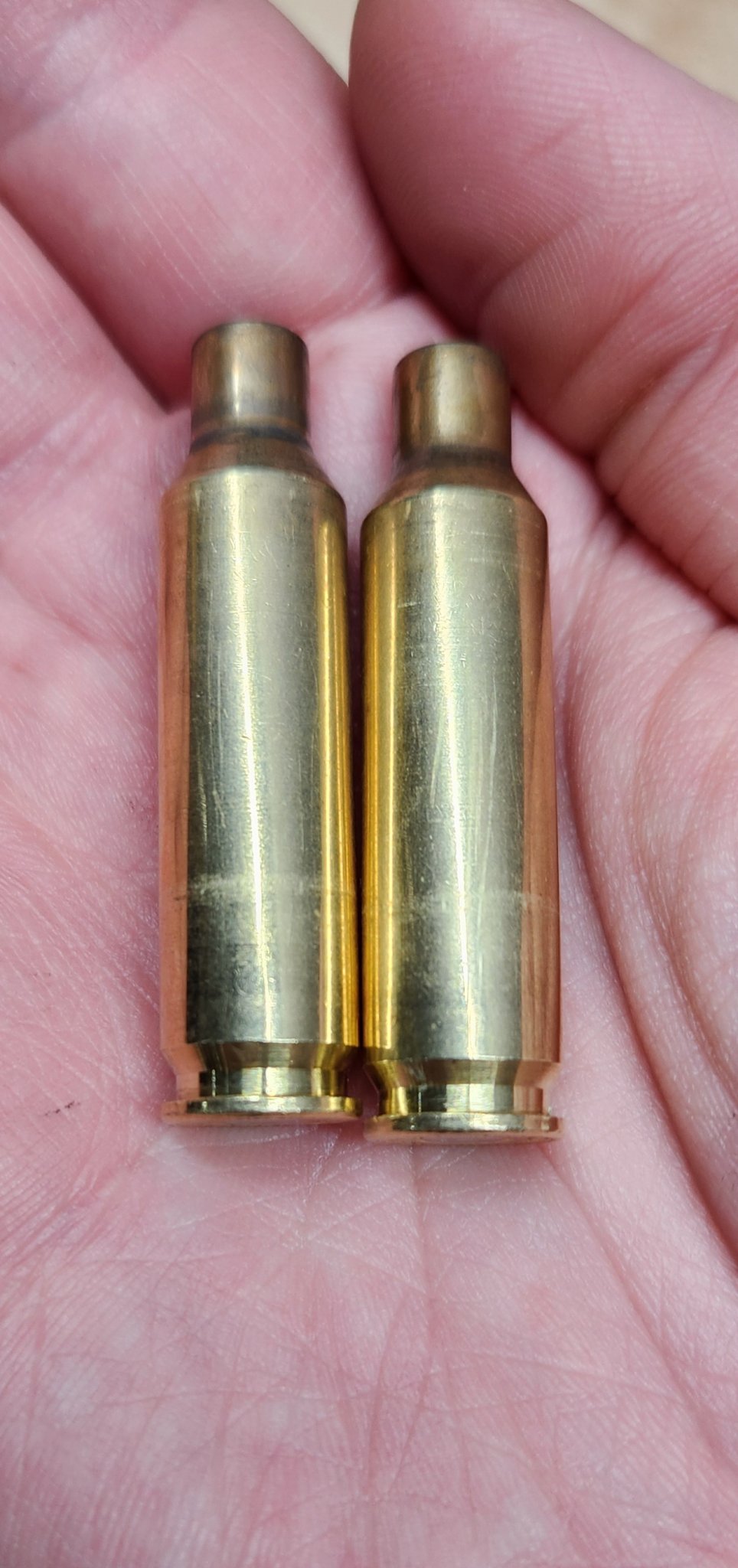

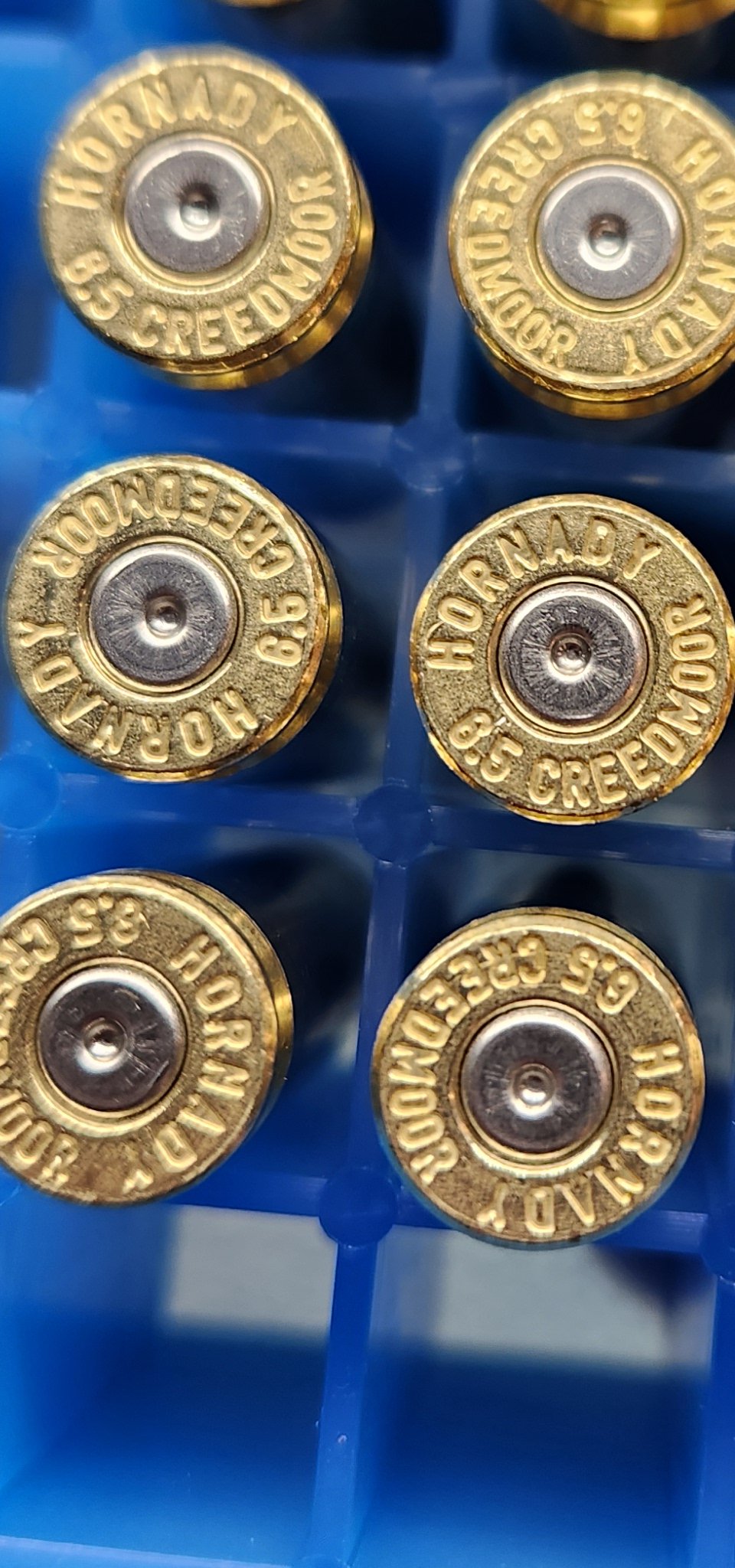

I just finished building a 6.5cm with zermatt origin action/26" proof ss prefit. I loaded up a few 5 shot groups with H4350 (36.0gr/36.5gr/37.0gr/37.5gr) and hornady 140gr eld match in once fired hornady 6.5cm brass (There's only 20rds through the barrel before shooting these groups). The shoulder was bumped back 1 thou. I shot the first 3 charge weights but didn't continue bc I noticed that all the fired brass had a scuff looking ring around them (It's not raised up or at least not enough to feel super noticeable) and that's not to be confused with the darker ring below that near the base from the resizing die. Recommended max charge weight is 40.0gr and i stopped at 37.0. Other than the rings the brass looks fine. Primers look good. Anyone know what would cause this mark? Does it mean something bad is happening or dangerous?

Are you loading the magazine then cycling through the mag into the chamber. It may put a bit of a ring scratch on the brass when it comes out of the magazine and hits the back of the barrel as you close the bolt?
these primers almost look like they have set back. Are they proud from the bottom the case head or do they sit flush with the head?
Pressure shows at the .2 line this is far above that. this looks like it might be something in a chamber that is less than ideal but won't affect accuracy.
I would hand load a few very clean ones and see if this is actually occuring in chambering. if so call gunsmith but its an easy polish out if so
