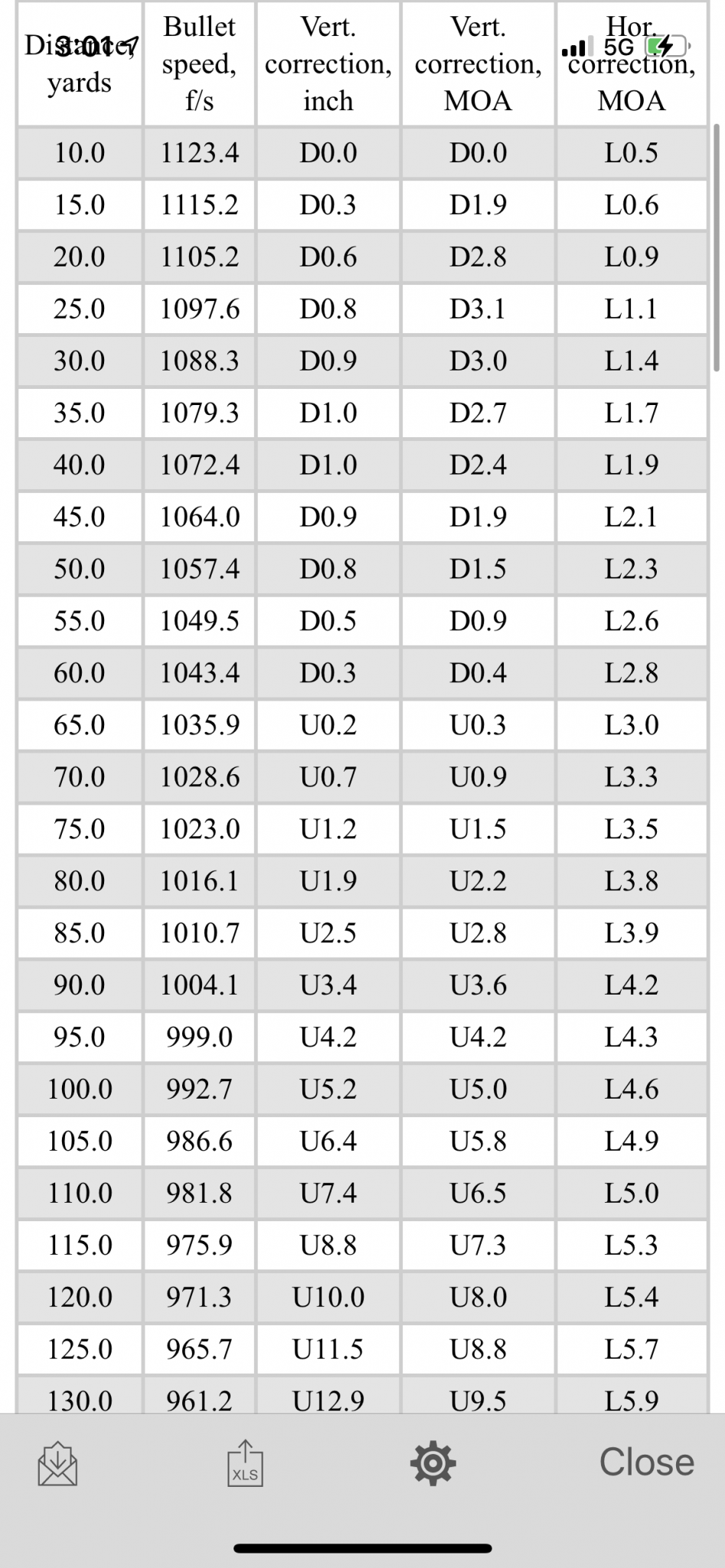

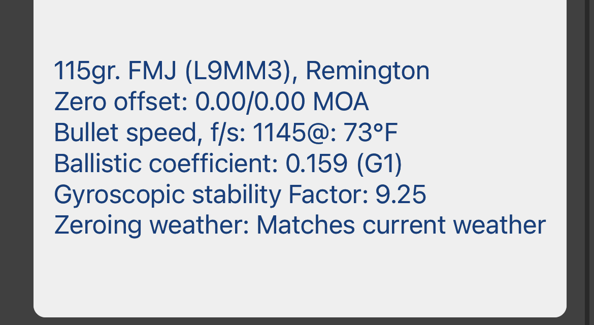

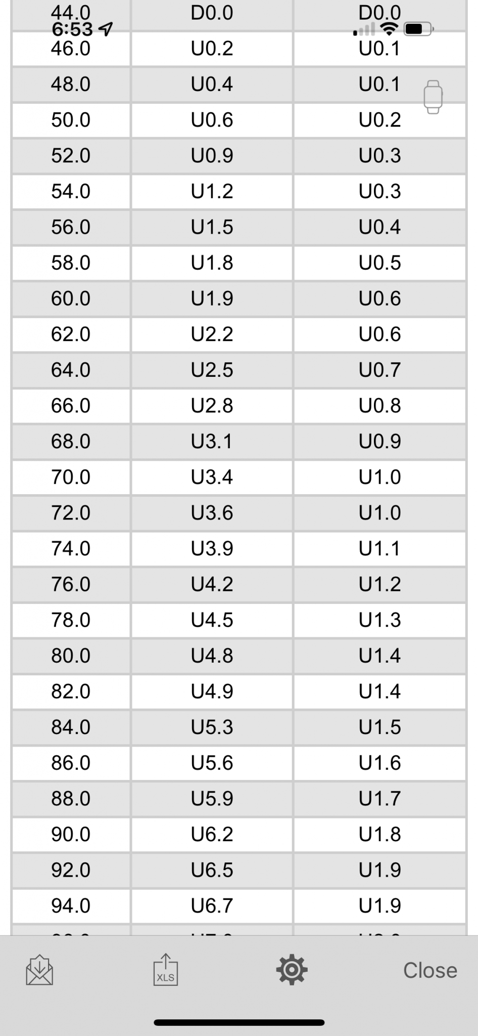

    Is this info correct ?
    Before I spend time putting info into strelok
    iSnipe. I found that at a 10 yard zero, the point of impact is +2.5 inches at 50 yards and -2.7 inches at 100 yards. My own experience is that at a 25 yard zero, it drops about an inch at 50 but 9 inches at 100 yards. When I ran it in the app, it was pretty much where I tested it to be. When zeroed at 15 yards, he calculation came to be a drop of a half an inch at 50 yards and almost 3 inches at 100.

    Seems odd to be talking about trajectory without clarifying what your load is. I mean, a 147 @ 1,000 isn’t going to have the same drop at 50 or 100 as a 115 @ 1350, etc.
    That may not matter much for the guys who never shoot past 25, but it sure does matter farther out. Any of us who understand rifle dope should get this too, same thing on a smaller scale.
