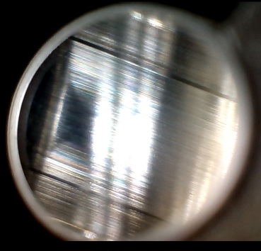

Here is the finish inside of a hand lapped, button rifled, Criterion after 200 rounds. Notice the absence of tooling marks.
I'm aware but it's part of the discussion chain. The excuse making because Craddock is a preferred vendor is incredible.
That’s a pretty picture and if the barrel shoots, even more the better. I’ve had many button rifled RC barrels on bolt guns that shot as good as anything. Only my factory DT Lother Walther barrels have done better and I’ve had had Bartlein and the lot that also shot well. To be fair, I’ve not bore scoped any of them. My RC barrels may very well had tooling marks, but I couldn’t see them by looking at the target.

I paid $300 for the barrel in the picture. I didn't have to pay extra. By all accounts Craddock makes some of the best custom barrels in the AR world. The RTRs do not appear to live up to that reputation.
I've seen more than a few factory Rem 700 barrels that looked like the rifling was cut with a chainsaw, but they shot lights out, didn't clean so easily thought.
Beauty is great for sure, but that doesn't always reflect or guarantee accuracy.
The problem with borescopes is that too many people are convinced that a barrel must be perfect, end to end in order to shoot well, & that' not always the case.
Do I prefer a pretty barrel, sure, but performance overrides beauty; best case you get both.

The marks are from the reamer before the barrel is rifled. It shows what the feed rate the reamer was fed in. Most times the marks are swaged out smooth but not always. One thing they can tell you is if there is loose spots in the barrel. That is where there will be more marks as the button passed over them without much force.
