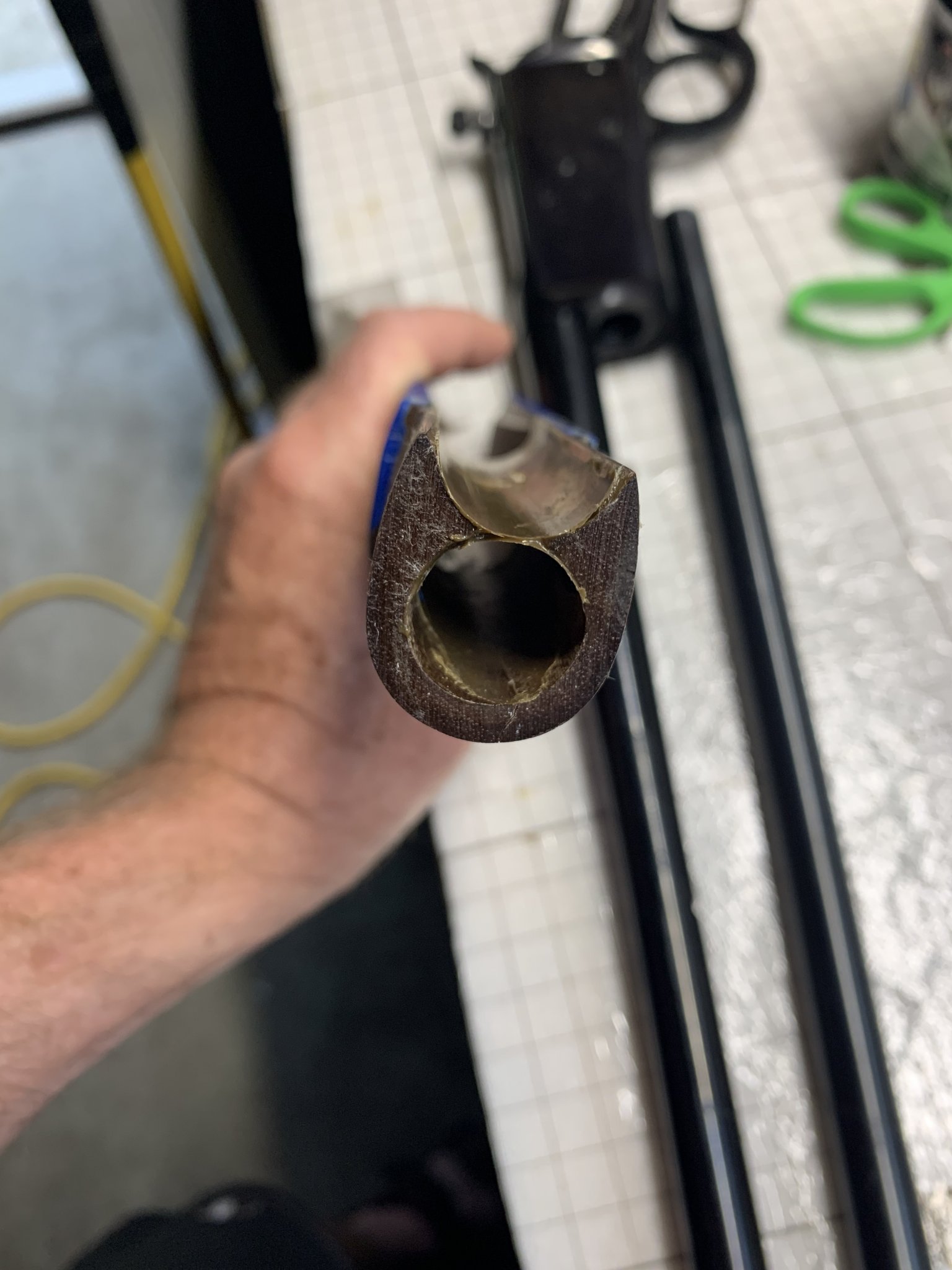

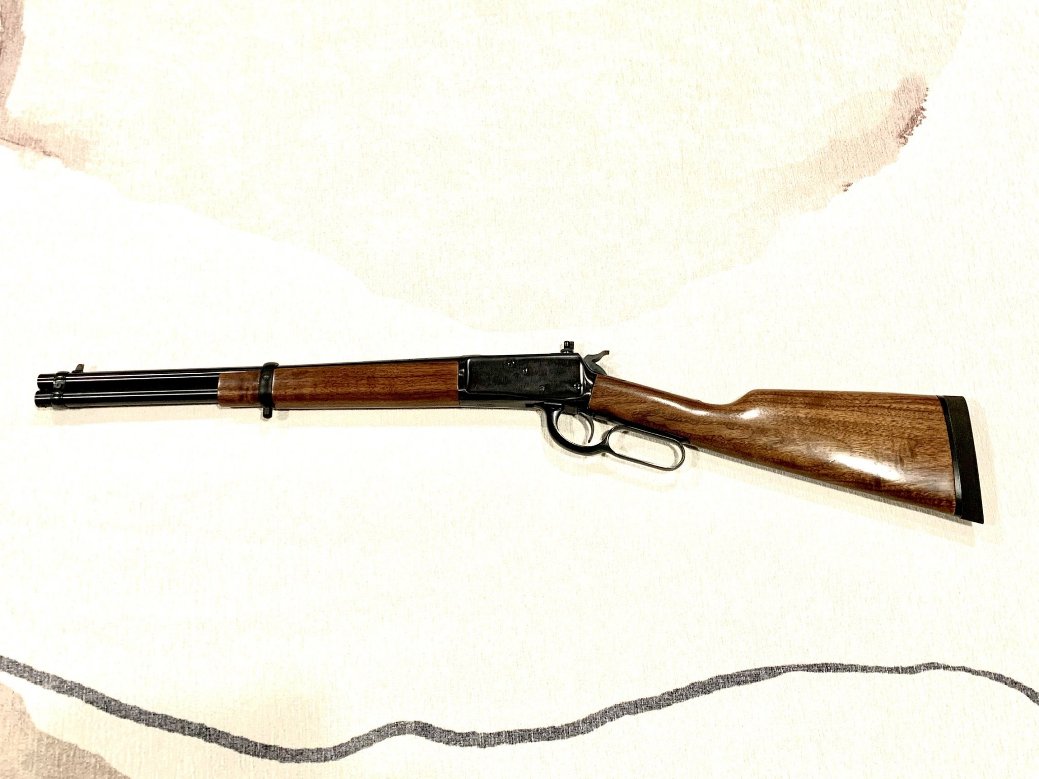

Gunsmithing Rossi 92 and Boyd’s wood
KYAggie
  • Oct 2, 2014
    1,553
    2,570
    Kentucky

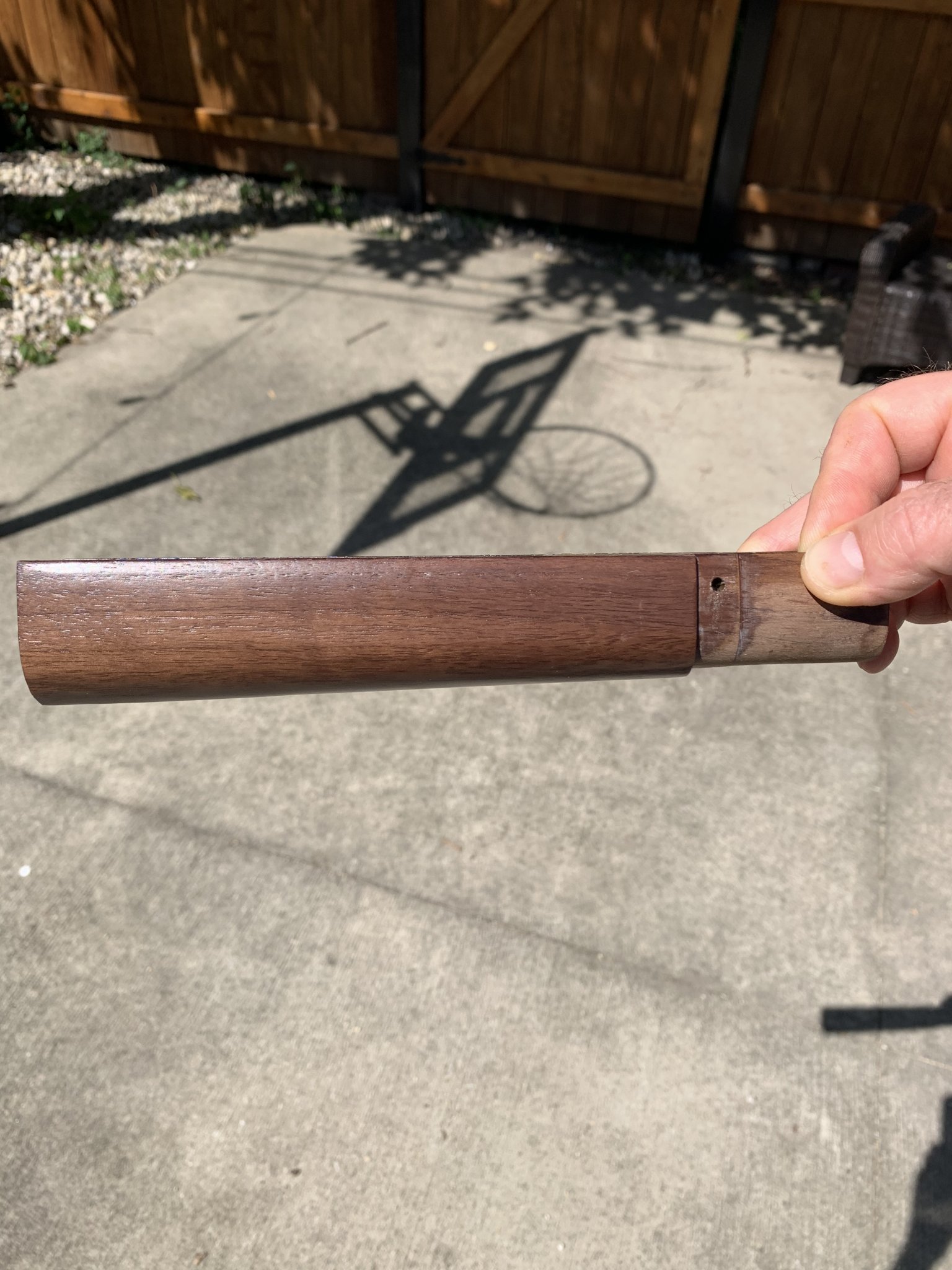

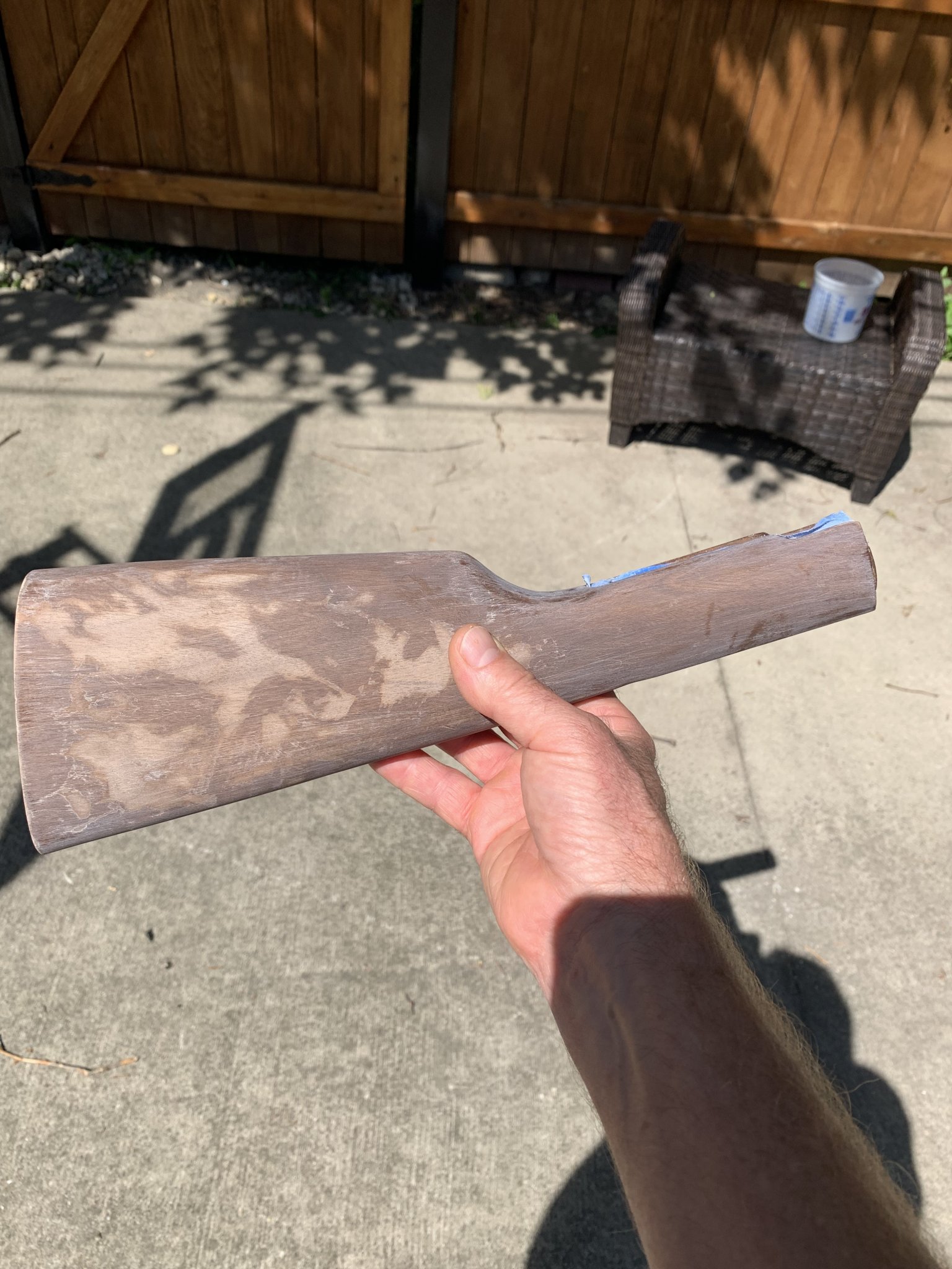

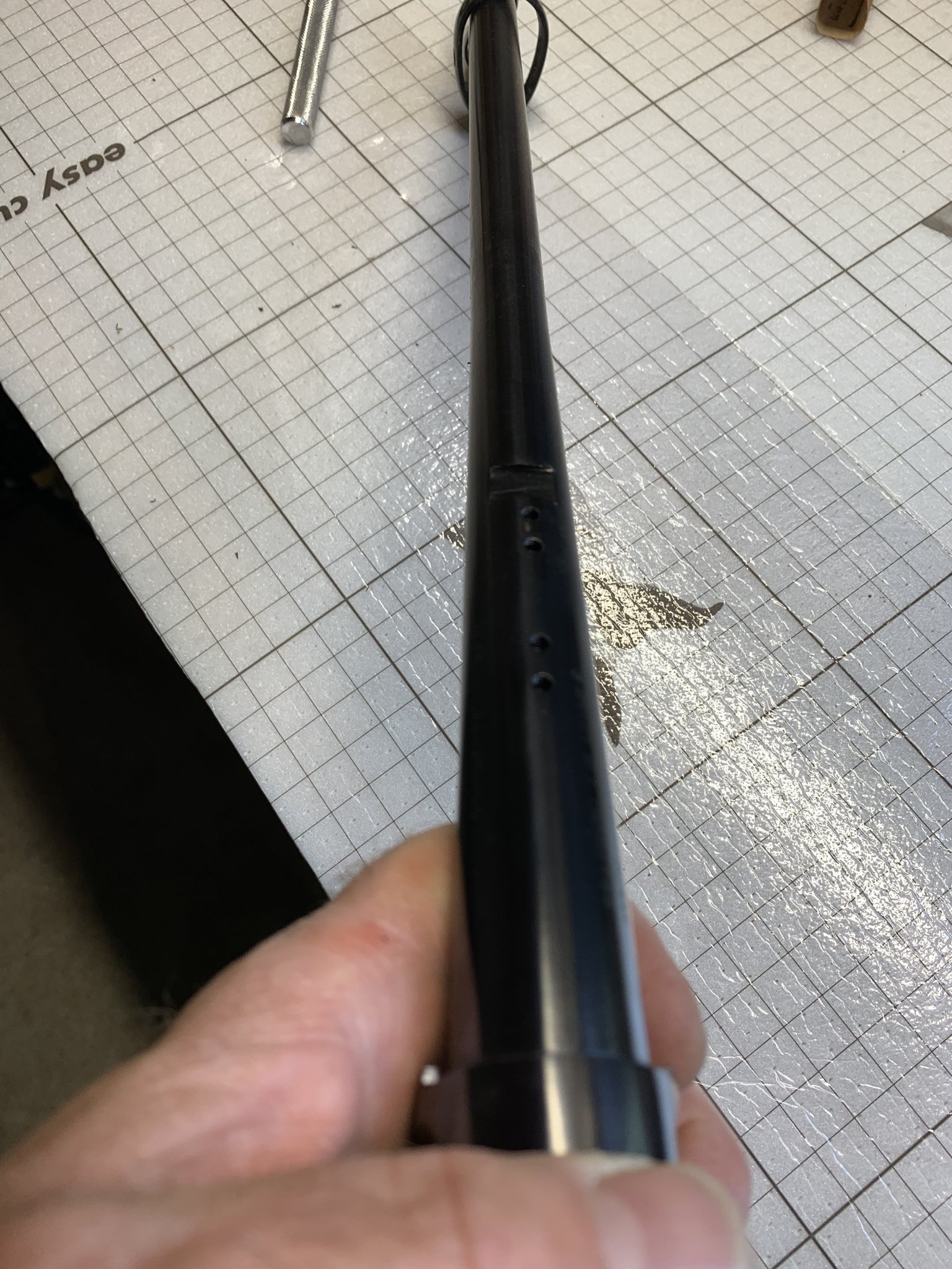

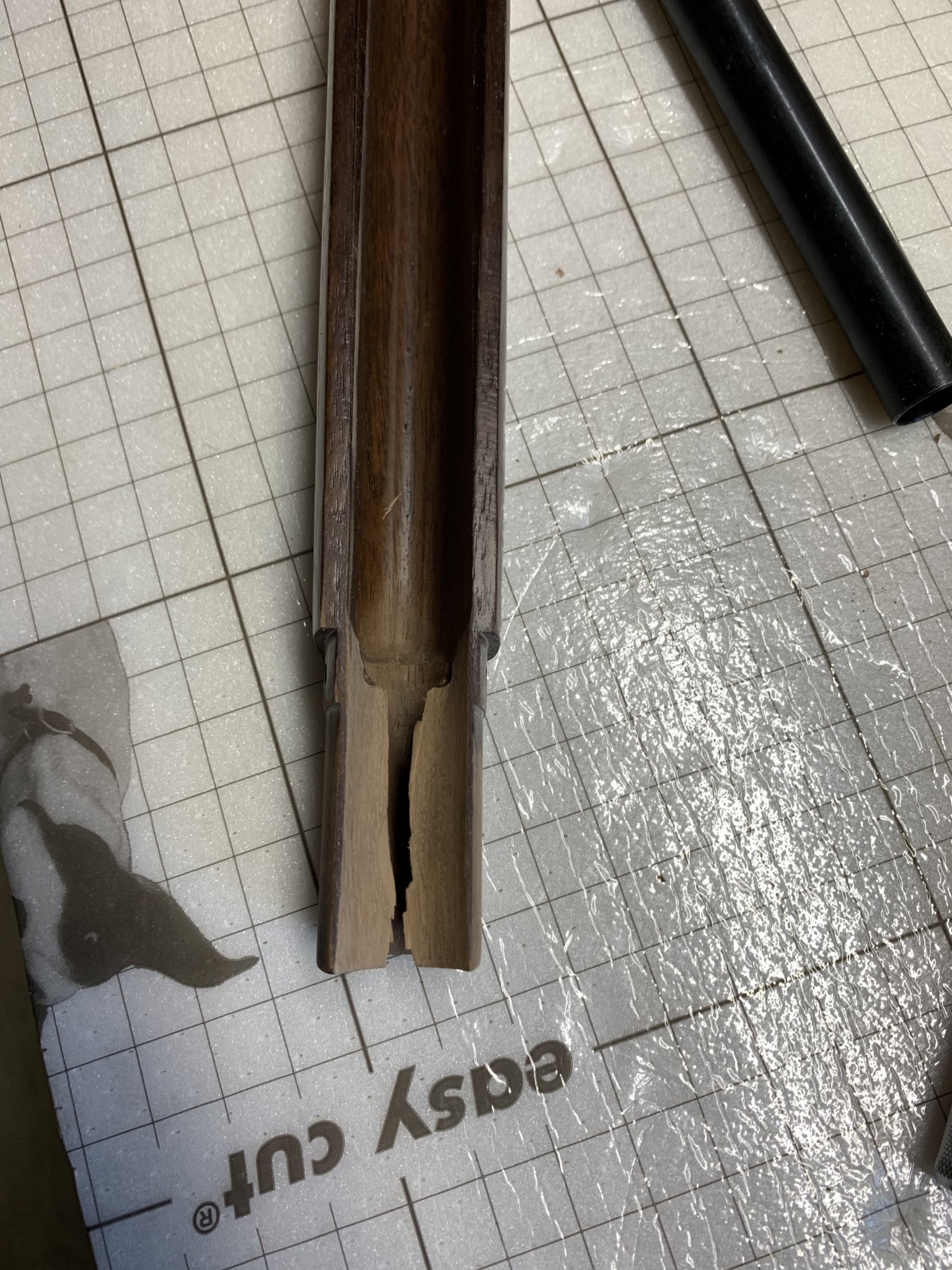

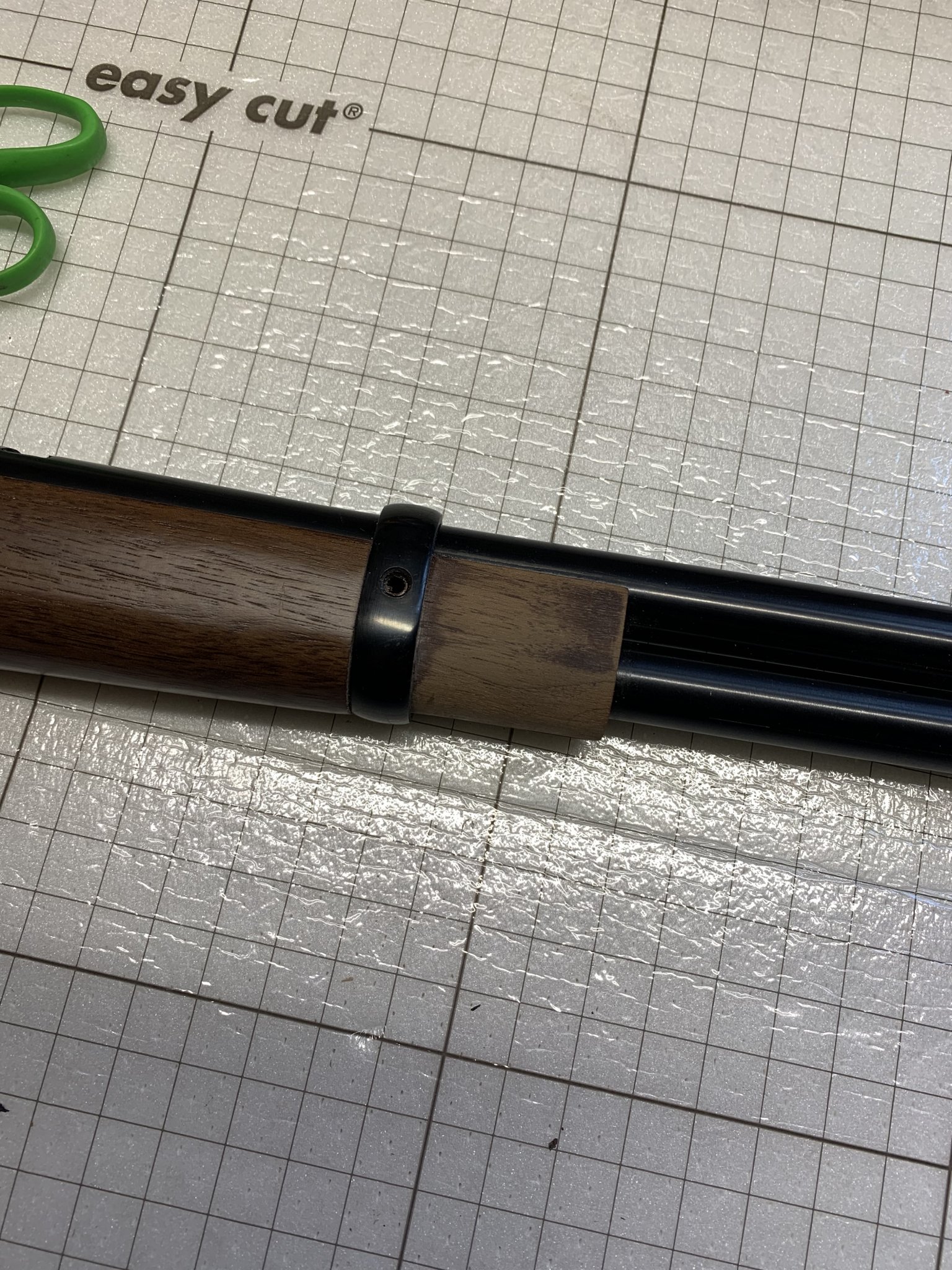

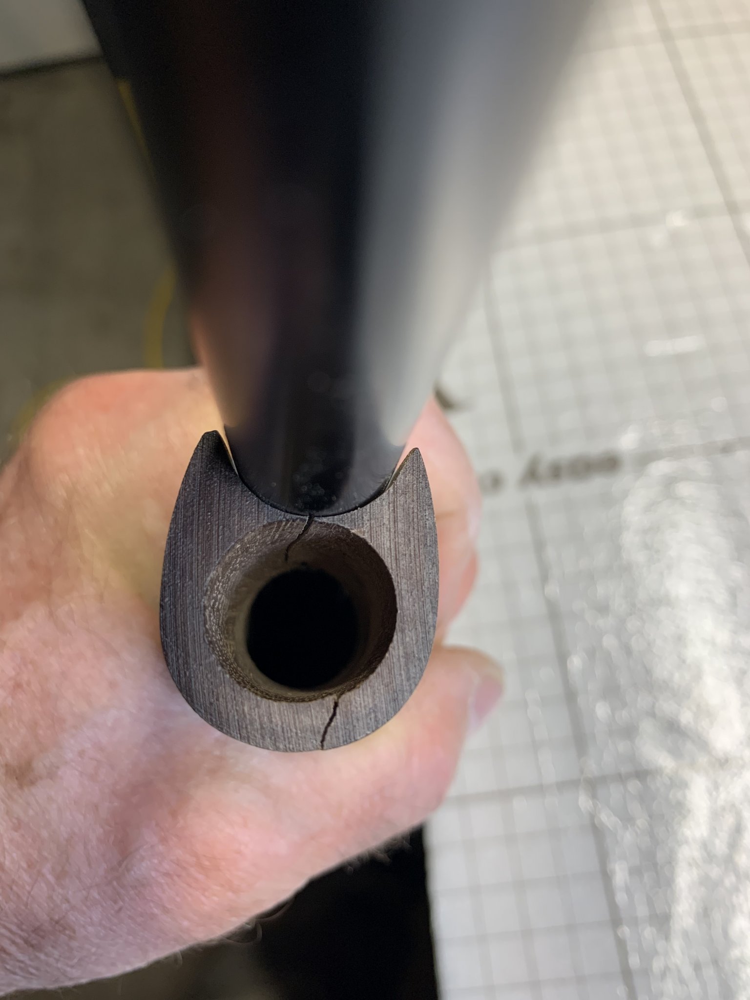

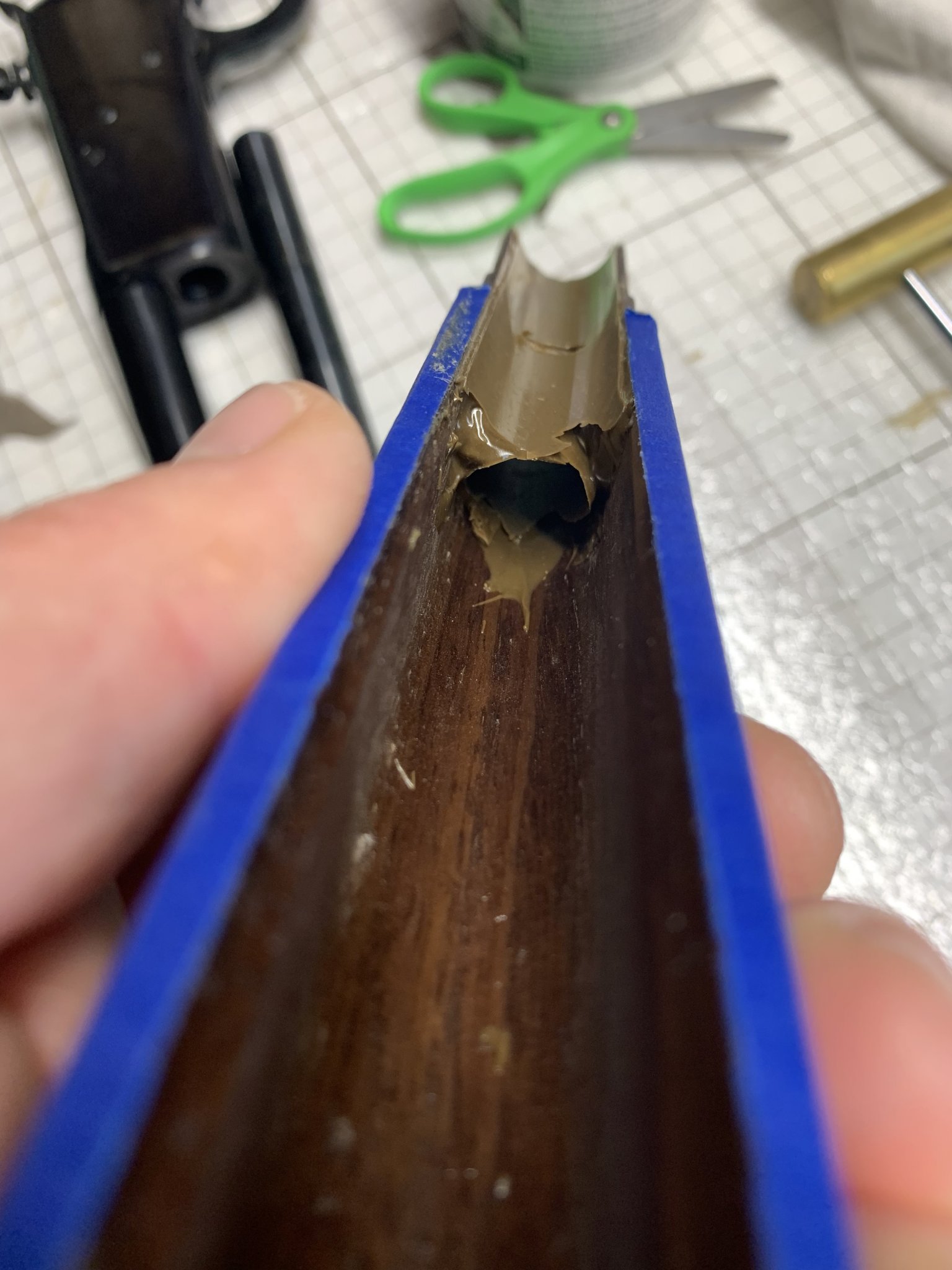

    I thought we had a lever gun section, but I can’t find it so I’m posting here. I have a Rossi 92 carbine in 44 mag. I hate the curved butt plate so I bought a Boyd’s stock set for it. They say that it will need minor fitting. Yeah. A little more than minor. I had to sand quite a bit to get the barrel ring to not crack the forearm. So much that I sanded through the very thin wood that’s suppose to be between the magazine tube and the barrel. I suppose I could have taken even more off the outside of the forearm, but I already had to take off quite a bit. I have no idea why they even bother to finish these stocks as I’ll have to strip and refinish it anyway after fitting.

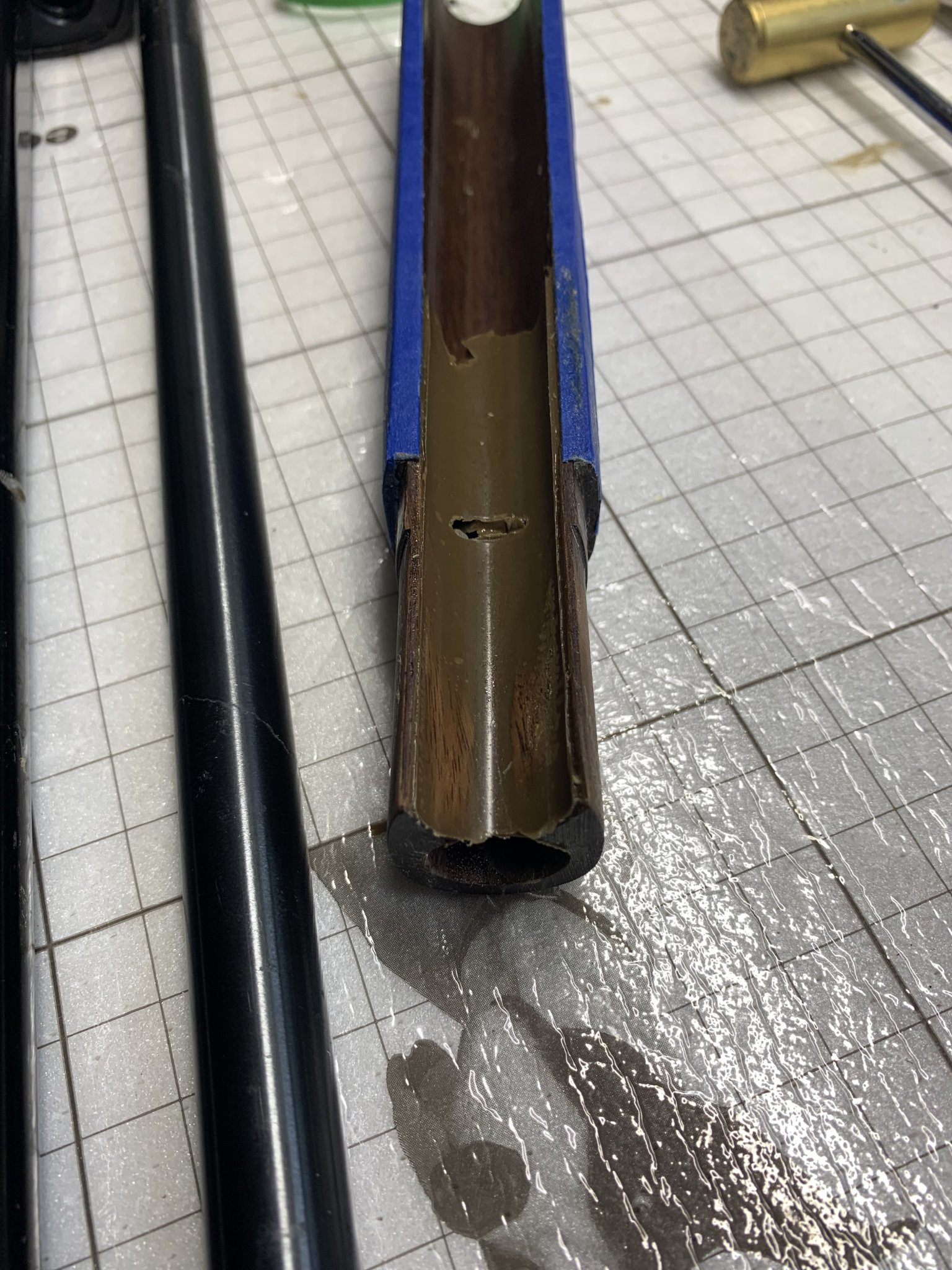

    My idea is to wrap the mag tube with one layer of painters tape, spray the heck out of it and the barrel with RAM 225 mound release, and carefully bed them with Acra Glass Gel. Then strip and refinish with Tung oil I have on hand. I might stain it darker before applying the Tung oil.
    Any other great ideas that would accomplish the same thing?
    If you look close in the picture down the barrel, you will see that who ever drilled the sight holes not only didn’t get them lined up with the top of the barrel, they aren’t even in line with each other. So much for my idea of installing a picatiny rail to put a red dot sight on……I know that would be sacrilegious anyway.

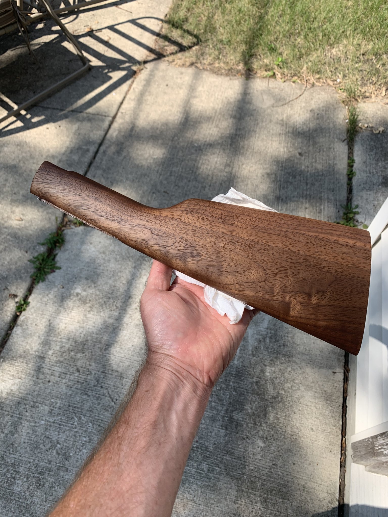

    Brown Acraglass is probably your best bet for that. Tung oil if that’s what you like, but I prefer something a bit more durable, like Brownells’ Acra-Coat for Wood.
    It also looks like you have a bit more wood on one side of that fore end than the other, so you can still take a little off if necessary and even it up.
    Reactions: KYAggie

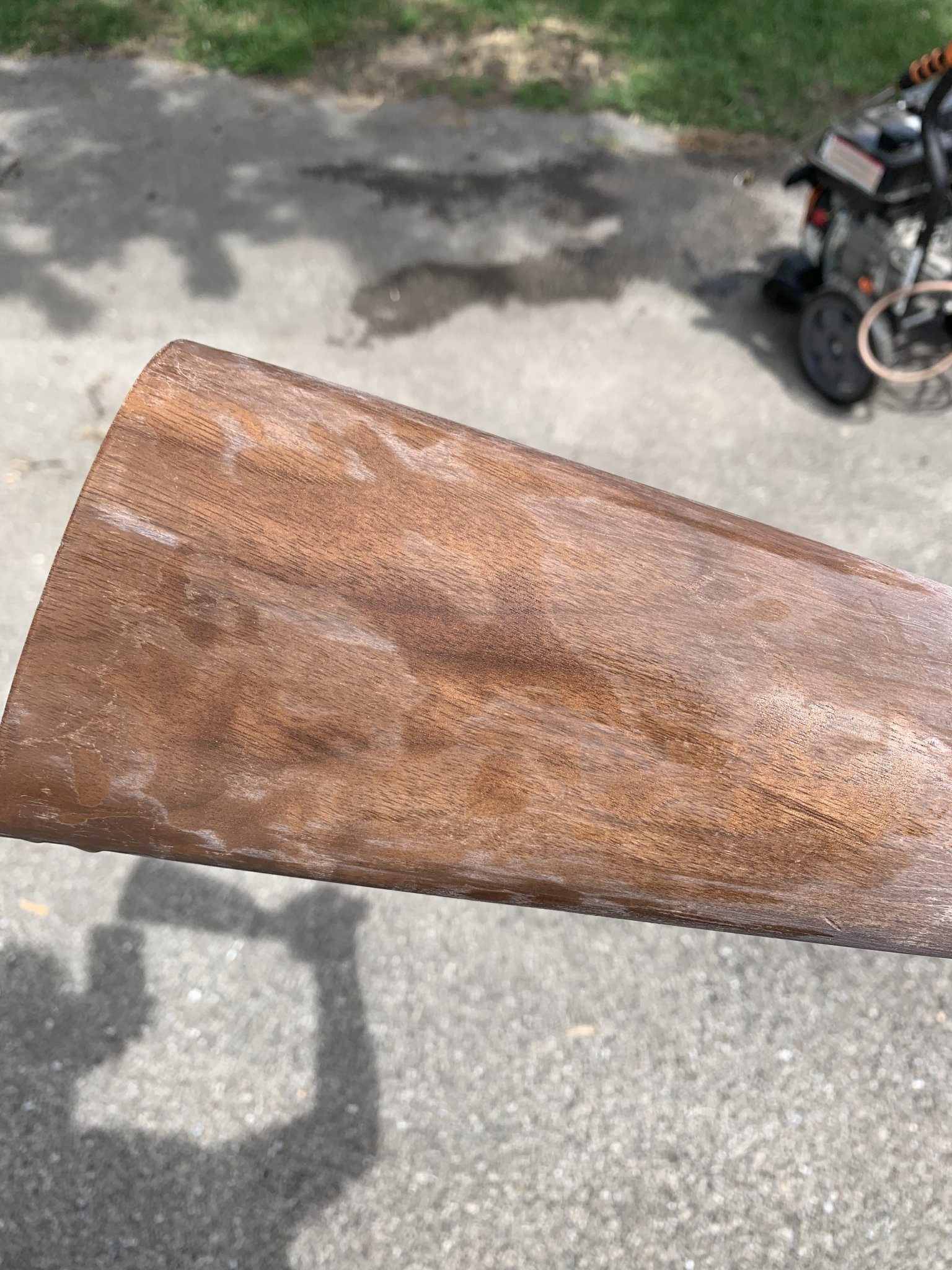

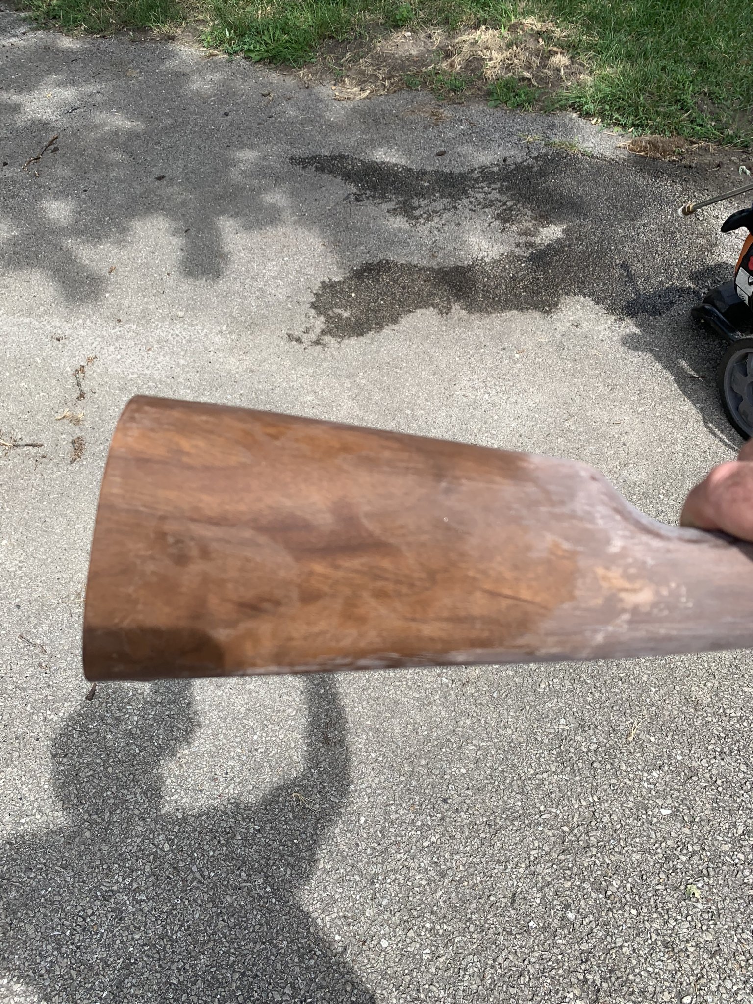

    Thanks. I’ll definitely even it up. I’ve never heard of Accra-Coat, but will look into it. Ultimately, I would like a medium to dark walnut colored stock that looks like a oil finish.
    Sorry to hear of the issues. And I don’t know much about what to do with that. However i did have one of them in stainless steel. I sanded it and did tongue oil on it. Turned out nice.
    Also did spring and follower from Steve’s Gunz, as well as shortened a couple of the other springs, polished the action. Made it smooth as silk.
    Reactions: KYAggie

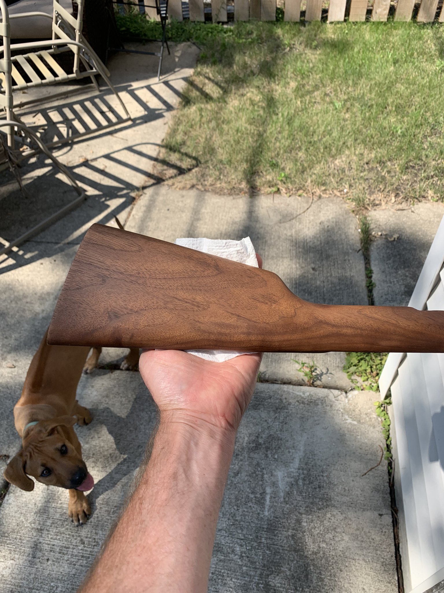

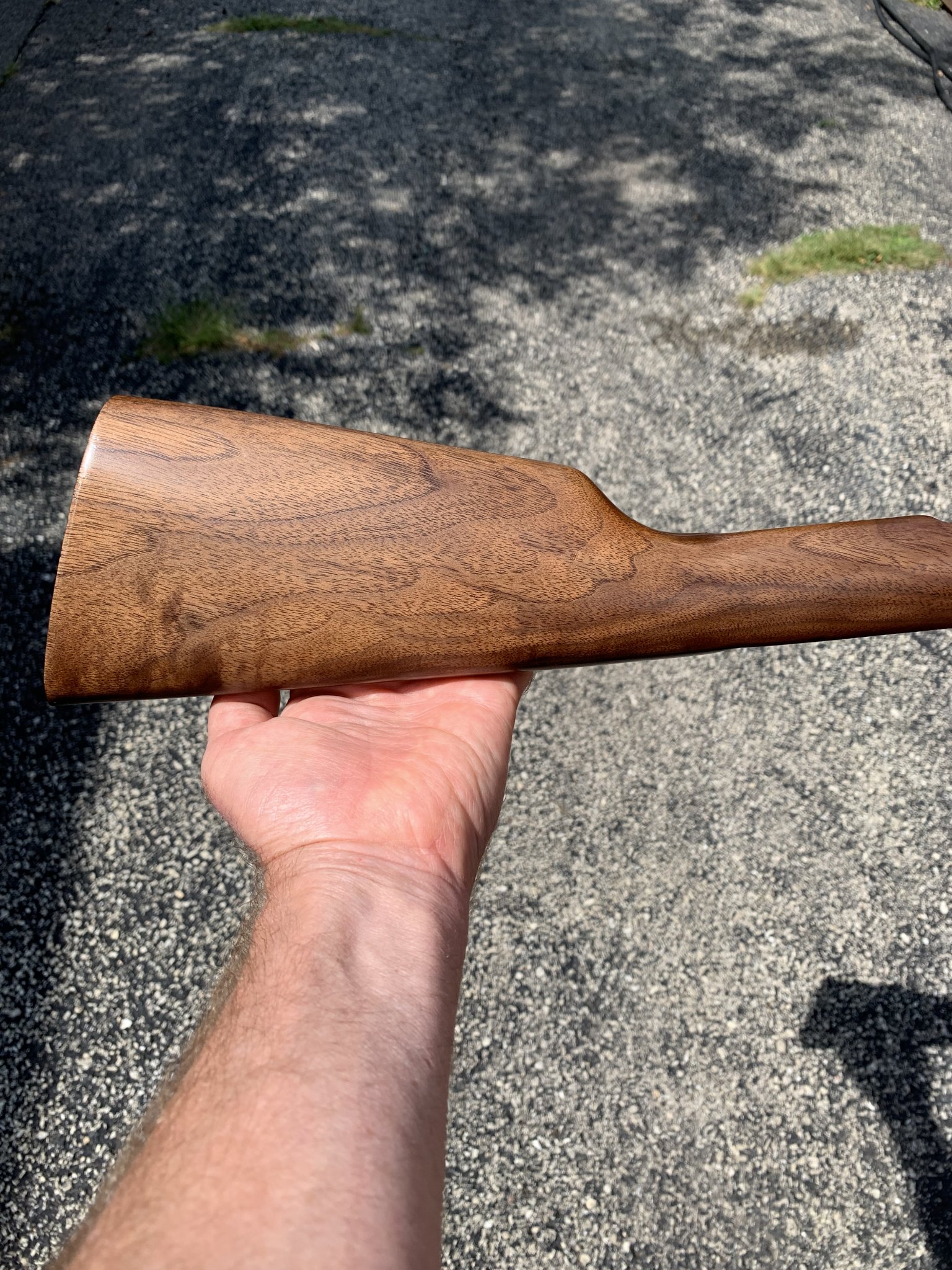

    I have the springs from Steve’s as well as the follower. I have his dvd too, I just have to find a way to play it in this now digital world.

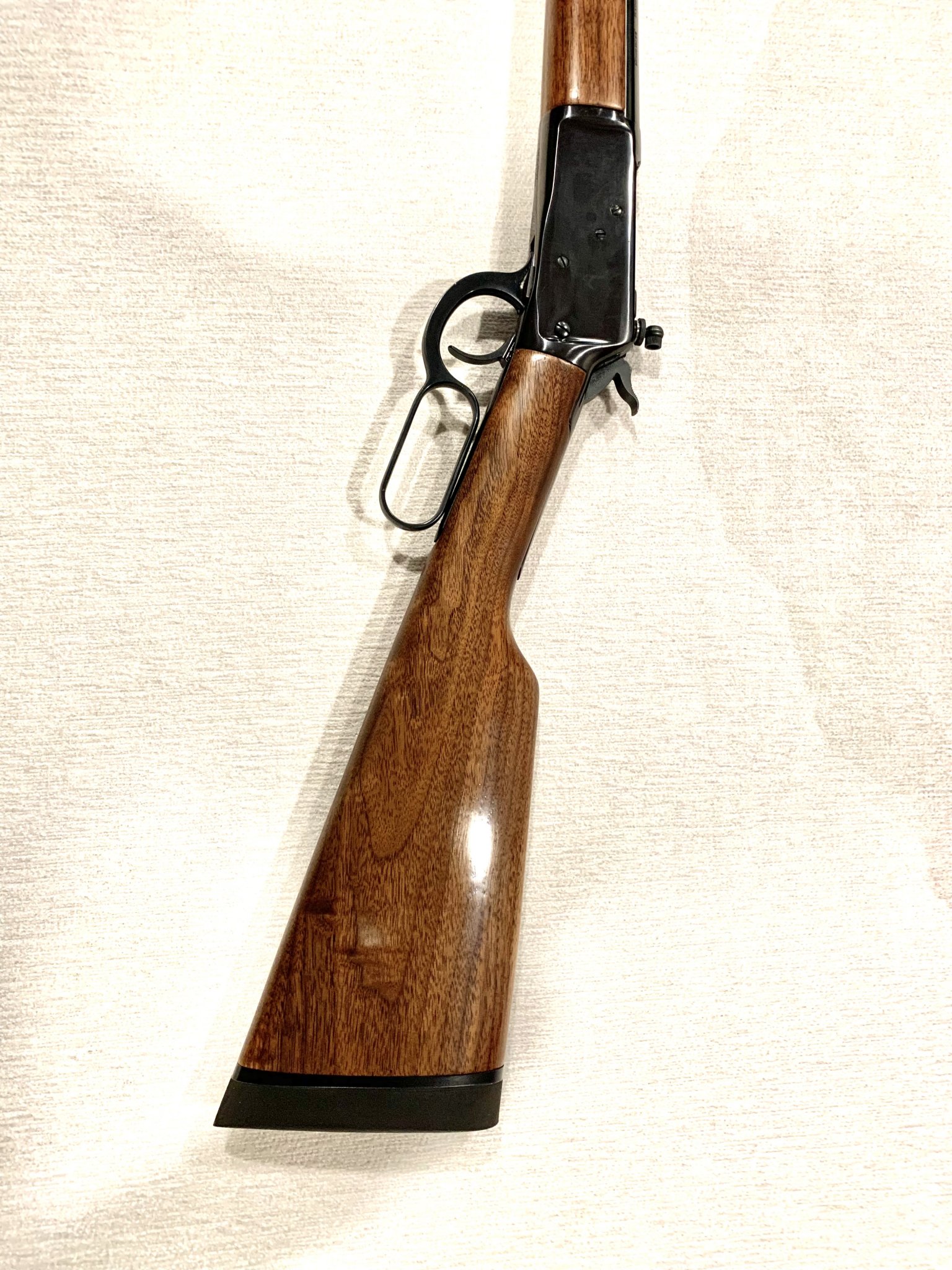

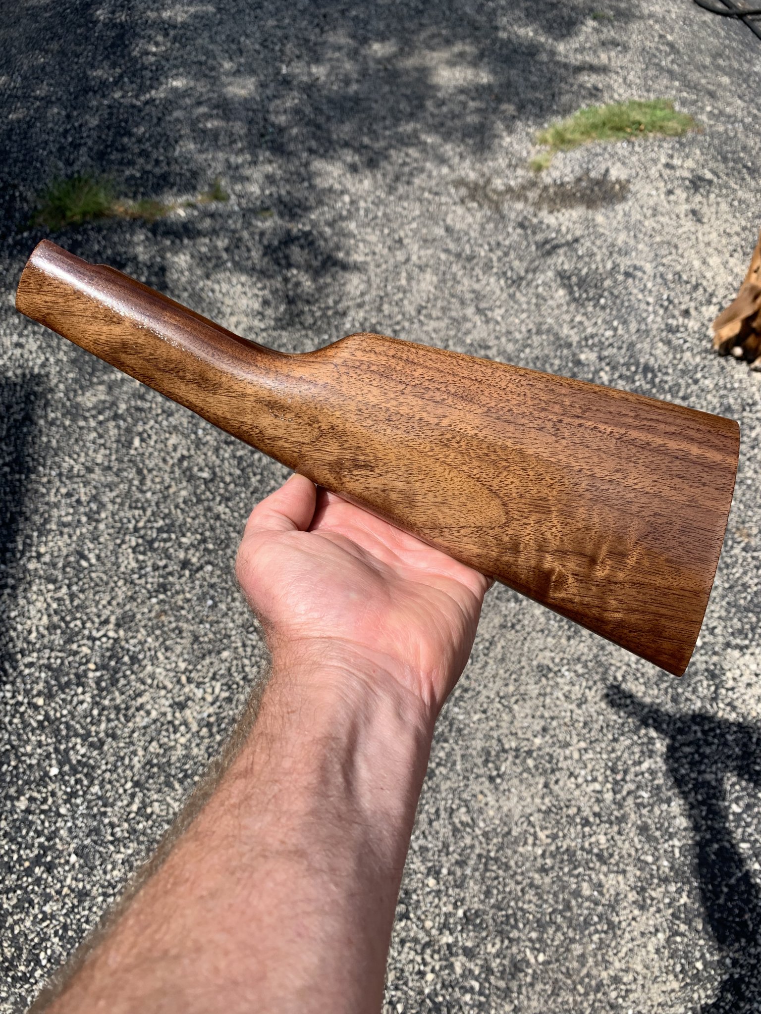

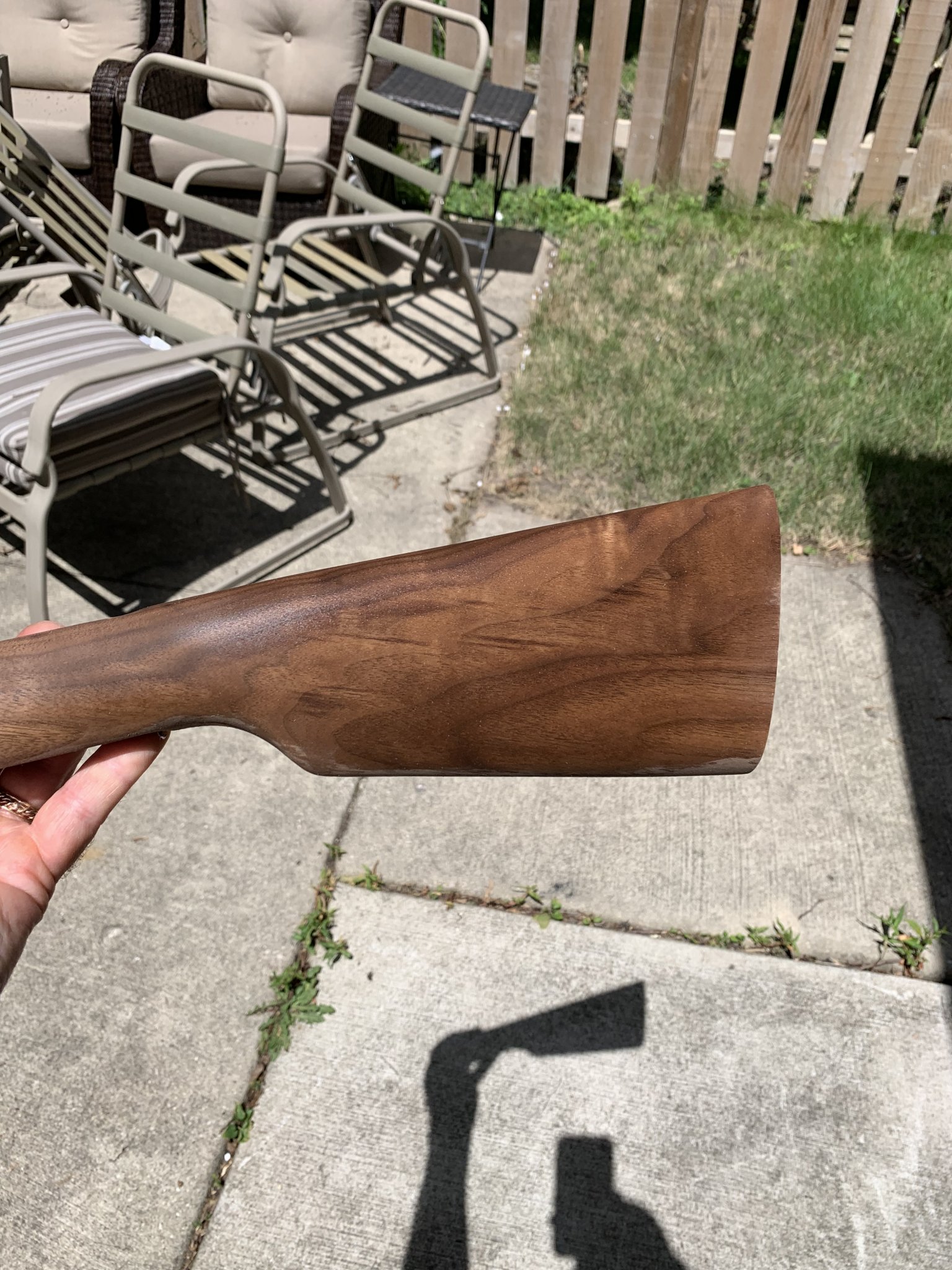

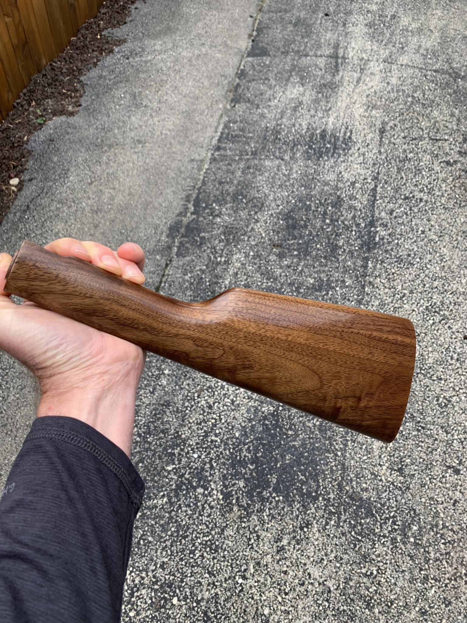

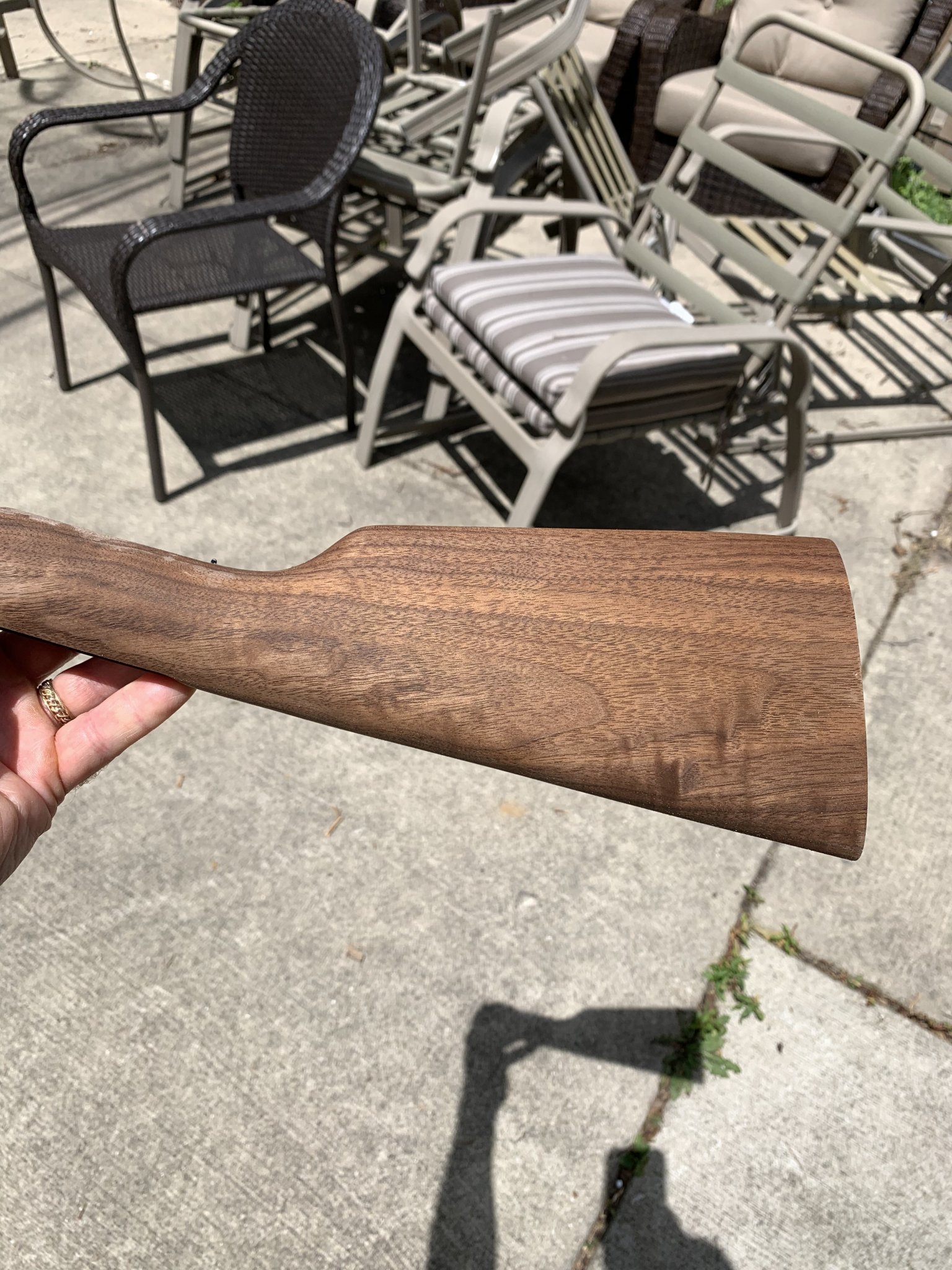

    Any chance you have pictures of how yours turned out with the tung oil?
    Sorry I don’t. Original wood was quite red., almost like they had some red die on it. After the tongue oil it was more of a brown and much richer looking.
    And I sold it during a lapse of sanity.
    I hope that lack of sanity is not contagious 🤣. I would mess with the original stock, but I hate that curved butt plate and it would be very short if I cut it out, even with a new pad.

    I Acraglased it yesterday. I sprayed the parts I needed to release three times with RAM225 and they thankfully came apart. I did have to use some persuasion with a rubber mallet to get the magazine tube out, but it did release. I did not wait 10 hours like the instructions said, but knocked it out after 5 hours when the extra mixture in the mixing bowel had set up. Here’s what it looks like now. Now I just need to strip the finish off this forearm and the rear stock and refinish them.
    I couldn’t get a good shot down the mag tube hole, but I’m happy with how it turned out. I had put a layer of blue painters tape around it so it would not be such a tight fit when I reassemble it. It turned out to have a tighter fit than the original stock, but loose enough not to be a problem when putting it back together, which is exactly what I was going for.
    On a side note. I broke the front band screw in the process. I called Rossi USA and they were useless. They couldn’t tell me where I could get one nor what the thread pitch is. Crazy. I’ll take the band to a local hardware store and see if I can figure it out. If not, I’ll recut them threads to something else to fix it. I can’t wait to see the face of the salesman in the local hardware store when I tell him what the band goes too; I’m 9 miles west of downtown Chiraq.
    Anyone know what the thread pitch is on that screw? An internet search was mostly a bust, one person said it was 6-32, but it was a old thread. I’ll start there I suppose. I emailed Steve’s, but haven’t heard back yet.

    I’d need to see pictures of it in sunlight before I can recommend a finish process.
    It’s walnut below the existing finish. The hand guard has a lot of the original finish left. The stock does not as I tried to strip it with High-Speed Ready Strip which didn’t work that great. It is the citrus paint and varnish remover one, but it sprayed out like a white gel and dried pretty fast, but didn’t seem to strip much of anything. I’ll probably have to sand it off unless you have another suggestion.
    I’m trying to get a hand oiled medium to dark walnut look. If the wood is dark enough without adding color then I would go that direction. I have pure Tung oil from the Milk Paint Company and I realize it could take 5-7 coats and about as many weeks to get it done properly. Perhaps there is a better way, I’m open to all suggestions!
    Citristrip gel. Apply it generously, and wrap in Saran Wrap for an hour.
    Use plastic scrapers to remove the majority of the finish. It should scrape right off, but if you run into spots that don’t, then don’t force it. Apply more citristrip gel to those spots, let it work it’s magic, and scrape.
    You should be removing 99% of the finish with the scrapers. Don’t heavy hand the scraping.
    Once all is stripped, let it dry for about a week.
    Then sand lightly. You should be able to start at 220. Use sanding blocks. All you’re looking to do is ensure the old finish is off, NOT CHANGE DIMENSIONS of the stock.
    Once done sanding, wipe it with water to grain raise. Probably not necessary, but doesn’t hurt. Knock all the fuzzies off with a 3M final finish pad. I do not use steel wool.
    Try some TRU-Oil in an unseen spot and see if that gives you the color you want. If so, then I’d recommend that finish since the stock isn’t highly figured. If you want to grain fill, then apply the Tru-oil heavy and sand it in with 400 grit. Sand with the grain at this point just to create a slurry. Once slurry is made, WIPE it across the grain. You may have to do this more than once….or just use Crystalac clear grain filler and skip all that shit.
    I usually do my first 2-4 coats with a 2:1 Tru-oil/mineral spirits mix. Soaks in better. Put it on kind of heavy, let it soak in for about 5-10 minutes, and wipe off. Let dry overnight. Just don’t let it get tacky before you wipe it off.
    Looks like their might be some nice color. Hard to tell with it dry. If you want it darker then it is now, then you’ll probably need to stain or dye it. A good mix for ho/hum walnut is 25/75 minwax gunstock/dark walnut. Gives it the more natural reddish-orange hue of air dried walnut.

    Here is what the stock looks like with water on it and yeah, it’s very smooth in the areas with no finish, not much if any of the grain has raised. It might have had the grain filled at Boyd’s. Not sure if the stripper will mess that up or not, but it has to be stripped anyway.
    View attachment 7921435View attachment 7921436
    That’s pretty close to what it’ll look like once finished if you don’t color it. Do a test spot on the stock with the oil and see if that is the color you want.

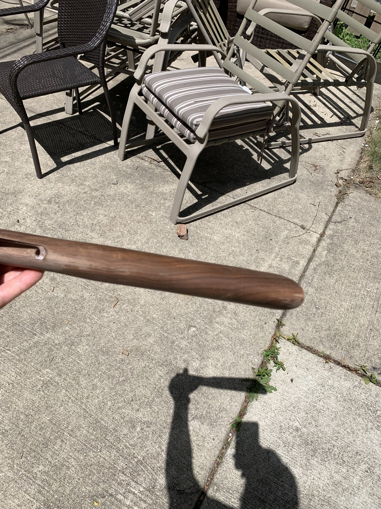

    Here’s where I am so far. I stripped the stock with Citra-strip with the suggested method; it worked much better. Sanded with 220, though it had 320, but didn’t, so I skipped on up to 400 then 600. I’m wetting it with a wet paper towel, letting it dry, then going over it lightly with a 3M final pad. I’m on the third iteration of that. Here are some pictures with it wet. I‘ll have to test the color, but I’m leaning toward the 25/75 stain mix above; it’s really brown with water on it and could use a little red tint and darling up. We shall see.
    Do some testing in an inconspicuous spot with the stain mix. The dark walnut stain is very strong so you may have to modify ratios.
    I’d also knock it back to 320 grit. I usually only go that high (600+) on the super oily hardwoods since you just polish those and don’t need a finish. For woods like walnut I only use as high as 400 grit for endgrain so it doesn’t absorb so much and end up darker than the rest.
    Looks really good so far though.
    Below is 100% minwax gunstock on a refinished mossberg stock:
    I’ll get some 320 and knock it back. I did notice it starting to kind of polish parts of the stock. If I understand you correctly, if I leave it like that, the “polished” areas will not absorb as much stain and the stock will look splotchy. Is that correct?
    That Mossberg stock looks nice! I would not have guessed it would be that dark from 100% Gunstock stain. Definitely going to do some test spots inside the hand guard. I‘ll grab some Tru-oil this weekend.

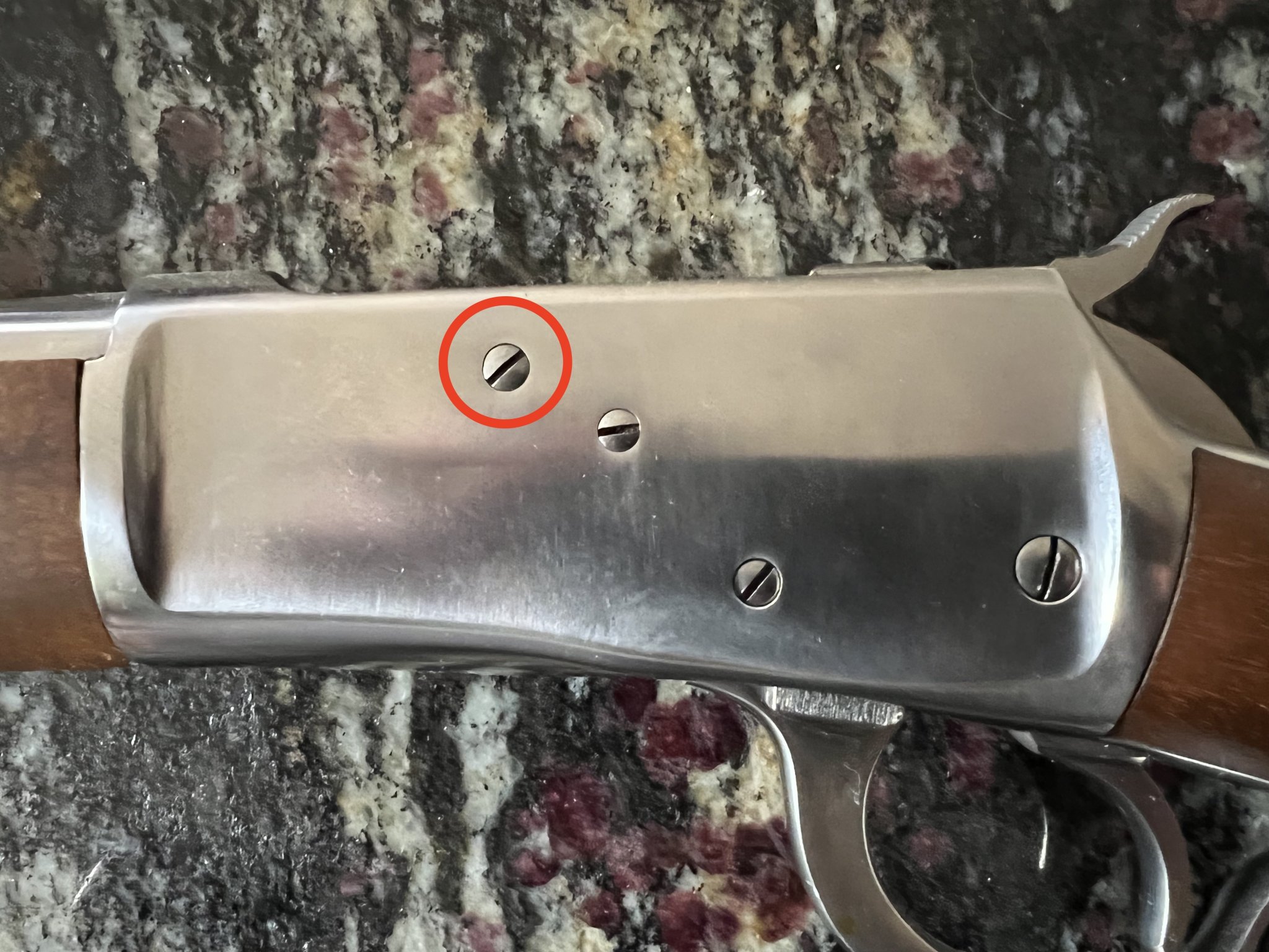

    In reply to your question about the missing screw on the left side of the receiver, it is a plug screw to alow acces to the pin that holds the lever in the bolt. There should be a punch hole on the right side that allows you to drift the pin out though the hole that the screw came out of.

    Update. I finally got around to putting the Tru-oil on the stock. I cut the first coat 2:1 with mineral spirits. I’ve sanded with 400 between coats. It’s quite glossy. The first picture is after the 4th coat; the second picture is the opposite side after the 4th coat and after hitting it with a 3M final finish pad. I’m wanting to get it to a matte oil rubbed look if I can. Even after the 3M pad it’s still quite glossy. I suspect I should continue to sand with 400 grit and put on more Tru-oil to build up and level the surface. Perhaps the gloss is coming from micro low areas due to grain, that the 3M pad is not touching.
    Reactions: Makinchips208
    🤣. That’s funny. Yeah the glossy stock makes it look like a kids BB gun; but it’s not.
    I’m a huge fan of gloss. Always have been.
    You could hit it with some 0000 steel wool. Now that a finish is on it, you don’t have to worry about steel particles being embedded in the wood. Wipe it off really well afterwards, and hit it with some paste wax.
    Reactions: KYAggie

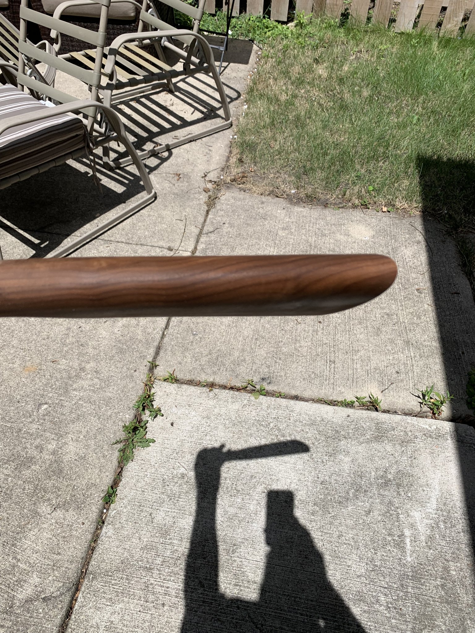

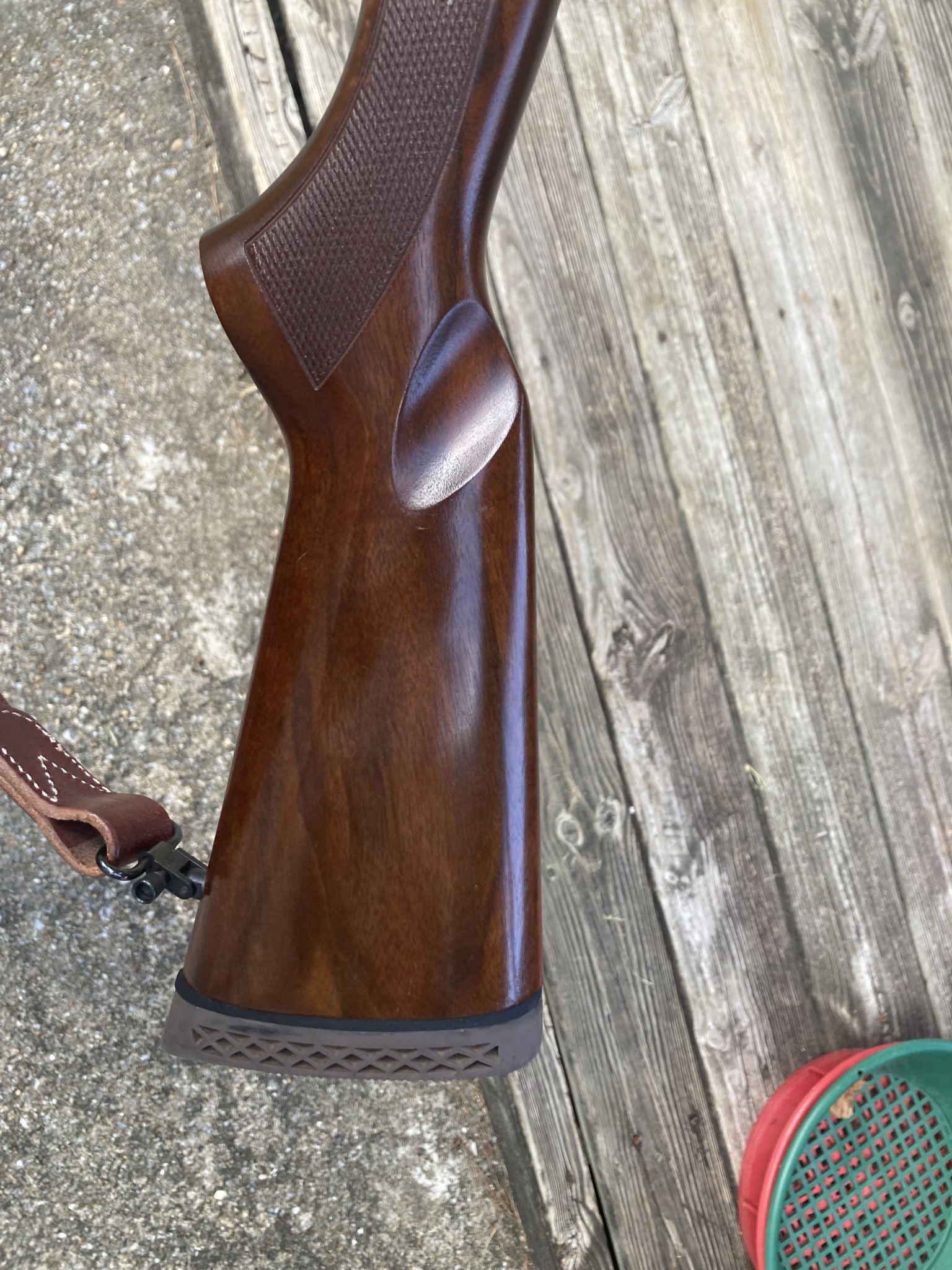

    Finally got it finished and put back together. It took 7 coats of Tru-oil. I then knocked the gloss off with 0000 steel wool and waxed it with Renaissance wax. I’m very pleased with the result, can’t wait to get it out to the range. It should be much more comfortable to shoot with the pad; it had a steel crescent before.
    My recommendation to anyone buying a Boyd’s stock for a Rossi is to get it unfinished even though it costs more naked. It’s worth it as the fitting that will be required will mess up the factory finish anyway and you will end up spending time stripping it. Besides, the finish I put on it is much betterthan the finish Boyd’s put on it.
    View attachment 7965582View attachment 7965584 View attachment 7965583
    Outstanding job!
    Reactions: KYAggie
    Outstanding job!
    Thanks! I certainly appreciate all your guidance, it was spot on. I learned a lot doing this stock and will be working on a Garand stock next.
    I worked on the action too. I can’t believe how rough the internals were. I used 400-1000 grit sandpaper as well as 200 and 600 grit lapping compound. It’s very smooth now and trigger is butter smooth.

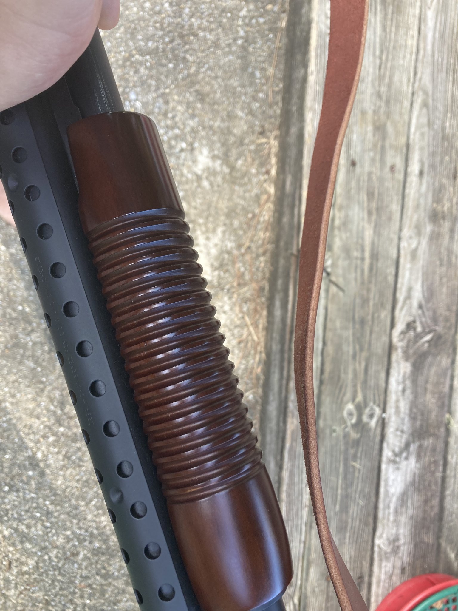

    Years ago I bought a beater 16 gage Ithaca Model 37 from 1947. I tore it down and sent the metal to get reblued and re-did the furniture with Tru-Oil. It turned out just as good as yours.
    I always thinned the Tru-Oil for every coat that kept the shine down.
