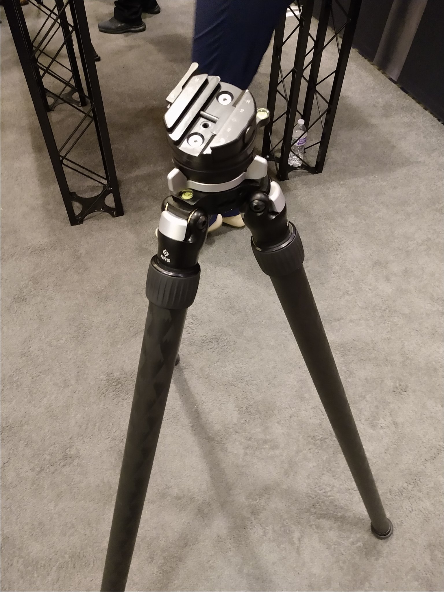

Picture from Shot, taken from another thread.
Twist lock on top, legs inverted. Ill have a video in a few days for the listing and can add it here.
First prototype the size has changed a bit to be shorter.
it can not take the tfct apex. Tiwst locks would not allow the tripod to shut fully since they are on top. This will accept the anvil with the 2 series platofrm adapter. The anvil is what is currently holding up all our orders. We attempted to make it a perfect sphere which has been biting us in the butt, as it is very difficult. But end product will make the feel better

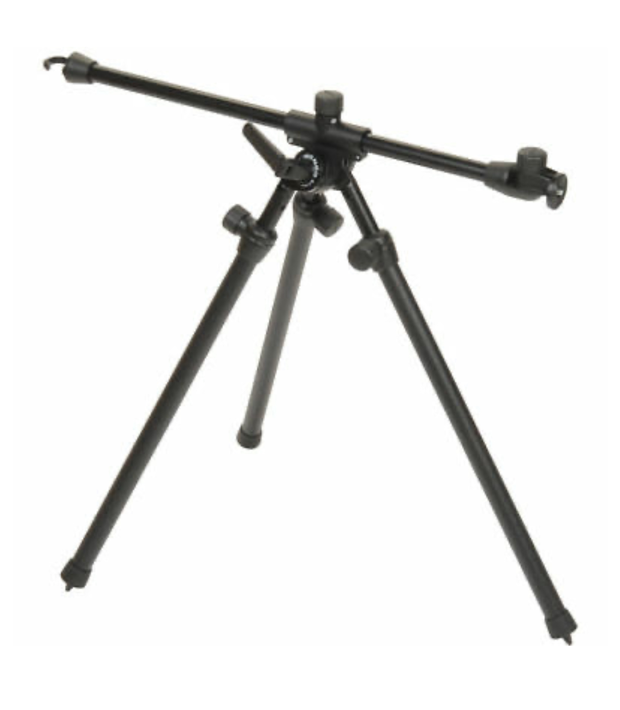

Inverted legs, by which I think RRS is meaning the big outer section of the leg slides down vs littler sections of leg sliding down, remind me of the Benbo tripod and Atlas bipod legs. If sealed, they work great even if submerged.
Not sure if it’s still made, but the Benbo was designed off of a machine gun mount.
It also had just one handle to adjust leg angle and center column height, which could cause accidents in unfamiliar hands.

What parts/adapters would I need to run an RRS ballhead on this and which ballhead would work?
I believe this is what you’re looking for...
The tvc-22i, has the versa apex. So it will come with a platform installed that has a 3/8”-16 stud. So any ballhead will go on it. You can remove the platform and get the anvil 2 series platform adapter for a more secure fit with the anvil instead of just the typical threading it on. You can also put a 2 series center colum in its place or if you can find a 2 series leveling base that will fit in as well. Sorry for the confusion of the video.

I realize this is a bit of an open-ended question, contingent on a number of variables with angles to target, etc., but would the TVC-33 be more versatile with kneeling and seated position heights, as compared to the TVC-22i? (Occasional hunting without any *extreme* angles, but mostly PRS and rear support type stuff.)
The max heights in all positions with either model will appear to work fine for me (5'10") but it seems that the minimum height on the 22i in positions 1 and 2 are a bit too tall for kneeling or sitting with the rifle clamped in. (Again, I realize angle to target, ground etc., will affect this, but at least with the TVC-33, the height can be raised from the minimum if too short.)
I like the quicker deploy time of the 22i with the single collar and the inverted legs, but I'm heavily vacillating between the two and wondering if I'll be better served for overall usage with the 33? (Plan to have both the leveling base and anvil heads as well.)
Thank you for any advice/direction.
Reactions: Aceteck
Your right for shorter people on the 22i. But if you just open up one leg into the second angle position it should be good for much shorter people. This would be fast and easy in all matches except if the space was very tight like a bunker. In that case I would extend that longer leg to be directly back to me and just sit on that, so it doesnt take up extra room. You still may have enough angle with leveling bases to be good but itll be tight depending on target location.
