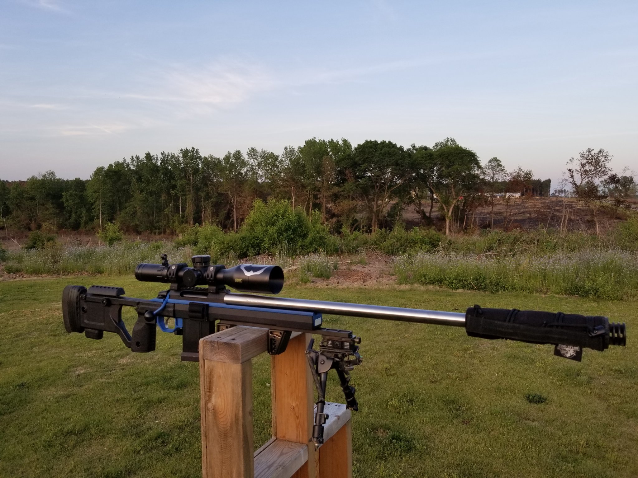

I swapped out the picatinny system on my chassis with an ARCA system. Zero regrets.
yup, arca is looking good...been running the RRS bipod mount that can attach to both pic and arca so that my atlas bipods are still usable on all my other rifles that arent setup with a full arca rail, and its been great
Yes, Arca is the way to go. Full length cut on an MPA chassis combined with a RRS clamp and bipod adapter. Let's you quickly push the bipod close to the mag well. With a small rear bag under the grip handle of the MPA and the bipod slid all the way back you can go "prone" on obstacles as short as 12 inches.

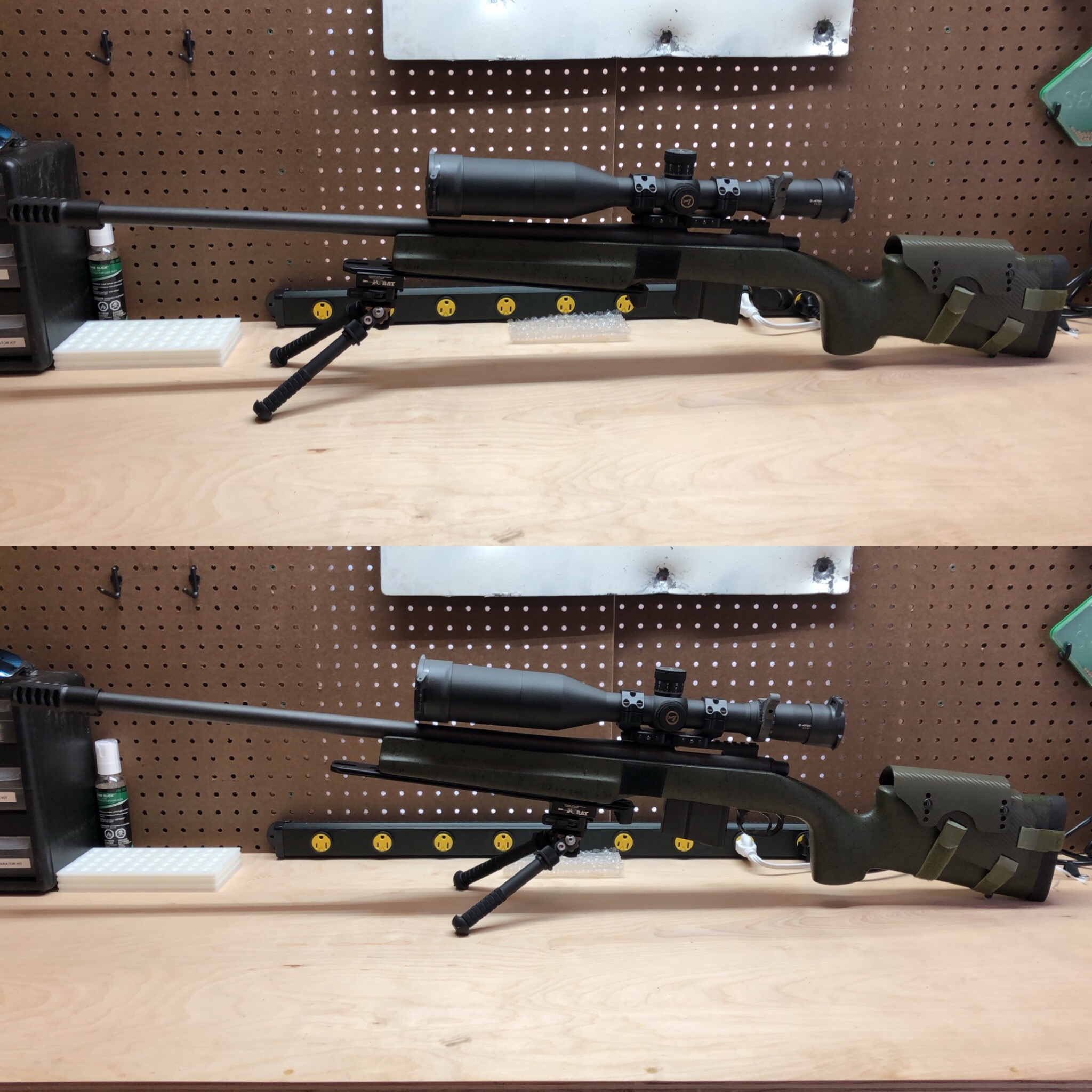

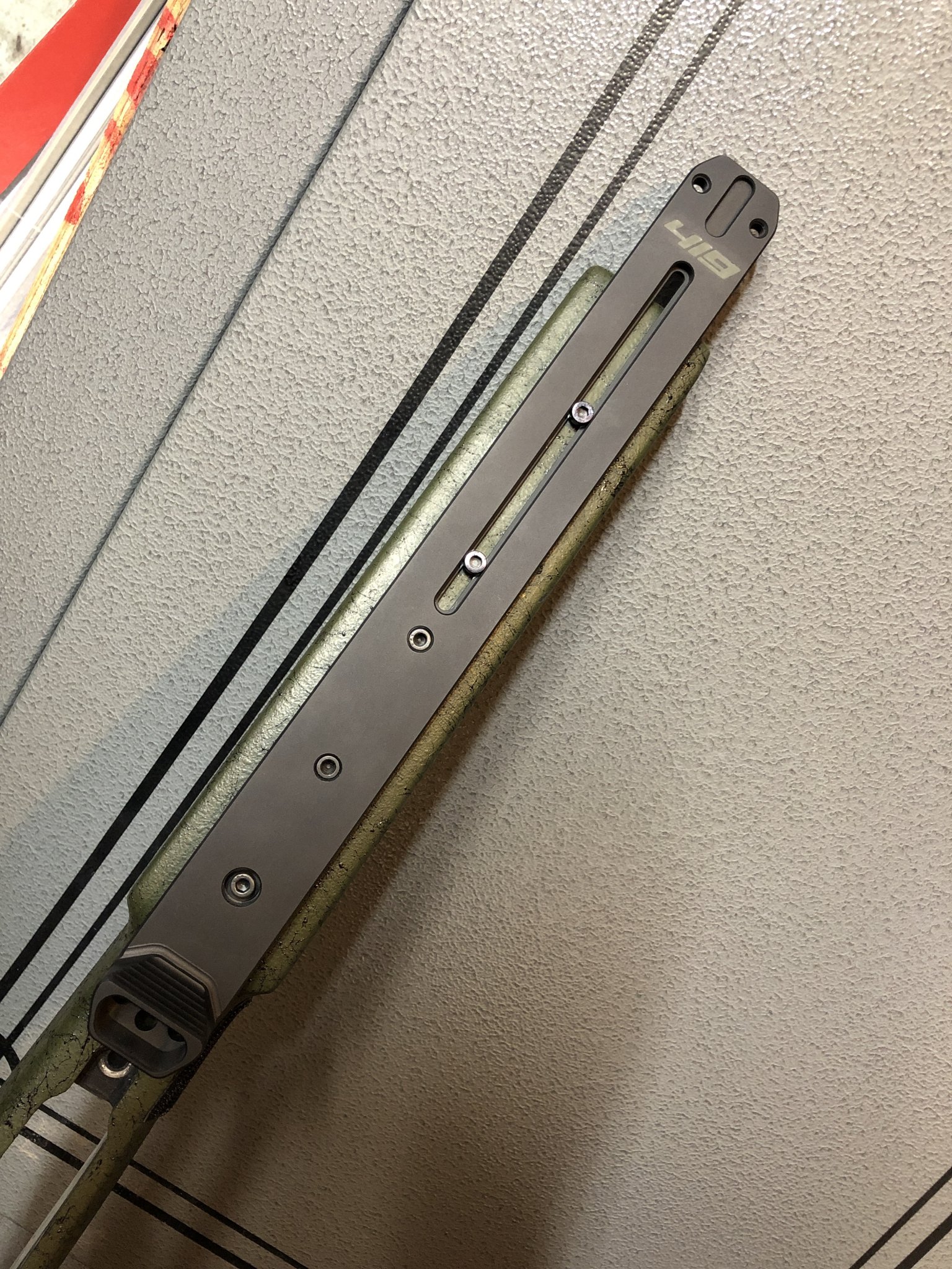

I just attached the Area 419 Arca rail last night. Haven’t got to use it yet but it’s very nice for the price. Any Arca attachments will work so I can use my MPA RAT system stuff with it.
Can the arca rail be inletted into a stock so that it doesn't stick out. @kabarNC, how does the bipod feel? Is there a lot of play or is it rock solid. If there is play, once you load the bipod can you feel any adverse movement?
I think the rail could be inletted a bit, but a little would still have to hang out the bottom of the inlet so the barricade blocks could pivot freely. And its not an arca rail per se, this rail itself is only 7/8ths in. wide.
Bipod is dead solid, zero play in it from this rail system.
Here's a little better shot of it. Super impressed, for me, on a barricade, it's way faster and more stable than using a gamechanger.

Area 419 makes an m-lok compatible arca/dovetail rail.
