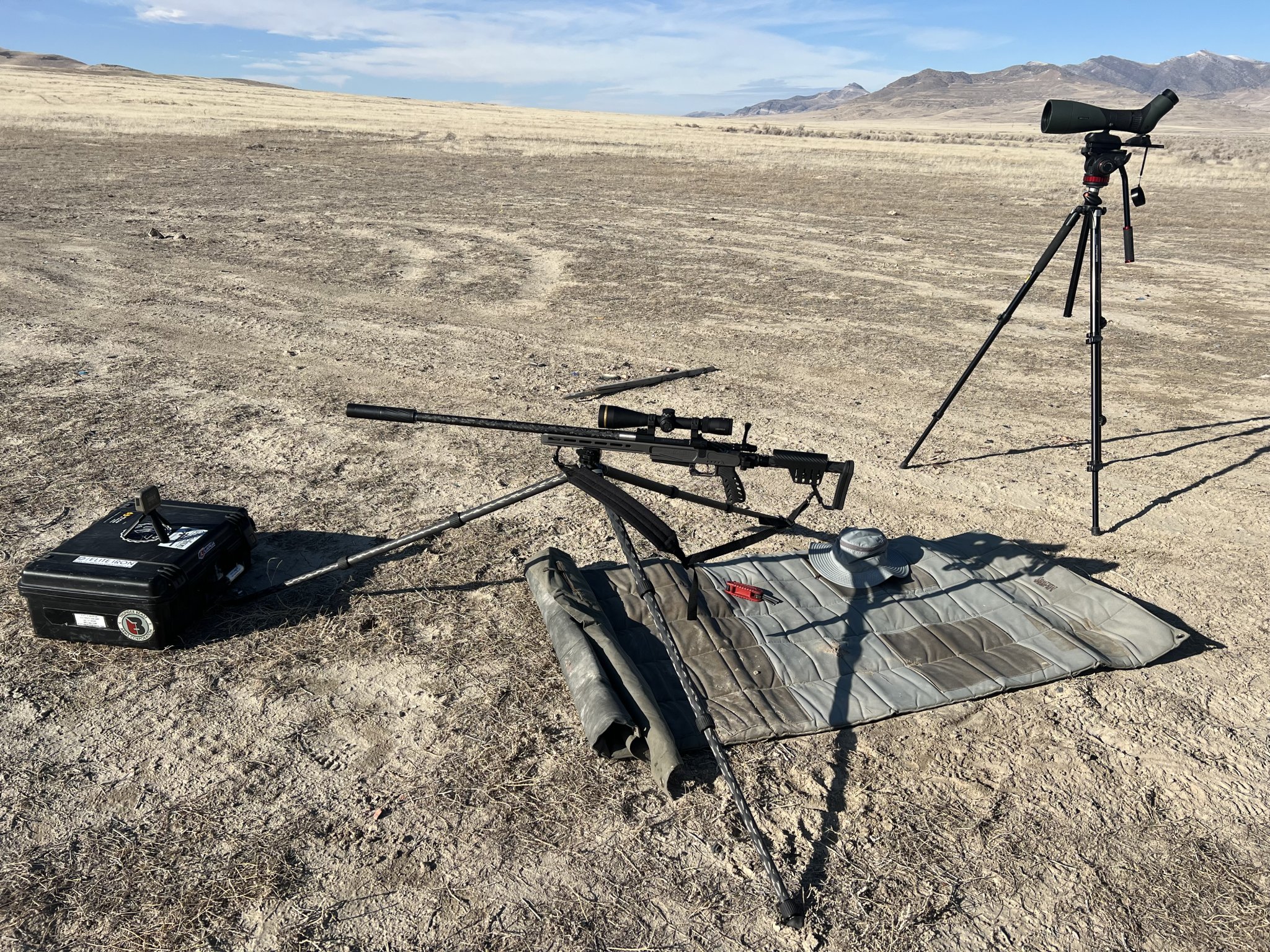

    I have killed a few sheep off of 33 legs and a anvil. A couple seated and 1 prone. Sure lighter is always nice. But this is very stable

    I left my 3.6lb set up at a trailhead in Oct, but had the Leofoto 324 legs and an Anvil and took it on 3 backcountry hunts this fall.

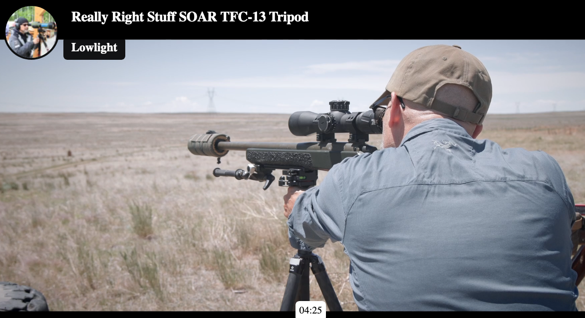

    They offer it now in a factory configuration with an anvil 30 head and no center column. That’s how I think they get to 3.5 pounds.

    @vanrichten The TFCX13 was made for the minimalist backcountry and we offer packages that resemble legos in the way you can put them together, only limited by your imagination. I like to take the TFCx13 and hard mount the anvil direct to the apex with 4 screws rather than the 3/8" removable stud (since the new style apex has a slight taper built in, the feature just like the tfct). I set that up for my comfortable seated shooting height. I personally put a quick release plate on the riser which has the PT Scout threaded to the top which brings me to my spotting height with straight eye piece spotter or binos. The Anvil is used as a leveling base, allowing me to be correct on plain when glassing, then if I need to switch to rifle, one lever of the anvil removes the glass with riser and PT-Scout attached, and I go direct to the rifle without having to fart around with anything else. It is a light weight system where i can be comfortable at all the heights i need without having a dedicated center column in the way.
    I ran a rrs tfct 33 for a 2 day elk hunt in AZ. It was 16 miles in 2 days and it didn't bother me. I would rather have stability that save weight. But I also had a 14# 300wm that all my hunting friends said would be WAY too heavy and it didn't bother me. As a matter of fact I carried the tripod, my 14# gun and my dad's 12# gun most of the trip cause he was having a hard time hiking. It's just personal preference.
    I looked at it like this.... I shoot 2 day nrl hunter matches with a 16# gun, two vets QDT, and more ammo than I would ever cary on a hunt

    I’d pretty much decided on the 14L for my purposes, until i saw the tfcx13. That height works for me (only 5’8). Shave .5 lbs off, I’m sure if it’s on the soar side of the rrs site, it has a load limit capable of a sub 10 lb rifle. Though the bigger tripod will be more stable. How much so, who knows, enough of a difference to make the shot presented? Last couple of years, I’ve been packing and shooting off a cheap as shit Sirui thats 1/2 the weight of the tfcx13, anything has to be better than that pos.
    I have to decide if the additional options of positional in terrain/stability are worth the extra .5 lbs for a successful hunt outcome, or can I make the smallest option work in the environments I hunt and shoot in? At least the pack gets lighter day by day until you're successful… I really haven't noticed .5lbs once pack weights get over 80 at that point.

    Yes I use both. Your determining factor, do you care about weight more or the ability to stand. Once you answer that there is your question. I do not feel wanting when carrying the 14L through the mountains on a long hike or short one. If there are a lot of unknowns it is what I am carrying no matter where I go.

    Yeah we’re gonna be testing a bunch of stuff in the Utah desert ranges leading up to the hunt.

    Well, I learned today out in the desert that the 14 L is fine for kneeling and seated on a 6 inch target to about 450 yards and it is fine out to 750 with a 10 inch target
    I was actually really surprised how good I did and the Mrs. are all within an inch or two off the edge of an 8 inch target almost all due to wind. And I didn’t have anything to stuff my backpack with so this is with no rear support other than my elbow on my leg
    This gives me the confidence to move forward with a 14 L for a backpack Hunt
