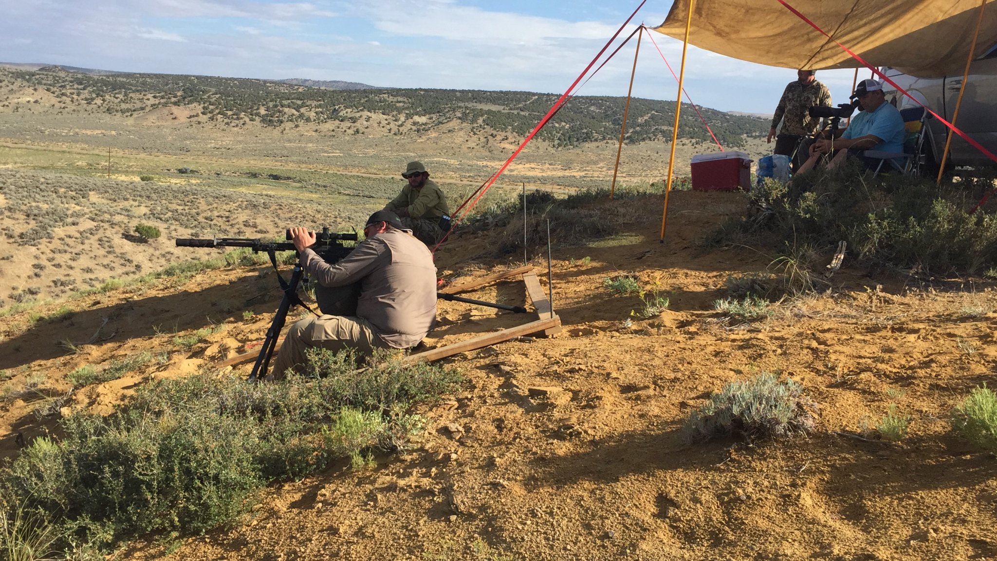

Picture below shows the tripod position I feel the 22i wouldn’t always be able to adjust to depending on how short the front legs need to be to fit the terrain
