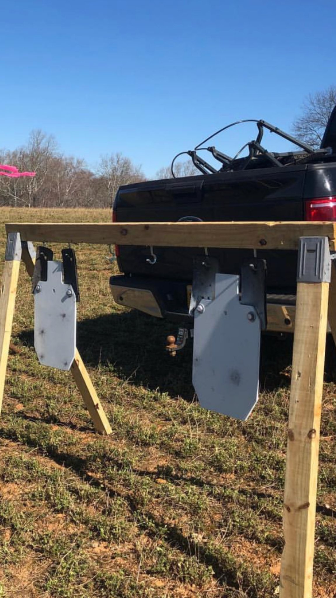

I've seen a few threads asking about various ways to hang targets. I even sent a few people some straps we have free of charge. But if anyone wants to be able to buy them here you go (we'll run out eventually and need to save some for ourselves). just take the through bolt out and you have 16 pcs for $28.
they hold up extremely well to impacts, and already have holes in them. get creative on mounting them to the plate/hanger

was going to go that route, but then I would have to cut it to size. then we found these straps which are almost the perfect length already and have the holes. ready to go! but yes I've been told the fire hose works well
