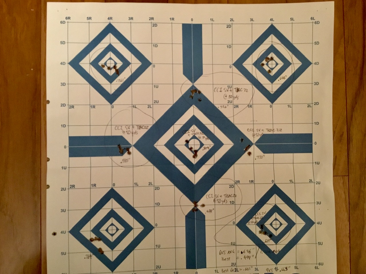

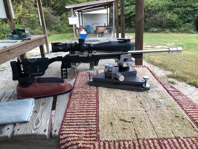

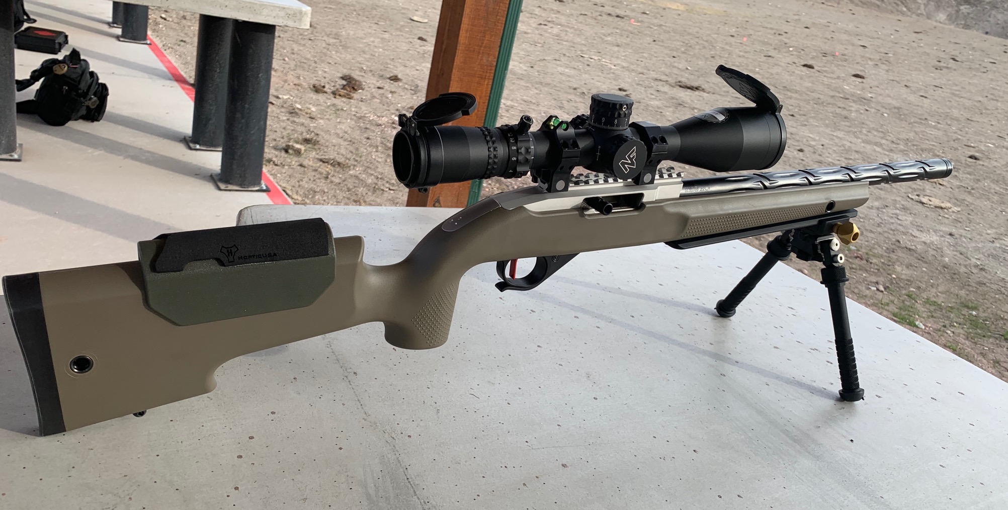

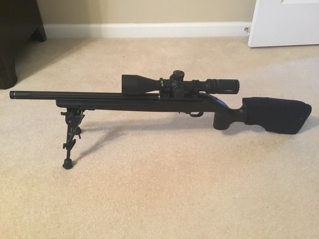

When precision rimfire matches were getting started locally, I only had my lightly modified Ruger 10/22 to use so I that's what I used and made adjustments as necessary. I did decently that first year and since then I've done pretty well with that 10/22, last year I placed 2nd overall in semi-auto division and 9th overall this year with a match win. I think in good hands they're a capable system and to date I haven't gotten any grief over the safety on to move issue. Basically, don't be a doofus while handling the rifle and it's likely they won't say anything at all.
My 10/22 is pretty simple and some say it shouldn't shoot as good as it does so your mileage may vary.
Stock Ruger 10/22 Receiver
Volquartsen bolt (price table pick up)
EGW 20 MOA base
Ruger BX Trigger w/ Volquartsen auto bolt release
Green Mountain 18" .920 barrel
Volquartsen V-Block
Volquartsen action screw
Victor Company Titan 10/22 stock w/ cheek piece
Nightforce 3.5-15X50 F1 in Burris XTR Signature rings.
I shoot Eley Force primarily but SK Long Range does well too.
So, if you have the 10/22, it may be worth it to build it out and use to get your feet wet and decide which direction you want to go.

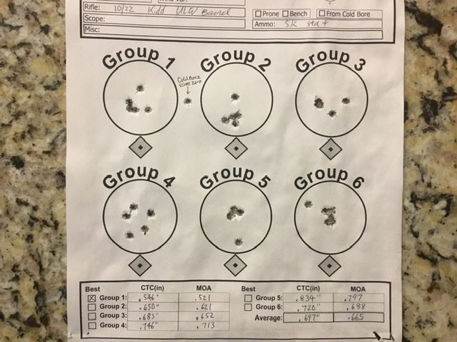

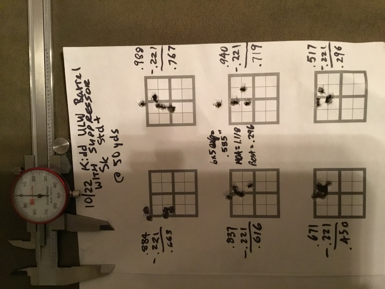

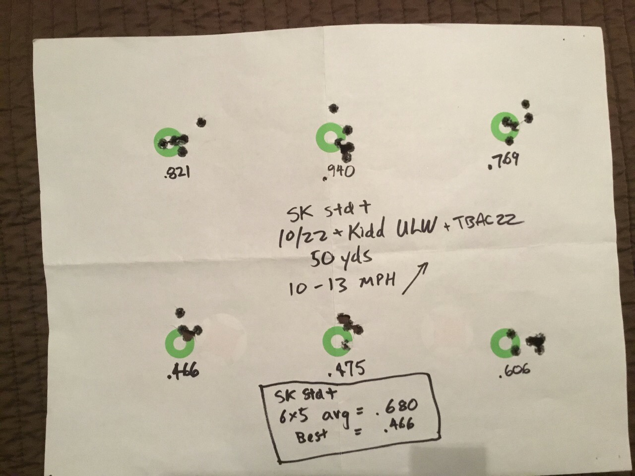

First would be the Kidd barrel, you have a receiver, trigger group, and bolt assembly. I would get a Kidd guide rod and springs. Do you have extended mag release? if not get one. Chassis I would go with a Titan.

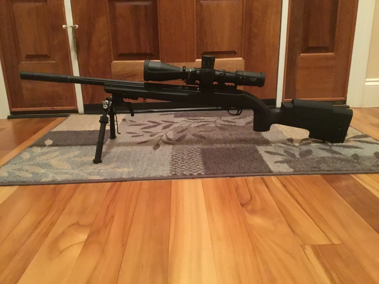

I built a few 10-22's. I had a Kidd 2 stage and a titan stock on one of them. I finally ordered a Kidd Supergrade barreled action. moved the trigger and put in the Titan stock with Titan's rear anchor.
Go to Kidd's site a add it all up before start going down the 10-22 rabbit hole. for just a little more you can get the best.
Or you can get a Tikka T1X for less than $500. Shoots as well as my Supergrade.
Mark
Mark

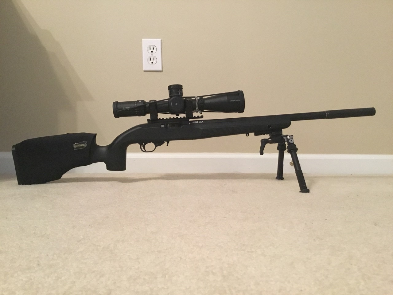

That would look a ltttle like this

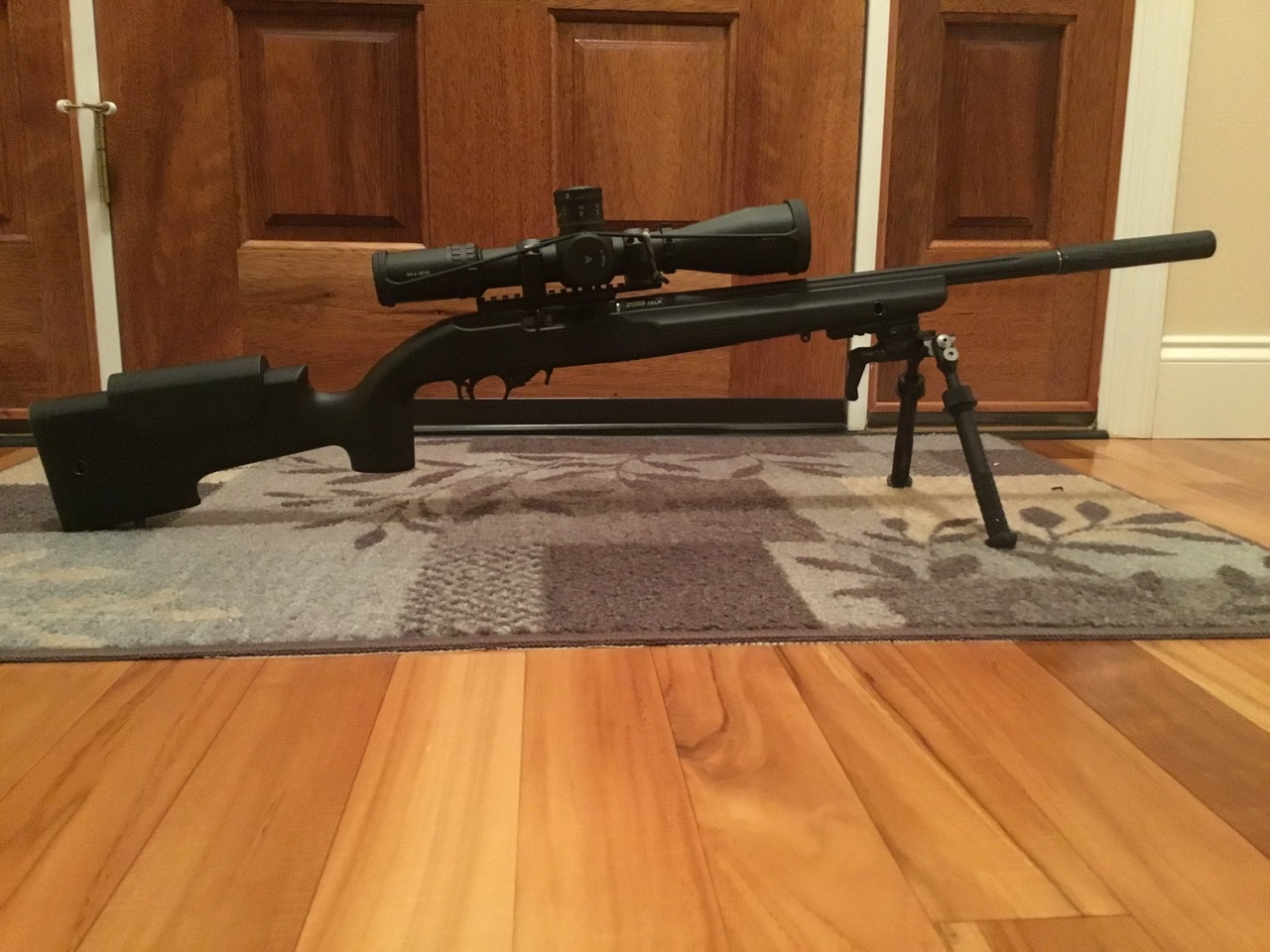

I have ran 10/22's since the inception of the NRL22. It was, but it's not a competitive platform in open class anymore. You can be in base until you move up. Then it's Rim X and Vudoo territory, of which I am currently building a Rim X.
I have four 10/22's, from a stock rifle to a heavily modified TacSol receiver. The main parts to change out are IMO:
1) Bolt release (Factory lawyers should be kicked in the nuts)
2) Barrel
3) Trigger (KIDD 2 stage is awesome)
The 10/22 platform suffers from mag issues and first shot flyers. I've done a ton of tinkering with the first shot flyer thing and it was never solved. My opinion is it stems from the seating difference from the NRL rule of chambering the first round via spring vs recoil loading.
If your just starting off, do what the above poster said and get a Ruger Competition model that will allow you to shoot in BASE CLASS. For the investment and being a factory configured option, it's hard to beat. Have built 3ea 10/22's, one for NRL Open and most times I can't outshoot it. If RSO has issues verifying the safety then they could be a personal prejudice. I prefer the semiauto for uncomfortable positions.
With the December Match I still timed out the same as the bolt guys did but the weak side stage was pretty quick just by pulling the trigger vs a more awkward bolt manipulation.

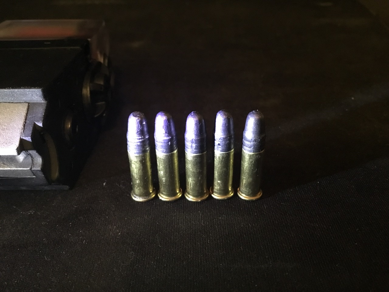

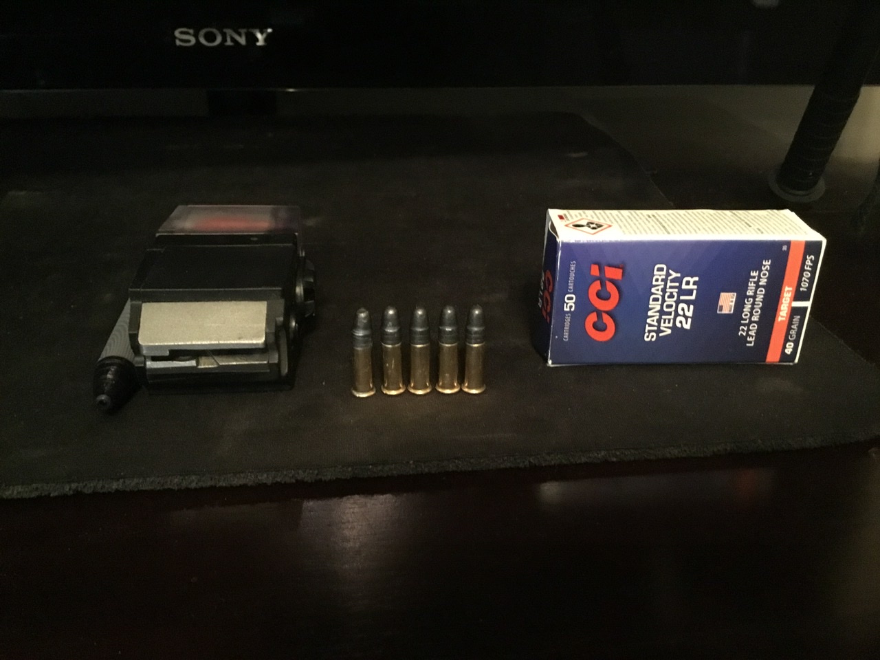

Interesting point on the closed vs open chamber loading. I agree that less change in feeding the cartridge will improve precision consistency.
Although it will chew up time, I am unaware of any rules prohibiting releasing the mag, closing the bolt, re-inserting the mag and racking the bolt after the beep.

I ordered one of Joe Chacon's custom 10/22 builds; the only Ruger part on it is the 10 shot magazine.
It has the following...
Tactical Innovations stainless steel receiver with built-in Picatinny rail
KIDD 2 stage trigger
CST Power Custom bolt
24" Douglas Barrel
Joe's own J&L Tuner
Accurate Rifle Systems chassis stock with their vertical grip
At the time, I ordered the rifle to shoot KYL matches to save time over a bolt gun since the matches are timed but ended up using it to shoot ABRA targets off a bench since it's very heavy and is very accurate.
My next rifle will be either a Vudoo or RimX though as I like them a lot too.

I enjoy tinkering and find enjoyment in building something that can punch above its $$ class.
Pending barrel delivery, assembly, break-in, and precision testing.
Rifle:
Kidd 16.5" fluted & threaded barrel - $185 (used)
Victor Co Titan22 stock with Spike rear anchor, front Picatinny rail, cheek riser - $259
Stock Ruger receiver and bolt - $235 (10/22 Scout model not used much)
Stock Ruger trigger pack with Volquartsen Target hammer and spring - $38
Bubba'd auto bolt release mod and nylon rear bolt pin - $1
Total 10/22 build - $718 (minus ~$80 recouped cost of selling original stock and barrel? guestimated total ~$638)
Optics:
temporary: Arken SH4 6-24x 50 gen 2 to test accuracy/precision + Arken 34mm medium rings - $459
long term: depends on the outcome of the accuracy/precision tests - $???
More to follow.
YMMV and happy shooting
Range update:

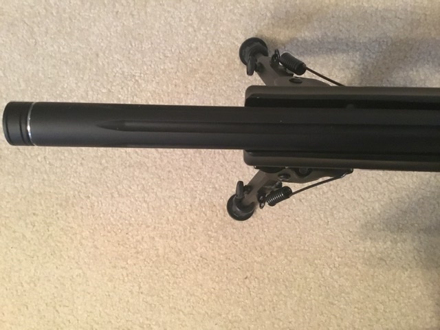

Kidd ultra lightweight barrel 16.5” threaded, Titan22 stock, Primary Arms 3-18x 50, UTG bipod
Prone with bipod and rear bag @ 50 yards, 4-8 MPH winds from 1 o’clock. 45 F climbing to 57 F.
Shot various ammo for function and getting used to the ACSS reticle on a scope I took off on a Ruger American Predator 6.5CM. A few stove pipes initially, but zero after the first 100 shots. Total rounds 250.
I followed the Kidd website instructions to clean the shoulder of the receiver and removed the paint there. I also Scotchbrited the overspray in the inside of the receiver.
The barrel was chilled in the freezer overnight and the receiver heated with a hairdryer for 2 minutes. With just a small amount of anti-seize, the barrel slid in 1/2 way with some firm pressure. The extractor alignment and v-block and receiver were leveled and aligned. Then 3 firm whacks with a rubber mallet seated the barrel nicely.
The Victor Co Titan22 stock is sturdy but light. The rear flush cup sling points rattled, but a dab of superglue fix the minor annoyance easily. The Titan22 spike receiver anchor was easy to install and there is zero teeter-totter or lateral movement after installation.
After assembly, the safety, bolt catch, magazine release, and dry fire worked flawlessly. Upon inspection of the barrel, it does not sit perfectly aligned to the stock’s fore-end. I looked at the Victor Co website and this is a known issue related to the receiver barrel mounting hole on the Ruger 10/22s. The barrel is still free floated and passes the dollar bill test, but if I did it all over again, it may be worth getting a Brownell receiver and building off of that. In my sample of 1 for the BRN-22 takedown, the anodizing is much cleaner than the black paint on the Ruger along with excellent machining and tighter tolerances.
Below are some photos of how she sits today. Please excuse the Beartooth neoprene cheek riser. I will likely upgrade the scope and bipod and I did not want to drill and mount the Titan cheek riser until I get an extended rail set up for the right eye relief. Current weight = 8.08 lbs with balance at the magazine well.

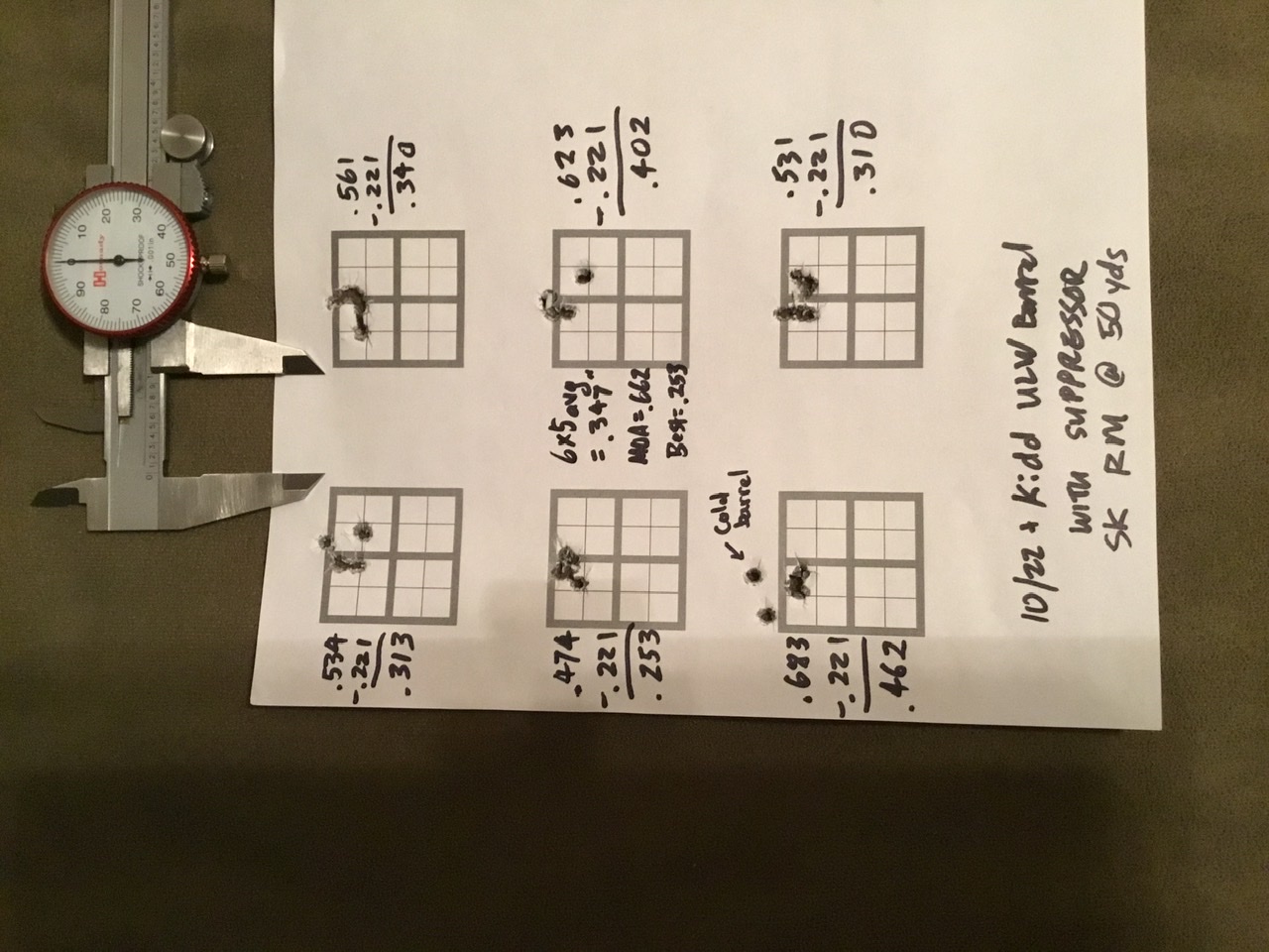

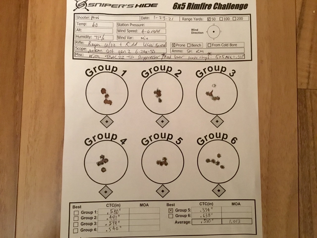

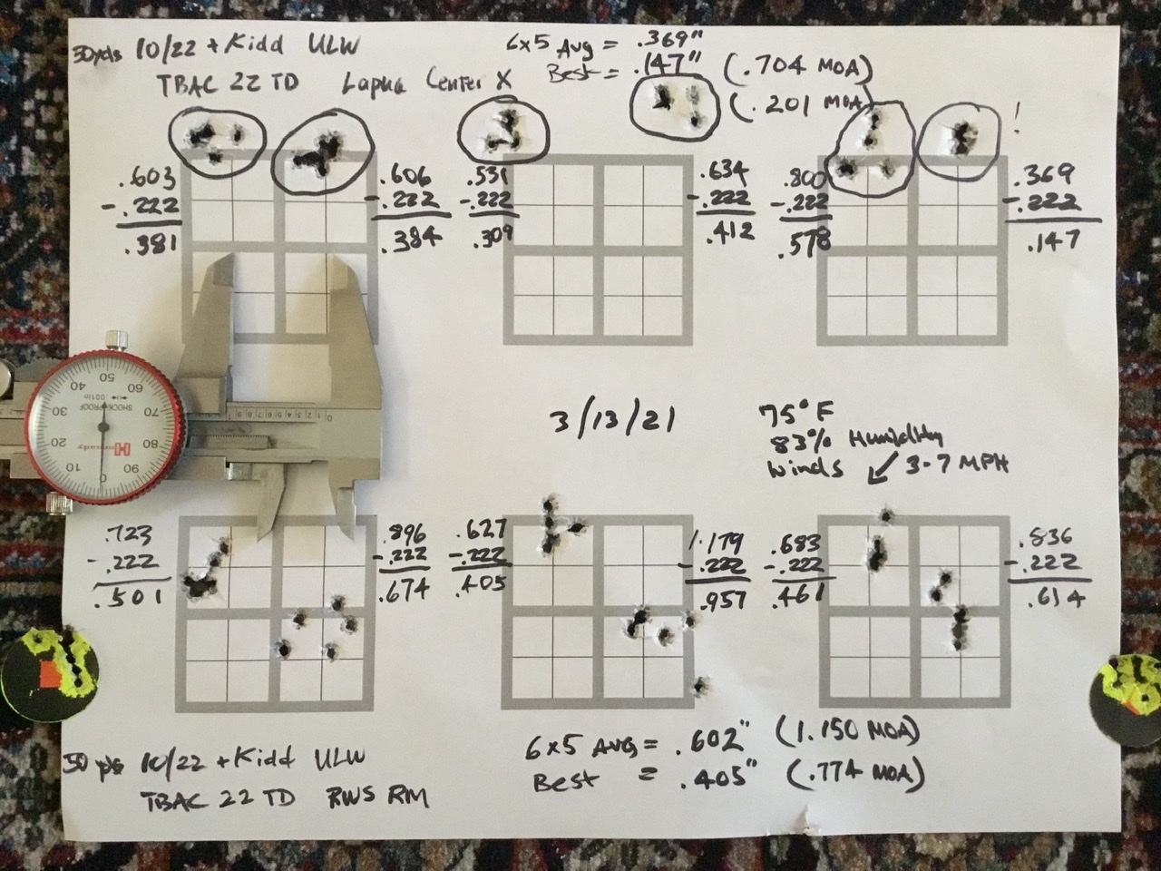

Below are the groups while seasoning the barrel and also the best cherry picked groups of the day.
Promising groups, and easy to stay on target for follow up shots. I was able to see 75% of the shots drop in.

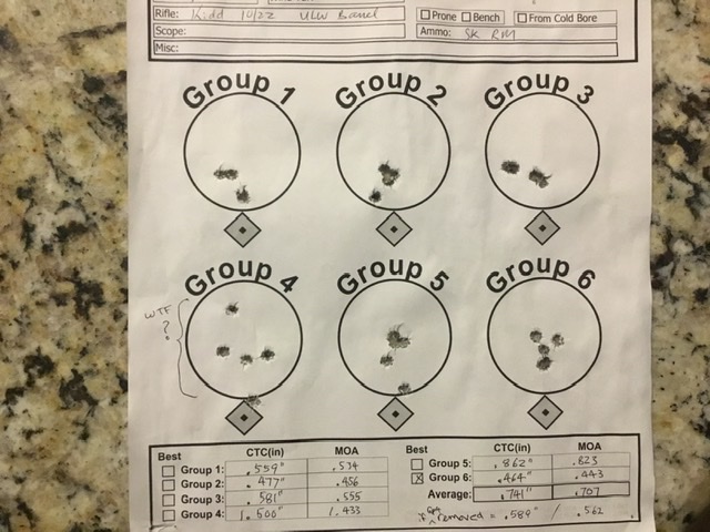

3rd best group: SK rifle match, 6x5 avg = .741”, best = .464". (disregard MOA numbers... I forgot to multiply by 2) This was the middle group of the day. Took a break to let others set up targets before group 4. Cold bore or cold shooter, either way group 4 was a hot mess. If group 4 removed, 5x5 avg = .589”
Runner up: SK std+, 6x5 avg = .697”, best = .546“. (disregard MOA numbers... I forgot to multiply by 2). This was the 1st 6x5 group and I was getting used to the rifle and the ACSS reticle. I was not using the chevron to best effect, but starting to get the hang of it by groups 5 and 6.

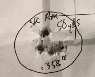

Best groups of the day: Last groups shot, figured out the best technique was to hold the ACSS chevron on the apex of the big diamond, and hold the .2 mil dot on the small black diamond. By this time, fatigue was settling in and winds picked up (as seen by the more horizontal stringing). 6x5 avg = .685”, best = .515”. (disregard MOA numbers... I forgot to multiply by 2). Less group to group variance compared to the SK RM and Std+.
Beautiful day at the range. I learned a lot about how capable this 10/22 with Kidd ultra lightweight barrel and Titan22 stock can be. The stock Ruger 10/22 scope rail isn’t set up for optimal eye relief, so a EGW extended picatinny rail with 20 MOA is on order and a scope with a center dot reticle and more magnification might shrink the groups. SK RM probably has the most potential as it had multiple sub .5” groups and would likely have had the the best average if there wasn’t a break in the action after group 3.
Reasonably accurate/precise and fun rifle for ˜$700 + time invested. Let me know if you have question. More testing to come.
YMMV, happy shooting
(edited for wrong MOA calculations, should be twice the listed value)
Reactions: Sagittarius

1-23-21 Range update
Received 2 goodies on Friday.
1. TBAC 22 takedown released from jail
2. EGW 20 MOA rail arrived
Mounted an Arken SH4 6-24x 50 and went to the range to zero and shoot 6x5 with and without the suppressor.
Temp ˜60-62F, 4-6 MPH winds from 2:30, humidity 71%, overcast with occasional drizzle. CCI SV and SK RM shot prone with a bipod and a rear bag.
Warm-up and scope zero required more shots than normal since I can’t boresight it like normal. The left edge shows the initial impacts. I was dialing up and down and wondering where the flecks of paper were coming from. Against a white backing, it was nearly impossible to see, but once I saw it, zero was easy as measuring with the mils with the reticle and dialing accordingly. The 1st group after finding the left edge holes were the large center diamond. The diamonds without annotations were the shot without the suppressor. The 6x5 (best 6 of 9 groups) resulted in avg of .601” and best group .499” with the newer light blue box CCI SV. I am pleased to find a cheap practice ammo that I have in reserve.
Next target, 6x5 group with SK RM + TBAC 22 TD. Most consistent groups of the day with 6x5 avg of .530” or 1.013 MOA. As I get used to the scope and rifle, I have hopes that it’ll tighten up. Although KIDD does not guarantee 1/2 MOA groups at 50 yards for their ULW barrels, I‘ll say that it’s certainly possible. I fell apart on group 6, after seeing group 5.
The group without the suppressor shot very well except group 4. Coulda-woulda-shoulda, I need to find a more comfortable position with the rifle setup as the medium Arken Halo 34mm rings are too high. 6x5 avg=.584” and the best group of the day = .270"
Observations:
1. Keeping solid fundamentals on a 22LR bolt action was a bear, but the 10/22 takes it to another level. Humbling experience.
2. A 8.1 lbs rimfire is a joy to shoot, balance point can be better, but weights can be added as I fine-tune this setup.
3. Scope rings are too tall. I don’t like a high bore axis and I'd like to drop it by ˜.375”. I had to slightly lift off of the stock for a clear and full sight picture and now my neck is paying for it. Arken Halo low rings on order. At least the eye relief and magnification power was sorted this time.
4. I didn't notice significant differences in group sizes with or without the suppressor. The groups with suppressor looks more uniform, but I may be hallucinating. More testing needed.
5. I believe that sub MOA 6x5 groups at 50 yards are possible from a bipod and rear bag on this rifle. My goal is to shoot a 6x5 <1.5” at 100 yards.
6. The KIDD barrel shoots CCI SV surprisingly well and I will use it as my practice ammo. I will also test Aguila RM and Fiocchi SV to see if this barrel can shoot a variety of cheap stuff well.
7. Rimfire precision is addictive and fun.
8. I’d appreciate your comments and suggestions on how I can tighten up my groups.
Thank you for following, YMMV, happy shooting
Possibly, but there is no way to correct. NRL rules require open bolt starts.
This has cost me countless first round misses on small targets.
Thanks Ruff. I'll have to keep an eye on the 1st round shots in the future but I did not notice it on during the 6x5 shoots.
I also cycled some CCI SV from the magazine and observed That only 2 of 5 extracted, likely from the tight chamber. But what I also noticed were some deformation on the top of the driving band and the vertical scoring. Since the 1st round would not be subject to the same vertical scoring, could that be the cause of the dreaded 1st round flyer? Tests out at 100 yards once I get the lower scope rings.
It's possible. It was concerning enough for me to hang that rifle up for NRL22. It is just not competitive any longer in open class.
I also had live round extraction issues from time to time with CCI Standard. I usually just shot that round into the bank to clear.
For anyone having trouble with chambering certain ammo in 10/22 rifles and clones...
Try SK ammo which is naturally oily or put some drops of oil on a rag and shake up ammo like CCI SV and others until it's oily and then try shooting it in your rifle as Clark Custom Guns recommends.
If you continue to have extraction issues after 200 rounds, order a replacement Volquartsen extractor/firing pin combo and see if that resolves your issue. (it did for me with my Ruger custom shop rifle)
I've heard those 1st round fliers can also be caused because the first round of every magazine is naturally loader by manually chambering the round with the charging handle which does not impart near as much force as subsequent rounds from the magazine when the bolt slams them home upon the rifle being fired.
Not much you can do about it (first round) except using the oily ammunition which helps somewhat.
Factors such as the above are a few of the reasons why semi-autos are in a different class and don't compete against bolt guns in ABRA benchrest shoots.

Update:
I am a certified idiot.
I was thinking yesterday on the best scope for this build (I know, a dangerous thing to do for the intellectually challenged like yours truly) and felt that the Arken SH4 4-14x provided the best balance of factors for this build.
When I placed the Torx bit into the scope ring base clamp to change out the scope, all 4 screws spun freely with only finger pressure. Prior to the range session on Sat, during the rush of moving around scopes and finding the right eye relief, I forgot to tighten everything down.
What is amazing is that I moved the rifle around by lifting it by the scope and couldn't detect a wobble. The silver lining is that the weight and sturdiness of the Arken SH4 gen 2 and Halo rings allowed it to stay in place enough to shoot .270" and almost sub MOA 6x5 at 50! This could certainly explain the random double or triple dispersions in the groups.
More testing and 6x5 results this weekend.

Update from range day, 1/31/2021
Range time after shooting the NRL22 match. Wet weather, foggy, cloudy, downpour to sunny skies in a span of 4 hrs. Shot the match with the CZ 457 but I had the day free and went to the 50 yard bay and settled in for some group therapy.
mounted the Arken SH4 6-24x on their lower Halo mount. Prone with rear bag. Tailwinds 10-13 MPH made it for tricky conditions.
CCI SV to sight in the rifle. Must be getting used to the rifle and for some reason this batch of CCI SV shoots lights out. I wish I had brought a full box to shoot a 6x5.
Next up: SK STD + winds picked up a bit and I have to admit that I was starting to get tired after the match. Still a decent group in moderate winds. I think I’m going to stick with the batch of SK RM and the CCI SV for further testing.
Here she is as a completed build. Titan cheek riser and Arken Halo low rings made for a much better cheek weld and eye box.
Observations:
1. It is my belief that the Kidd ULW barrel in the Victor Co Titan22 with the spike anchor is capable of shooting sub 1/2” 6x5 @ 50 yards. More testing with CCI SV and SK RM pending.
2. This rifle is a hoot to shoot... less accurate than my CZ 457 but more fun. I don’t usually think this way, but building the gun may contribute to the fun factor.
3. After ~200 rounds, the chamber gets sticky and casing extractions were 50/50. Angled wire or nylon brush with some CLP for 3 minutes fixed it.

Range update 3/13/21
Beautiful day to shoot. Gentle winds 3-7 MPH from 1:30 position, 75F, 83% humidity.
Cleaned the barrel with BoreTec and the amount of soot and lead it got out was impressive.
Top: Lapua CenterX. 50 yard 6x5 avg .365” (.704 MOA), best group .147” (.201 MOA). Fell apart on group 5 but made up for it on group 6.
Bottom: RWS Rifle Match. 50 yard 6x5 avg .602” (1.150 MOA), best group .405” (.774 MOA)
Observations:
1. Although the Kidd ULW seems to shoot many variety of ammo well, it prefers the SK/Lapua brands.
2. The suppressed 10/22 likes to be cleaned every 150-200 rounds for reliability and precision. No 1st round flyer this time. I’ve read that carbon ring may contribute to 1st round flyers so cleaning with the BoreTec rimfire solution seemed to help.
3. Shooting and loading magazines with a broken little finger isn’t fun.
4. Having been spoiled by the CZ 457 and Savage B22 Precision triggers, I may have to bite the bullet and get the Kidd 2 stage. As nice as the Volquartsen target hammer group and polishing is, there is still a lot of creep, gritty pull, and ˜2.75 lbs leaves much to be desired.
5. The Kidd ULWB and Titan 22 spike stock is capable of of producing a very competent rifle for a fraction of the cost of a full Kidd build and IMHO it’s more fun to shoot something you‘ve built up.
Next up: Testing at 100 yards and NRL22 matches.
