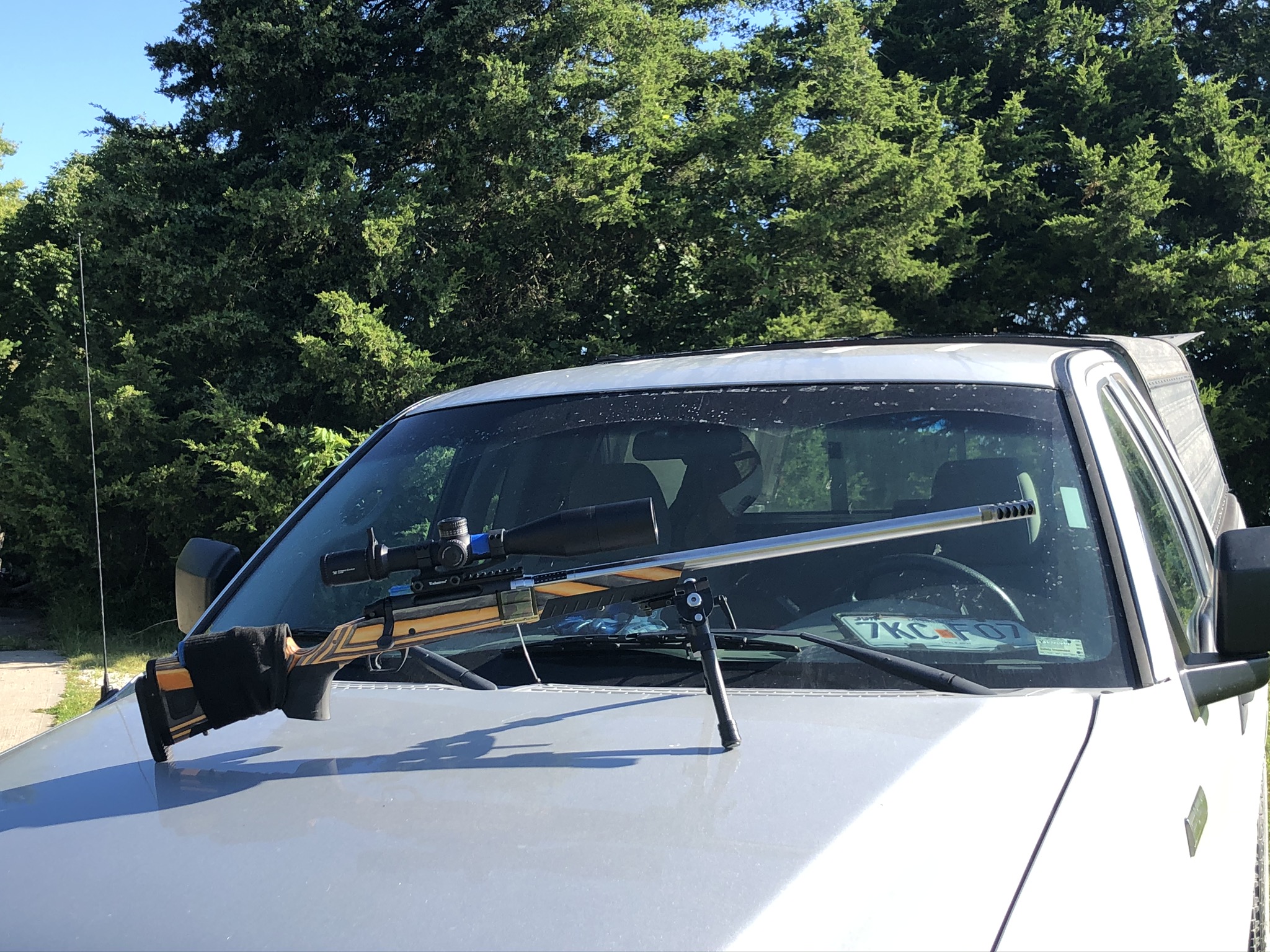

I'd like to see your Remington 783 if possible.
I understand, it only makes sense to do complete analysis before you decide.
Mike
Boyd’s stock
Criterion 26” Match barrel
Witt Brake
Vortex Strike Eagle Scope
I reload for it.
Norma Brass
GM210M primers
75.3 H-1000
225 ELDMs
~ 3.690”
2860 fps
Reactions: jpasci
I like it a lot. Fits me well and I like wood. I got that model for the adjustable cheek piece, I don’t use the adjustable LOP. I load so long that I single load. Maybe this winter I’ll get some bottom metal for it so I can mag feed.
