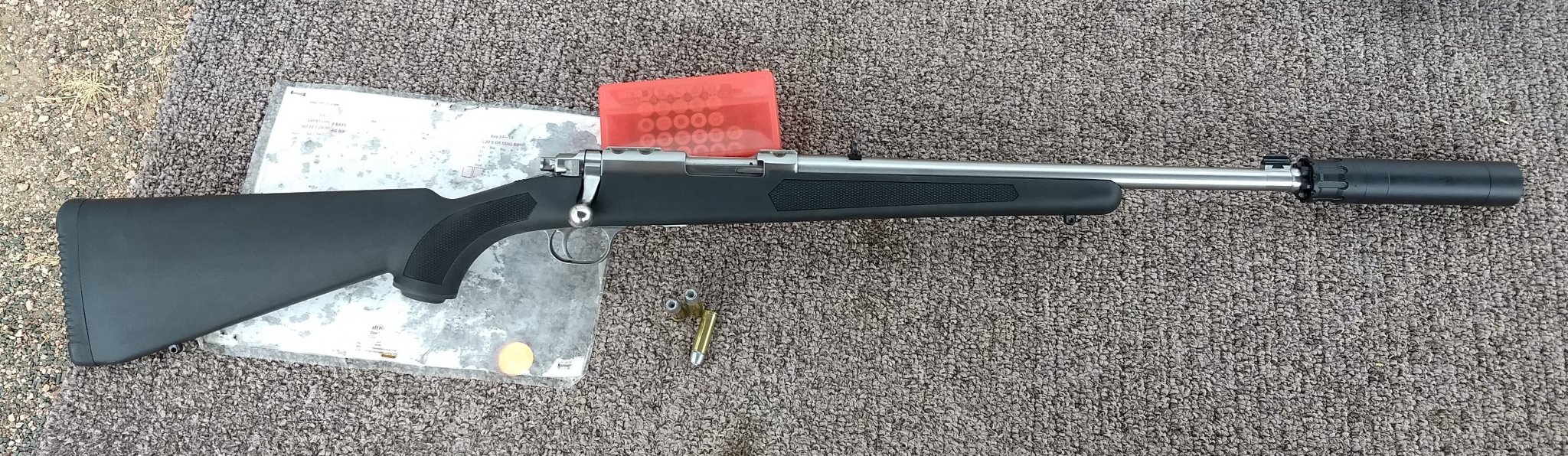

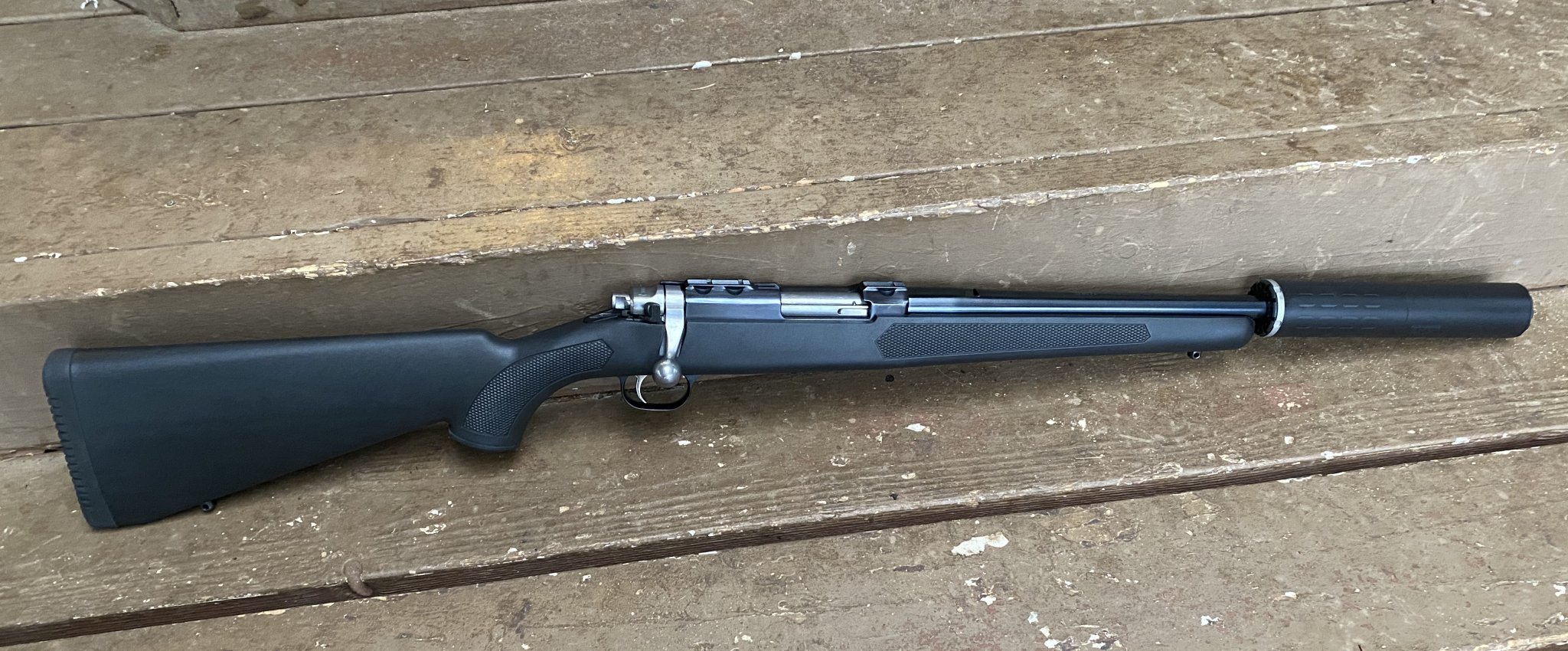

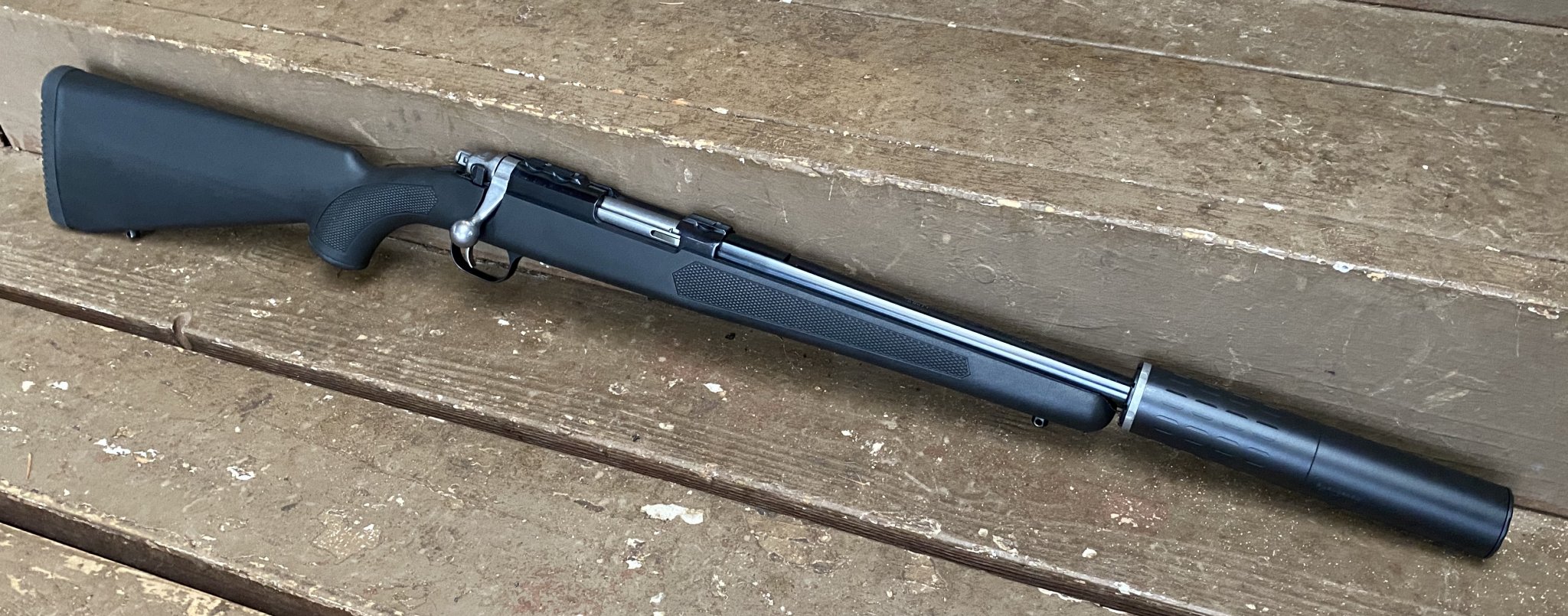

    Got this together for a friend of mine. He wanted a silent destroyer but didn’t want the wait and wanted to be able to use the can on other stuff. Helped him with the paperwork and chopped her down when his form 1 came back. Turned out pretty cool and sounds great.

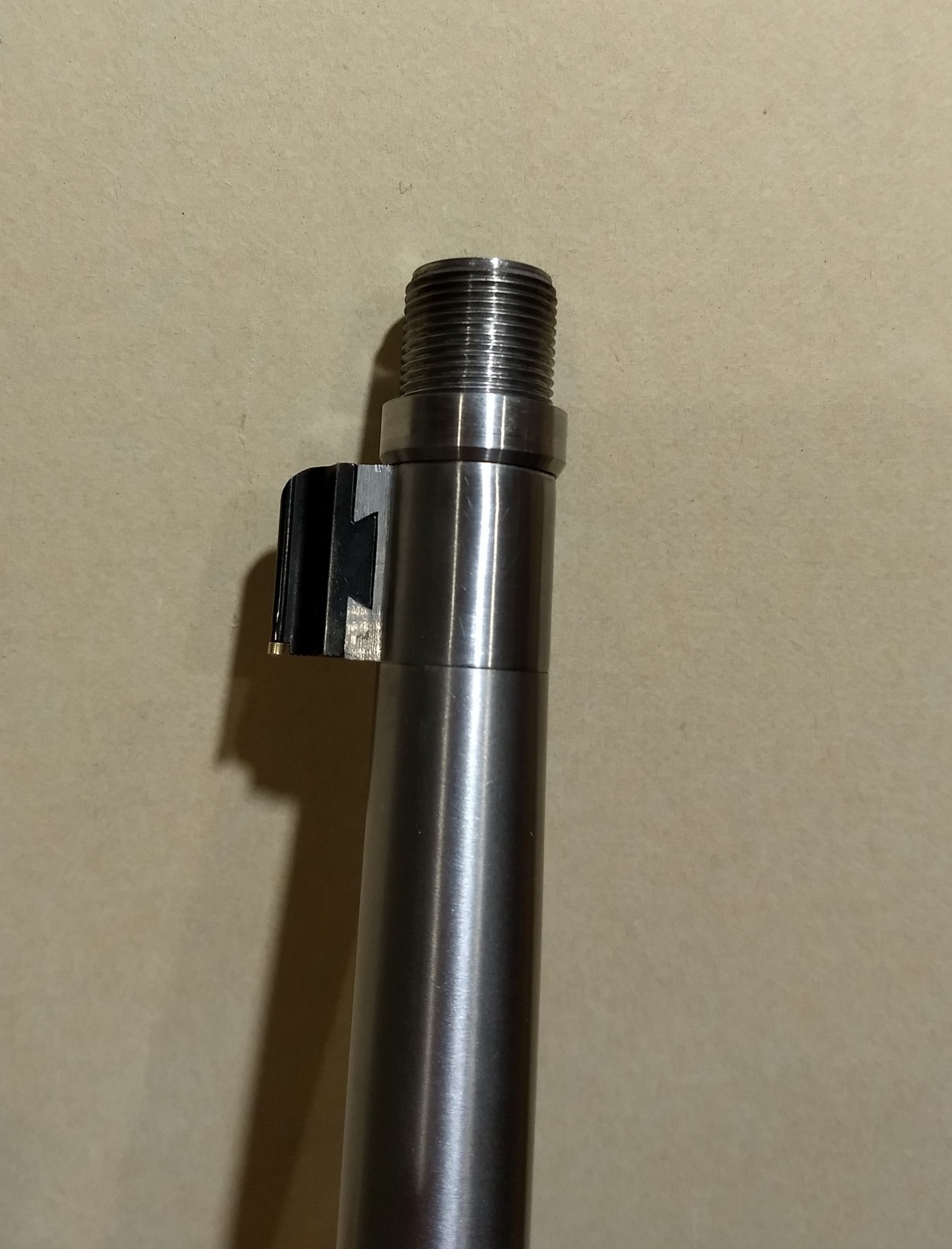

    Cut to 10.75” and threaded .578-28. It was too small for 5/8-24 threads.
    Sounds like a paintball gun with subs.
    Nice setup! I had mine cut at 16" and threaded 5/8x24 by Ecco machine. In cases like this where there isn't enough barrel thickness for a good shoulder, they can mount a threaded collar and turn it square to provide a shoulder.

    I'm sure the .578x24 .45 acp thread will work, but I wanted the extra bore to thread root wall thickness of the 5/8x24 and already had a DT adapter for that pattern to boot, so there was no reason for me to go smaller. Ruger is using an 11/16x24 thread on their 77/44s, and Henry is using 5/8x24 on their 44 mag and 45 LC X series lever actions. Both of those should be good fits for rifle muzzle use, but of course, 5/8x24 DT adapters for pistol cans are very common due to .300 BLK use, 11/16x24, less so.
    Since a Hybrid 46 would go on this ultimately, Silencerco has both .578 & 5/8 45 tri-lug mounts. Just think I'd feel better at 5/8 and probably wouldn't need as much shoulder for the tri-lug.
    Difference between the two threads .578x28 and 5/8x24 on root to bore is about 0.018”. The 24tpi eats up a lot of what you add in diameter. Both threads should be perfectly adequate. I’d prefer 5/8 as well if I can maintain an appropriate amount of shoulder.
