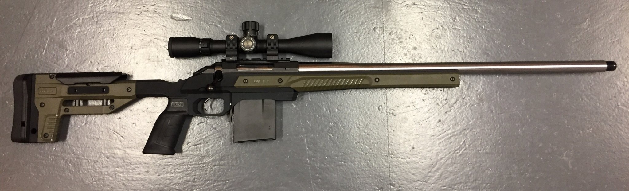

Optics planet had a ruger oryx on sale for a couple bucks off plus the July 4th 10% to make it 350 to my door. No brainer done deal. Just barely more than the boyds but a chassis and I get to rep another mdt product. I appreciate the work mdt!
I can report that the ruger oryx in combination with the extended lip accurate mag has feed the 10 rounds of 223 I put in the mag without a hitch.
From this
7115090
To this
7115089

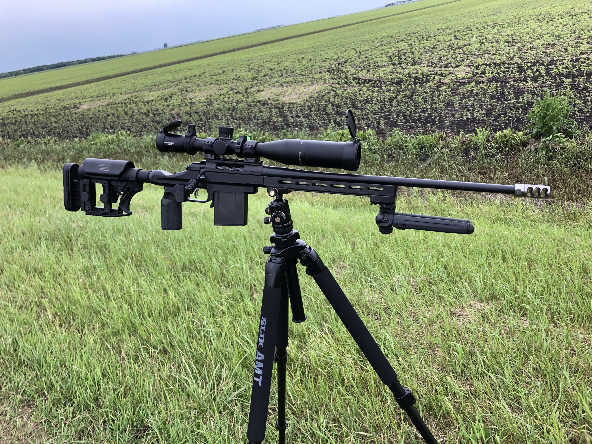

The Indian Creek Design MoFo chassis that uses AICS magazines works phenomenally with 223. I’m personally using the now discontinued “Ruger 90458” magazines, but I saw on posts here that you can still get the magazine directly from Accurate Mag by contacting them directly.
I’ve walked 2 guys through “tuning” the Ruger polymer magazines. Basically what needed to be done was sanding the OUTSIDE of the magazine body, to allow it to sit further up into the action. As the “fat” polymer magazine body hangs up on the action itself.
If you run an AR15 magazine model Ruger American, and wish to continue doing so, Indian Creek Design also has an AR15 magazine version chassis. BUT, if your rifle used the rotary magazines in the factory stock, and your bolt body does NOT have the extensive milling done to it, the AR15 magazine chassis will NOT work for you. As the bolt cannot close on an AR15 magazine unless it has had the bolt body milled out.

I've been wanting one of those ICD chassis. It looks like they may have a longer arca and m-lok forend on the way.
If you haven’t upgraded yet, or seen the release, the Johnny(arca, m-lok) fore end has been released and it is amazing.
Linked is a walk around video of my RAP 223 in the ICD MoFo with Johnny fore end.
Reactions: Tx_Aggie
