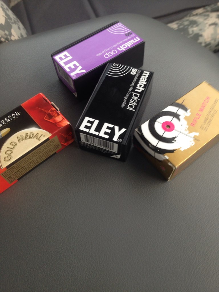

Had a buddy let me use his match stuff... Shot perfect without any hiccup and group around an inch. The federal match stuff and the eley match may have grouped best today but it was close... So it only likes match ammo apparently
