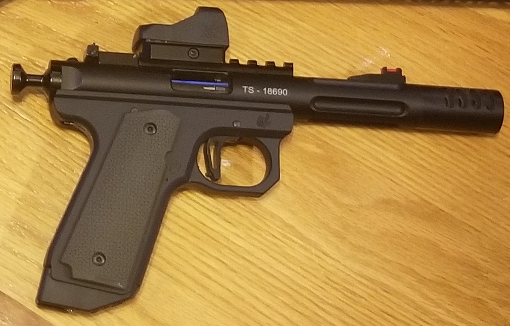

Yup. As pic above shows, this gun is not a Ruger anymore, at all. TacSol Upper, Volquartsen frame / internals / bolt, etc. Really, only the magazine body is Ruger, with aftermarket followers, baseplates etc.
So more than likely the recoil spring is a little stiffer, add to that the added restistence of the magazine spring of a loaded mag until you get past the first two rounds and it eases up a bit and starts functioning properly.
Reactions: GetReal
