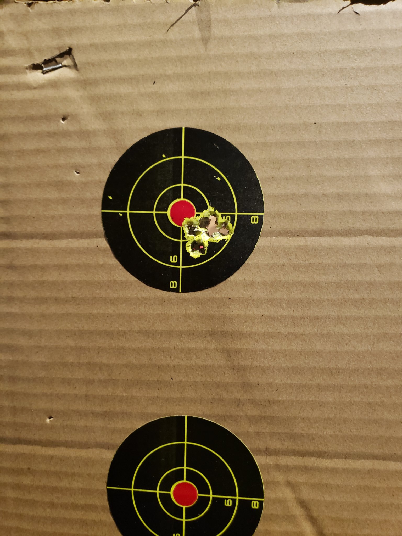

Thanks for that info, my next step was to call them , but it seems to shoot 178 amax OK at 100 is as far as I've gotten.. my issue with 178 ELDM is that the throat is so short im getting compressed loads at around 43 grains of IMR4064 and lapua brass. I'm used to the remingtons where the Freebore is VERY long.
41 grains 4064 , 178 amax 100 yards ..
I can't just feed it what I want like my 7005R

Ehh, 9 isn’t that much different than a “standard” 10. The old 12or 14 twists were for times 40 years ago when a 180 gr bullet was super heavy. Now it’s the baseline. Your 175s Sierra is a forgiving bullet, you’ll find something that shoots well with it guaranteed.
