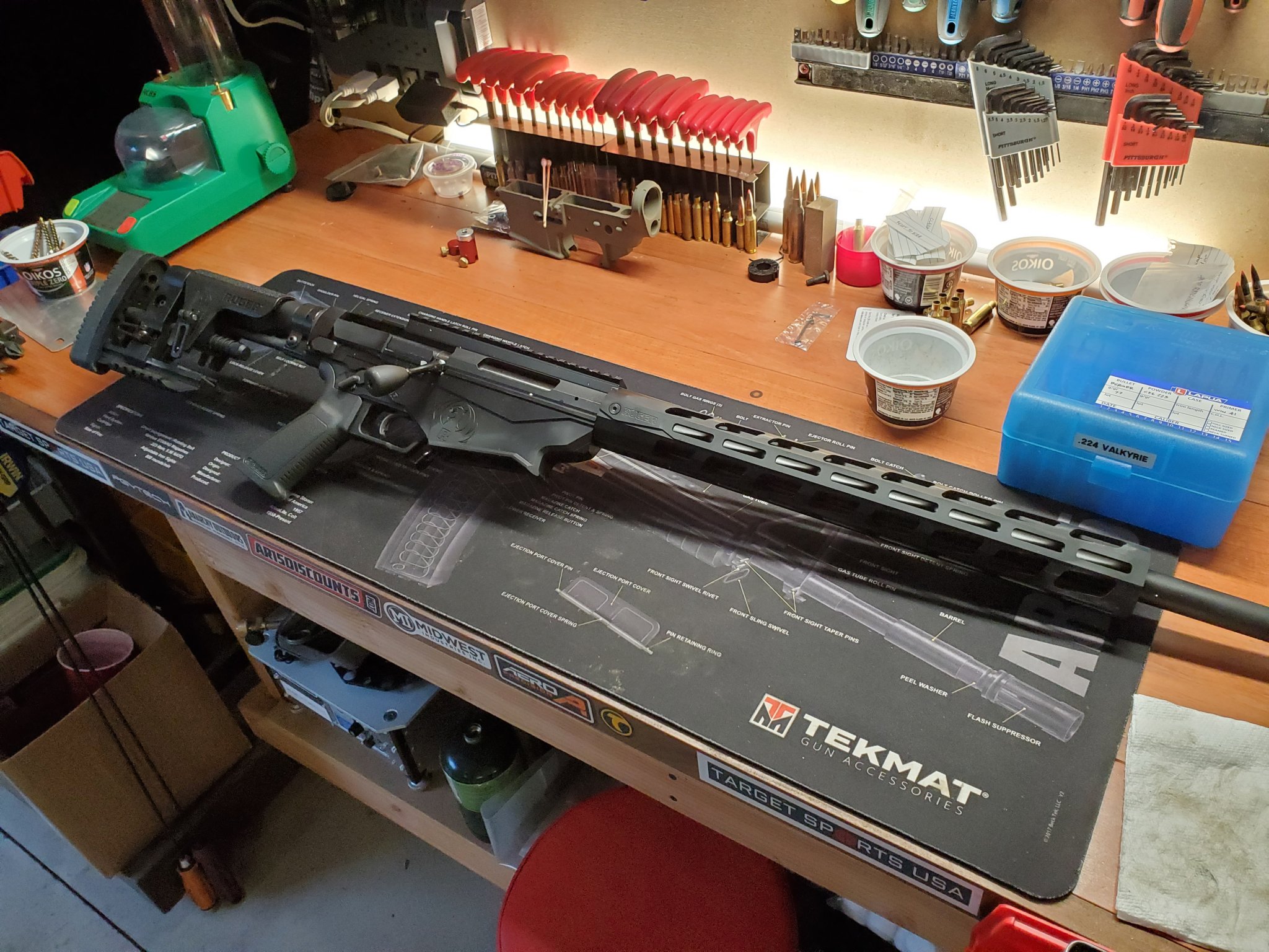

Progress Update: I have begun the upgrades to my RPR in .308. I have successfully updated the HG (replaced with the Catalyst Arms "Arca" rail), the butt stock (with the Magpul PRS3), and the Catalyst Arms Extended release tab. The Timney 2 stage trigger is "in progress" because they don't tell you that you have to take some parts out of the original factory trigger and put them into the Timney Trigger before you install it. :mad: One of those parts is a very tiny e-clip that goes flying and gets bent out of shape. And, apparently, it's the only one of its size needed for the pin. Well, Amazon to the rescue for that. Now I have bought a 300pc. eclip set. I don't understand why Timney didn't just supply the parts to go with it Perhaps, because the trigger can fit many different models and they can't supply those parts for all the different models. Uggggghhh. (n)
I also had some issues installing the updated Titanium bolt shroud on the bolt. I think the supplied mfgr. bolt is a little different. Either that, or I need the "mangum" size bolt shroud that is a little longer. But I can tell the bolt clip (see below)
is a little different in re: how it's portrayed in the ads for the replacement bolt shroud. The titanium replacement bolt shroud is just too short to fit. So, I either need the magnum bolt shroud, or I need to have Anarchy Outdoors machine the one I have so that it will fit. But for now, I'll leave the factory shroud in place.
I've also come to notice that you have to be very careful with "tolerances" in re: the lower receiver, lest there be problems getting the bolt to go back into battery and pulling it back to extract (it gets stuck). But I will keep the bolt oiled (to a degree) and ensure the channel stays clean.
I'll check back in after I get the Timney trigger settled.

Update, after a little bit of effort, the Timney Trigger is installed and is functioning. Although, I don't feel the "two" stages. It just feels like only one very light stage. As light as a 1911 trigger, which I don't mind, actually. I just have to be ready for it.
Next issue... I'm still finding that the bolt sticks as it attempts to enter battery. I've oiled it reasonably (not too much) and it will go into battery (I can push the handle down and press the trigger), but when I lift the handle and attempt to pull it back, it sticks. I work it a little and seems to do better but I can't be sure something isn't right.
Any help with the bolt would be greatly appreciated. Nex steps are to mount the bipod to the HG, and then begin the process of mounting the scope. We'll see how that goes.

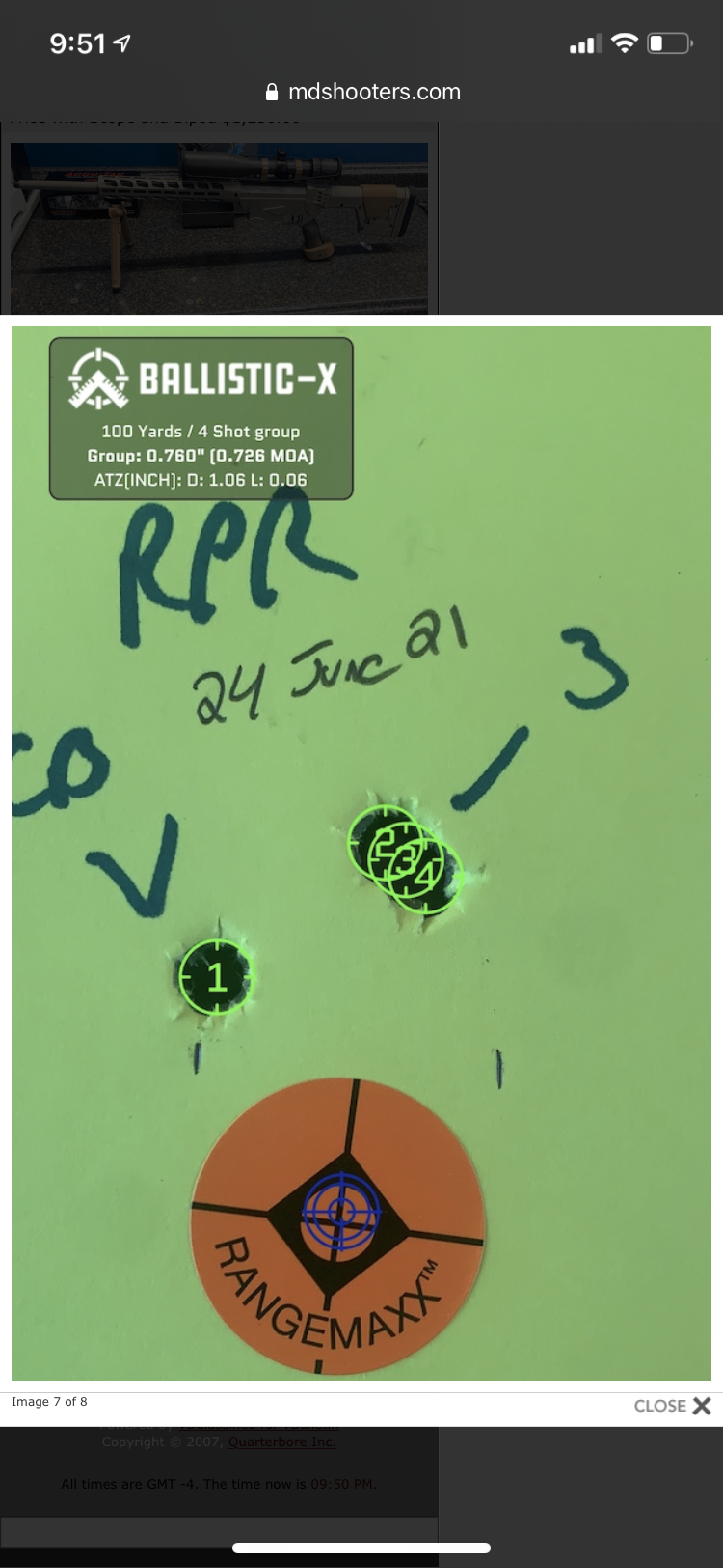

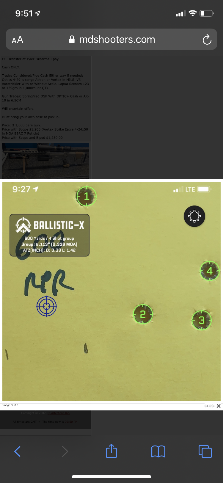

Here are my groups with my 6.5 RPR the green target is 100 with my Cold bore shot and then cooled for about 10min and then 4 at 600. It will does this in my not skimmed hands and these are normal groups not try all day groups.
Update: Timney Trigger is now installed, after some effort. Biggest effort was getting the e-clip to seat. Still waiting on a couple more parts (adapter for the Harris bipod to the ARCA rail HG) and I discovered I needed "high" rings for the scope instead of low so I'm exchanging those. With the optical lens at 56mm, the low rings just aren't enough.
We'll see how things go.

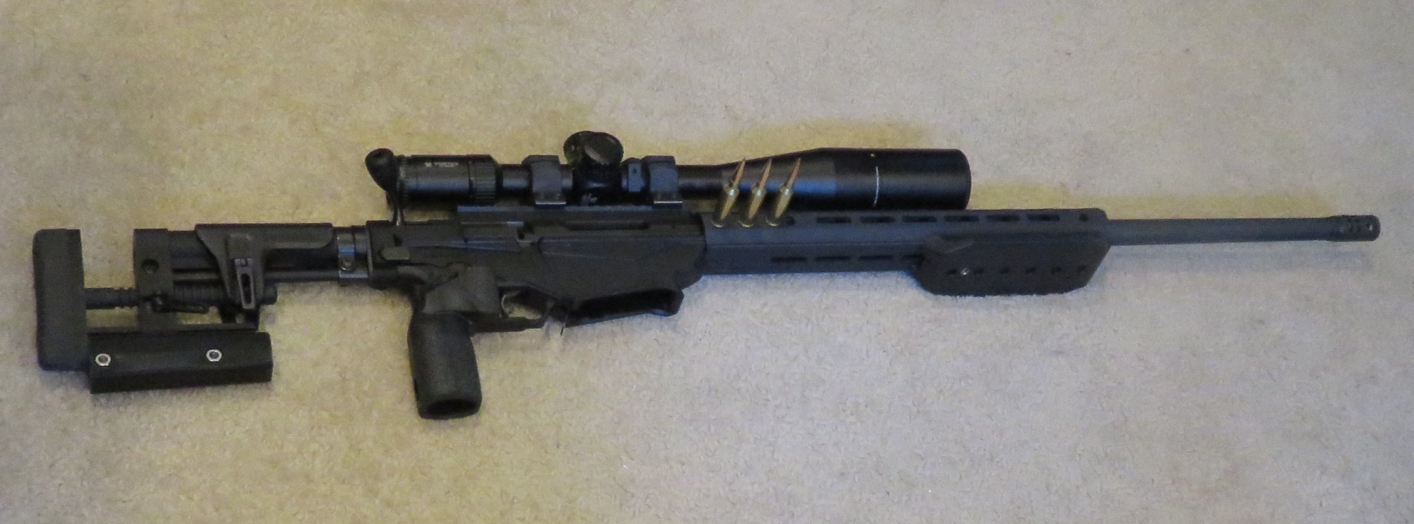

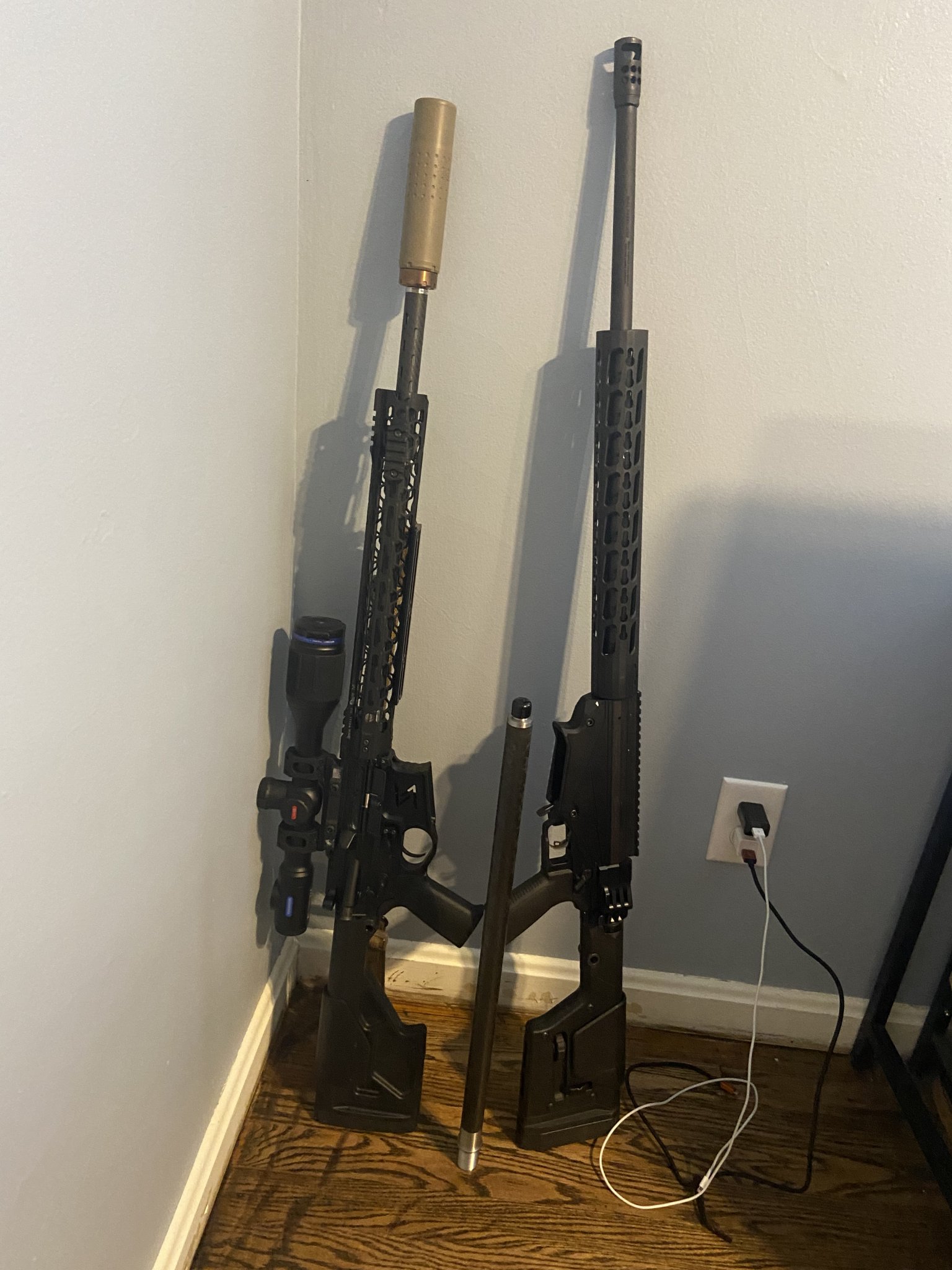

Got bored waiting on my AT-X and .223 conversion so I figured I would fiddle around with this in the meantime.
RPR 556, added a vertical grip and the Catalyst rail. Topped with a spare USO TS20x. Shoots 75 ELDs and 80VLDs equally well. Super cheap and fun to shoot. I’ll give it the rattle can treatment when I find some time.

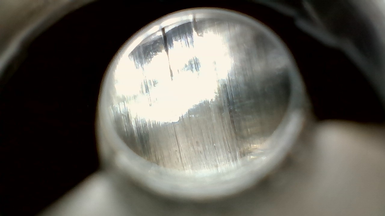

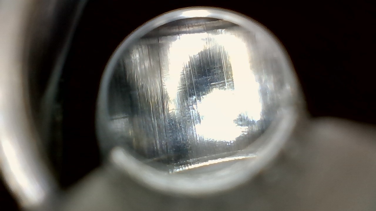

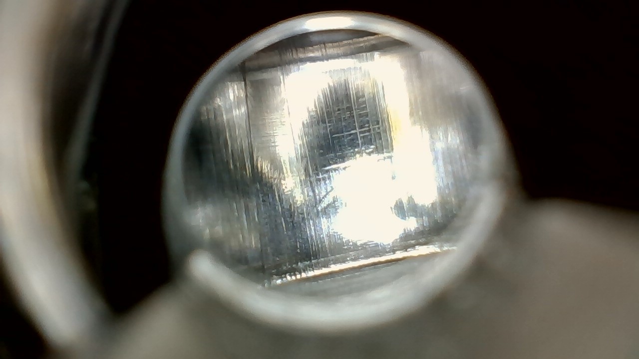

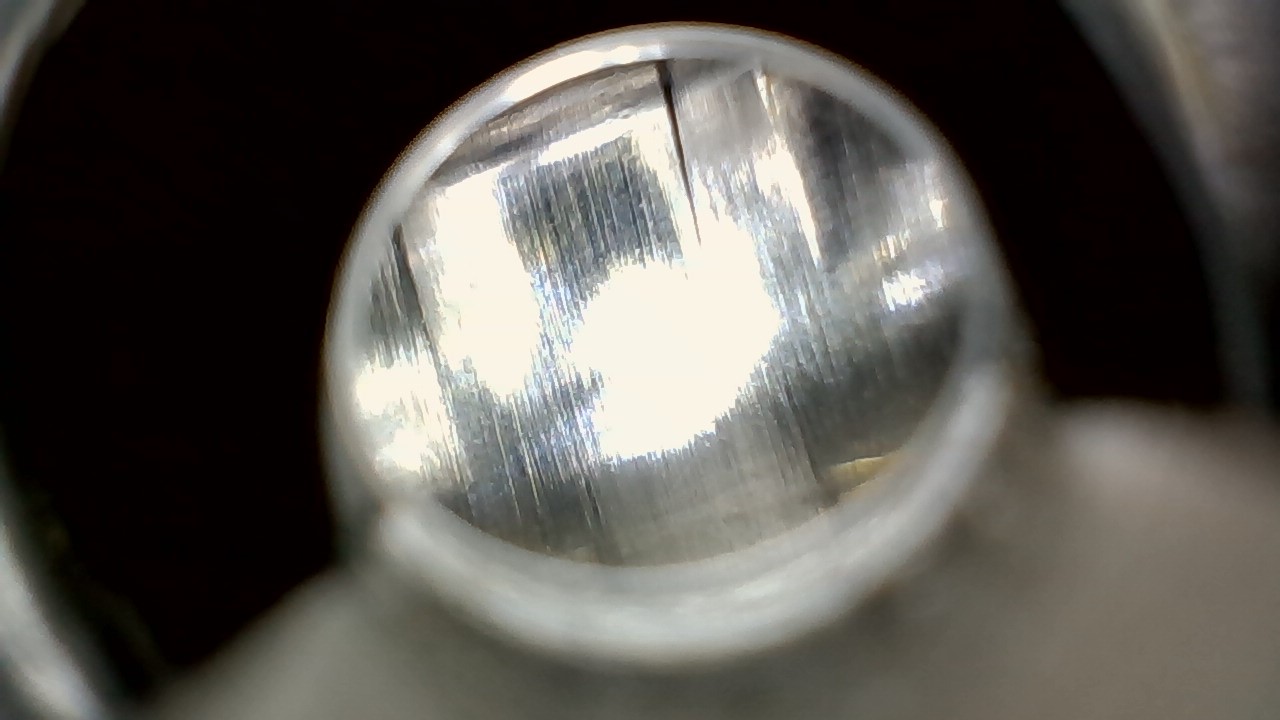

Likewise Carlos, I have high hope with my 2nd RPR (the other being the .308), which is a 6.5 PRC. Only 40 rounds down the barrel and still breaking it in.
I have some concern as upon inspecting the bore with borescope one of the lands was all the way to the freebore and the rest were quite a ways away. I called Ruger and they didn't seem to feel this was out of the ordinary and recommended I shoot it to see how is does and if there's any problem, then I might send it back to them.
Can you post a pic that that? I’d like to see it, doesn’t sound right.
It's difficult to get perspective with still pics (much easier to see with video) as I can't get the short lands in the view along with the edge of the freebore at the second shoulder junction. That junction is out of sight at the bottom of the mirror. (where it looks like the freebore at the top of the mirror, pay no attention to it as it's a weird reflection)
These two pics each of different short lands that doesn't reach the freebore
These two pics are of the same lands (left of the light reflection) and you can see is extends down to the freebore.
