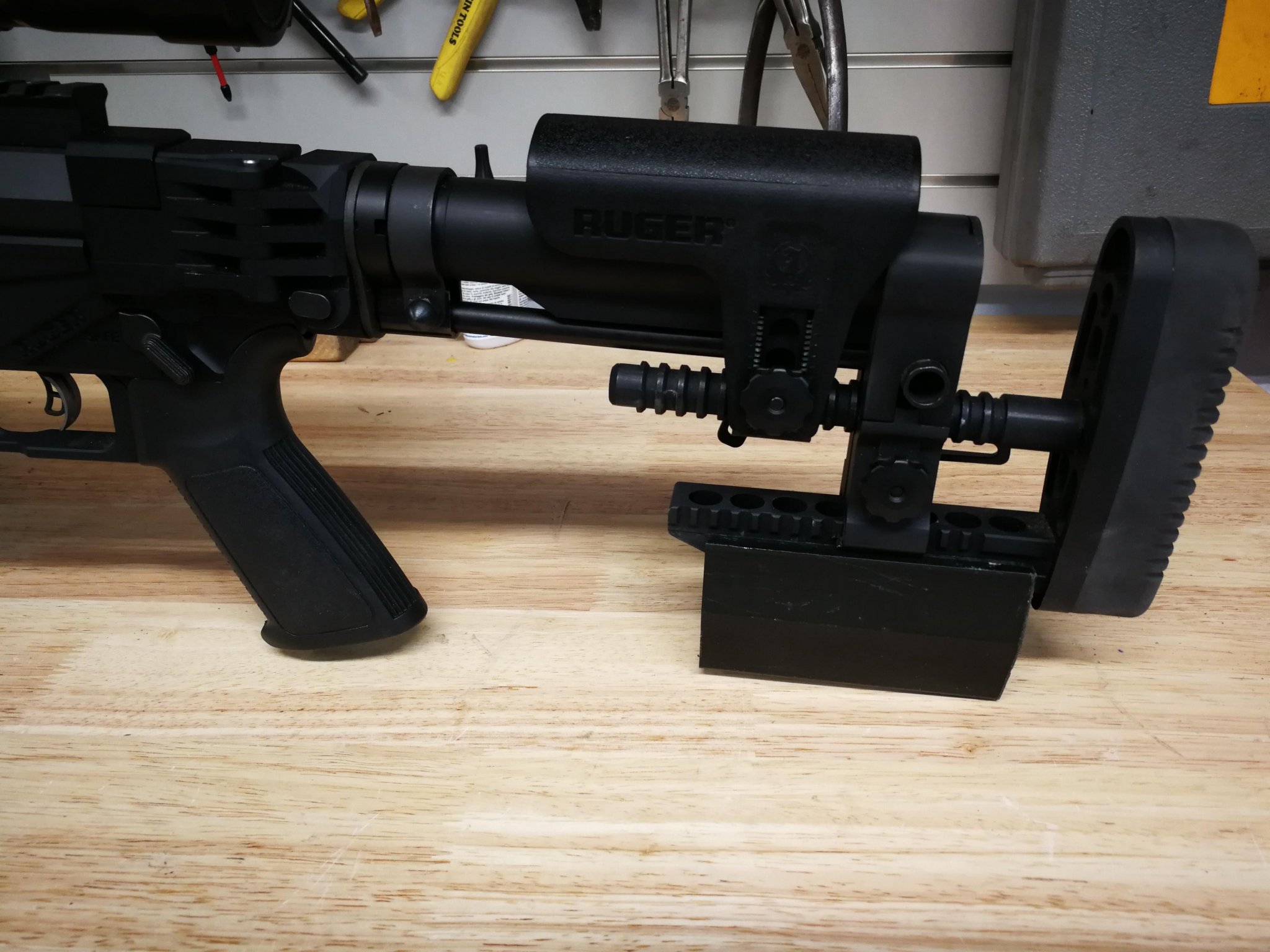

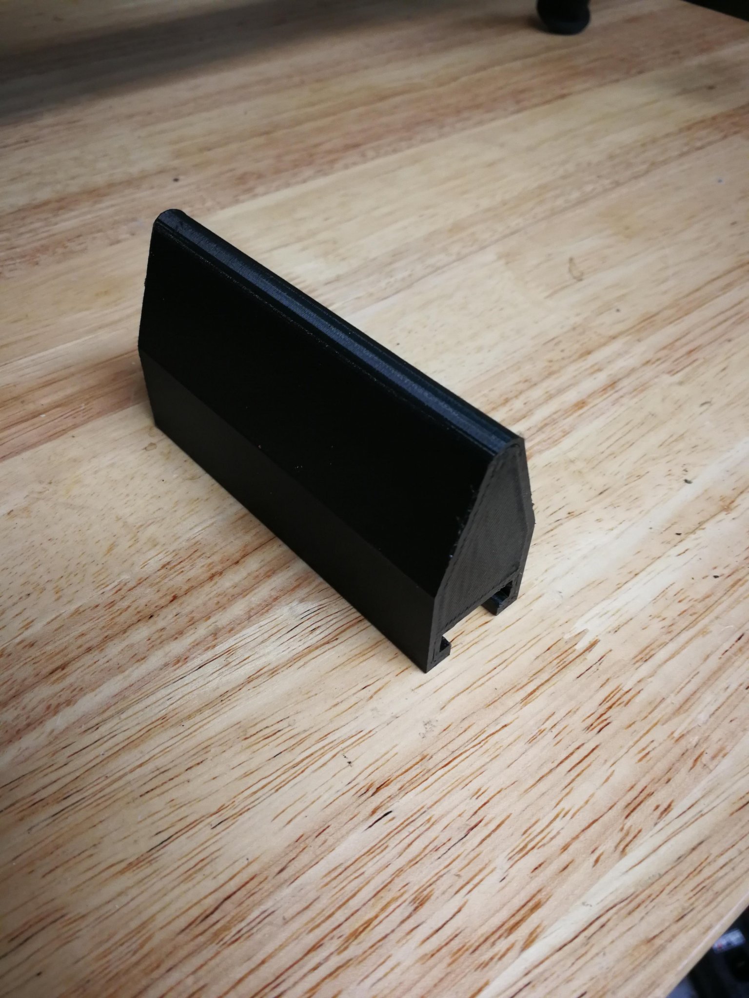

I had a little extra time today and printed a bag rider for my RPR. I haven't been happy with the ones I purchased.
I tried it out today (briefly) and I'm pretty happy with it. It might be a little tall but my bad is a little short :)
stl file attached if anyone wants to use it to print one. I had to change the extension to txt though. If it doesn't work for you DM me and I will send the file in email.
  • rpr_bag_rider.txt

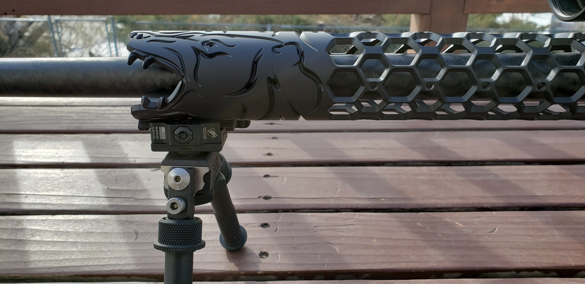

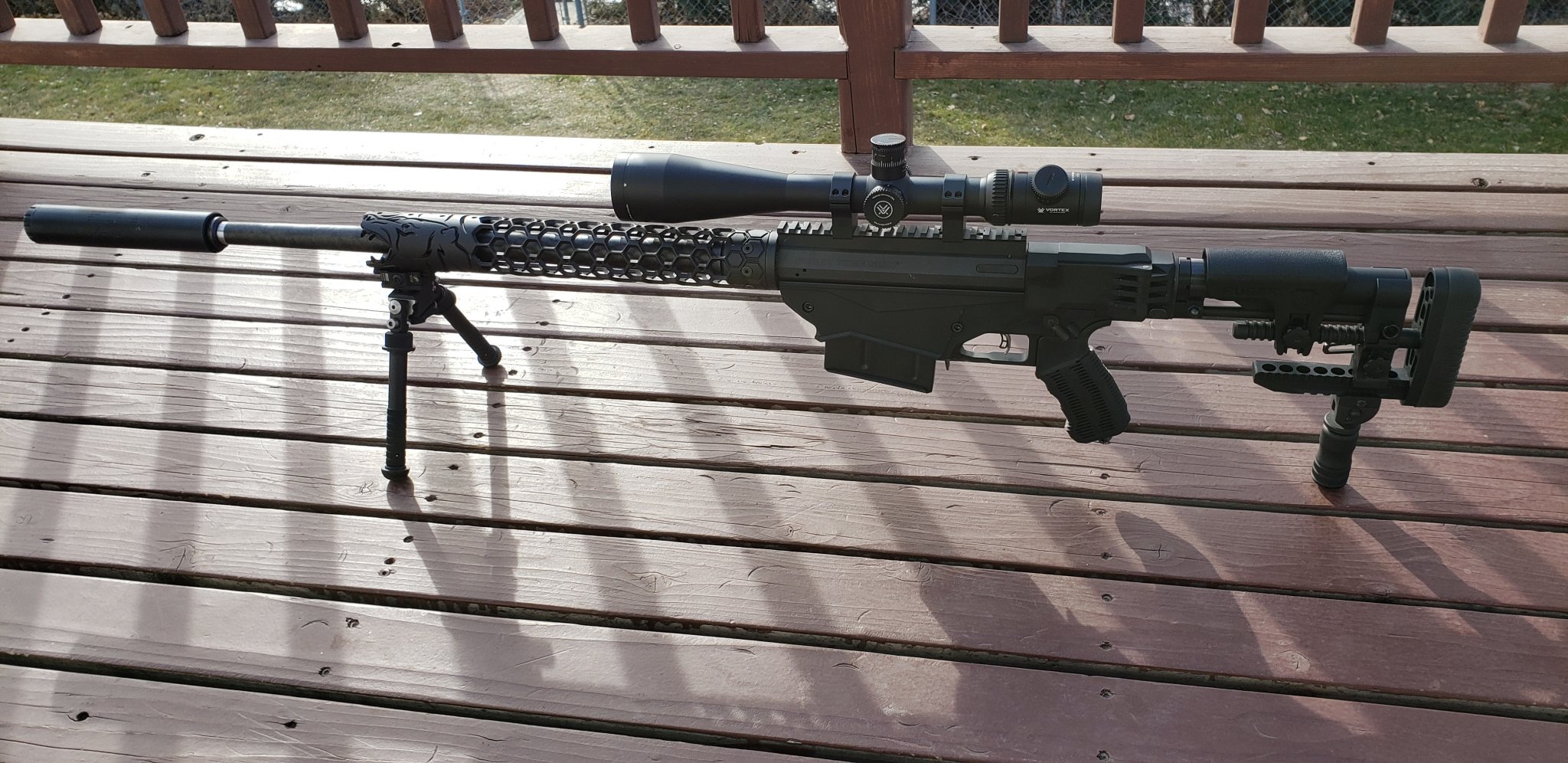

I recived my RPR 300 PRC back from the the custom handguard maker! If you want to customize your RPR magnum handguard contact Unique ARs (
https://unique-ars.com ) you can use one of the handguards that they have in stock or you can go full custom like I did. I went for a bears head on the muzzle end. I also have thier rifle grip installed. You can adjust it to completely conform to your hand!
Final weight to my rifle as pictured is 14.7 lbs! If I take the monopod and bipod off I'm right about 13.8 lbs!

That's really cool, did you have to provide a drawing of what you wanted?
Sorta, I gave them a couple of ideas and then thier artist( Rich) worked with me to get exactly what I want. They send you mock up CAD/digital format drawings to get you to the design you want. I can barely draw a stick figure so he is really good hahaha!
@Vidar That is a very interesting and unique design. How is the integrity and strength?
I dont detect any flex when loading the bipod or moving the rifle around. If you have a facebook account I think they have a video showing how strong the handguards are. Unique ARs makes really nice products. If you haven't already go to thier web page and look through thier gallery. They have made some awesome crazy stuff.

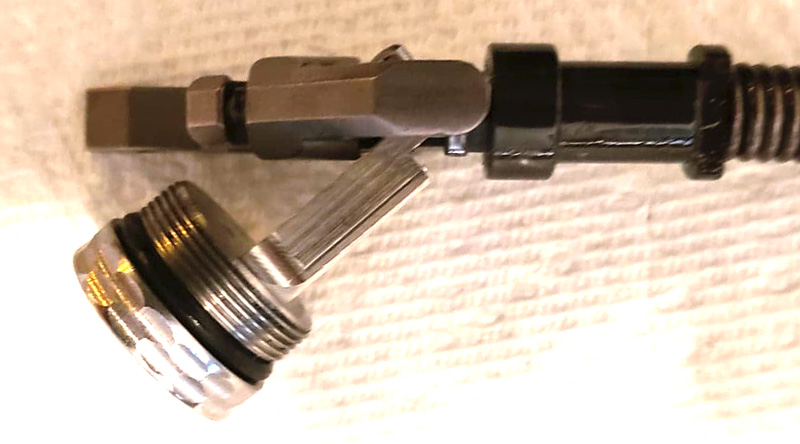

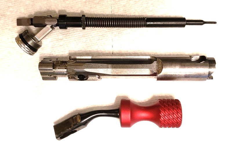

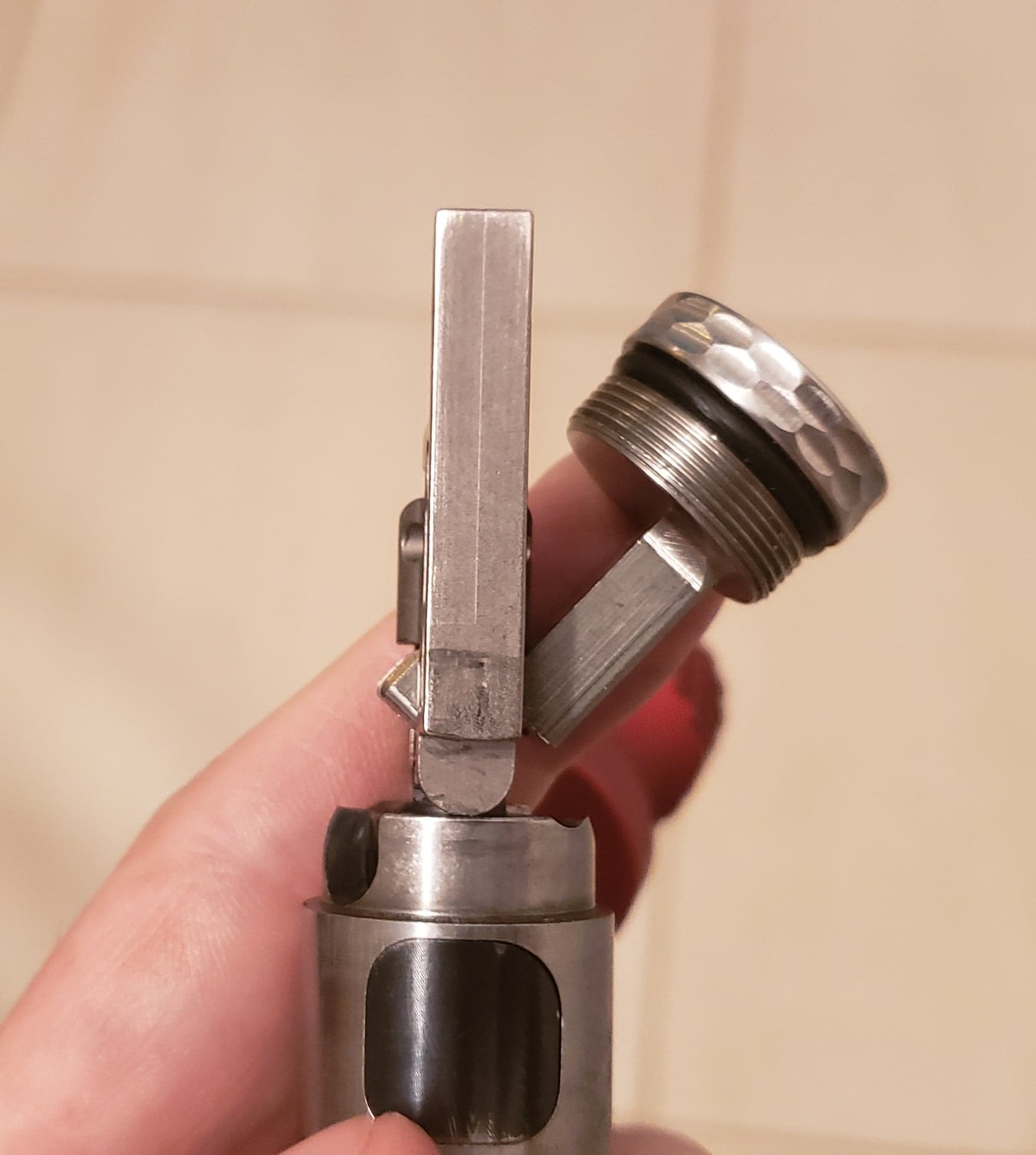

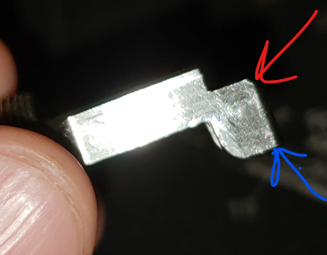

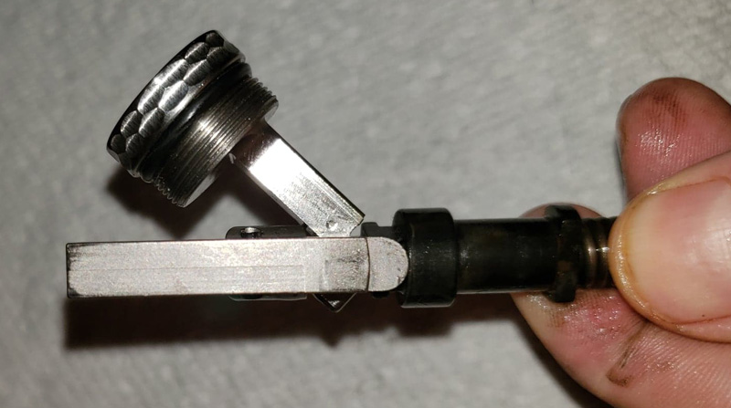

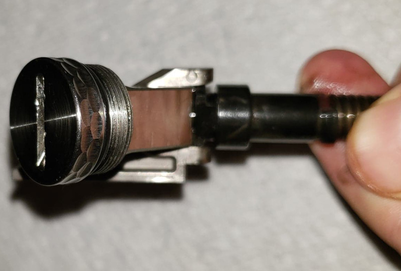

Hello Racer88, I have the same Anarchy bolt shroud but had never used the take down tool until now. Slipped in and rotated just fine. From the photos it appears you might have inserted the tool too far and the tool is binding on the rear of the firing pin, that it is supposed to depress. Just a thought.
I tried again today. I was able to disassemble the bolt. Though, the tool still would not rotate all the way, no matter how I manipulated it or oriented it. So, I just did it with the tool at 45-degrees.
I guess I'm not sure of the purpose of breaking down the bolt. After over 3,000 rounds through my rifle, and never breaking down the bolt until now... it was remarkably CLEAN inside. For the hell of it, I sprayed it with CLP and wiped it down. But, there wasn't really anything there.
Fortunately, I was able to get it all back together with no issues. And, it still works! :)
Unfortunately the Anarch tool has square corners on the part that interfaces with the bolt that should be rounded. Compare it to the factory ruger plastic tool and you'll see what I mean. Rounding them off with a file lets the tool work as it's supposed to.
Hope this helps.
Hope this helps.
Thanks... I no longer have the OEM tool, since it broke the very first time I tried to use it. So, I can't compare. But, what you're saying makes sense. But, so I'm clear on which corner to radius / round off... red arrow or blue arrow?
Thanks again!

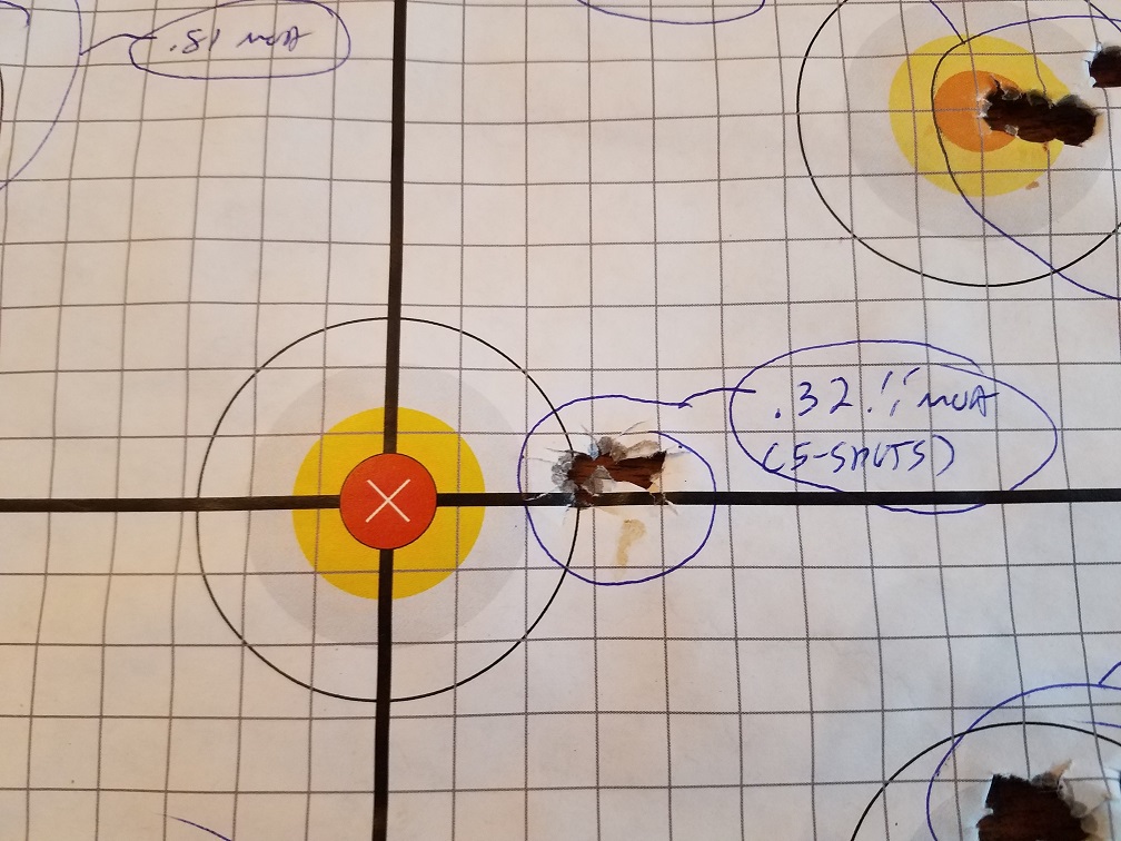

Went out yesterday for a small session at the 100 yard range (it was raining pretty well). Shot all prone for the first time, for a total of 8 different 5-shot groups. Averaged .805 MOA, with a best of .32, which was my best EVER!! That also happened to be the first group, on a cold bore. I tweaked the windage by .2 MIL after that, and for the rest of the morning, things were much closer to center. If you take out the fliers in the "bad" groups, I had a bunch of holes overlapping/touching. You can see a few of those groups on the edge of the pic. Felt really good when I left the range! This rifle is bad azz, especially for the money!
