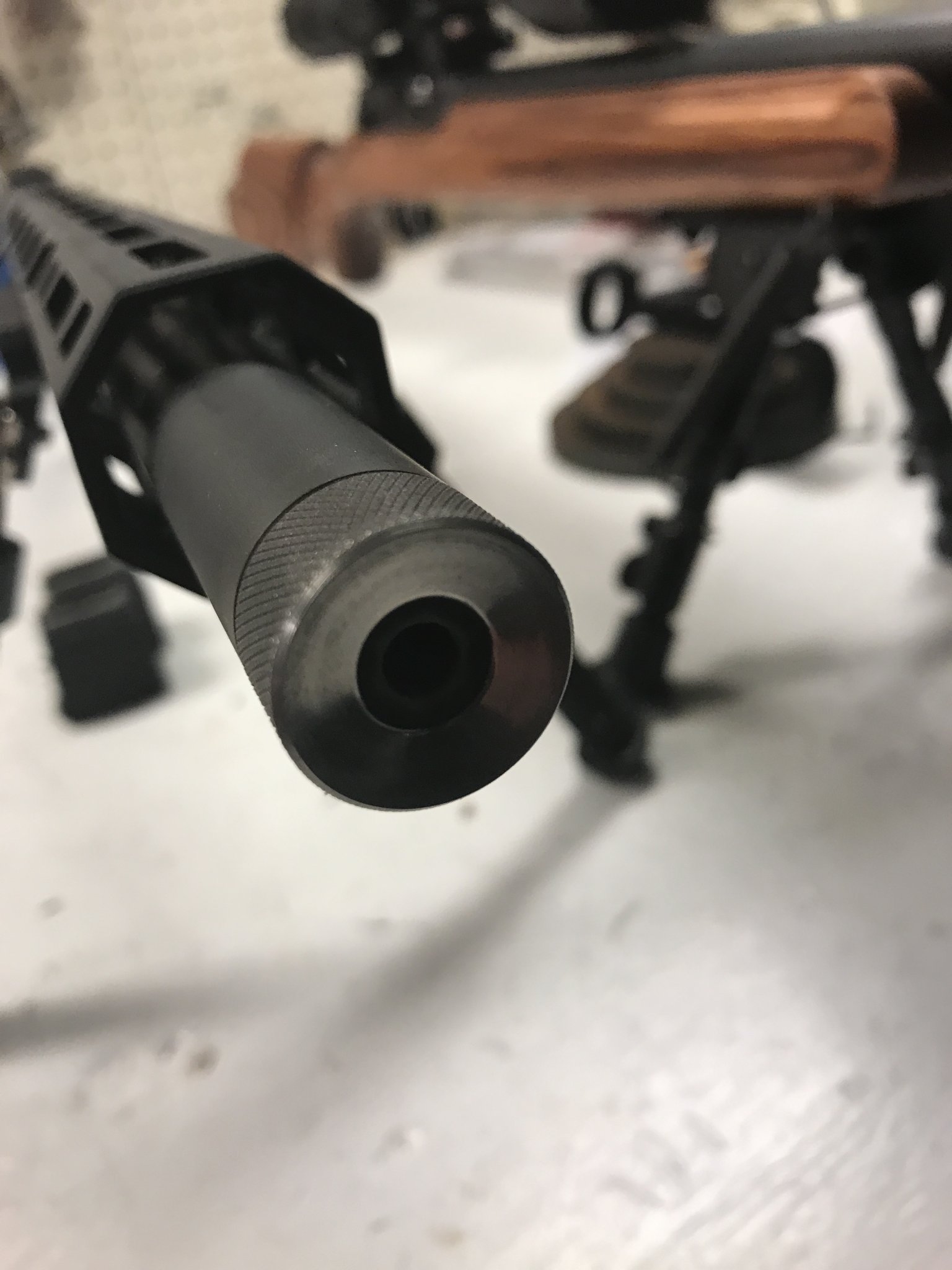

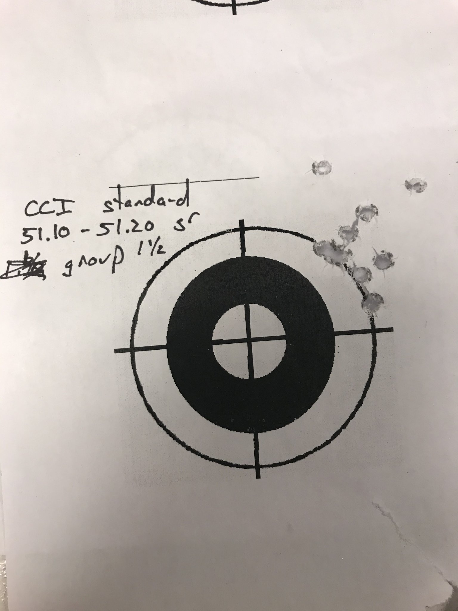

I bought a RPRR about a month ago, did some ol school stuff like fire lap the barrel right out of the box whether it did anything or not no idea but I was shooting 2 1/2 - 3 “ groups at 100 yards was not impressed but I do know different ammo shoots differently.
all I read about was guys shooting 300 and even 500 yards with results to brag about I did notice they all had suppressors but didn’t click yet.
started a little testing by accident I found it shot better with the thread protector off found it weird! So I cut a 11 degree crown on the thread protector and opened the hole to match the diameter of the barrel. See attached picture
I also bedded the action did not need much but still bedded it.
my groups had dropped to 2” at 100 yards and still not happy, i was now dealing with the hated fliers! if you look at a ballistic chart loads with the least drop at 100 yards were already subsonic anything super sonic was not by a 100 yards, this will cause wobble and accuracy gone!
i chose CCI standard ammo 1080 FPS just about as close as you can get and stay subsonic, I started weighing my rounds and found in a batch of 100 I will have a difference in 1 gr so I started separating in .10 gr differences and my group dropped of 10 dropped to 3/4” except for two fliers which made it 1 1/2 “ group.
i have started separating at .05 gr differences and will post results later need a nice day, I have watched the wind carry bullets at 100 yards threw the scope
any feed back will be welcome

1) Transonic shift has insignificant effect on accuracy with 22lr.
Not my words but those of Dr. McCoy at the Aberdeen Ballistics Lab.
2) Ammunition quality is what y'er fighting with.
Look closely at those cartridges before chambering.
Dents, dings, scratches, irregular drive bands, asymmetry
is the true cause of most strays.
3) Use a ballistic chronograph every time you punch paper.
Watch the mv differences and the shifts in vertical poi.
4) Use wind flags to time y'er squeeze.
5) Purchase better ammunition. Cheap ammo won't do the job.
Lack of quality control on the production line is why it's cheap.

Sideways or keyholing is a result of poorly made cartridges.
If the bullet is asymmetric, deformed in any way, it will pitch/yaw/spiral/tumble due to aerodynamics.
All due to cheap, crappy ammo.

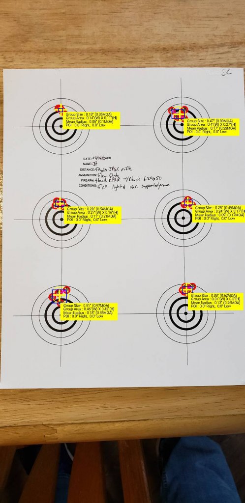

I've got a few videos out but here's one of me making good hits on 4in steel plate and 6in IPSC Head target at 300yds.
My RPRR has a very inconsistent cold bore shot unlike most of my other guns.
Find the right ammo and it will probably work well for you...
Practical precision. Head shot on a fly at 50 yards. This is my RPRR with Eley Club and a bit of cross wind. Took my new t1x on this trip today also... that'll be a different thread.

My RPRR shoots well, best groups at 100yrds have been .65" and .63" , using SK Long Range and SK Rifle Match respectively. I dont notice much difference shooting when cold (I live in Nova Scotia). POI might be slightly different but I dont see any real difference in group size. I think it affects me (trigger finger gets cold) more than the ammo. I did notice small improvements initially as the barrel had more rounds through it, probably took 500-600 rnds. Early on I did bed the action using Elfsters foil tape method and that helped quite a bit. I've since added a second layer directly on the bedding blocks. I dont have a torque driver but that is my next area of focus, trying different torque on the two action screws. I have always had extraction issues with many different types of ammo that I used during the initial barrel break-in, CCI, Browning bulk, Winchester and so on. Extraction issues with SK are non-existent. I blame it mostly on the heavier lube other brands use. Even Eley ammo gave me issues. I recently tried for the first time a few mags of Federal Automatch 40gr and no extraction issues - more testing needed but it would be nice to have a dirt cheap ammo that functions when you just want to fool around. For serious shooting I've pretty well settled on the SK Rifle Match and SK Long Range Match at this point. My goal is to have a good shooter with ammo under $10/box, and the SK gives me that.
FYI - I use a Vortex Diamondback Tactical 4-16 and it seems pretty good.

Great info! I have downloaded BallisticX and will Talley results in action torque and ammo
Here's the best 50yd 6x5 I have gotten so far. Was
shot on my bone stock- non bedded- unclean (aka nicely seasoned) - at least 1k rounds fired rprr. Diamondback tac 6-24 in utg rings on top. Supported prone. I think the average is 0.34 inches or 0.64moa. Eley club ammo straight from the box.
Reactions: heartburn
That's a solid performer, probably the best rprr groups I've seen posted so far.
