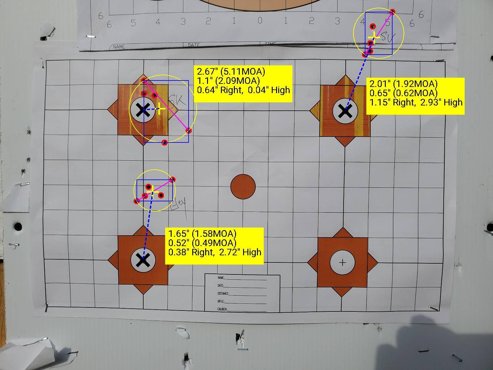

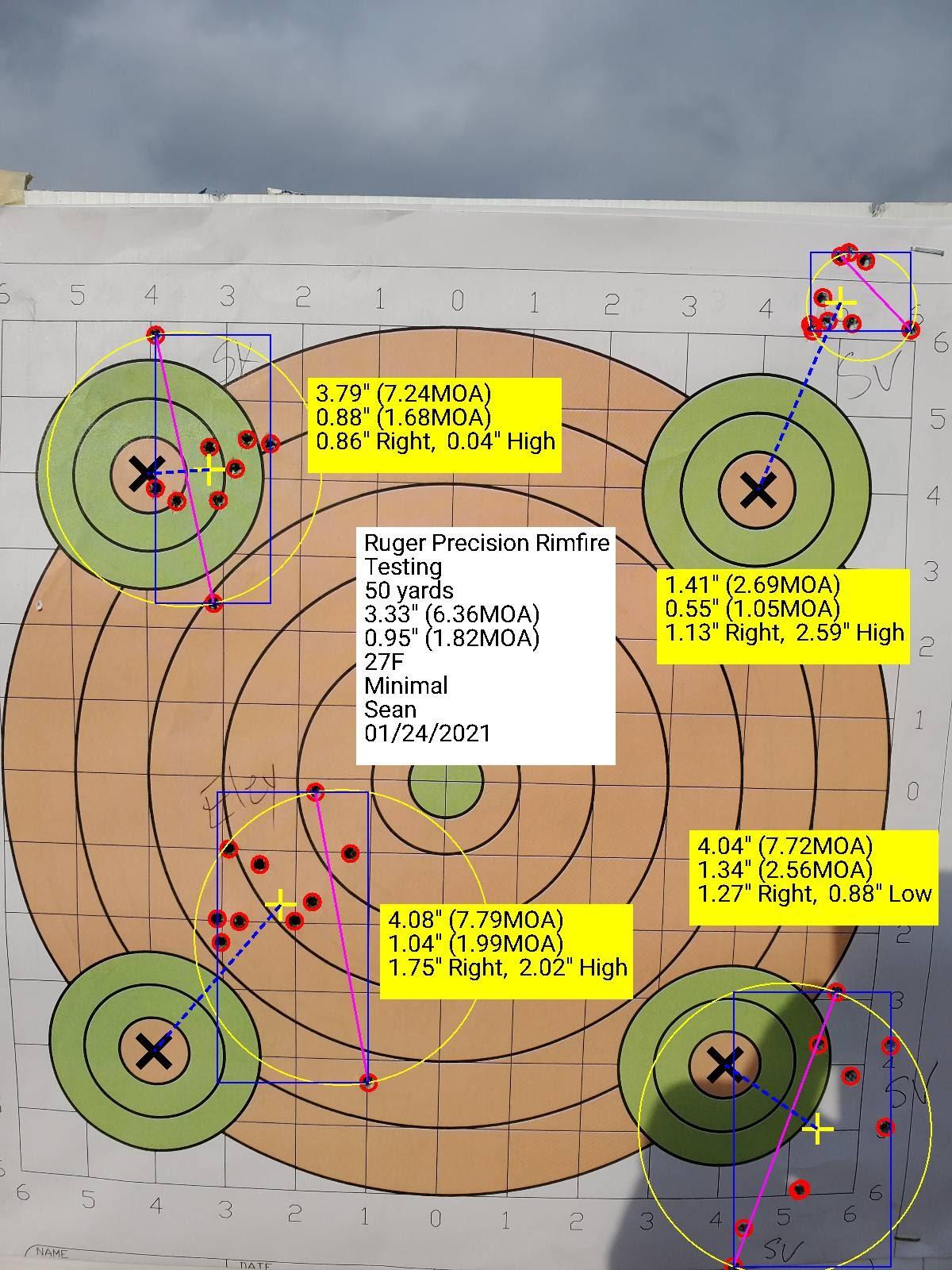

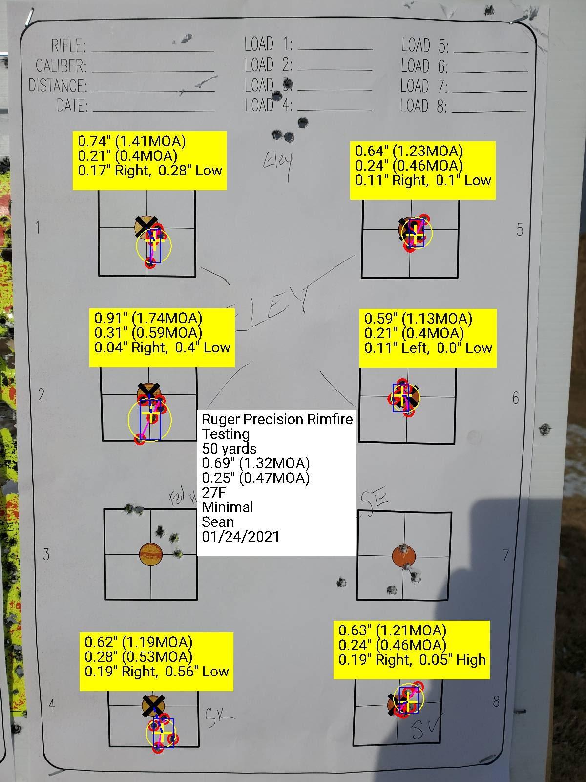

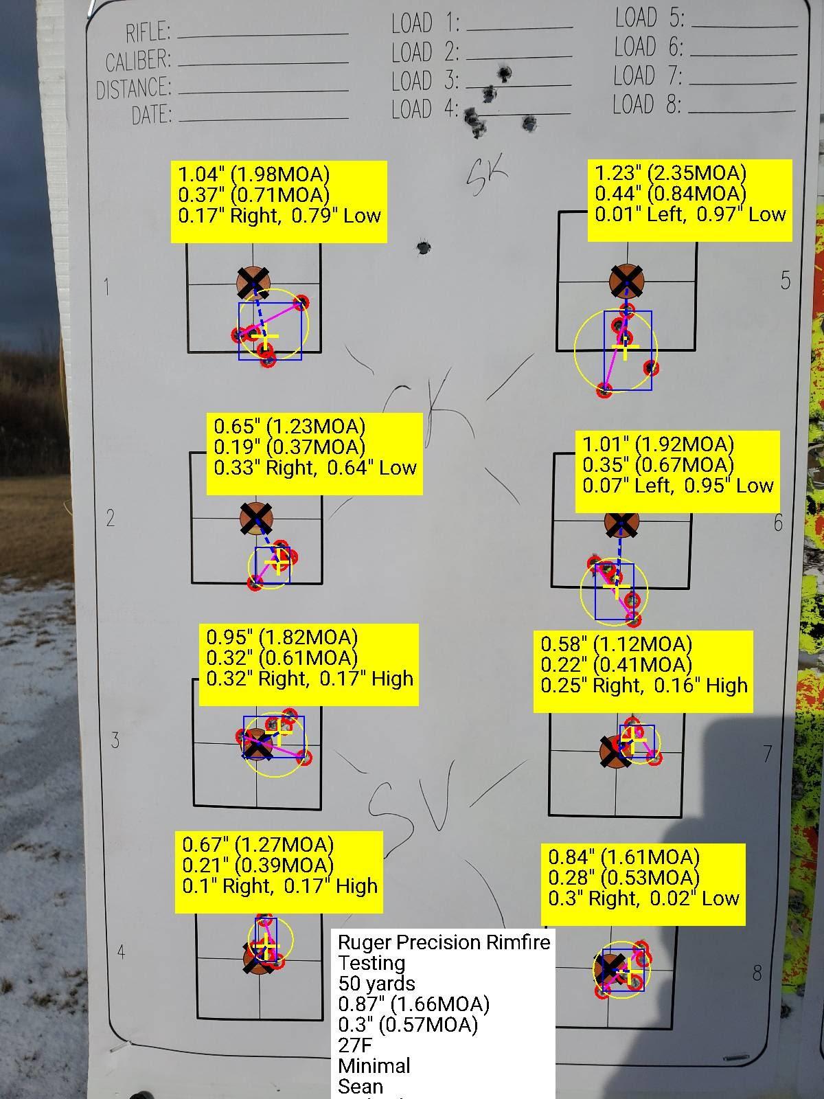

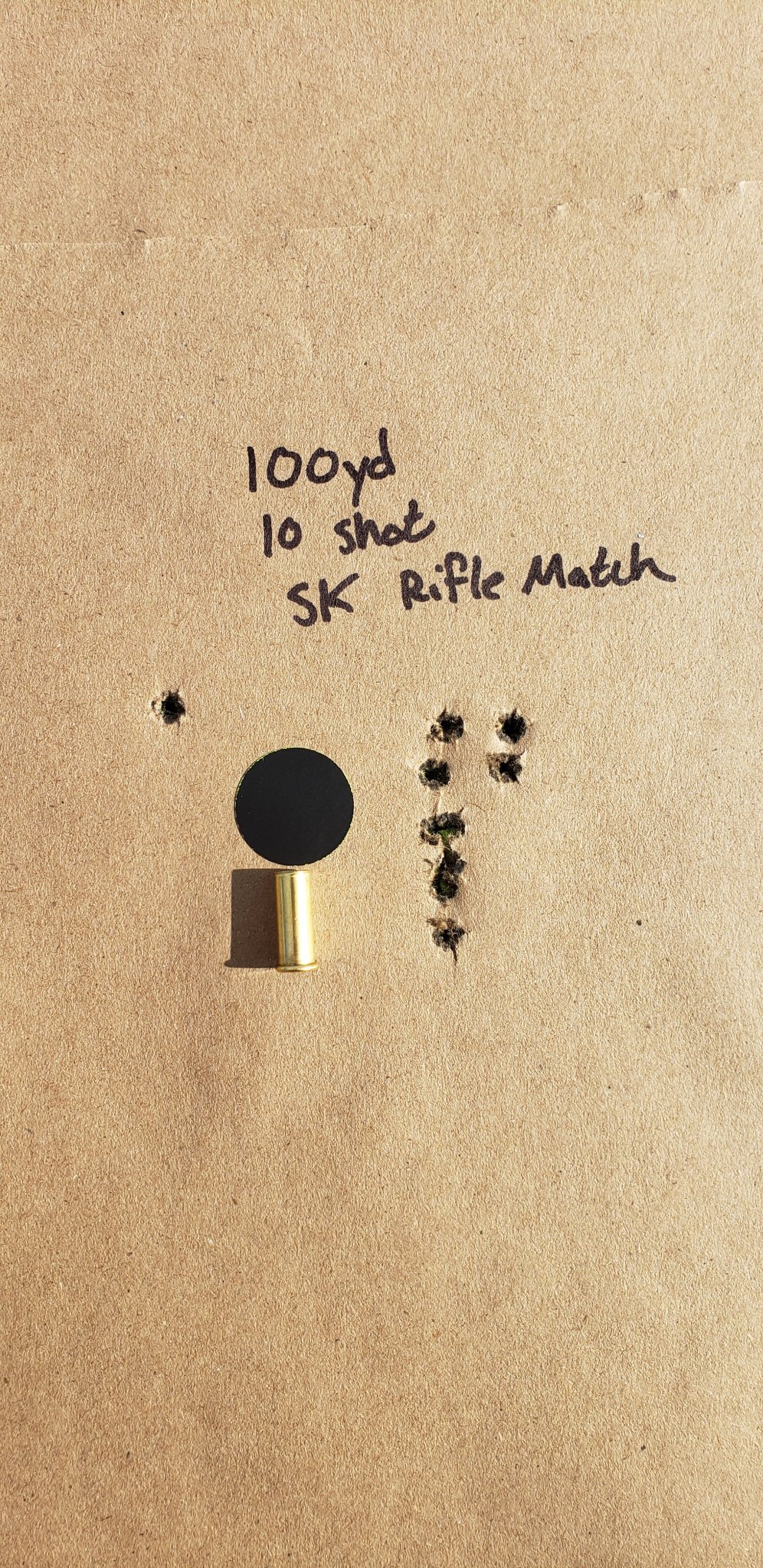

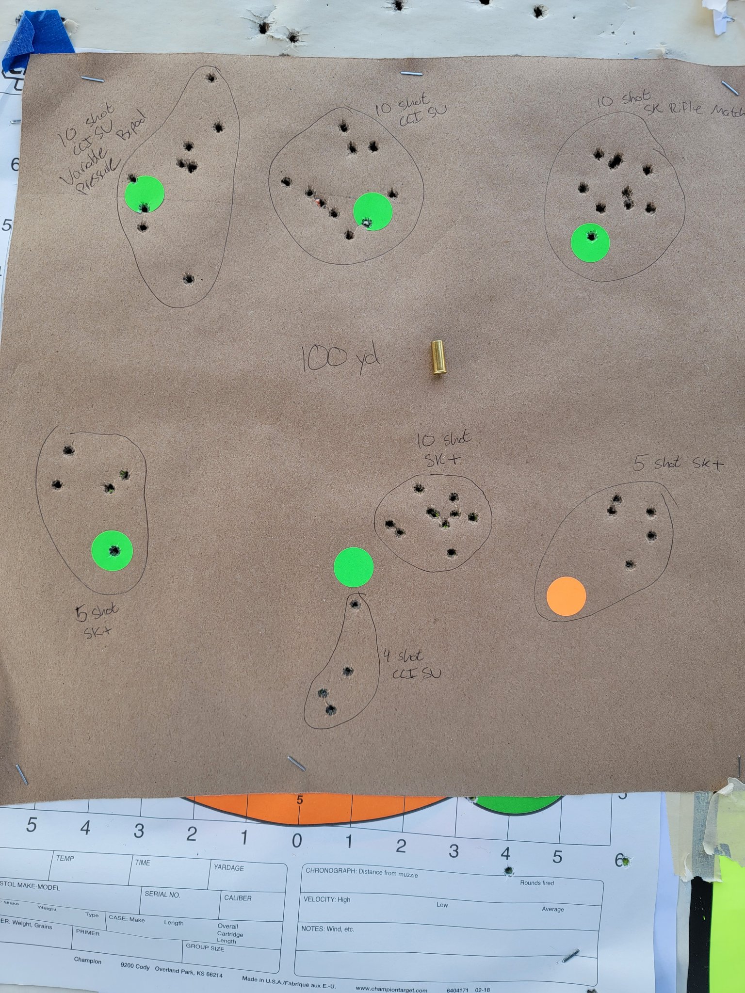

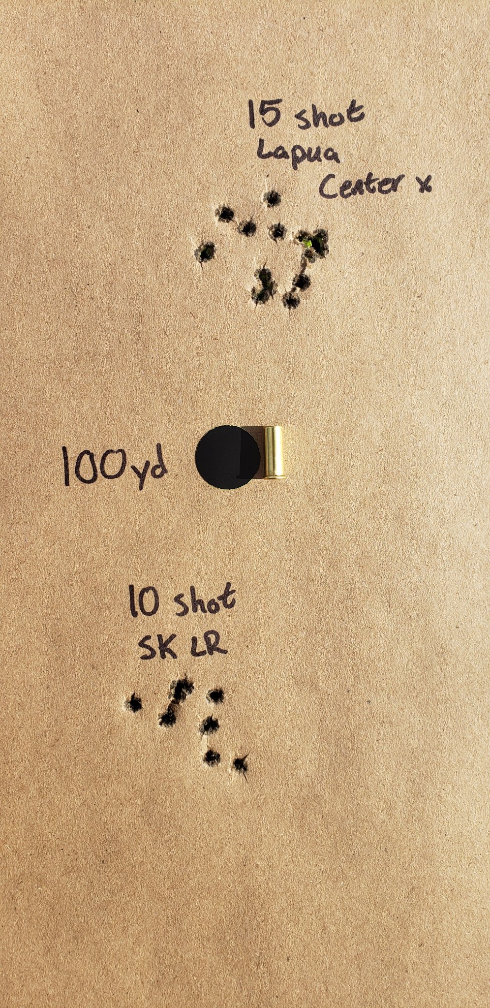

A little update...
I took the advice of some people both here, on Snipershide and Facebook and change one variable at a time. I did the foil bed and went and shot. I did notice an improvement, subtle at 50 yards, more of an improvement at 100 yards, but the biggest improvement was my group sizes with CCI Standard Velocity from before the bed. I think I can do better as a shooter but I also think the Shaw barrel is still going to benefit me. See most recent groups below. Dont mind some of the MOA callouts and stuff as I messed up the distance when creating some of the groups and didnt want to redo them. Call me lazy.
50 yards with SK Match and CCI Standard Velocity
50 yards with Eley Match EPS, 1 group of Federal Match HV, 1 group of Aguila Super Extra, and one more group each of SK and CCI SV
1st groups at 100 with each ammo, 10 shot groups. The 2nd group at the bottom right labeled SV may not be SV and is possibly the Federal Match HV. I kinda forgot which one I shot there, but that group does not match up to the rest of the SV groups.
I know the bedding did something because at my last outing, the SK Rifle match is the only ammo that would even group. Now I can group the CCI SV pretty well. SK Rifle match does not seem to like to shoot well at 100 yards though. I may use the SK for some plinking with this rifle or maybe for my indoor league in my other rifle, but I think I have to get my hands on some more CCI SV. I wont make up that decision though until the Shaw barrel gets installed.
Any opinions, advice, or things you see based on your experience that I may not know or see?

I will try Green tag again.it didn't shoot well before the bedding, but neither did SV. I love greentag in my Savage, but hate i can't find it. After the new barrel, ill like have another shoot off between SK Rifle Match, CCI SV, Eley Match and CCI Greentag and pick an ammo once and for all.
Does anyone shoot different ammo based on the distance they are shooting like CCI SV at 50, Eley at 100 plus?
I’ve shot both at 100 and both are .8-1.2 moa. I’ve put 5 in 1 hole at 50 with cci sv. Each barrel including the shaw will like different Ammo. my 20 inch Shaw likes federal auto match a lot. I have a ats tuner coming so I can play with the bulk I have. My Shaw is less picky than the factory ruger barrel. It also lowered the es and sd’s on just about everything in my safe by a good margin.

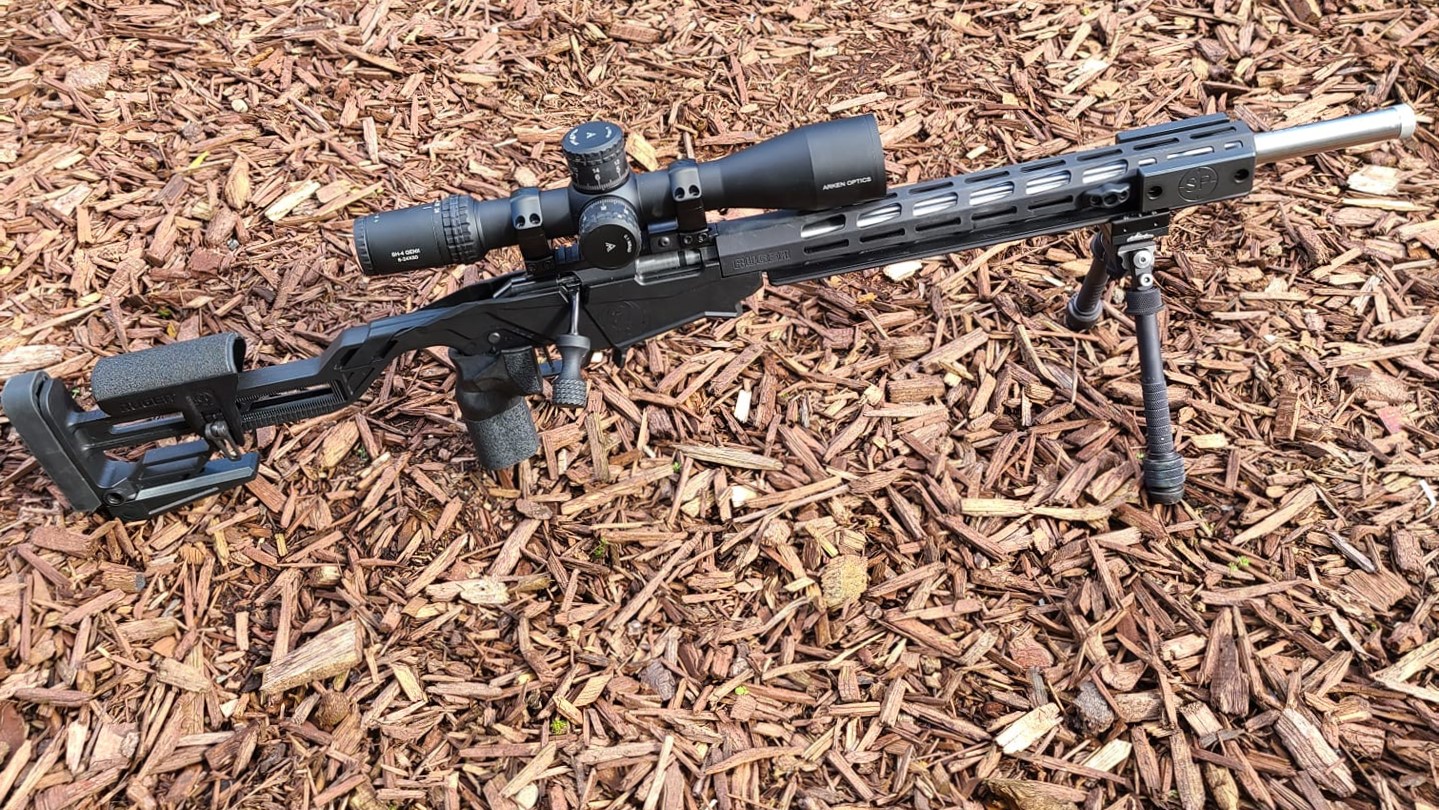

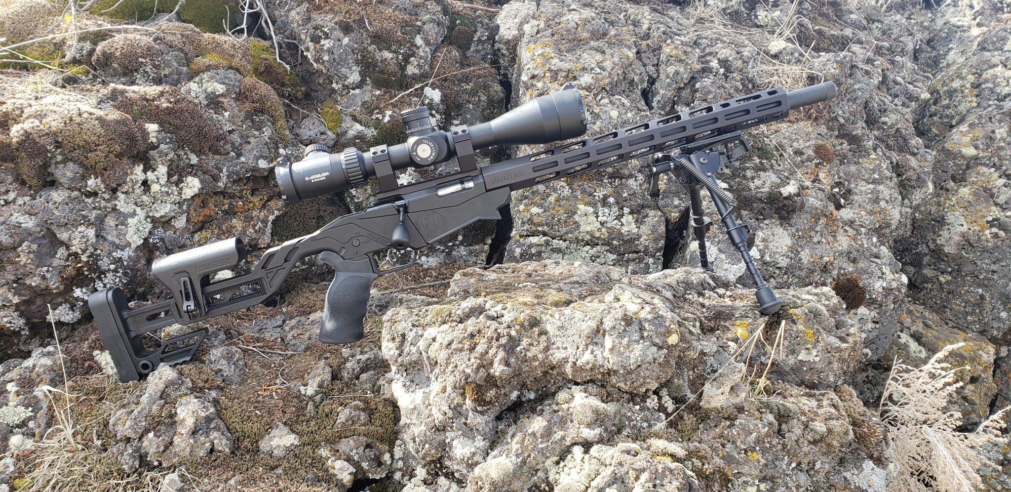

Got my scope in from Camera Land
Finally got the screws from Seekins for the ring caps, may have went a little overkill on the rings but oh well.
Accuracy wise the SK and Lapua was best and only ones even decent. The super hyper velocity shit was horrendously inaccurate as expevted but it did shoot flat. I have a brick of SK Standard + in the mail and hope to find some CCI Standard velocity to test too.
Overall I forgot how fun rimfires are.

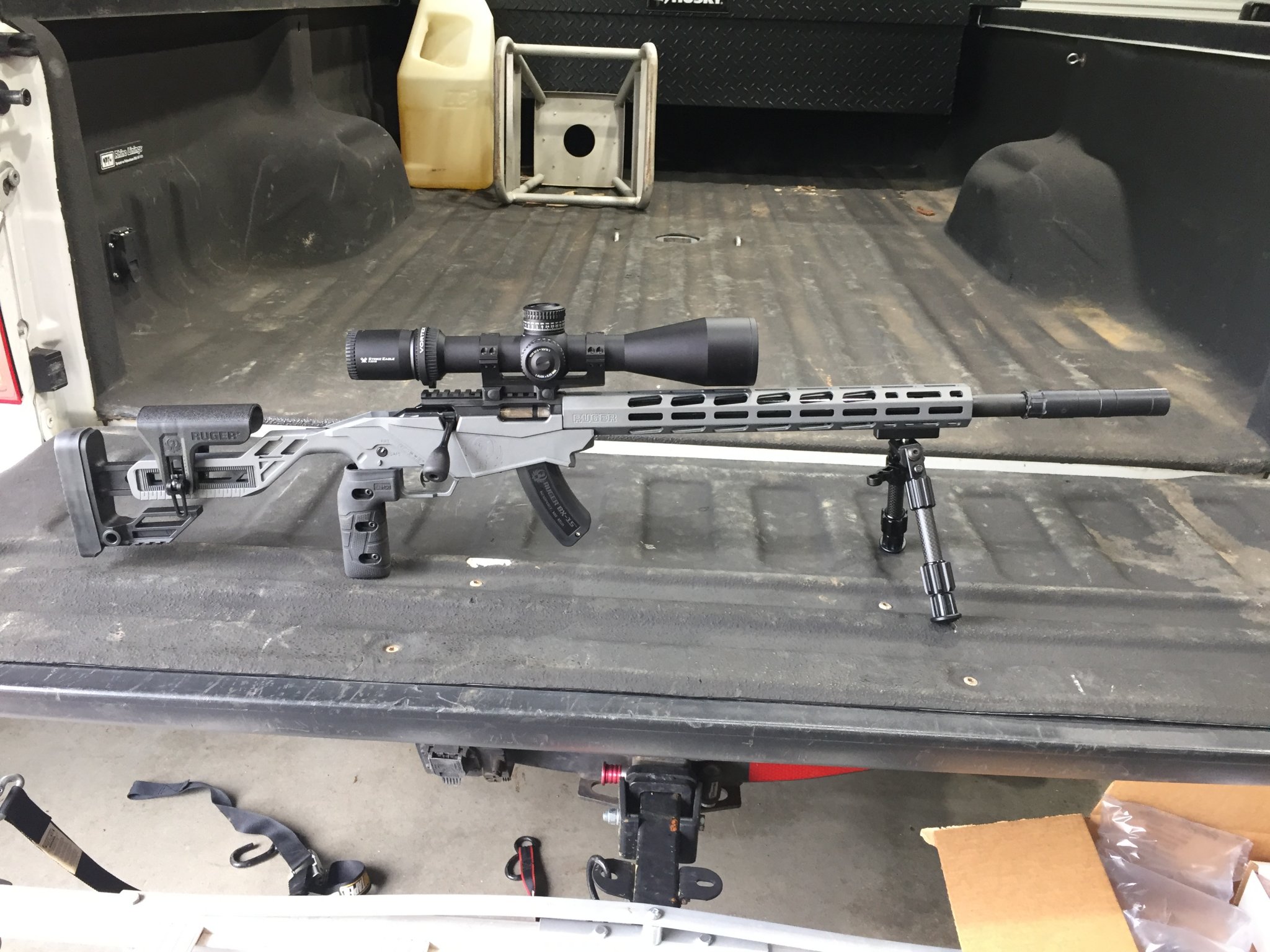

what optic is this??
Vortex Strike Eagle.
It looks like where you have the scope mounted you are losing the 20 MOA that the factory installed mount provides. Go with separate rings versus the all in one mount
1) It's not my rifle
2) Why would it lose the 20 MOA from the base, unless the scope mount has negative MOA? It wouldn't matter if separate rings or a one piece mount is used, the whole factory base is angled at 20 MOA.
Still fighting groups on this gun. I did discover today that ANY pressure on the bipod drastically changes POA/POI.. is this common on these little guns?
I have a SAP 10” MLOK ARCA rail on mine and no problems. I installed the mlok rail so I could use my Warne Skyline bipod that’s also ARCA that I use on my PRS rifle. Prior to the addition of the ARCA rail I experienced no impact issues when using a sling mount adapter for my Harris bipod S-BRM
Reactions: flyfisher117
Thank you. I'm at a bit of a loss what causes the huge swings. I have fully stripped the rifle and torqued everything twice. I tried the foil tape bedding and see no improvement, if anything it's a little worse.

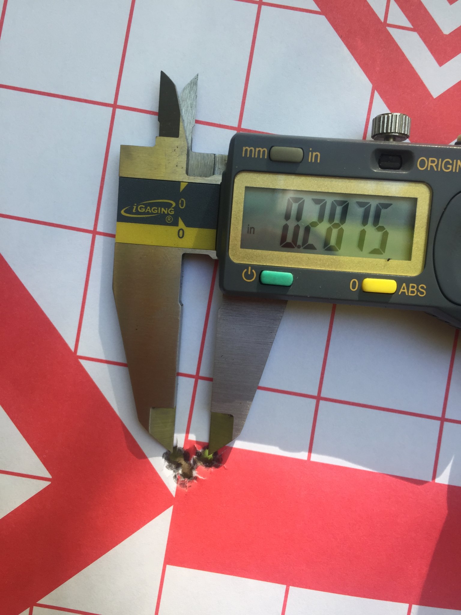

I’ve been pleased with my RPR rimfire. Accuracy was great out of the box. Sub MOA 50Yds/MOA 100yds. Using vortex 6-24x50 diamondback. I will be adding a Timney 2-stage straight trigger shortly from Anarchy. I blame my zingers on ammo and factory trigger.
I sight in from bench with a Sinclair heavy varmint w/windage and custom Edgewood Hunter front bag that fits my PRS with ARCA rail and less sand to get a good squeeze and tracking and with a Warne Skyline bipod and solo WC light when practicing
