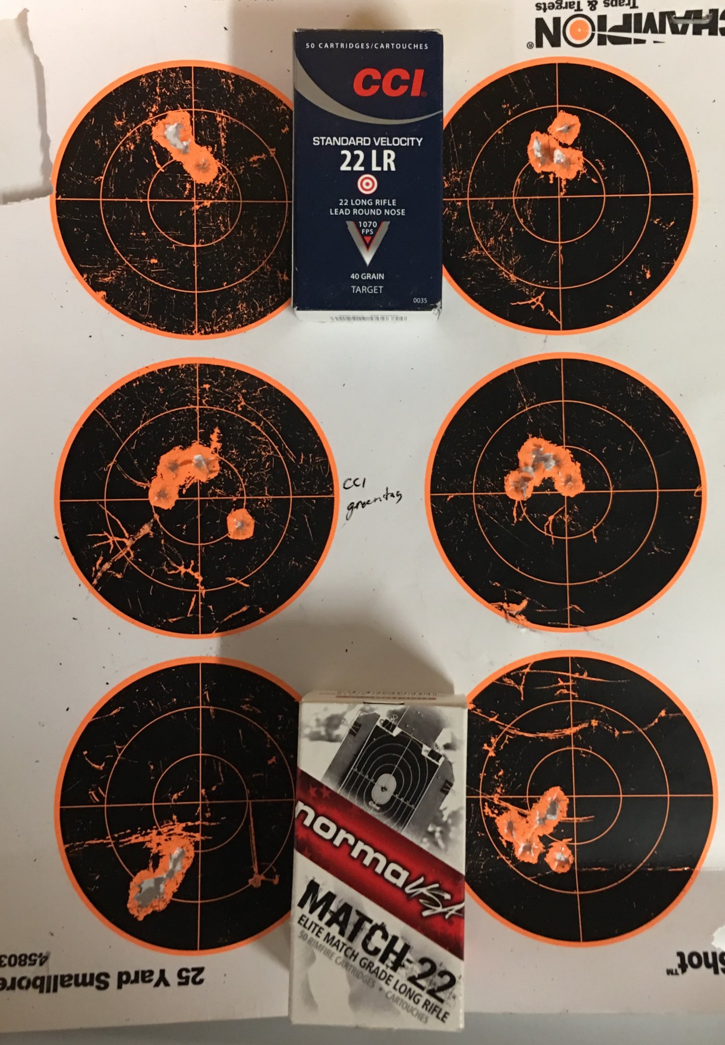

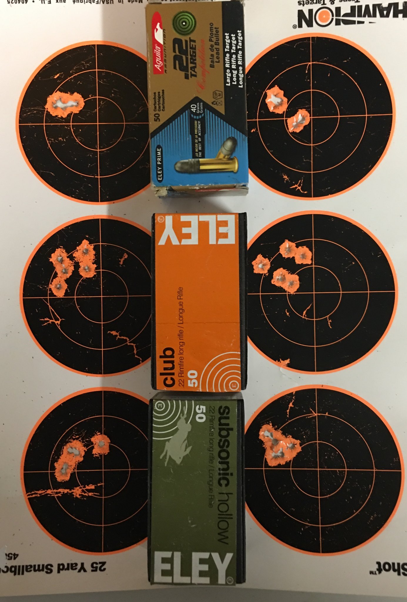

My factory barrel was quite accurate but had occasional fliers. 50 yard groups were regularly .5-.75” for 10 shot groups, 100 yards it would throw a good 1-1.25” group, 5 shot, and then 2-3”. No real rhyme or reason.
I picked up the green mountain 16” barrel hoping it might be a bit more consistent. I’ve only got about 300 rounds thru the GM barrel but so far it is more consistent. 50 yards is still .5-.75 and 100 yard groups averaging 1.5” but consistently, no more odd large groups. 200 yards is still running 2+ MOA. Clay pigeons or 4” gong are no problem at 200 and a 9x12 plate at 300 no problem.

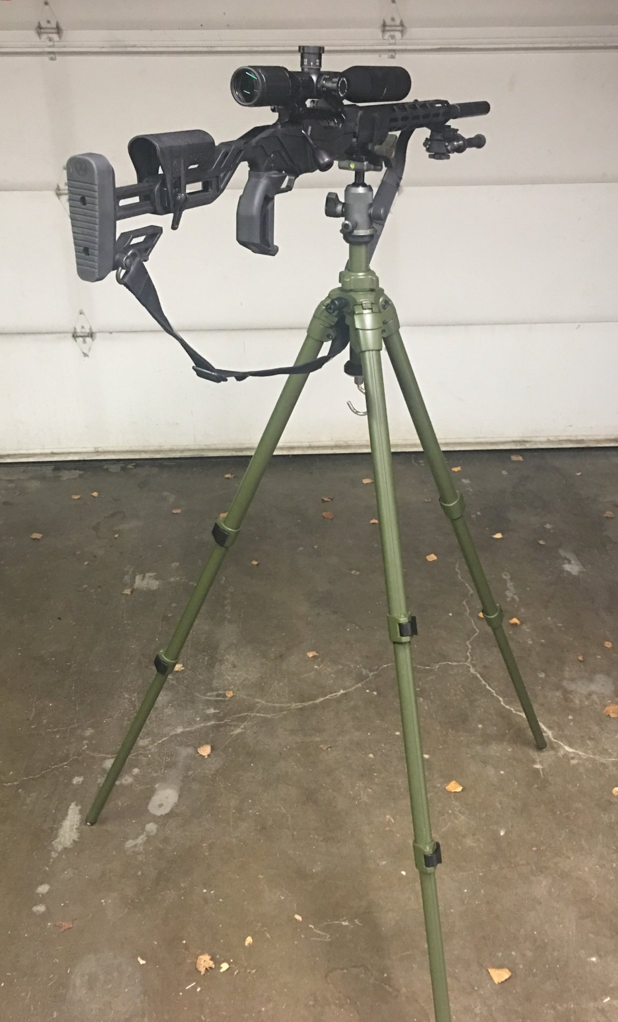

I put a vertical grip on mine and find it more consistent. While it’s no vudoo it is very good considering the price tag. I’m really liking forward to the timney trigger upgrade.

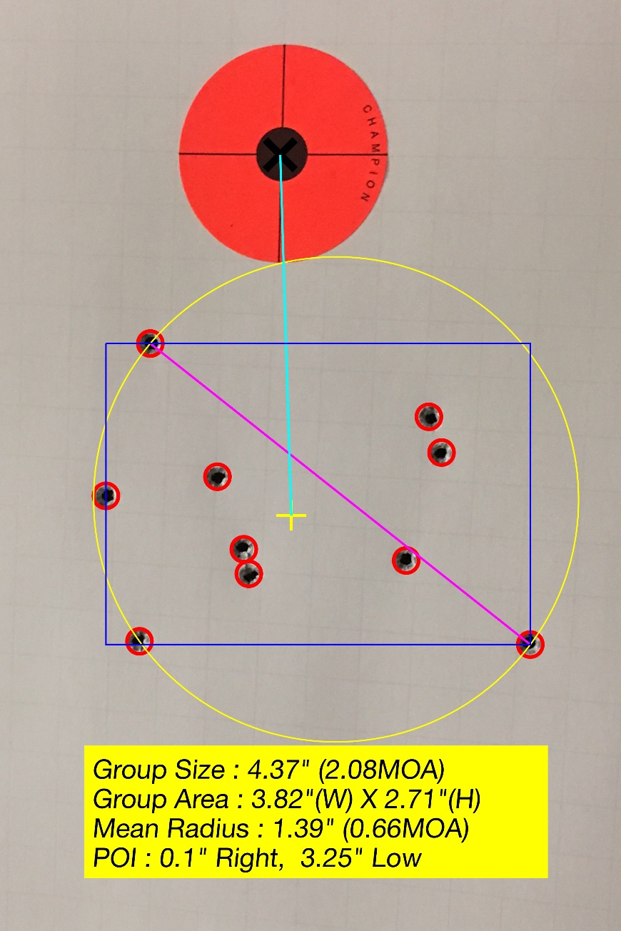

I'm having trouble with flyers. 2-4 shots will be nearly touching at 50 yds and then 1-2 will be off by quite a bit. Sometimes more than an inch or two. It's pretty frustrating because I know it has a ton of potential. I'll have to try some more ammo and see if it likes anything that I haven't used.
