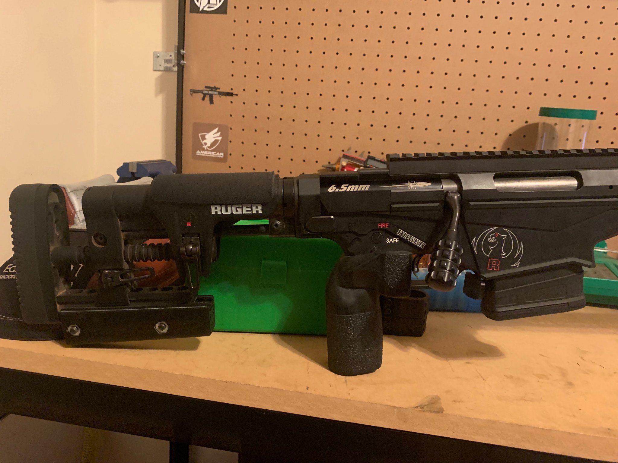

XLR butt stock was a major improvement to my Ruger I had several years back. You might also try to turn the cheek piece around backwards. God A Grip sells high-quality stick-on sorbothane pads. Good luck.
I cut out a "cheek pad" from a glock cleaning mat and glued it over the stock cheek pc...the mat is prolly 1/4 inch thick and not super squishy....alot more comfy when sending 80-100 rounds a secession.
You can also reverse the cheek piece and the longer portion will face rearward. I also suggest ditching it all together. Magpul PRS gen 3. With hoptic cheek pad is a good choice.

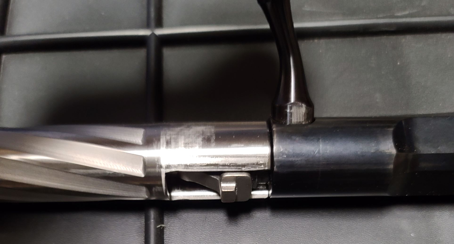

I purchased the RPR in 338LM and before going to the range, I swapped out the stock for the Magpul PRS Gen3. The problem I am having is that the bolt is not able to travel far enough back to pick up the next round in the mag. Its stops about half an inch or so short so I end up having to nudge the round with my finger so the bolt can pick it up. I tried it with the bolt shroud tool cover removed to see if it is hitting something internally and it's not. When I open the folding stock, I can see markings on the bottom of the buffer tube where the firing pin back plate hits the buffer tube and then apparently stops at the end of the threads of the tube. I used a mil-spec rifle buffer tube with the new stock. Any ideas what would cause this or how to fix it?
Thanks for the help!
I purchased the RPR in 338LM and before going to the range, I swapped out the stock for the Magpul PRS Gen3. The problem I am having is that the bolt is not able to travel far enough back to pick up the next round in the mag. Its stops about half an inch or so short so I end up having to nudge the round with my finger so the bolt can pick it up. I tried it with the bolt shroud tool cover removed to see if it is hitting something internally and it's not. When I open the folding stock, I can see markings on the bottom of the buffer tube where the firing pin back plate hits the buffer tube and then apparently stops at the end of the threads of the tube. Any ideas what would cause this or how to fix it?
I'm not sure what is going on. I dunno how different a long action is vs a short action. Did it work fine before you put on the magpul stock? I have had no issue like that with mine
I didn't think to try cycling rounds before swapping the tube and stock. I assumed it would be good to go since it was a standard buffer tube swap and no reported issues using the PRS stock. In hind sight, I wish I had tried the factory stock first.

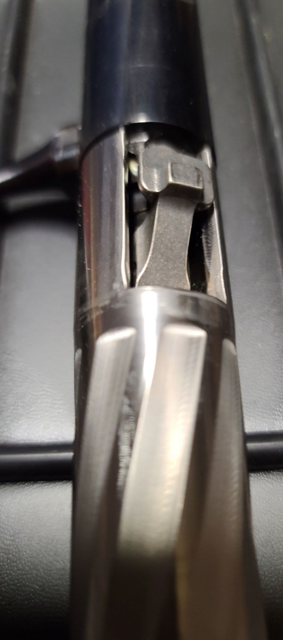

That's what it looks like. It shows signs if marks in the back half of the folding section that the buffer tube screws into and clear marks on the lip of the tube that it is apparently hitting and stopping rearward motion completely.
WTF, post a pic of the tube wear the marks are and a pic of the cocking piece. My phone keeps trying to auto correct to cooking piece
Reactions: KDFWSGT
Is the rear side of that cocking piece have a sharp corner? If so can polish it with 2000 grit sandpaper with a little oil on the sandpaper to a mirror finish so it doesn't catch.only do the rear ward side if the cocking piece if it is sharp
It's not overly sharp but I can try to polish it to see if that helps. The bottom edge is dragging across the the first part of the tube and then the flat edge hit the lip if the buffer tube threads. It's pretty odd.
So what I would do is knock that edge down on your tube. Get it smooth. Polish that with high grit sandpaper and then run your bolt slow and see if it still catches. If it doesn't fix it then you can try polishing the rear side of that cocking piece and see if it helps. I bet the tube itself had a burr or something and the cocking piece just smashes it over and it progressively got worse. So start with smoothing out that tube, get it sanded down to a mirror finish and go from there

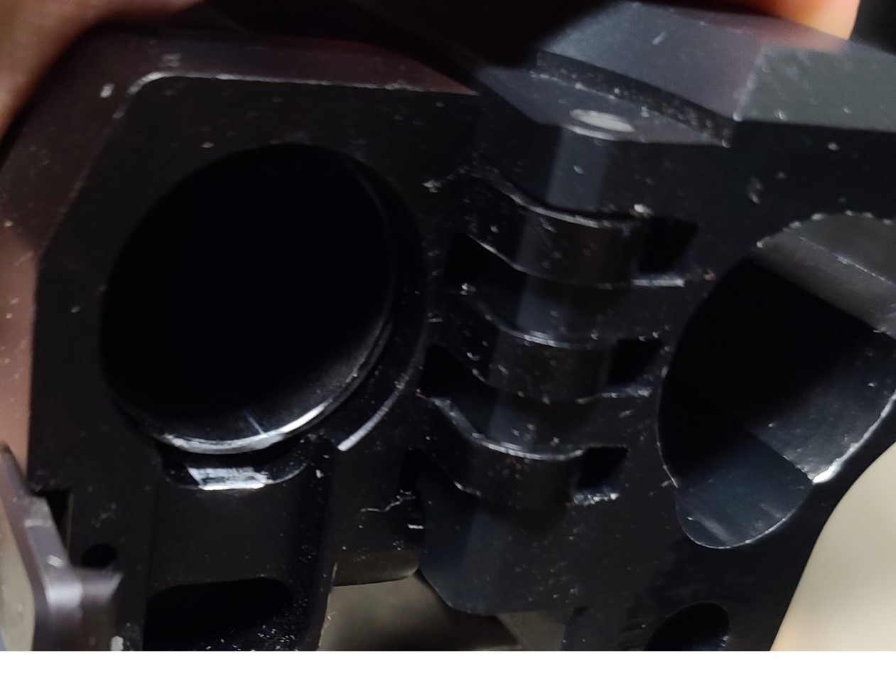

Jmkjr87- I figured I would circle back and let you know how it went. When I dug out the factory stock assembly I realized the carbine buffer tube that is uses has a section cut out in the threads to allow for the cocking piece to travel far enough back to pick up the next round. I ended up removing the rifle buffer tube that I installed for the PRS stock and used a dremel to remove the same section in the threads so it would work.
I took it to the range this weekend and it worked great. I appreciate your help!

Very nice you got it fixes. I've never looked in my tube before but now that you say that it makes since, there's gotta be room for that cocking piece to clear
No. You can use any buffer tube. You just have to use the middle piece that’s correct for the standard tube.
Ok thanks. Have you ever done this swap? Looking at my stock rpr stock ha I can't figure out how to get it off. Not much online I could find either.
I just did it.
My PRS came with the "Carbine" connector already installed on it. If you want to use a rifle length buffer tube, you need to switch the connectors on the PRS. But you won't need to do that on a standard issue RPR in .308 (which comes with the carbine buffer tube).
I have the RPR in 338 LM and switched the stock out to the PRS Gen 3 as well. Switching to the rifle length buffer tube provides a definite benefit for a solid connection to the receiver. The rifle is heavy so it helps for a better lockup on the rifle buffer tube with the screw into the back of the tube when installed.
One thing I found out the hard way, when you remove your buffer tube, you will notice a small notched cutout in the threads. This allows the cocking device room to travel back so the bolt can pick up the next round. I ended up removing the tube and using a dremel with a cutoff wheel to cut the same size section so it would function properly. You will need to install the tube to mark the spot that will need to be cut out first.

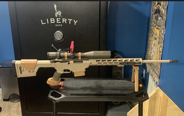

I wish I had joined Sniper's Hide and read this thread before buying a stock for my Ruger Precision Rifle. I bought a Magpul PRS Gen 3 stock and installed it with the short adapter. The length of pull was 15-1/8", which is way too long for me. 13" to 13-1/2" is in the comfort range for me.
I ditched the adapter, cut down the front of the stock and cut 1-1/2" off the back of the receiver extension. This shortened the minimum length of pull to 12-7/8", which works well when wearing heavy winter clothing. There is enough adjustment in the stock to extend the length of pull to 14-1/4" and enough room in the receiver extension to clear the end of the bolt when cycling the action.
I cringed at the thought of cutting down a $250 stock, but it worked and doesn't look bad.
