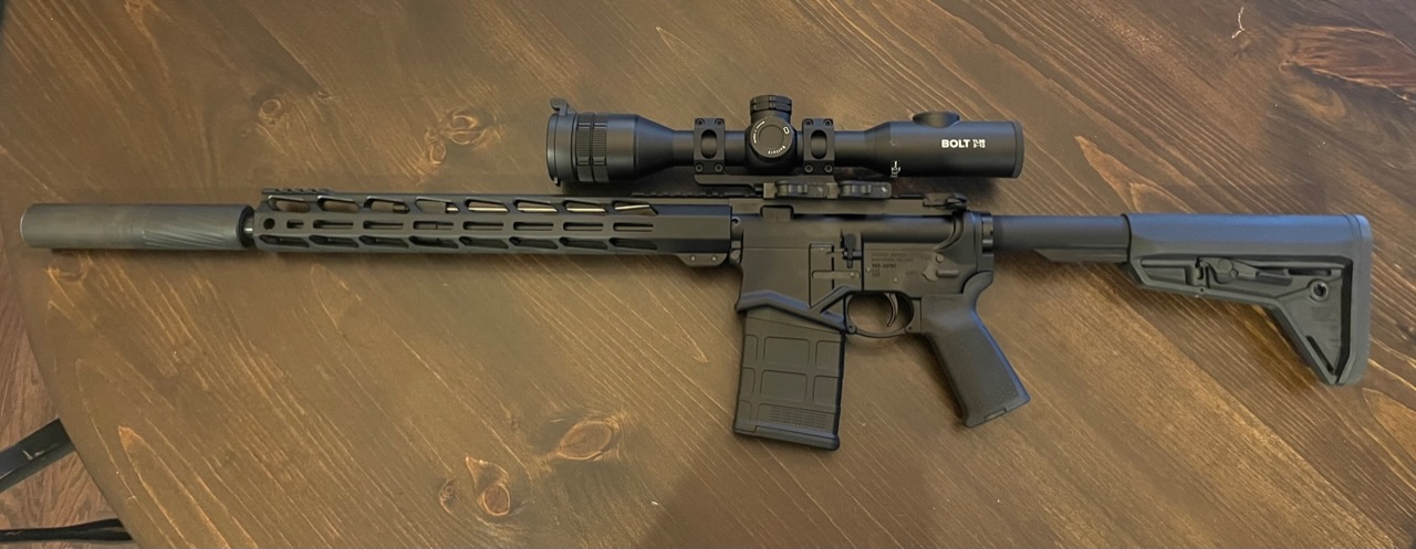

Also, as for the flyers. Thiers minimal space between side of gas block and rail. Maybe the gas block is contacting the rail when barrel whips?

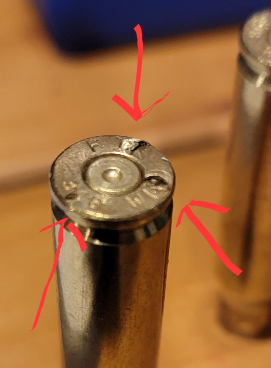

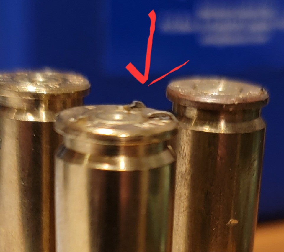

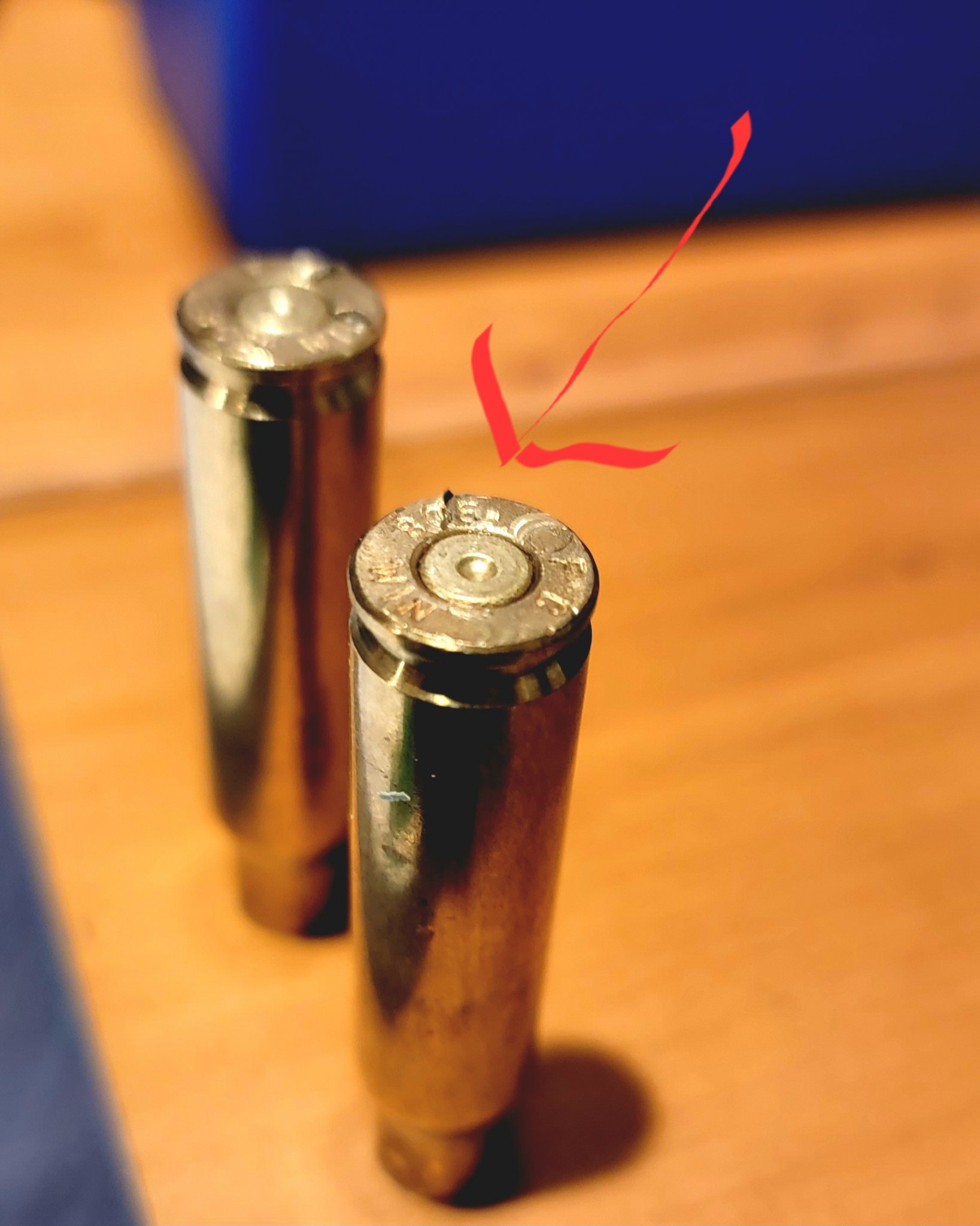

Appears the ejector is flat-faced with sharp edges. Round it off by chucking it in a drill and holding it at varying angles against a sharpening stone. It can be spherical on the end and it won't hurt anything as long as you don't shorten the total length. Could possibly help with fliers as well.
To some extent I think it's the nature of the beast with a mid-length gas LW .308, my Rogue slapped brass around too.
That said, it looks like you're making things worse by not turning the gas down to 2, and maybe by running loads a bit too hot. What's your load in that Fed brass? I've been playing with Fed, LC LR, Win and SSA brass lately and Fed has similar capacity to LC, but is softer, takes me a grain more or so for equal velocity in Win brass. My SFAR was rough on brass like that, with bolt gun loads, got better when I dialed things back a bit. I'm now using 165gr TGK over 40.3gr Ar-Comp, and 150gr IL over 41.8gr in mine with Fed brass, 0.2 more on both with LC brass.

this isnt the "the nature of the beast" and that ejector swipe is a sure as shit sign its unlocking to early
When the beast is a mid-gas .308, especially with limited gas adjustment, it's been my experience that early unlocking is usually part of their nature. Hence the common use of intermediate gas, and why some folks are buying the 30" rifle-gas and cutting down. OP having the gas turned up certainly doesn't help an already sensitive setup.

I was thinking about it and may still try it. I think I have a spare Seekins block somewhere.
I only hesitate because I think if I did that and got it down to a point where it didn't destroy brass then it wouldn't cycle at all. Maybe a lighter spring would be needed but then that light BCG isn't supplying a hell of a lot of inertial dampening so it might just squeeze the balloon and move the problem someehere else. Less gas might require a lighter spring but make the spring too light and maybe it brings back the early and egregiously sharp unlock.
I think the Stoner lightweight BCG is something like 15oz, I think JPE has one around the same weight as a AR15 BCG, I think my DPMS BCG is heavier than any of that (18oz? 20oz?) and when I put the SFAR BCG on my wife's super scientific and extraordinarily accurate cucumber scale it eyeballs somewhere between 10oz-12oz. The point of all that noise being maybe it would be worth the time to find something that runs reliably and well with a lighter BCG then work backward from there looking at gas port sizes, spring weights and buffers.
ETA: this thread over on 308AR seems to speak to what I'm talking about when I say "squeeze the balloon" ... a properly functioning AR has a balance of timing and force between gas, spring, tube, buffer and bolt so changing just one thing is probably not enough
My 20" SFAR has only chewed up a single brand
If there was only one brand of crappy ammo this rifle chewed up I'd probably do the same but 5 different brands/weights of ammo that work fine in every other gun I own all get chewed up in this rifle. I haven't yet identified any ammo this thing won't grind.
The issues that are out there seem to vary a lot. Some people trace their problems back to a loose gas block and for others it's something different. Other than you, I can't say I've seen anybody who's happy with the way theirs runs who has talked about the brass other than how far it throws the brass and where.
