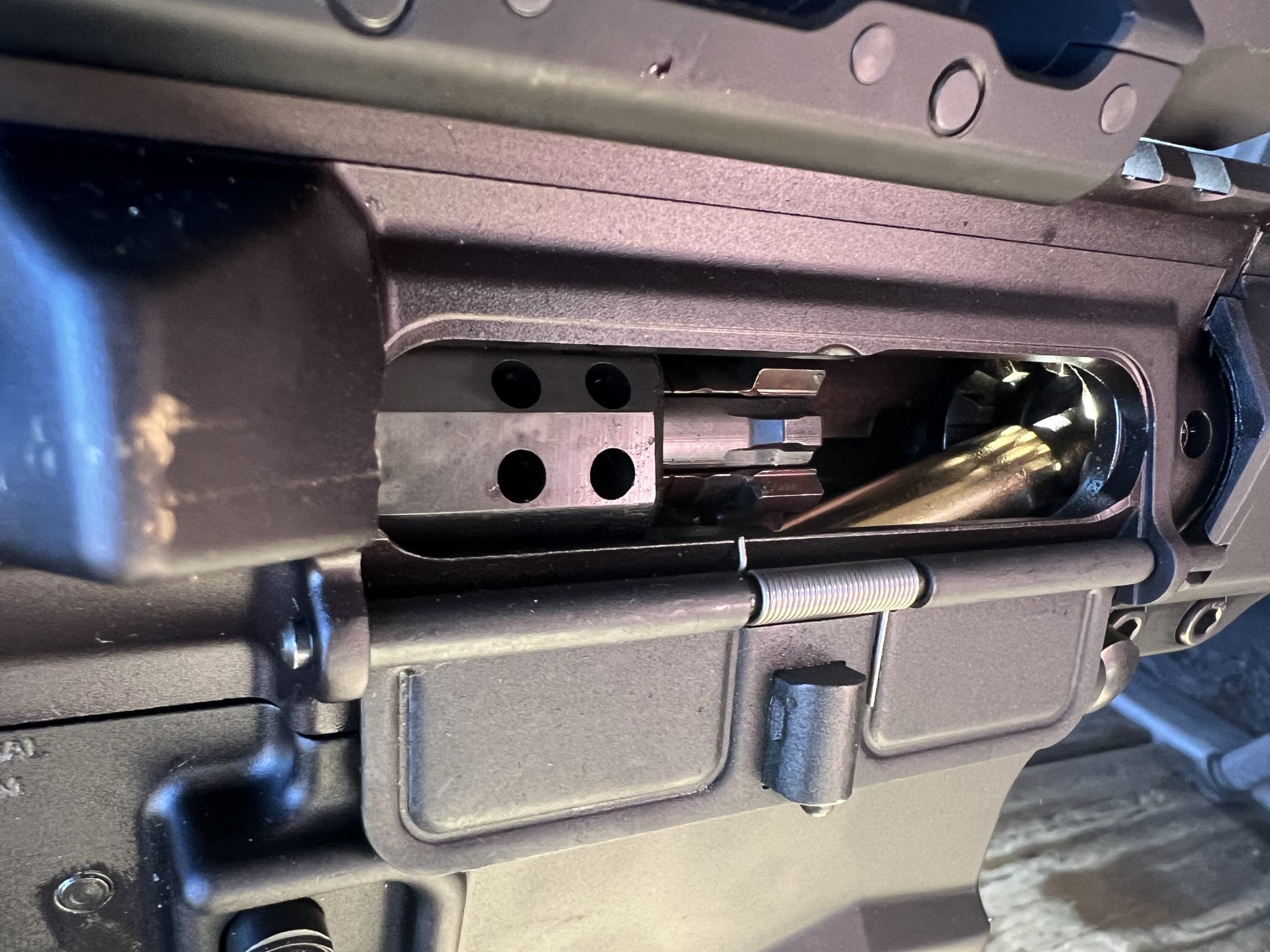

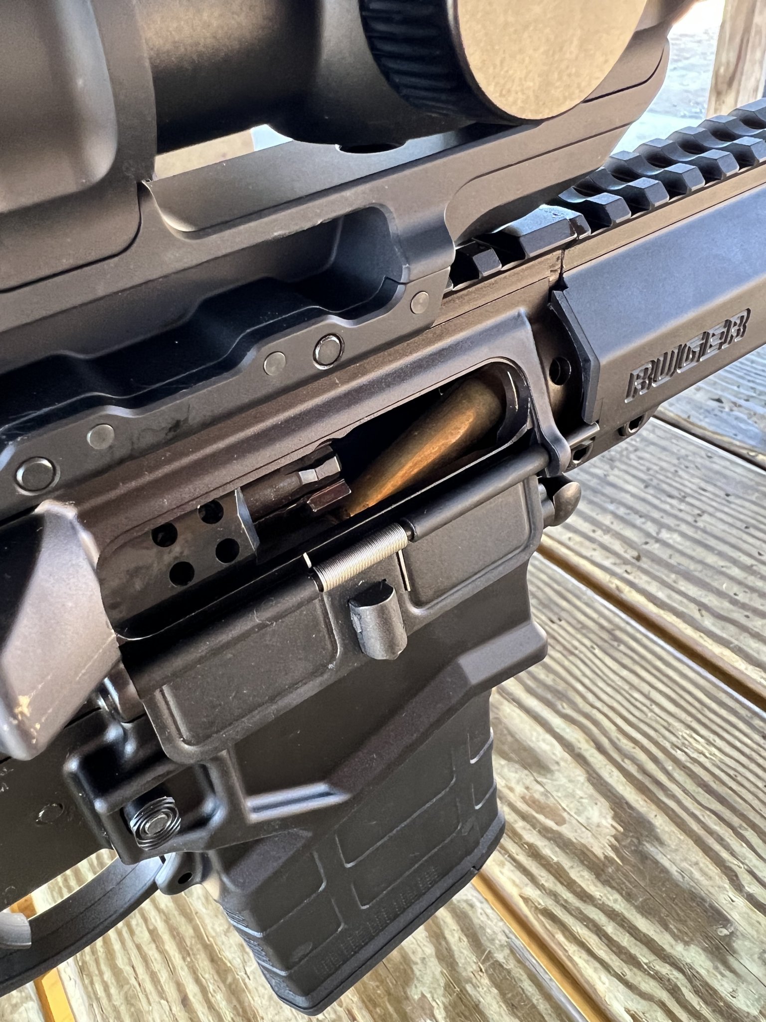

Hello All,
I’ve had the same issue with various ammo. Any thoughts on the problem?

Are you using the same magazine, not brand of mag, when you're having the failure to feed?
This could also be indicative of the gun being undergassed and short stroking but it could also be the gun isn't lubed up, that bolt looks mighty dry.
Start diagnosing the problem by eliminating one variable at time.
1. Try a new magazine. If it works, that was the issue, don't use that magazine again.
2. If a new magazine didn't solve the issue, try lubing the rifle.
3. If a well lubed rifle is still short stroking it could be undergassed, at which point you may have to contact Ruger.
I don’t claim to have the knowledge of some of the guys here - fixing an over gassed large frame AR is what brought me to the Hide . And that bolt over rim looks exactly what I was dealing with and have felt with 2 more times with large frame ARs that were heavily over gassed .
Like others have stated - adjust that gas setting.
And keep us updated on the SFAR- when you get this worked out , accuracy- durability ect. I’ve been window shopping on them but have yet to see an example in the wild.

Mine was doing this when new. It’s fine now and running suppressed on first gas setting. Just get a few boxes of ammo through it, try it on 2 as it seemed over gassed on 3 to me.
Reactions: msgriff
Yeah, judging from my SFAR, I'm guessing it's over gassed and outrunning the mag on setting 3 as opposed to undergassed. Turn it down to 2 and try it again.
Reactions: msgriff
Wait a minute, this looks confusing to me, but seems like something that is well-known-enough that others are not surprised, so let me ask:
How is it that the round is leaving the magazine if the bolt is not grabbing/pushing it by the rim on the way forward? Is it the "momentum" from the mag spring/follower combined with the friction of the bolt on the surface of the shell casing?
Looks like a bolt over base failure to me:
The SFAR spring is already pretty stout, but the buffer is a standard carbine. Step 1 would be turn the gas down to setting 2, as viewed from the right side of the rifle. That will probably fix it he's running wide open now, if not he can try heavier buffers. I've used an H2 suppressed and it has been running, might go down to an H1 and see how it does.
Thanks for all of the helpful replies. I've tried another magazine, set the gas block to 2, dissembled the BCG, and lubed it. The bolt is super tight in the carrier, I've been working the bolt, and it's considerably better now. I spoke to the folks at Ruger today, and they want me to send it back. I think I'm going to try it again now that it's loosened up a bit before I send it back.

Easy answer. When you have short-stroking or excess cyclic rate and the bolt rides over the cartridge, the carrier face hits the rear of the cartridge and forces it forward and up the feed ramp, pinching it between the bolt and the carrier. This is called a Bolt Override Malfunction, one of the several types of Failure To Feed malfunctions that are possible.
This often damages the cartridge so that it won’t fit inside the chamber anymore.
Way to diagnose whether you have excess or too slow cyclic rate is do the single round in magazine test with LRBHO, and also look at the ejection pattern. Ejection pattern isn’t a 100% legitimate method, but is worth looking at to see if you have a forward ejection pattern, or one that is more into the 3 or 4:30 direction as seen from above the rifle.
LRBHO?
Okay.(y)
My understanding of "bolt override" is when the round gets above the bolt ("overrides" it... or, "rides over" it) and as a result, fails to chamber.
As for the carrier face pushing the bolt, that makes sense to me in the context of the magazine sitting too high in the mag well. I'm trying to imagine other scenarios that might cause this other than an out-of-spec mag or out-of-spec lower... (?) I'll take one apart later and try to see what you're saying. Thanks for the explanation.
Okay.(y)
No, it's not the round getting above the bolt, it's the bolt overriding the round. As has been explained, the BCG velocity is too high, so it outruns the magazine's ability to push the next round up in time. So the next round is not yet far enough up in the correct position when the bolt reaches the point where is should be pushing the case head to force the cartridge forward out of the magazine and into the chamber. Instead the cartridge comes up when the bolt is further forward than it should be, and an edge on the BCG pushes the cartridge partially out of the mag before it gets pinned against the barrel face or feed lips.
Yeah I get that. Jogging my memory, maybe what I was thinking of was "brass over bolt."
But when I do an image search for "bolt override" I get this:
