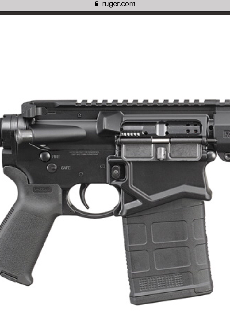

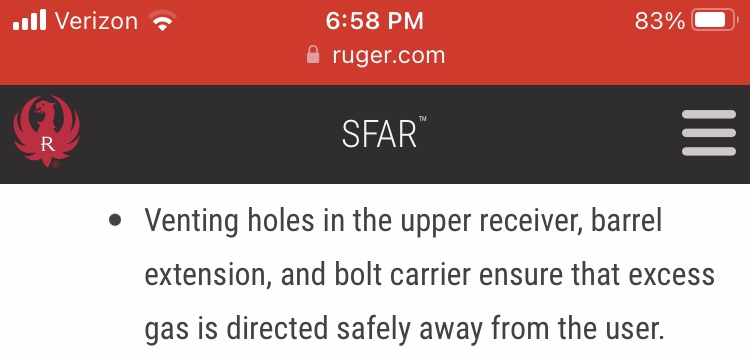

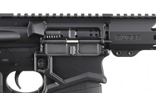

    Anyone have any idea what the extra 4 holes in the bolt carrier are for ?

    Curious too.

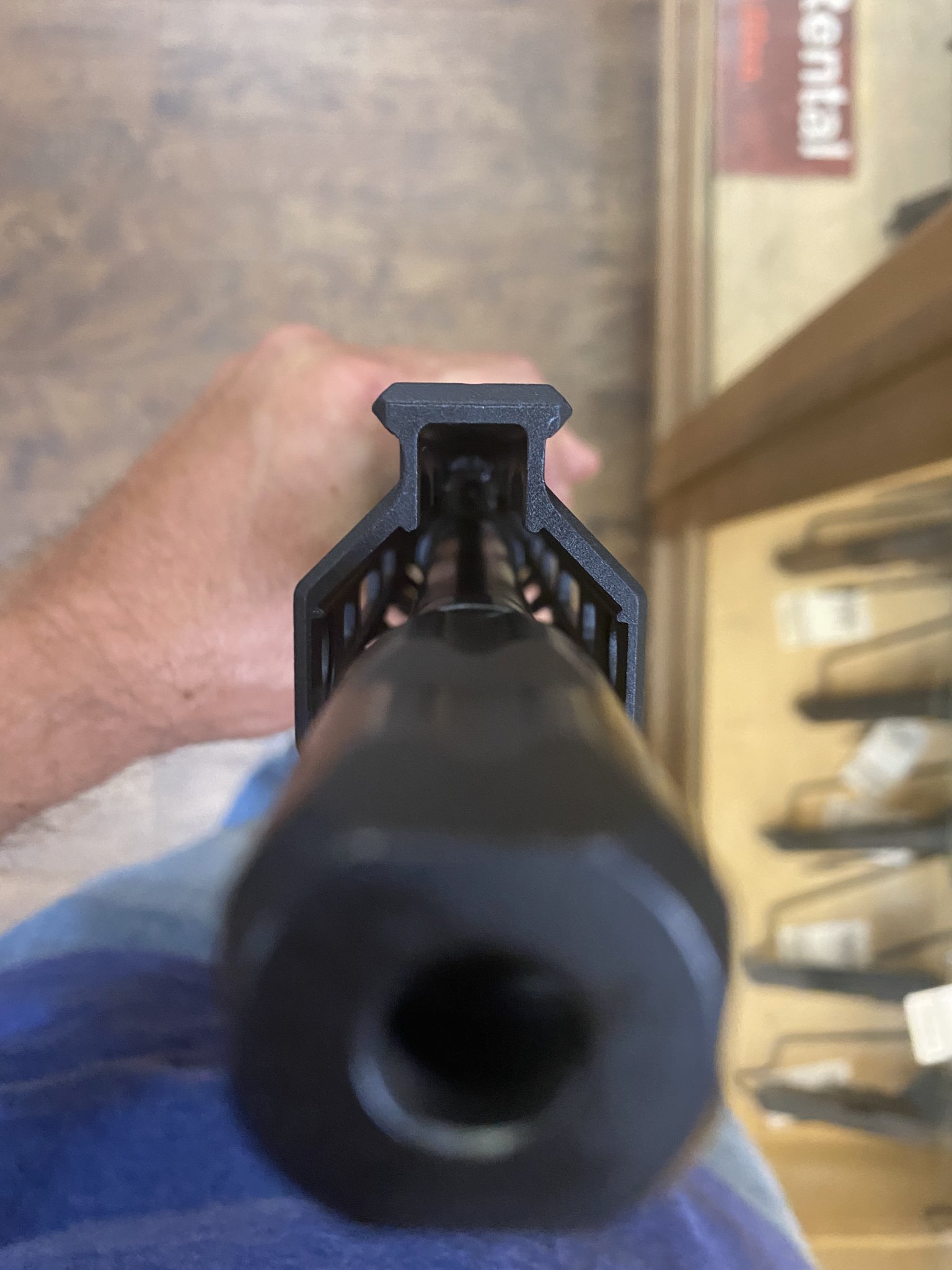

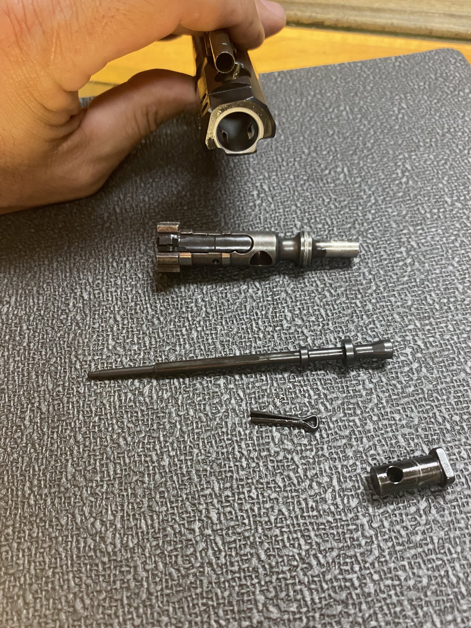

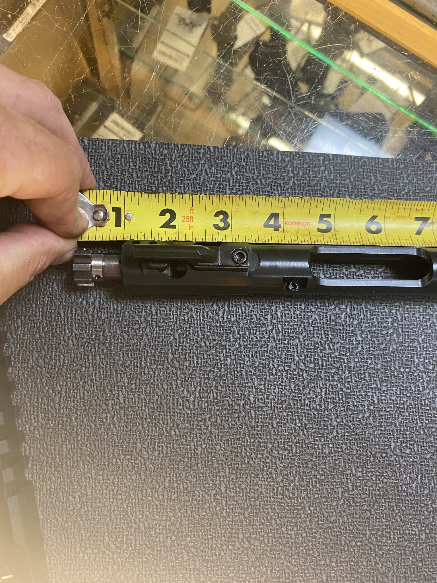

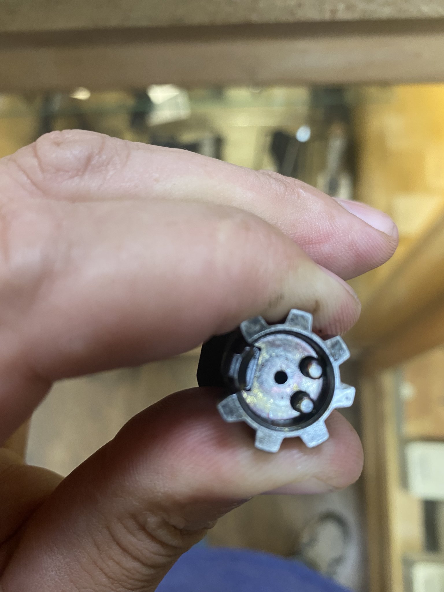

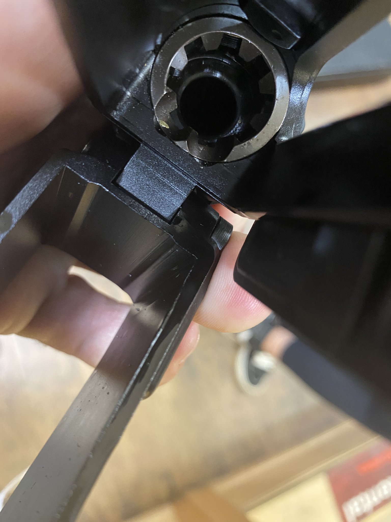

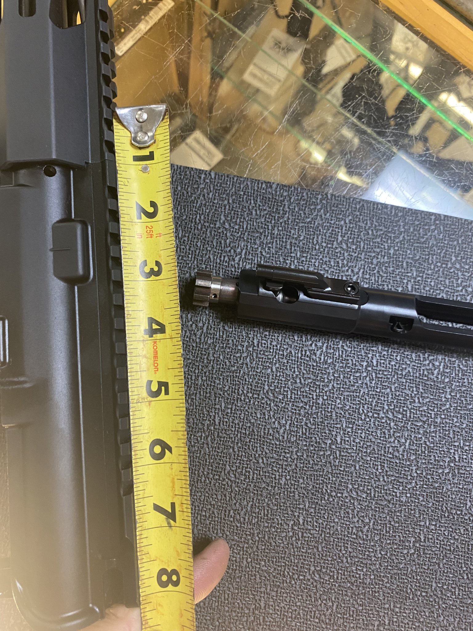

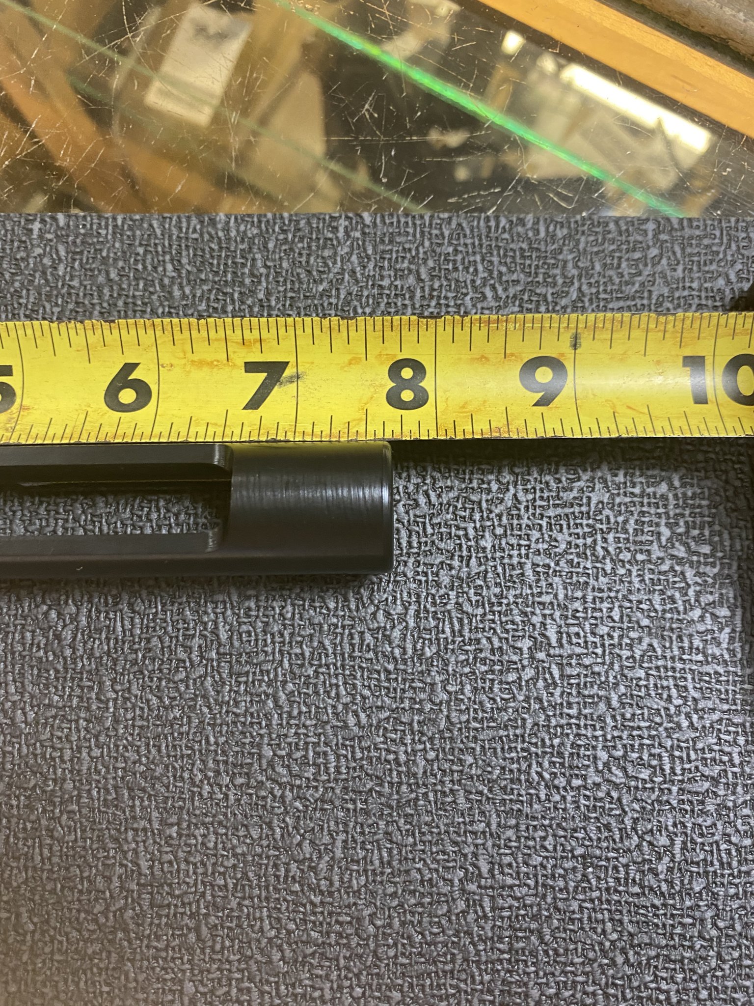

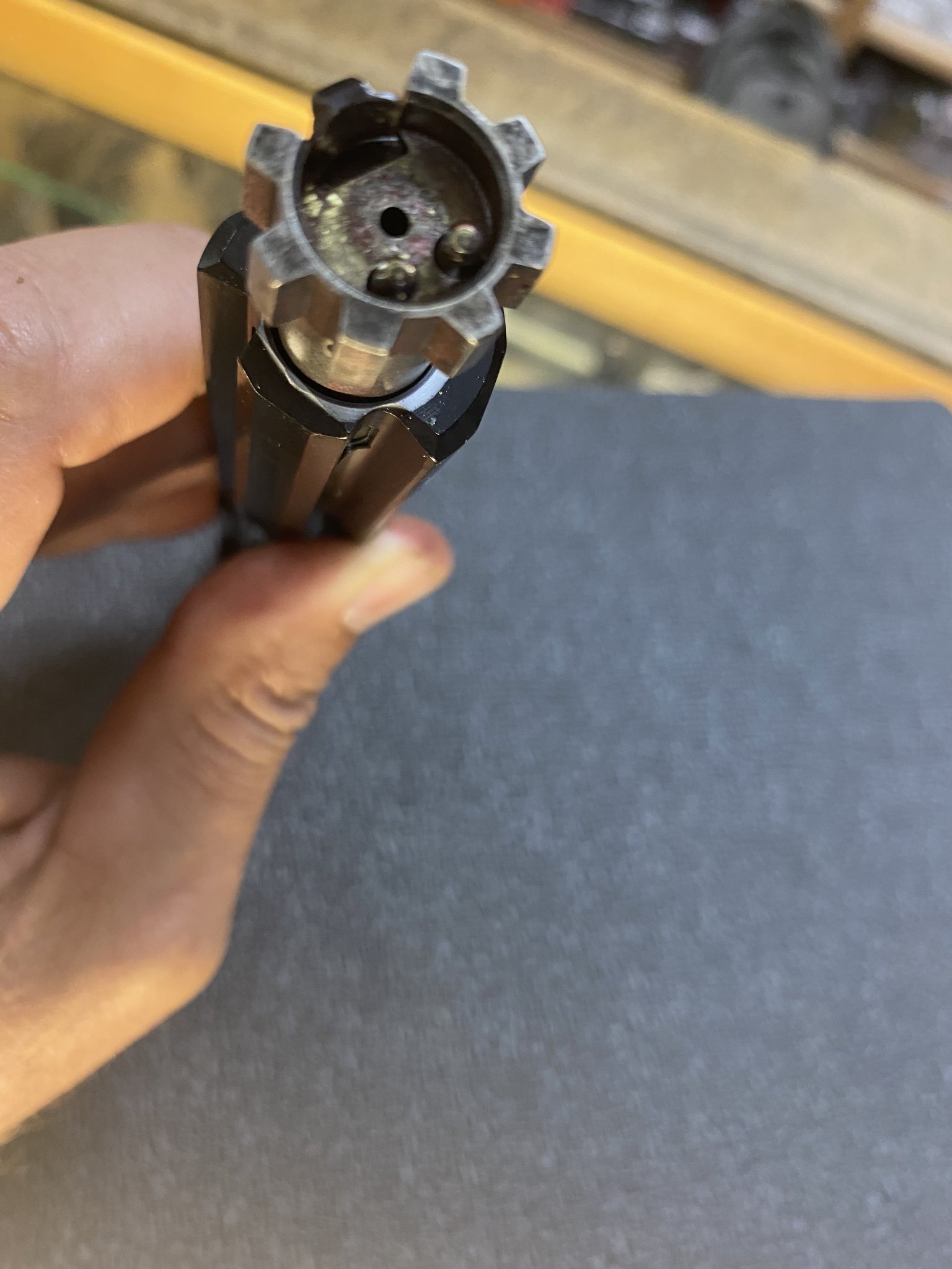

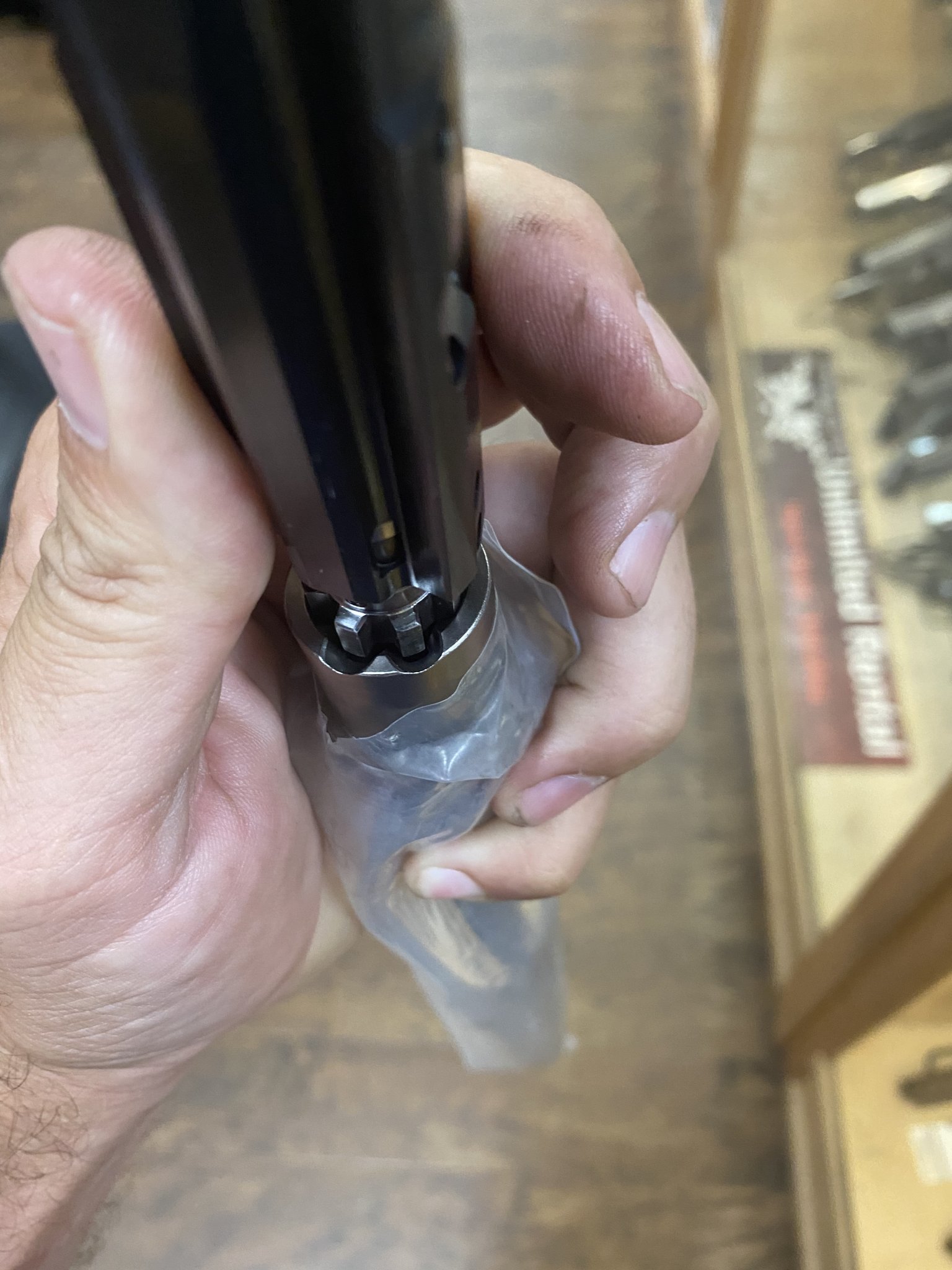

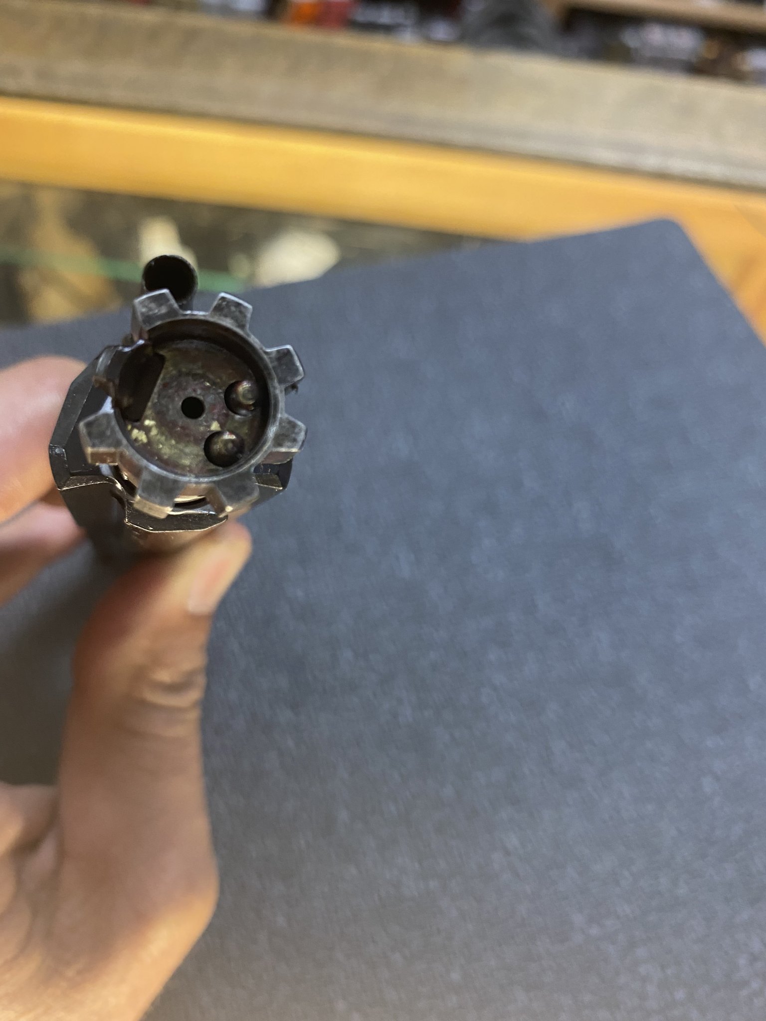

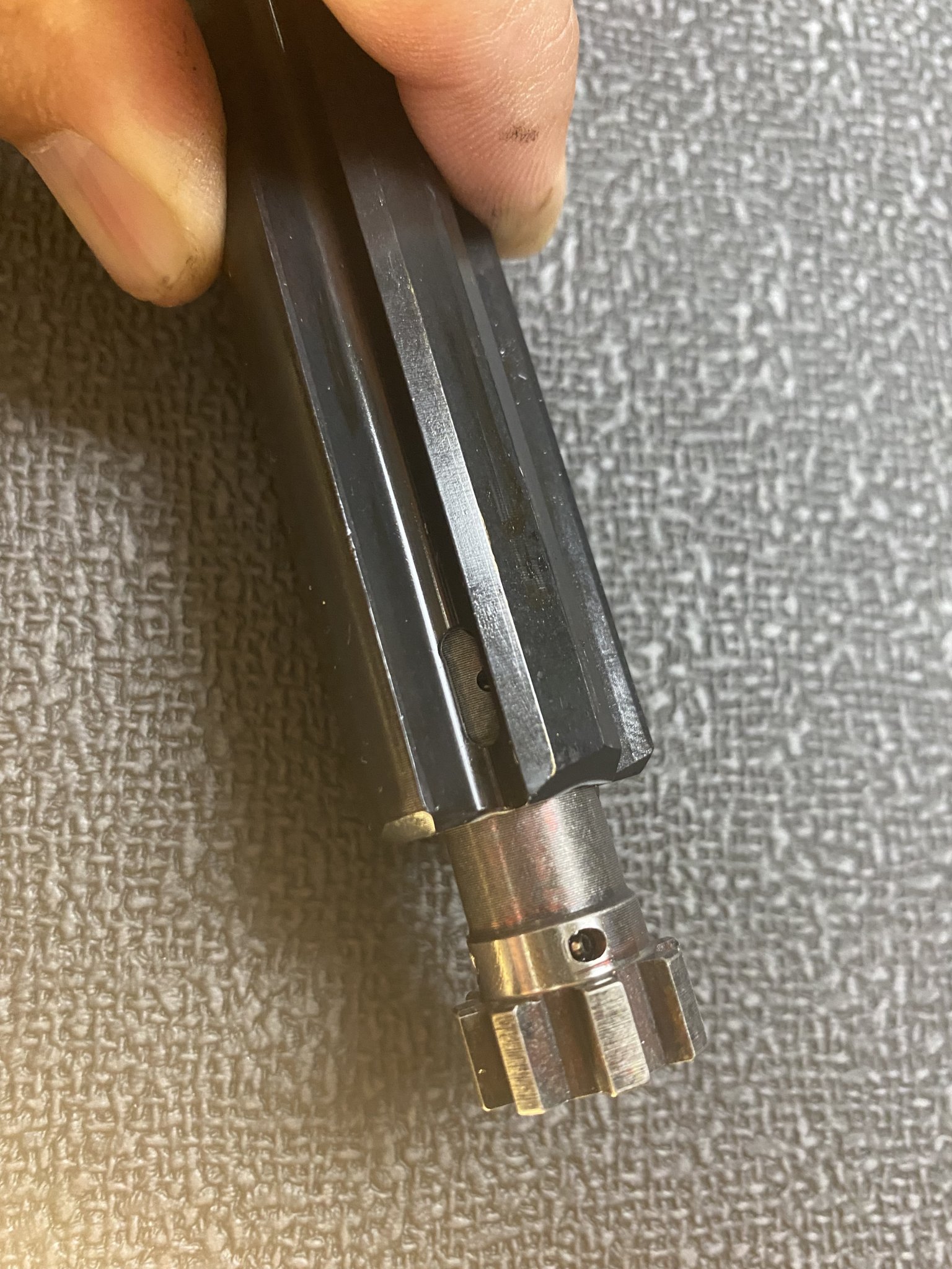

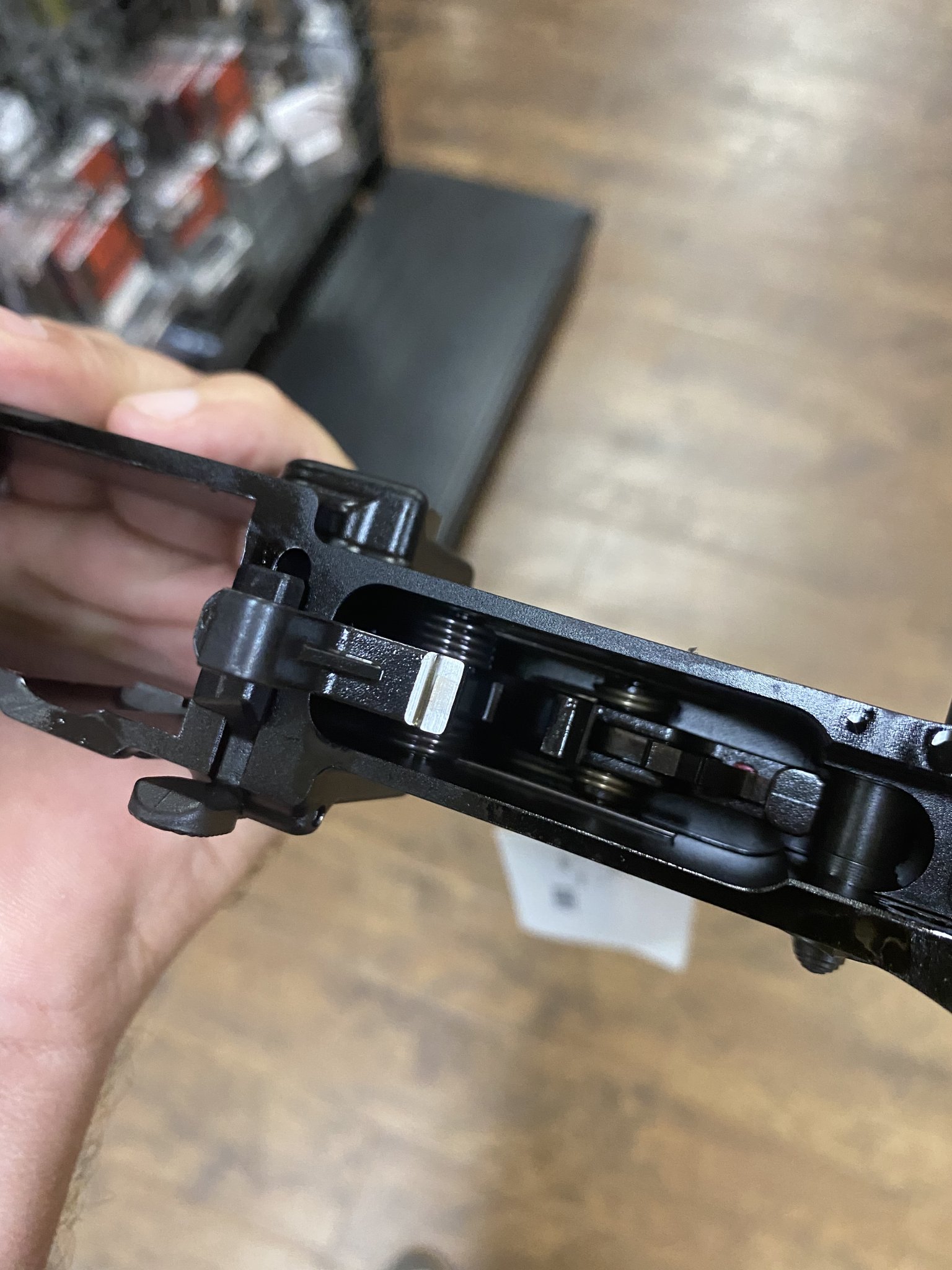

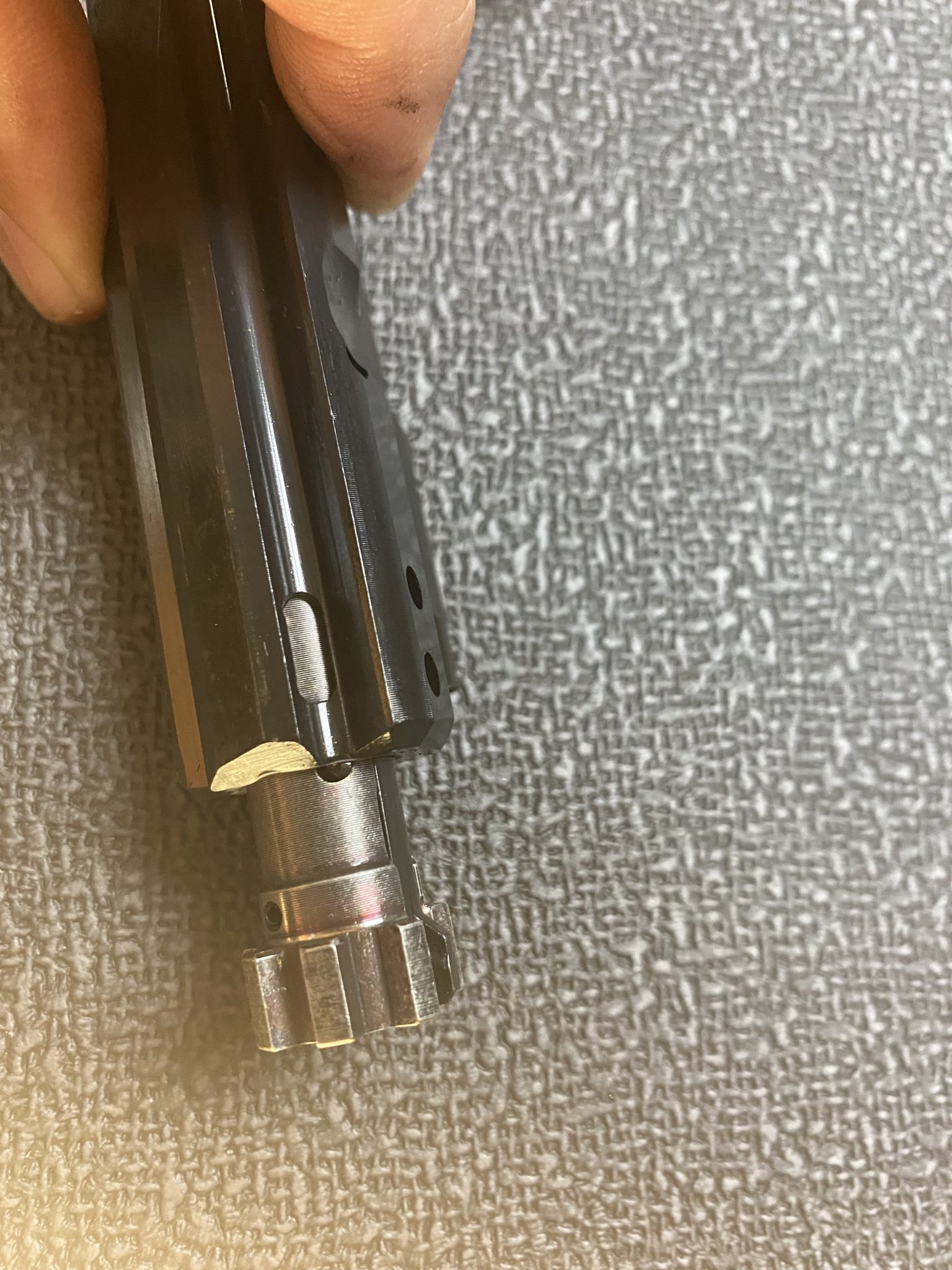

    Got to put hands on one of these today. I wasn’t impressed. If I’d known they were going to let me field strip it, I’d have brought dial calipers. Tape measure was all they had in the shop.

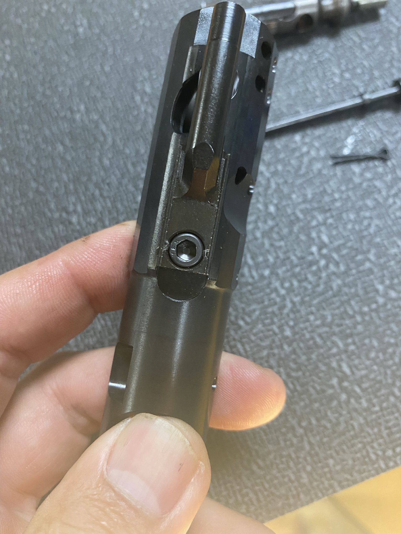

    It’s light. The handguard felt cheap. Gas block had minimal clearance. The barrel extension has to be proprietary. The bolt will almost fit in an ar15 barrel extension. It almost looks like a Grendel bolt. Firing pin has to be titanium, it weighs nothing. Pics aren’t loading right. I’ll post more later.

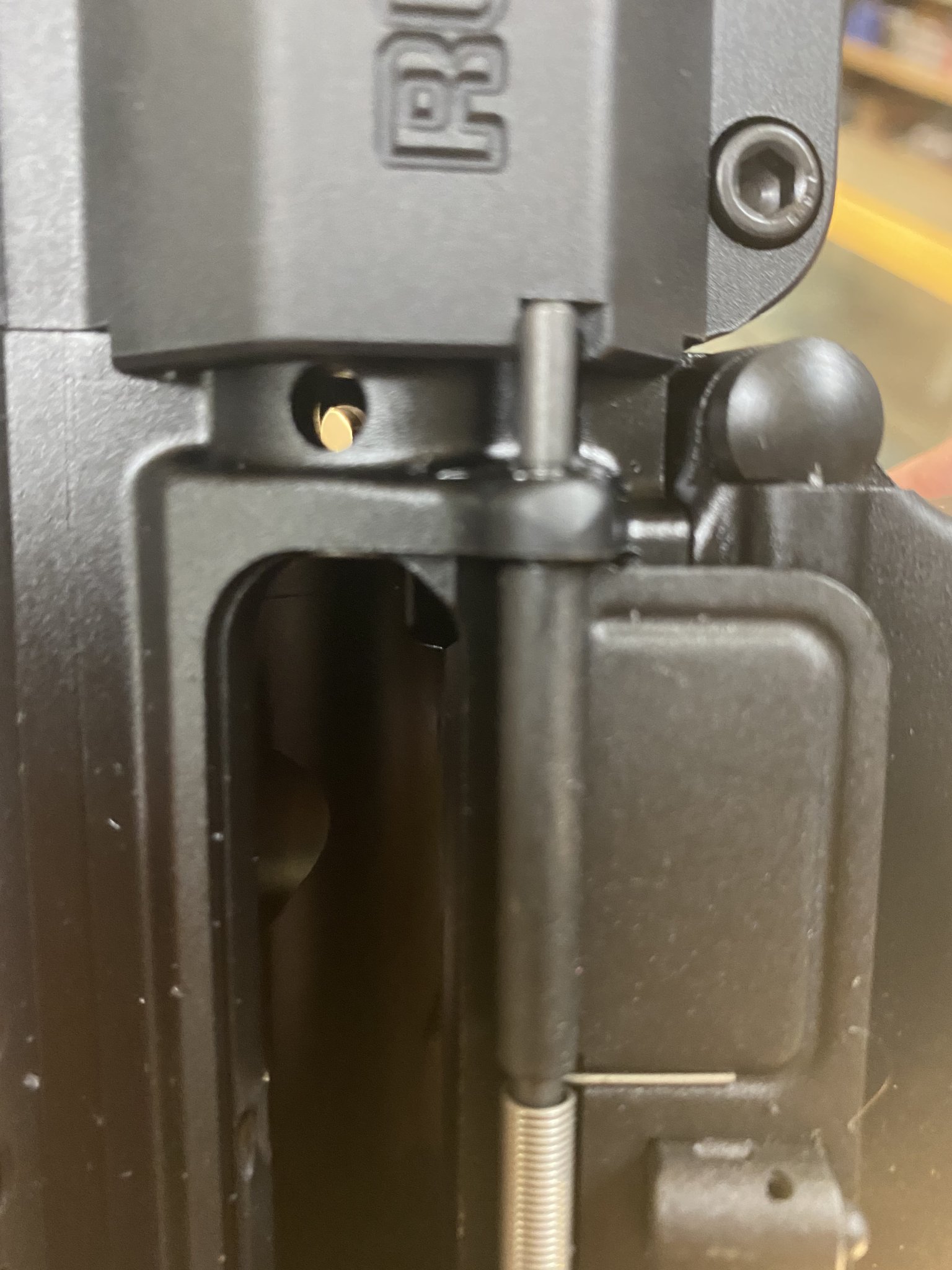

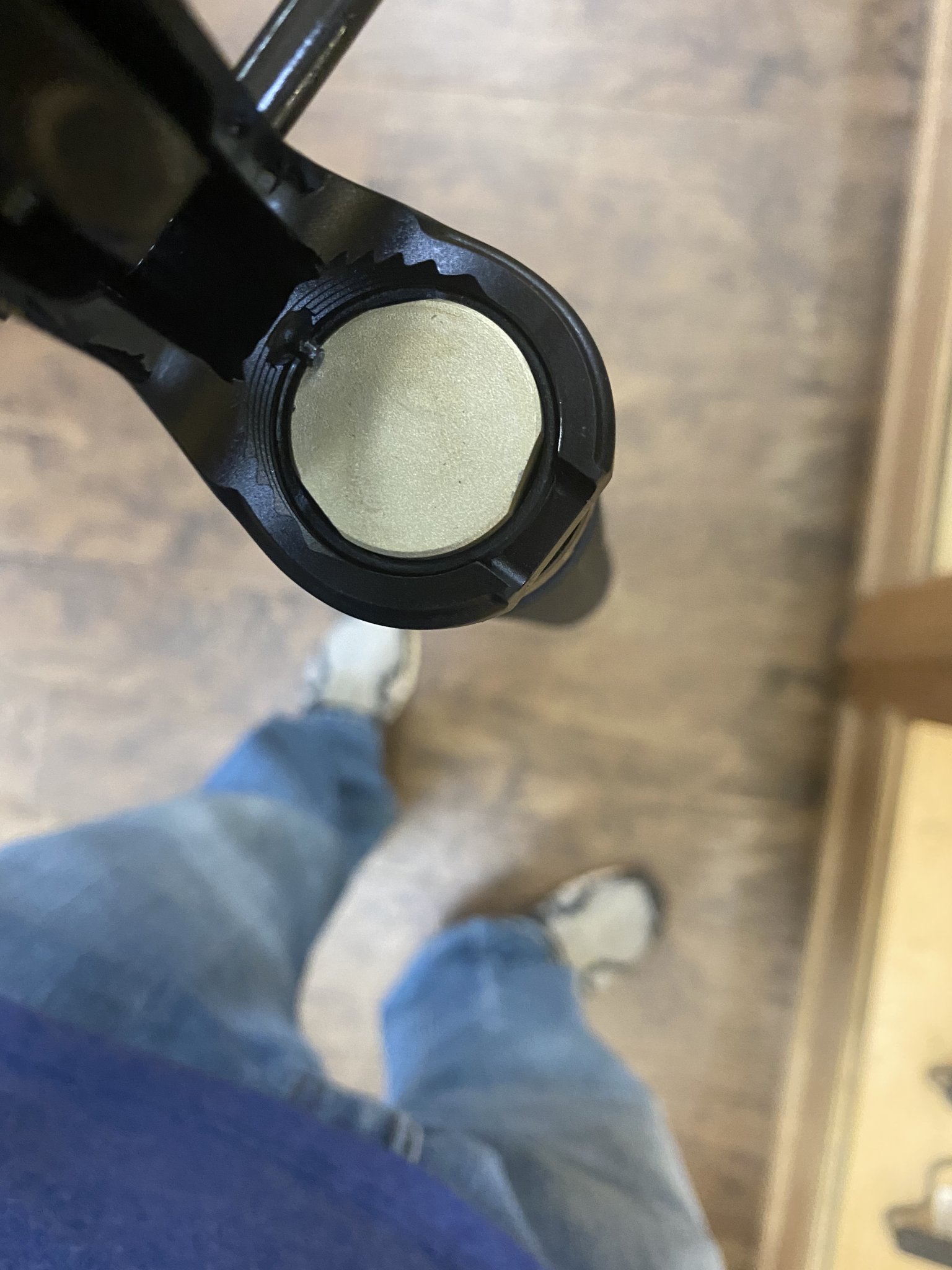

    Any chance you were able to measure/inspect the barrel nut and height to gas tube/top of rail?
    Would a normal AR 15 hanguard potentially fit?
    The handguard was flimsy. It flexed enough to contact the gas block.
    From what I could tell in the shop lighting, the barrel nut looked to be about an inch long. It looked like an ar15 handguard would fit. Without disassembly, I couldn’t tell.
    Barrel was stamped 7.62Nato/308win
    Bcg was interesting. Seemed to be melonited with a chrome bore. Gas key was melonite as well. Vents on bottom of the bcg. Carrier got really thin at 5&7 o’clock.
    Barrel extension was vented on each side.
    Measurements were taken starting at the 1 inch mark. The shop started getting busy so I put it back together so the staff could work.
