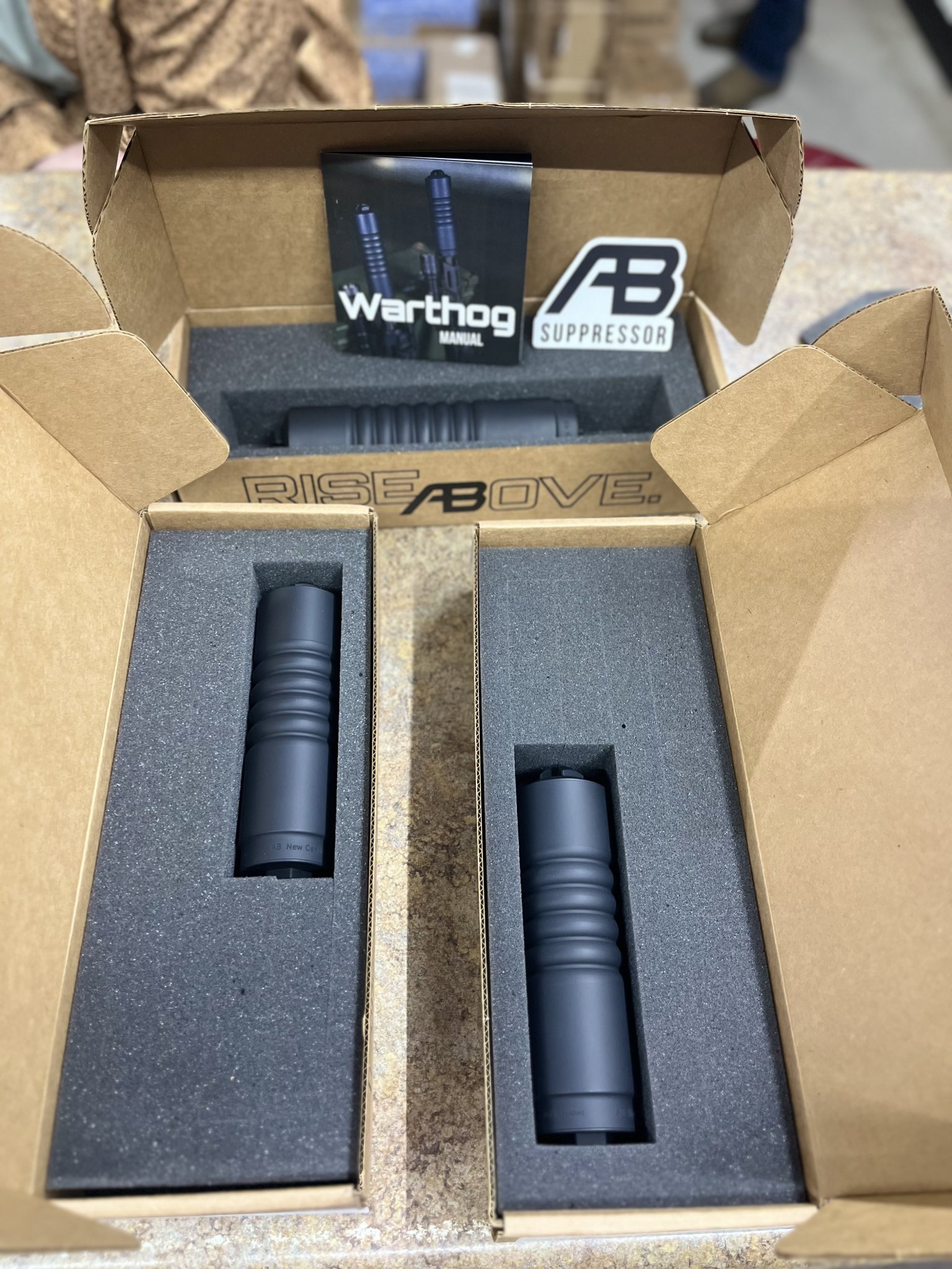

What was your overall thoughts on the warthog? Any you prefer more?
I have a Warthog pending now, based on the performance I've seen next to other 5.56 cans (Razor, Saker, Sierra,). It weighs almost half of my Saker 556, but sounds better to my ear, if anything.
