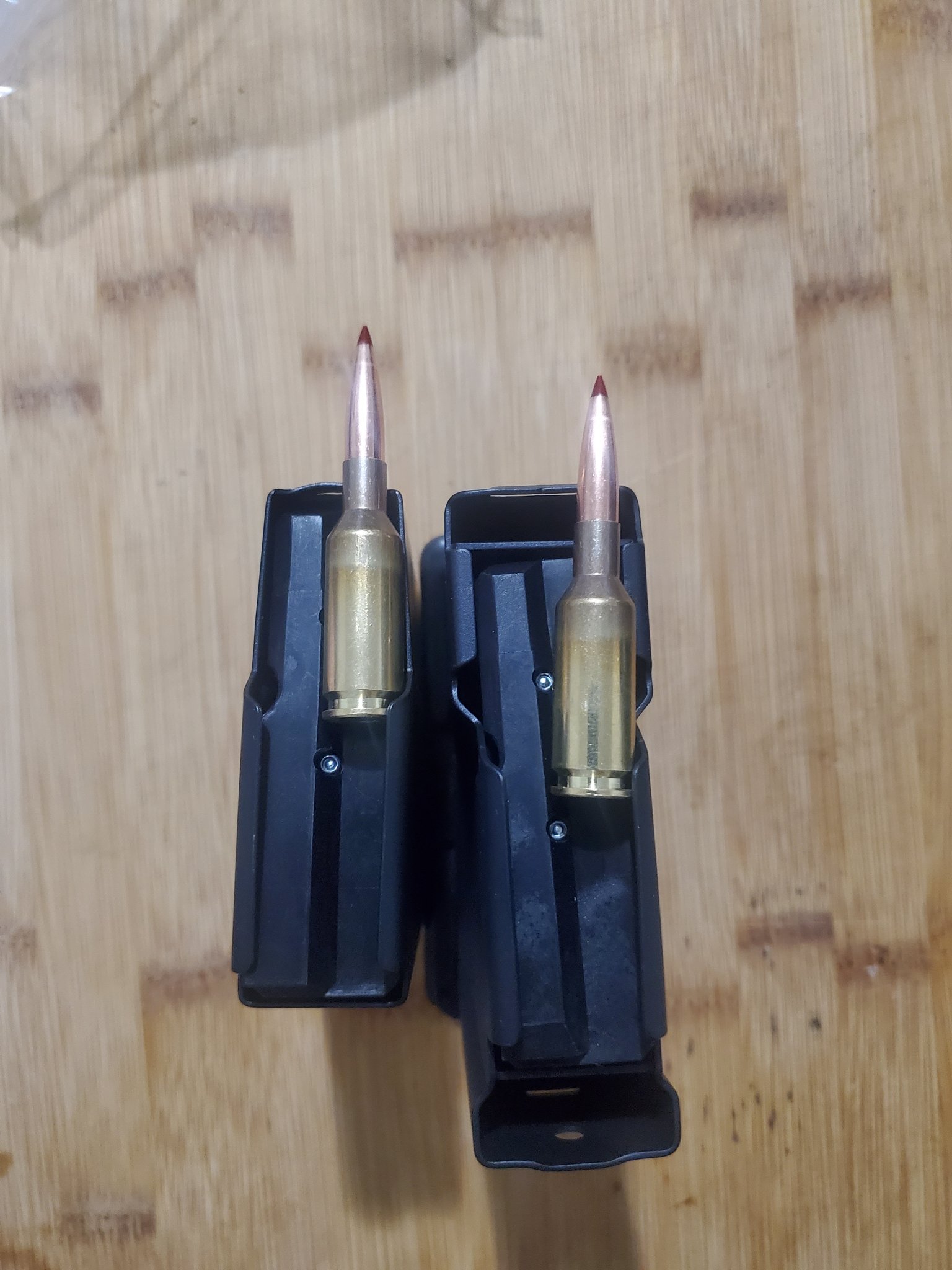

This isn't a dasher. It's a 6br just for reference for you. This is the position they release from the feed lips in. I don't think the 6br case is far enough forward to enter the chamber when it's released. That's part of why the 6gt was designed. To be long enough to be entering the chamber as it's released from the magazine. If that makes sense.
Thank you Jbuck88, that photo really helps explain what the issue is with short 6mm cartridges.
Do you know if the 6GT have any similar issues in the AXSR?

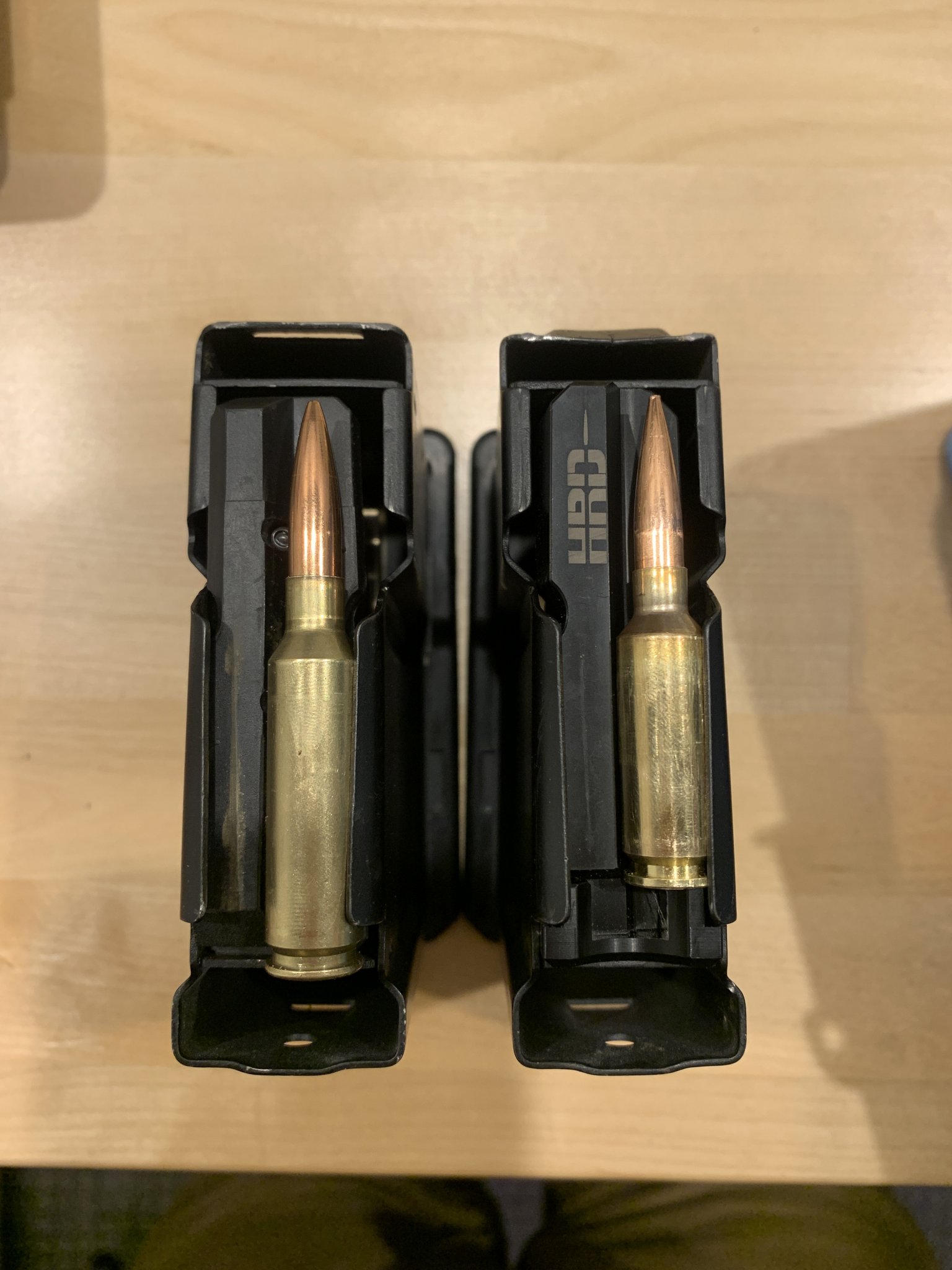

I just burnt out my 6.5 CM Barrel, and put on a prefit from proof for 6 Dasher. With no magazine kit, I couldn't get rounds to feed. I tried installing an HRD kit, but it needs to be modified to fit in an AXSR mag. After modifying, they feed fractionally better, but I'm talking about maybe being able to cycle 2 rounds cleanly.
I'm going to call Mile High on Monday and speak to Adam (the Gunsmith) and see if he knows or has any modifications he can make to the mags to get it to feed better. Otherwise it may be back to 6.5 CM for me.
Here is a side by side of 6.5 CM (Left) and Dasher (Right). They look similar, but the Dasher nosedives when you try to feed.

Mind sharing what you find out from Mile High? Also, would you be able to ask him whether or not the same issue will exist for the 6gt?
So I went to Mile High and spoke to Adam.
Long story short, it’s not possible to run Dasher or any of the short 6mms in the AXSR reliably. We used the HRD kit, modified the feed lips, and still got less than 50% of the rounds to feed.
The issue is how far back and how short the feed lips are. There is a moment when you’re cycling a round where that round is literally just free floating inside the action, and there is nothing guiding it, which causes it to not feed.
They took my Proof prefit (unfired) and sent it back to proof to be rechambered in 6mm Creedmoor. He said they sent all of their Proof Dashers for the AXSR back to do the same thing.
