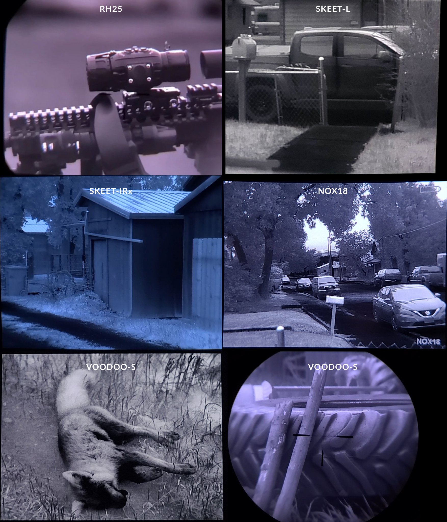

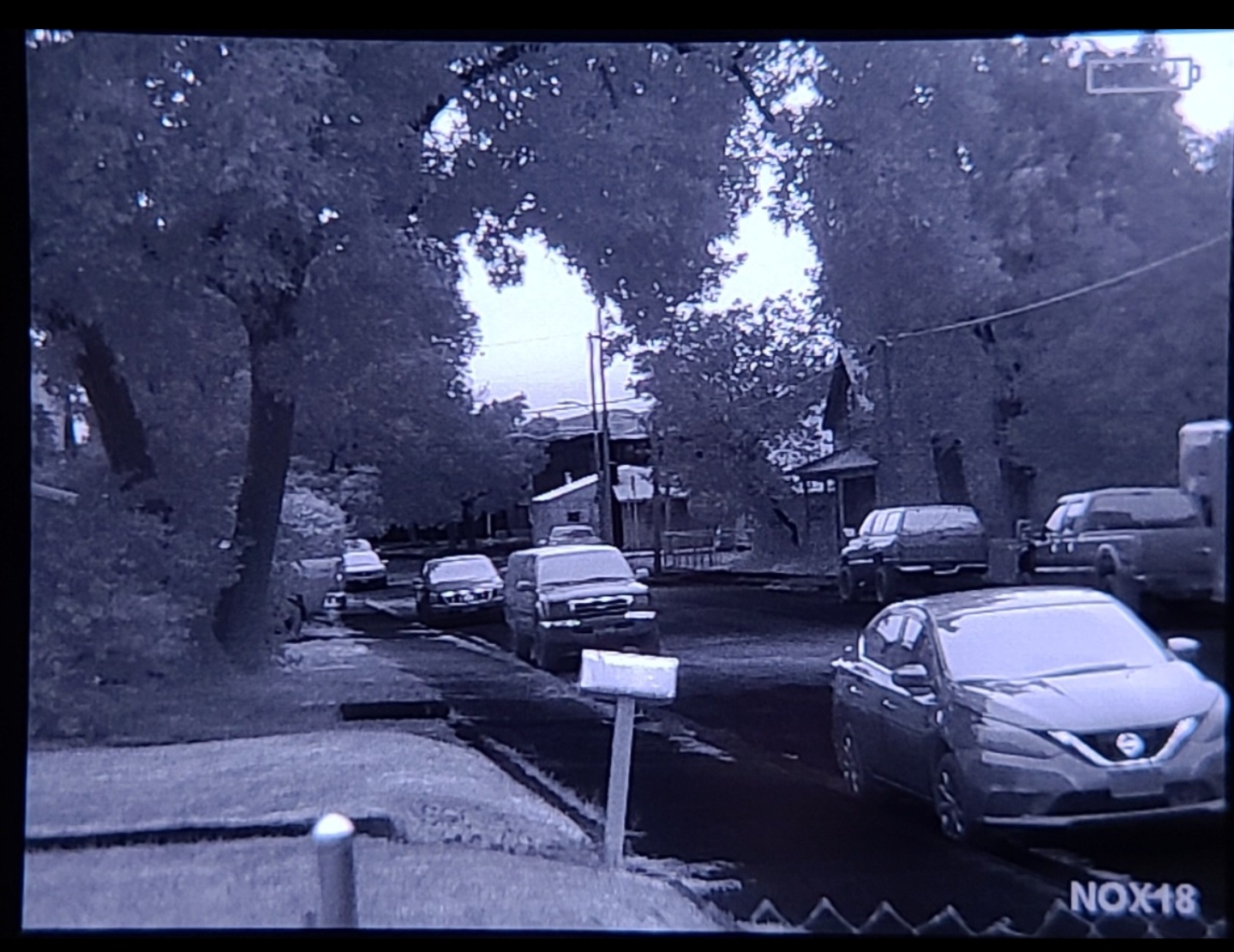

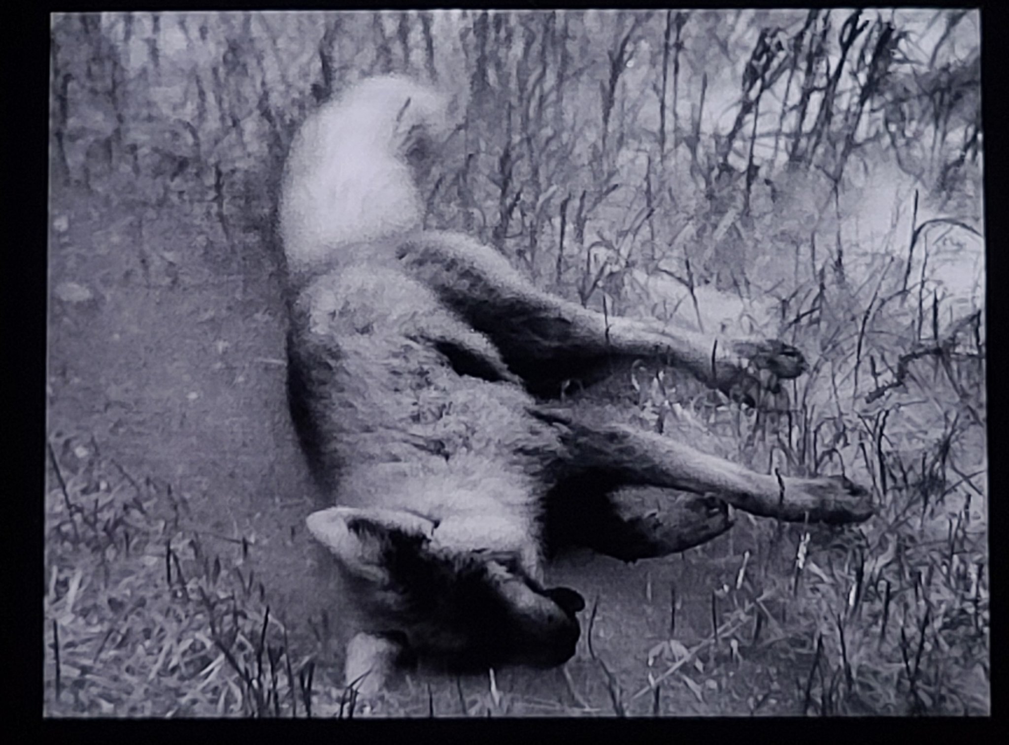

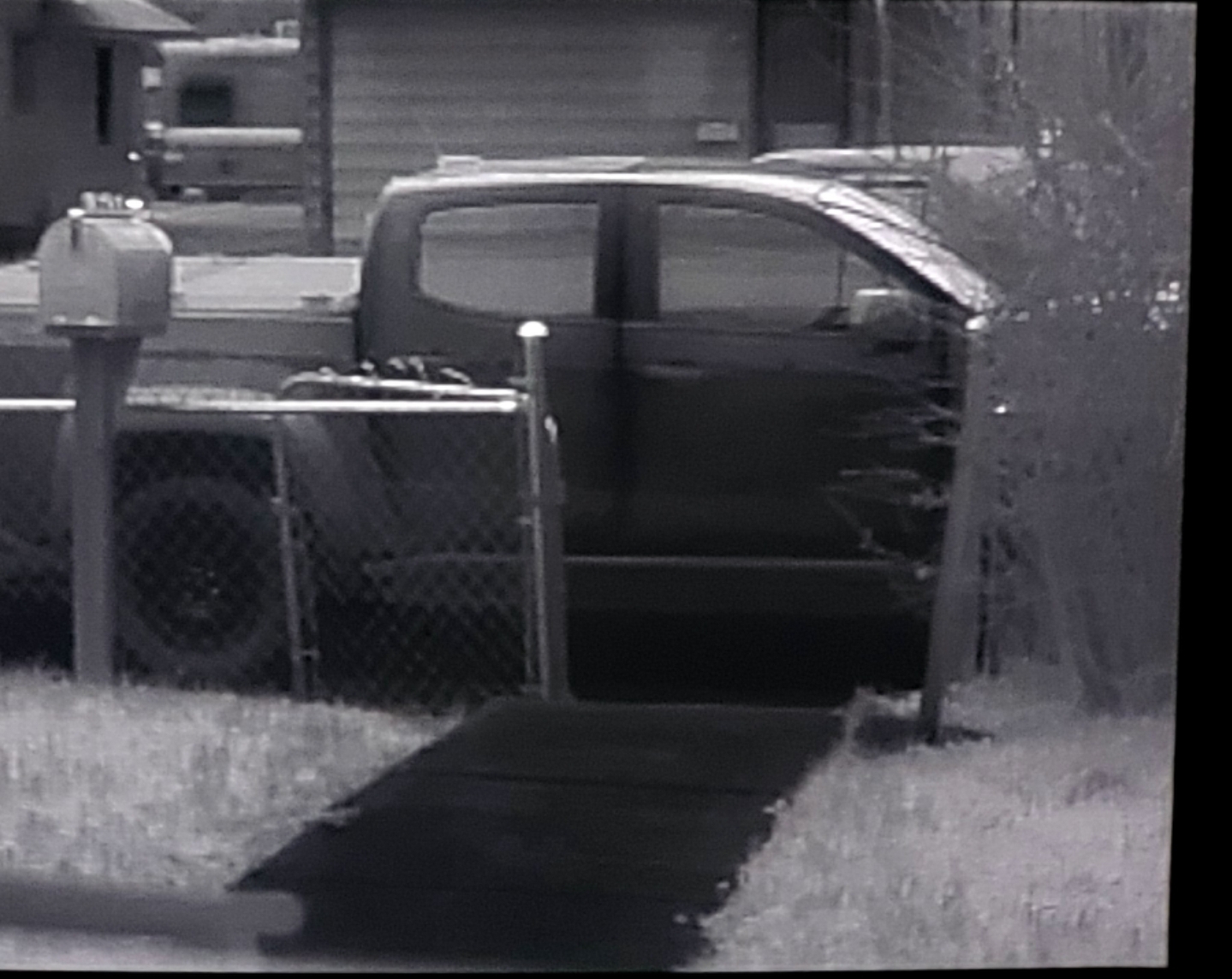

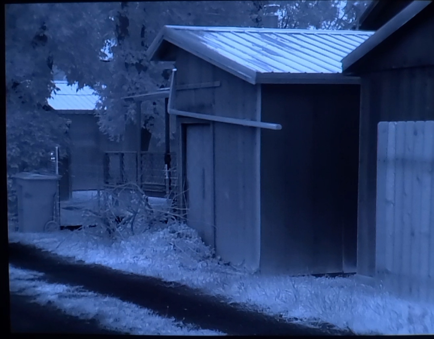

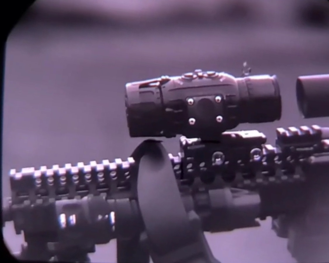

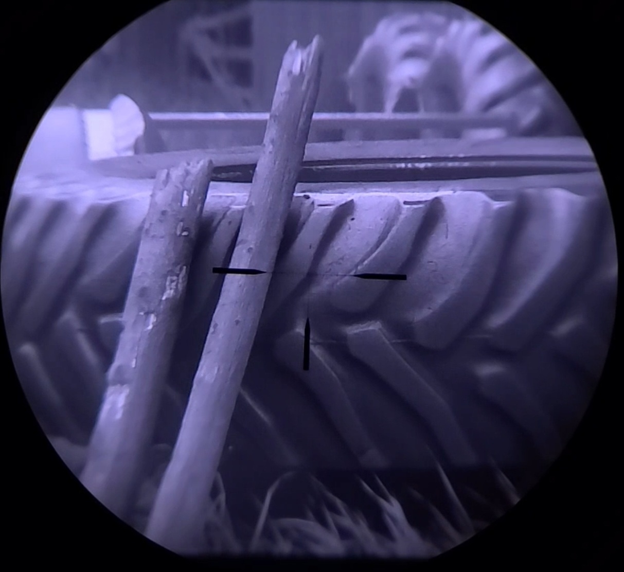

So, here's some comparison photos through the RH25, Skeet L, Skeet IRX, Nox 18, and Voodoo S (last 2) respectively

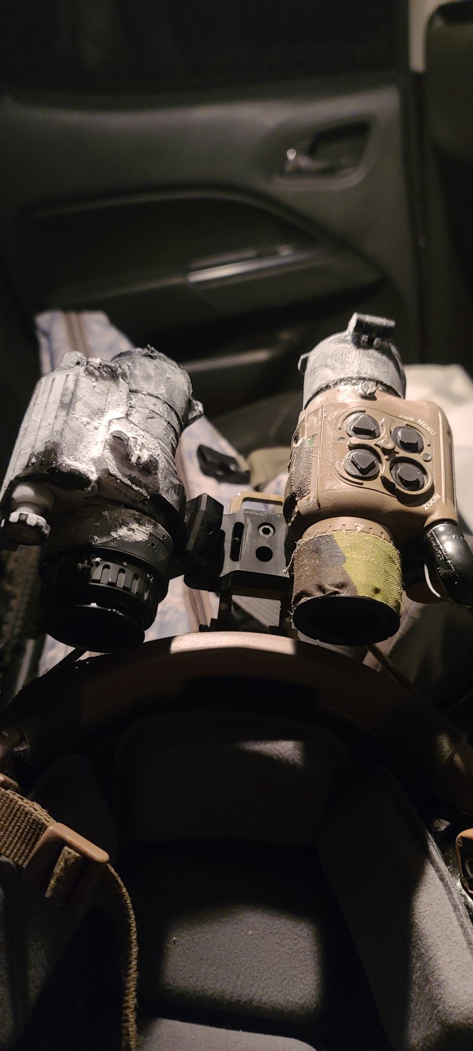

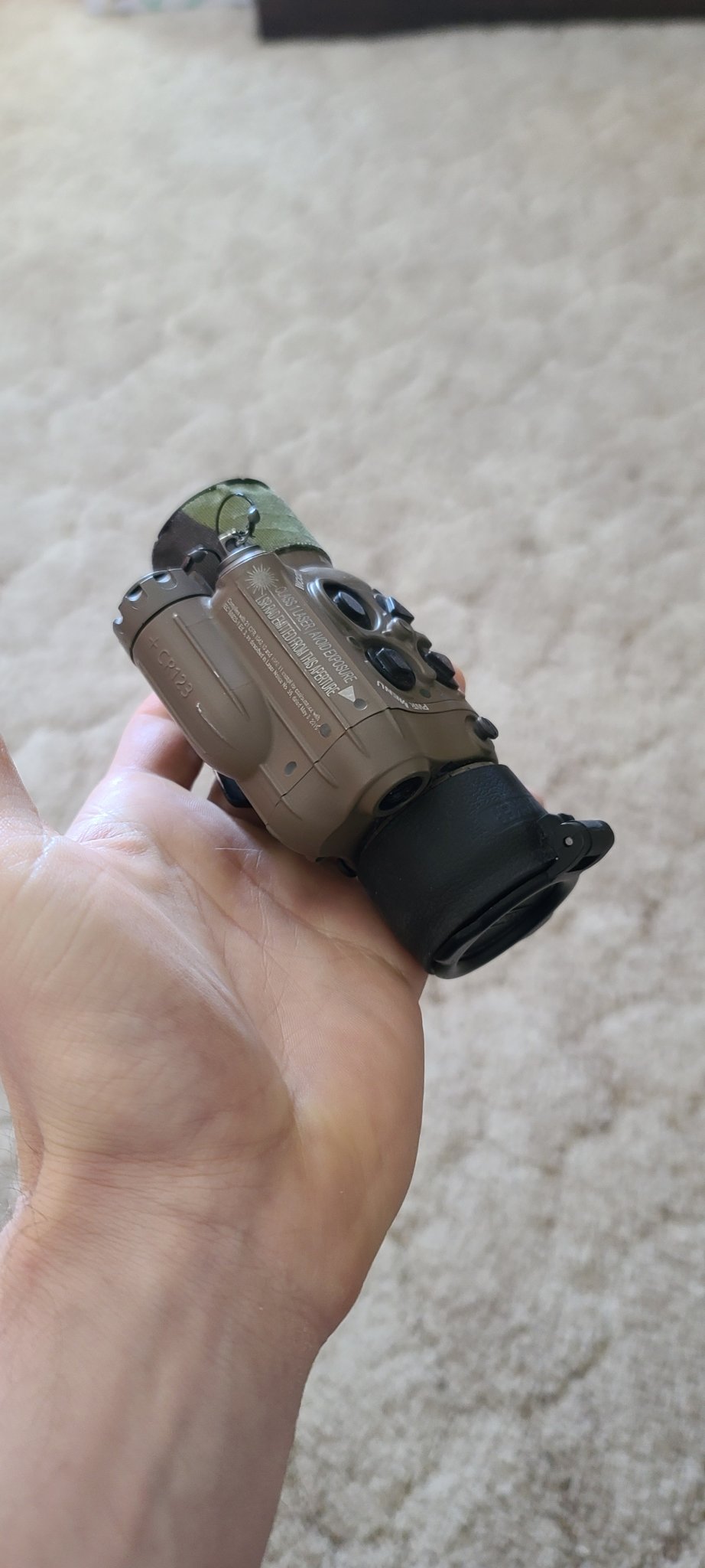

Here's the unit as it stands. One picture taken today and one last night after an outing in -5⁰ F Temps. Unit performed flawlessly (like always). That frost was just from my breath 😬.
