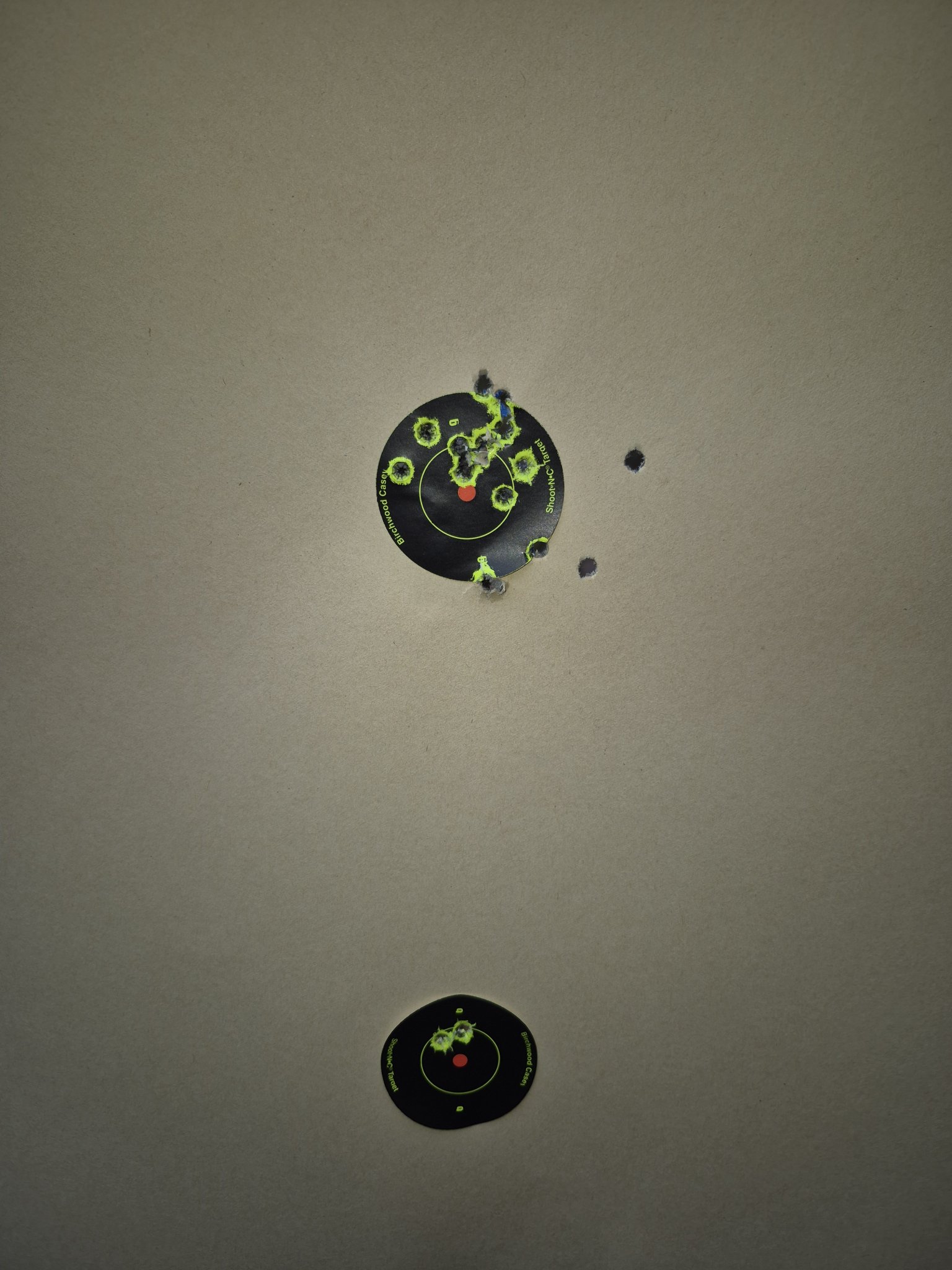

well i got my Echo cv25 yesterday, last weekend I had the chance to use my friends sv50, as mentioned before the image quality isnt there yet but with the lrf, bdx feature i was easily engaging six inch steel plates at 250 & 350 quickly.

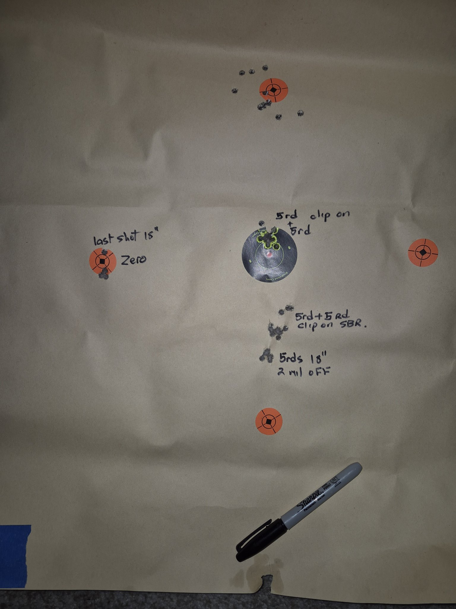

Onto to the echo cv25, played with it last nite, bought primarily as a clip on, every thing seemed to work fine thankfully. So this morning I went to the range for a quick unscientific test. Had a 11.5 sbr with a sig tango6t and a 18inch with a hennie 4-16. Neither were zeroed, and the only ammo I had on hand was 52grain eldms which shoot fine outta the 18'' 1-7.7 but not the 1-7 sbr.
So you can see the target, left red dot 18inch ar, rough zero last rd was were I left it, obviously the 1-7sbr shoots rotten with this ammo, Then I fired 5rds at the center target with the echo, removed the echo, replaced it and fired another 5rds. I had a hand warmer taped behind the center black dot. I removed the echo once again, replaced it then I fired 5rds with the 18inch holding 2 mils off the heat
source.
I then placed the echo on the sbr, fired five rds holding off the bottom of the heat source black dot, removed the echo replaced it and fired another five rounds.
Hoping to get it out to a 100 yards with either rifle in the next few days to see what happens. If those with knowledge that have any ideas on what i should do with regards testing please mention them.
one thing I noticed was apparently the app supposedly has an optical axis misalignment tool that one can utilize to improve the clipon;s zero, that i cannot find in the app whether Im looking in the wrong place or it hasnt been added yet.
