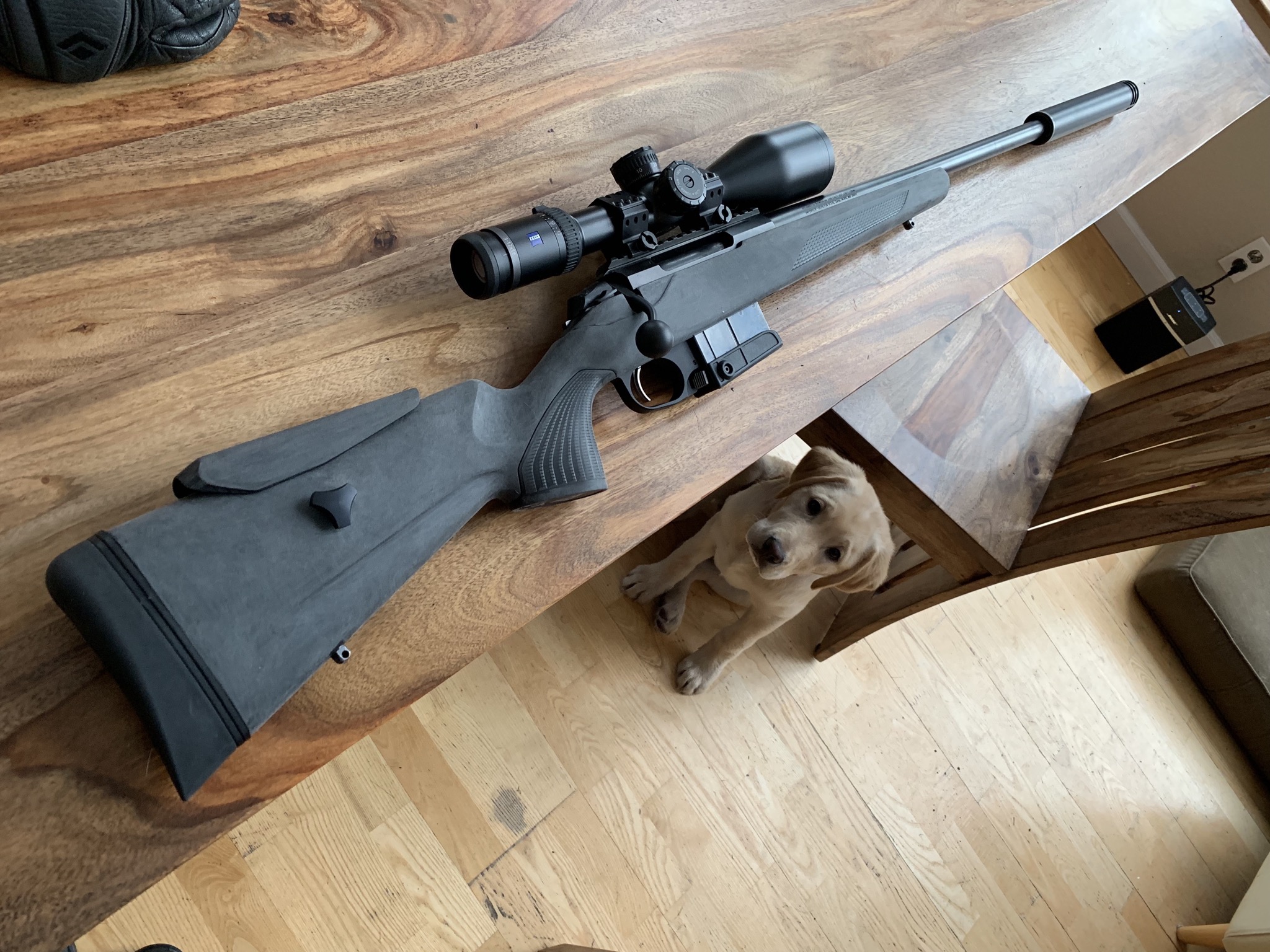

Yeah you will not hear a lot of love for the factory stock around here but the only real drawback is the lack of cheek adjustment. I just put one on. You can also add spacers for length of pull adjustment. View attachment 7046336The fiberglass polymer composite is stiff and won't hold you back.
Really like the looks of your rifle. I have one iike that in stainless ordered. I was thinking of using it as a hunting rifle. Two questions:
1) Quick detach bipod? good idea, bad idea? suggestions?
2) I have an "extra Kahles K624i scope" taken off my RPR in 6.5Creedmoor when I sold it. Too much scope to hunt with, spot and stalk, ground blinds , no extreme back pack hunts.
Thanks!!!
