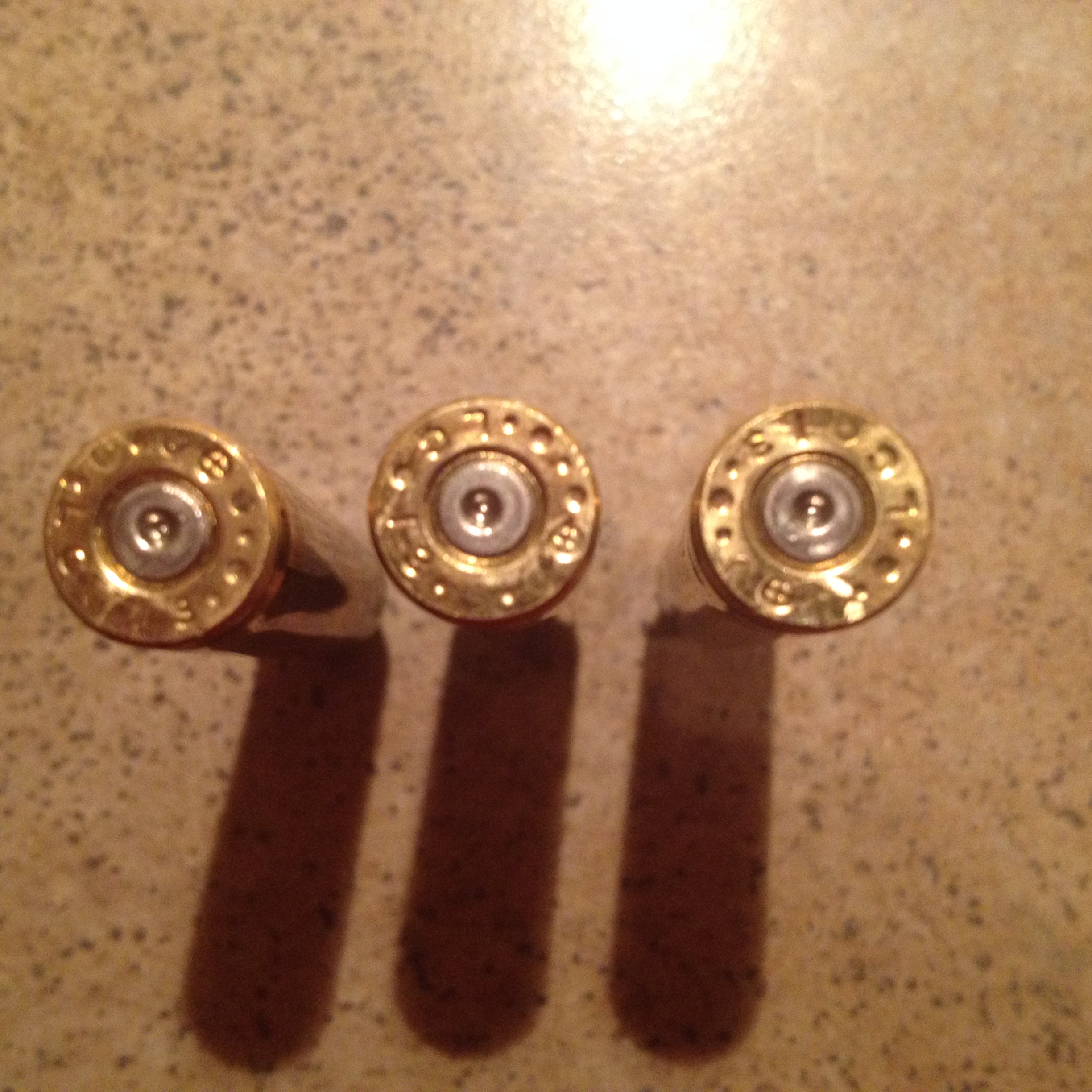

Hey guys, I attached a pic of some of worst cases with ejector ring. Actually pics look worse than actual. As I had to look hard to see the ring on many of the cases. OF&B has been helping me with this and concluded I have a gas problem but probably best to keep the gas block on my Daniel Defense as it is fixed and not adjustable. Not sure if different buffer spring, etc. would help but will just live with it. I think part of problem is my LC 13 cases are new unfired with only 1.444" headspace yet my rifle headspace is 1.463". So after my fire forming should be better.
So have decided with OF&B's help that will be best to load somewhat mild loads for fire forming and then do load development. Then I can get back to my original thread to reduce runout. Thanks especially to OF&B for all the help! I will be considerable time fire forming the 500 cases and then report back. If anyone has other guidance as to my overgassing/gas timing would be much appreciated. Thanks!

I agree but have had both new unfired brass from LC 13 and Lapua with exact same 1.444" of headspace. My rifle is 1.463" and after fire form move back to 1.460". What can I do about this brass? OF&B measured some of his new brass and also said his wasn't anywhere close to 1.444". He even told me couldn't be wrong measuring with my Sinclair bump gage since the same gage comes up with 1.463" time and again after firing. Wonder if this much headspace is causing my slight ejector rings?
Your unfired brass should be longer than that at the shoulder. In theory, it could cause the marks by slamming against the bolt face. I dunno. Try some FC ammo. It should be longer. Then you'll know.

"WHY" would Lake City and the Army sell new unfired brass?
Lake City loads the cases that pass quality control standards, so again why are these cases being sold.
Because they "FAILED" military quality control standards, and if these cases failed the hardness test it could be why you are seeing the ejector marks on the rear of your cases. If these LC cases are rejects then this also explains the excessive case runout
Now go out and buy some commercially loaded ammunition and see if these "control" cases have ejector marks and excess runout.
Do you actually think the U.S. Army is selling the ammunition below?
I get that I don't know squat when it comes to reloading. This is why I am on here to learn. Guess I don't even know history of LC. Wish I would have just bought 500 or so of Lapua and went with that. Trouble is the lapua was also 1.444 but had no ejector or other pressure signs that I could see up to max Sierra published data.
In fact, only cases had ejector rings was LC and factory hornady match 75. Same ejector rings on those and they only got me about 2400 fps in my DD 16". Shot winch match 69, xm193 55 (2960 fps), am eagle 55, fusion 62, PMC 55, tulammo 55, winch varmint express 55, rem hypersonic 62 (2680 fps), DRT 55, horn varmint express 55 vmax, Barnes vortex 55 tsx and none showed ejector rings.
