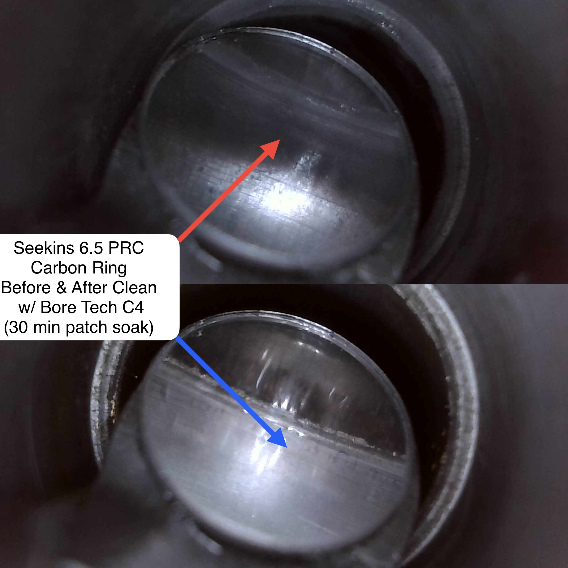

I posted this there. I use solvent, dry patches and bore conditioner after c4.
I posted this there. I use solvent, dry patches and bore conditioner after c4.View attachment 8584772View attachment 8584774
Good move patching out with a solvent/degreaser after using bore tech since BT has so much water content. I’m sure you’re probably already doing this but make sure to have good ventilation/gloves and avoid open flames when using KG3. Looks like its mostly Hexane which is a very powerful nonpolar solvent in the same family as mineral spirits/kerosene (aliphatic solvents) but is extremely flammable/toxic and way stronger than mineral spirits.

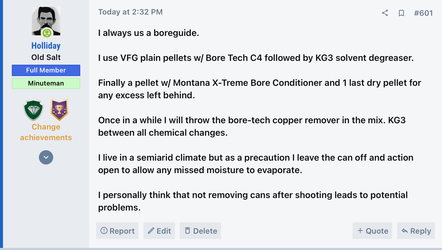

ugh I had thought KG3 to be somewhat benign because of the low smell. I clean in my den. Guess I need a safer alternative.
Yeah its sneaky bc of the low smell. Its probably fine to use it once in a while if you’re in a hurry and don’t want to wait for a weaker solvent to soak for a few hrs/overnight. Hexane is so aggressive it probably only needs to soak for like 5 mins before it all evaporates.

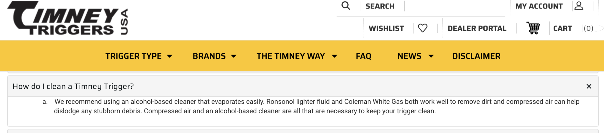

Zippo lighter fluid?

Yes it's essentially lighter fluid but the kind I'd recommend is VM&P naphtha which is slightly different than raw naphtha (which has a strong moth ball odor) so it doesn't have as strong of a smell.
Something like this:
