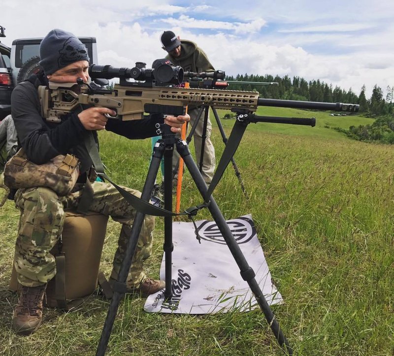

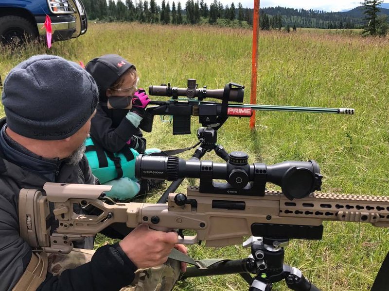

But I have been running the 3-20x Ultra Short with P4F in it... some guys in Alaska this past week shooting it in the rain found the crosshair a bit thin, but I always recommending turning on the illumination if you want to see it better.
19145968_10155394200577953_8090813568101696399_n.jpg?oh=d7ffd88e79f90aaea987572676f1640f&oe=59...jpg
19420857_10155422973057953_5388019572491608115_n.jpg?oh=457189763c34712d7d17d48bd06c6fb1&oe=59...jpg
