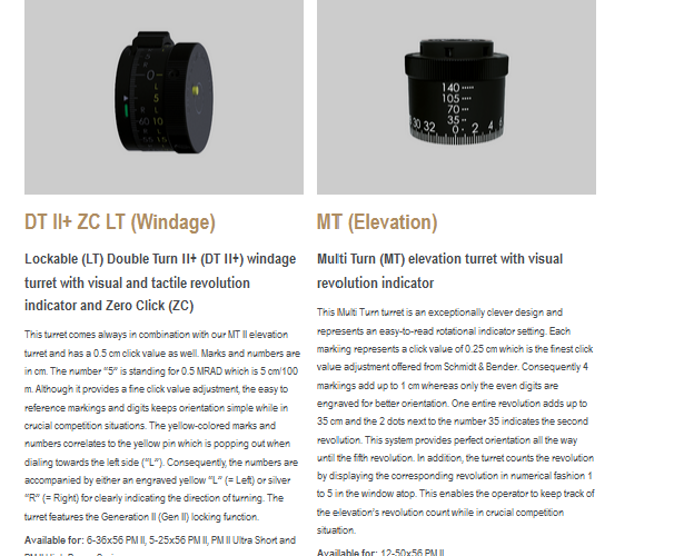

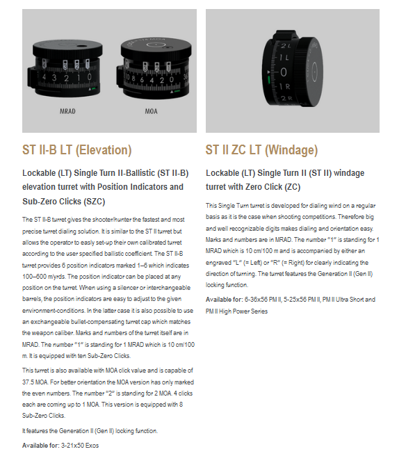

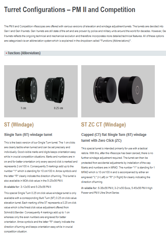

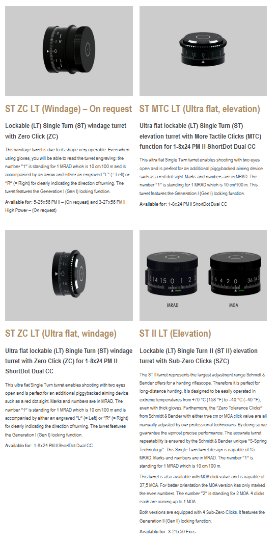

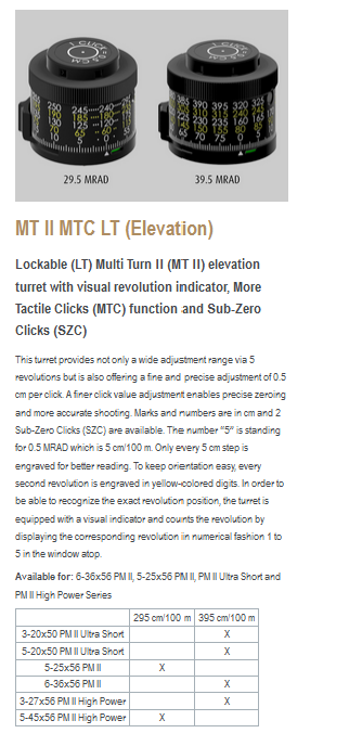

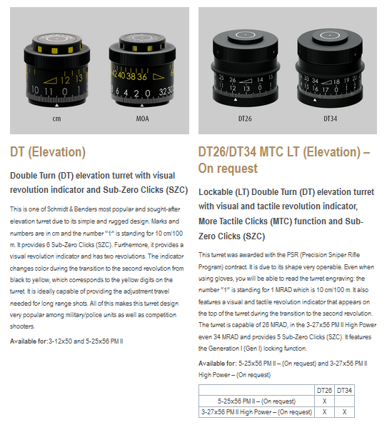

I thought this subject deserved its own thread, since you sent me down this hole. This is the complete turret information from S&B for PM II and Competition scopes.

Old news bro.... Only ones that matter are the dtii,+ and stii zc windage done
Yes, thank you and I don't necessarily disagree. But for mouth breathers and recent converts like me I thought this was at least an interesting evolution.
And all kidding aside, I had people arguing with me those weren't the best choices.
Just to be clear, after my Kung Fu like journey I agree the DTII are the best.
Arguing the dtii+ aren't great? The mtt suck
