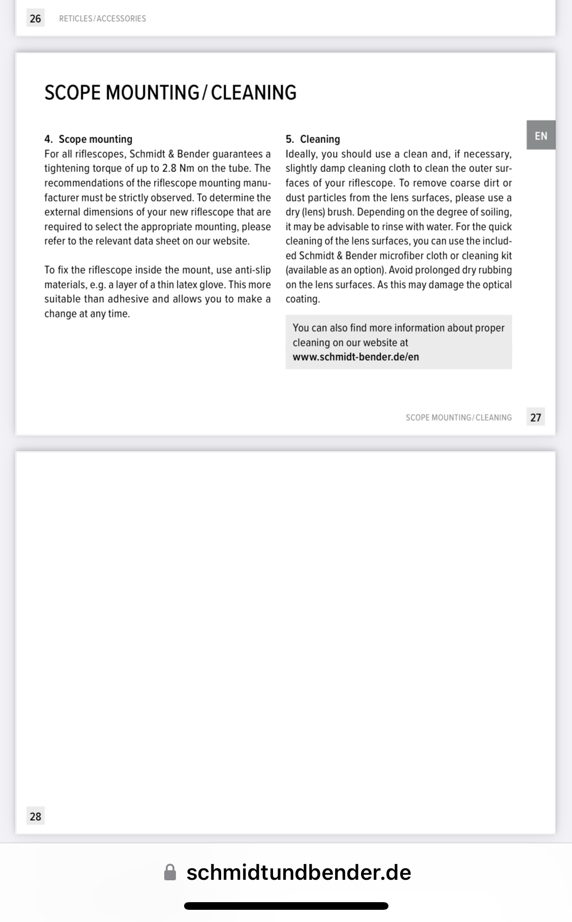

FYI...from S&B's PMII and Competition online owner's manual. I'm sure finding an online conversion calculator would be an easy find. Enjoy your S&B.
