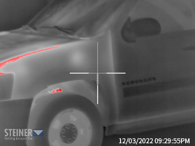

    Got a S35 yesterday from @DownRangeThermal.
    The amount of these that were sold looks like we could use a dedicated spot to discuss the ins and outs.
    So far I've found the wifi temperamental on mine.
    Haven't figured out how to adjust "red hot". I thought it was supposed to have a slider.
    White hot has worked best outside for image quality.

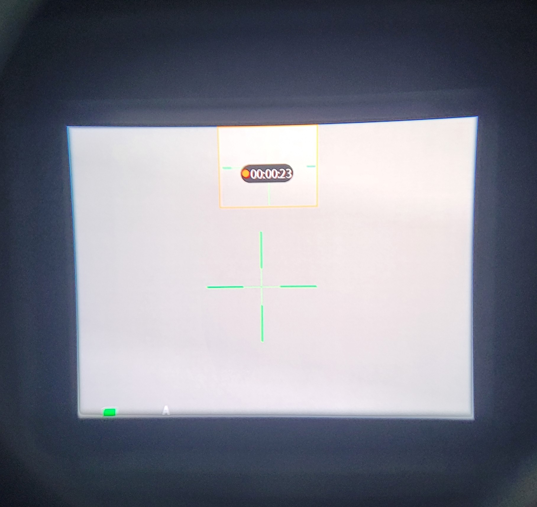

    Another niggle for me.
    The sight has PiP...which I like. But....whoever wrote the software has their head up their ass.
    If you put the PiP in the top center of the screen...which for me is the "correct" and most intuitive place to put it. When you record video it puts the elapsed time timer right in the center of the PiP window!?!? Making the PiP crosshair useless.
    Now you can move the PiP to the upper left or right, but again...this is not intuitive to me.
    Also worth noting...the PiP does not show up in the video. So what you see on the screen is not what will be in the video. And...the video quality is pretty poor. So much so, I will not post it because it truely is not what you see while looking through the sight.
    Anyways....more to follow.
