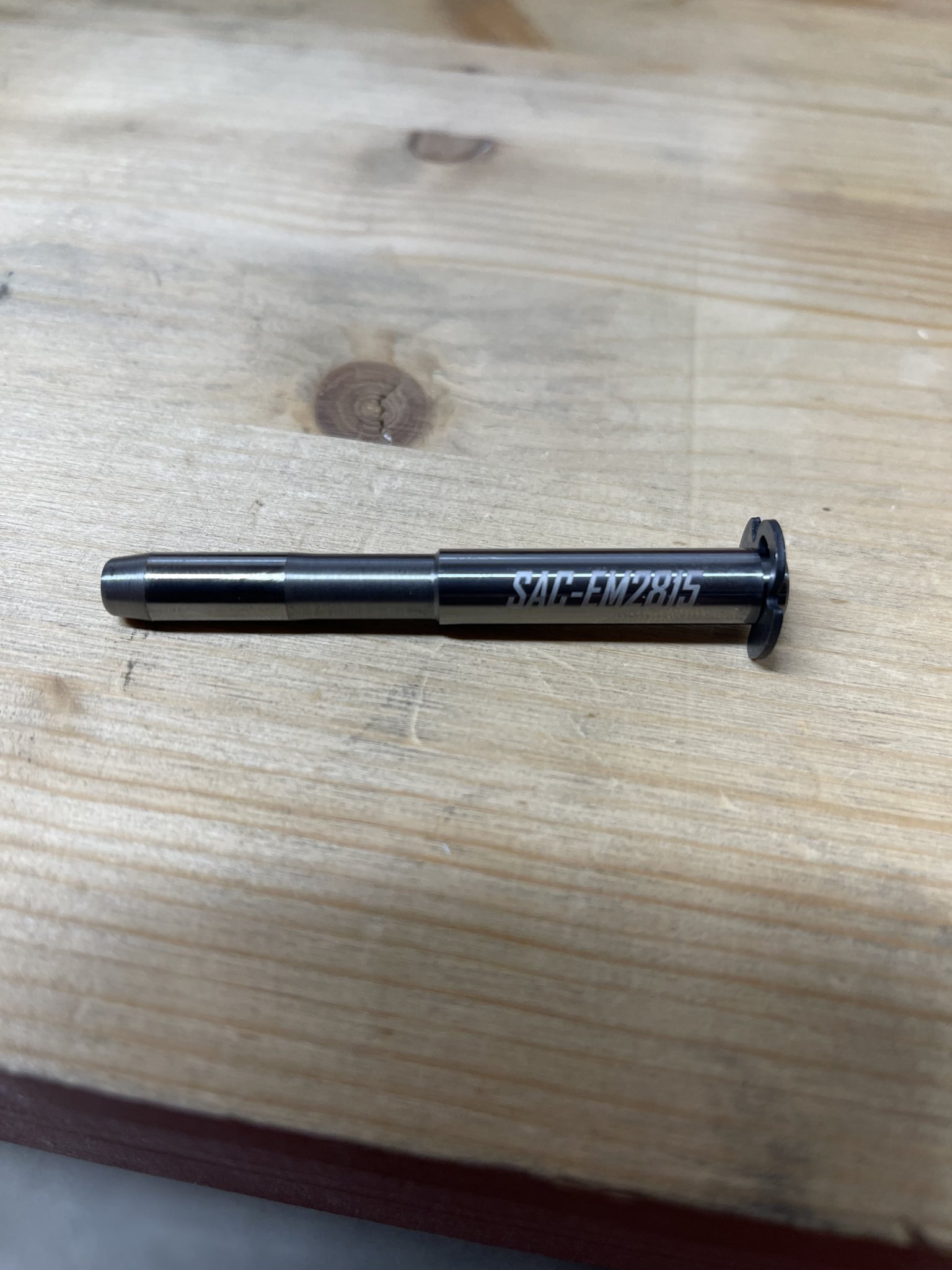

In order to decap/resize/mandrel in one step it looks like I’d have to purchase the die ($300), a seperate decapping expander mandrel($90), and the corresponding collet ($25) - so $415 in total, correct?

One shoulder/neck bushing comes either purchase so you can remove that from your total price. My mandrel was $50 but I didn’t get a decapping mandrel. I use a universal decapper.

SAC dies do the size / mandrel all in one step, which saves time. The different mandrels let me fine-tune neck tension, which I want to do. The different shoulder bushings let me work the brass minimally, which I want to do. The SAC bushing's slightly bigger neck diameter just above the shoulder is how I setup my regular neck bushings on the theory that it better-centres the round. When I was trying dies for a new calibre (6mm GT), the first two brands scratched cases badly and/or marked bullets significantly - the SAC dies do neither.

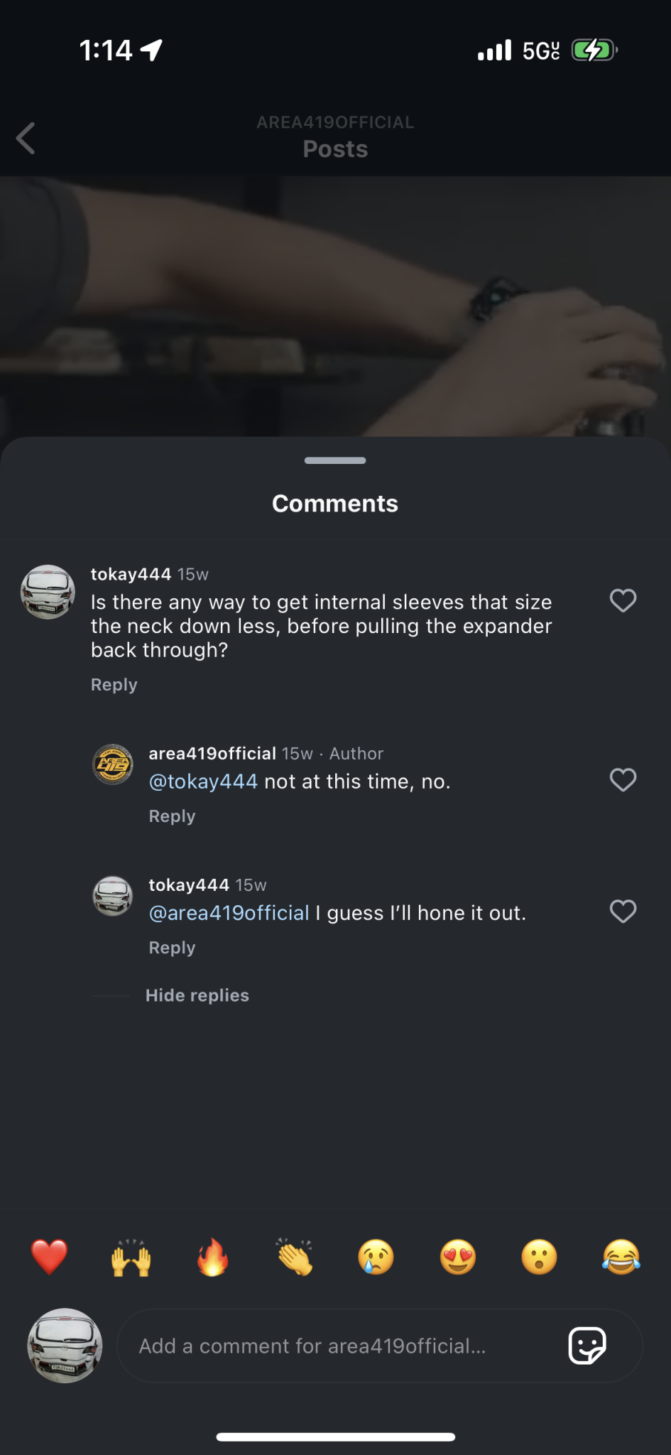

I got the A419 die on Black Friday sale when I grabbed their press, and have had to stand on my reloading bench and pull on the handle to ripped the mandrel back through the neck, so that I didn't picky my bench off the ground. I just pin gauged both the A419 sleeve and the SAC bushing with minus pins and nominal pins. The SAC is exactly .265" as marked. a .265- pin goes through with a bearing fit. The neck in the sleeve of the A419 lets the .259- pin start and .258 nominal pin bottoms out.
I'll probably end up either modifying the sleeve, or making my own to accept SAC/Redding bushing to go into the Zero die. There's absolutely no reason to crush the neck down that much just to turn around and rip it back open.
