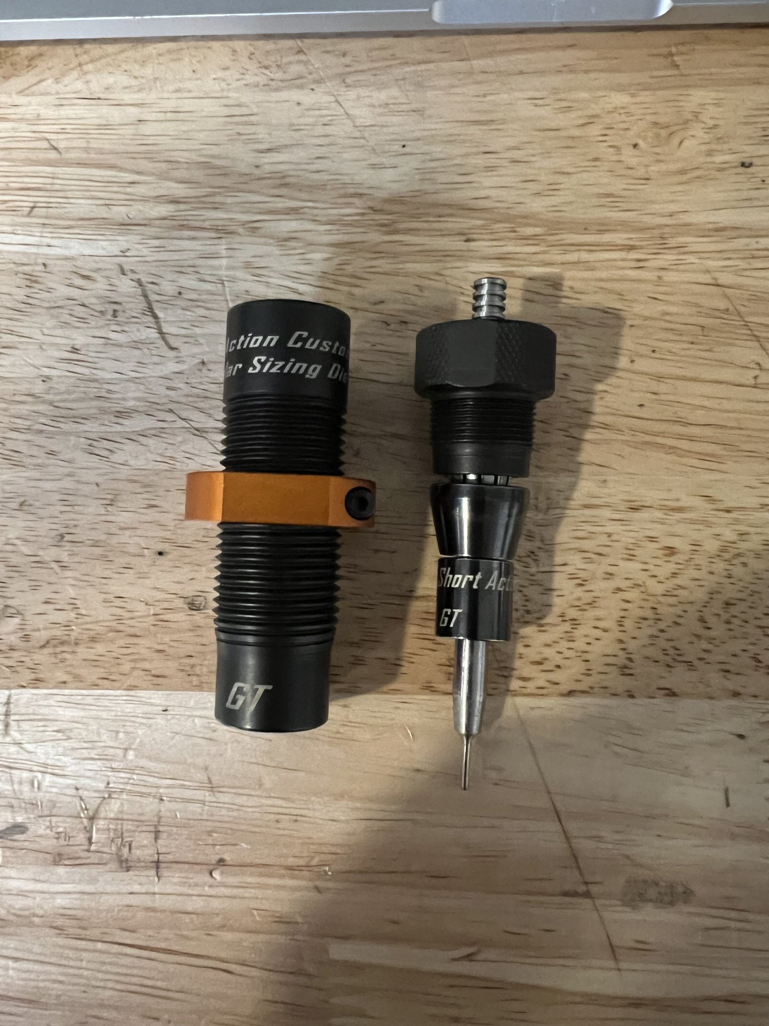

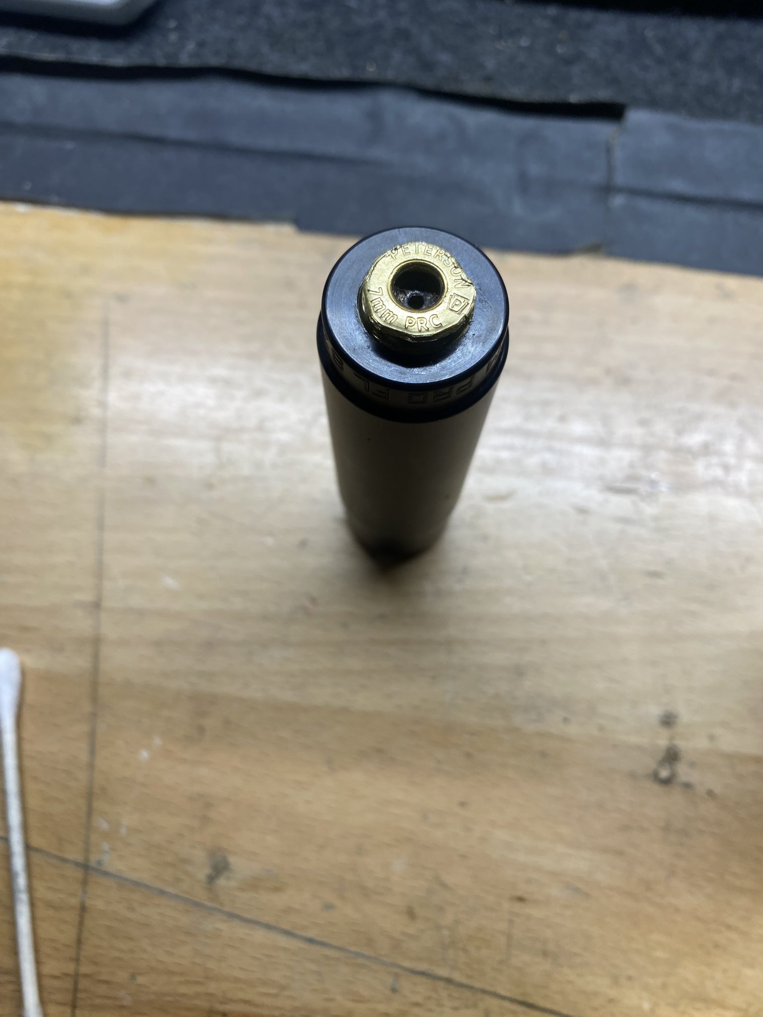

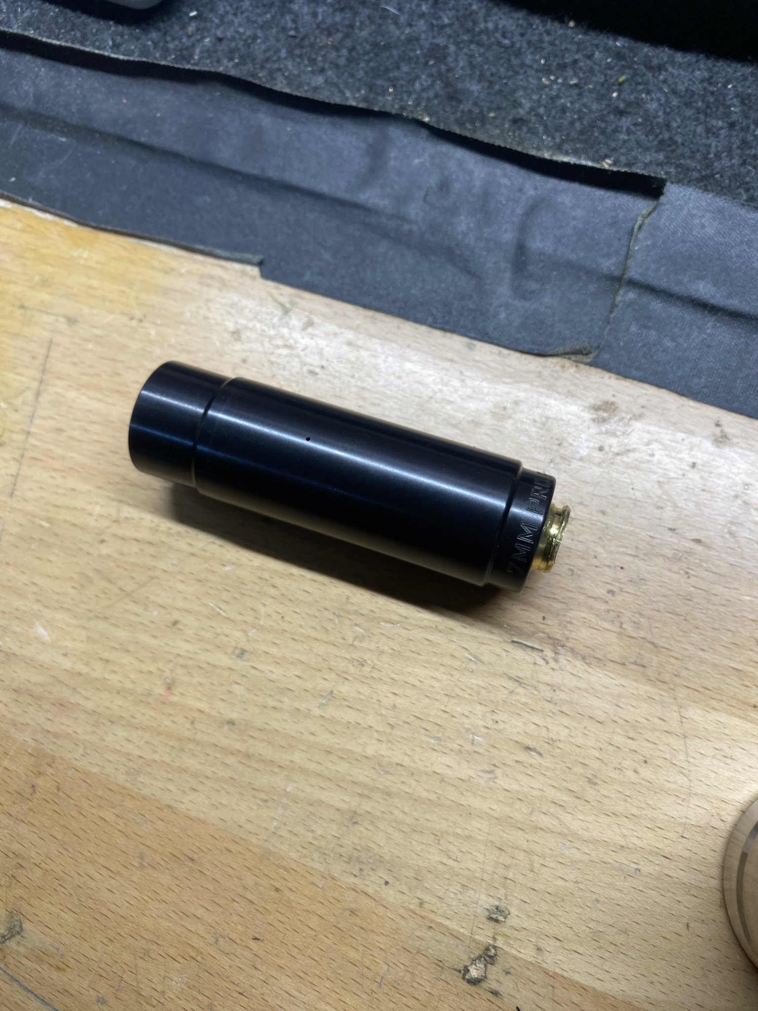

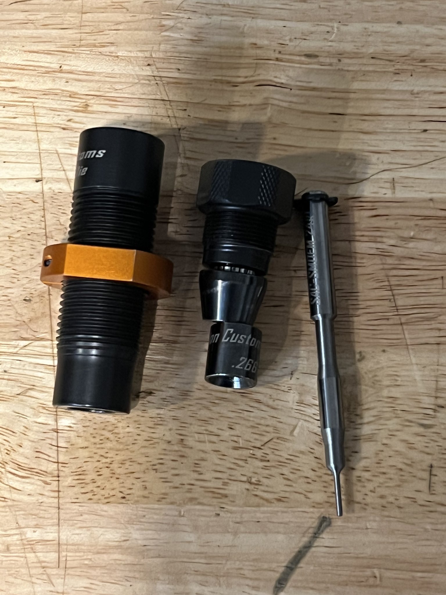

Well I attempted to run my first piece of brass through my new M die. It immediately got stuck and now it’s fucked. I read some of the comments here before running the die, I lubed the case and case mouth with Lyman case lube and that’s all she wrote. I tried removing it to no avail, the fucker is in there.
I contacted A419 and they sent me a label and now the sleeve its on its way to them. Figured I’d let them fix it to avoid me getting frustrated and damaging it.
Bummer for sure but am pleased at how fast they responded and jumped on the issue.
