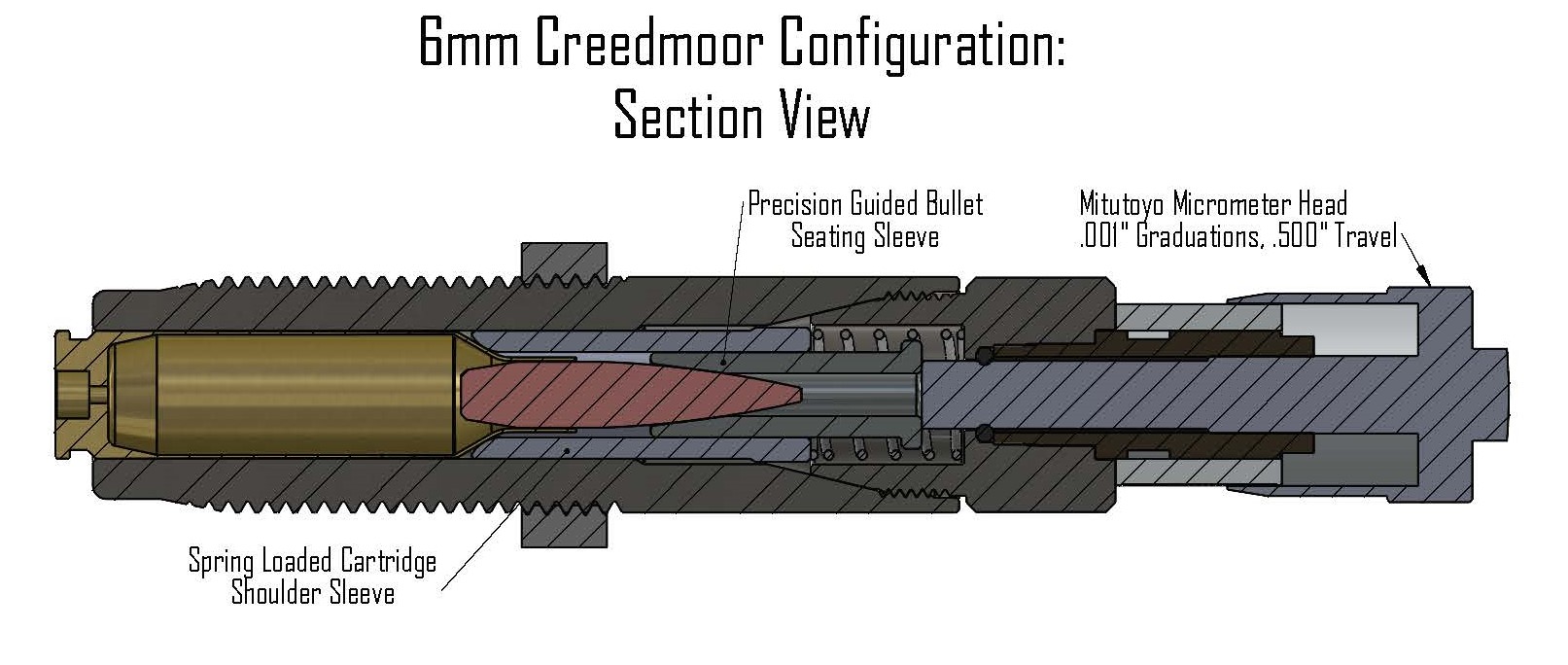

We first started using Newlon die blanks in 12L14. They are a pretty good product, but we were running into supply issues and it always bugged me that the bullet seating stems would mark some bullets up. In addition, I hated the fact that people need to buy so many different bullet seating dies for cartridges that were extremely similar.

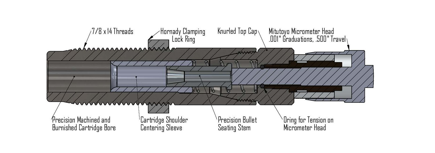

So we started designing "The" Seating Die with the goal of being able to offer one die that could seat bullets in a very straight, concentric fashion on a variety of cartridges. Furthermore, we wanted to solve the seating stem problem that most dies have.
So we developed our seating with these features in mind. The heart of the system is the die body which we make from 12L14 then Black Nitride it. We chose this material because the "breakthrough" with our die body is making a hole through the center of the die body which about as perfectly straight as possible, but also has the inside diameter held to a +/- .0002 diameter tolerance (each one we measure is actually exactly the same size) and has as close to a mirror like finish on the inside. We use a special inside diameter burnishing tool which controls the surface finish and diameter. This is why we chose 12L14 is because it is ductile enough to allow this process to work. We made some prototypes in 17-4 Stainless, but the I.D. Burnishing process didn't work as well. Lastly, the diameter is a little over .4730" which offers a .001"-.002" clearance for the base of most short action cartridges to center up. Again, that is only .0005"-.001" per side of clearance. I grabbed my (Brand X) sliding chamber sleeve from the bullet seating die and measured the body diameter and it was .005" larger than the cartridge body.....so are most bullet seating dies ACTUALLY supporting the case??
Next, we designed the "Cartridge Shoulder Centering Sleeve" to only have a .001" fit inside the die body, which keeps the two very straight and concentric. The Cartridge Shoulder Centering Sleeve has a radius on the bottom which interfaces with any shoulder angle of the cartridge and centers up the shoulder with the die body. Now we have the cartridge base and shoulder held considerably straight.
Then we made an oversized bullet seating stem with a .3145" outside diameter. We did this so prevent the bullet contact geometry from swelling and bulging over time like my (Brand Y) bullet seating stem does.Next we made the stem with a through hole to 1). Prevent suction on the bullet 2). prevent any bullet tips from contacting the stem 3). Ease the manufacturing process, chip clearance when precision boring.
We also tried a bunch of angles for the bullet seating stem and created an angle that fits the bullet a little lower on the bullet nose which prevents bullet damage and creates more contact with the bullet which increases the bullet concentricity. Lastly, it also pushes the bullet down closer to the center of gravity instead of at the top of the bullet which increases runout.

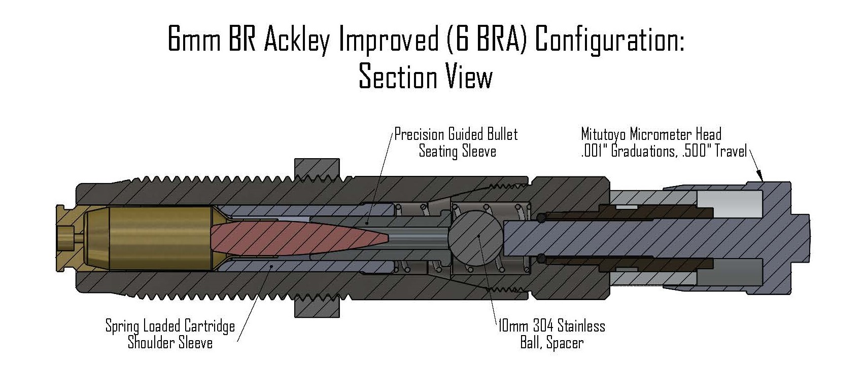

Each seating die will ship with a 10mm polished ball which serves as a spacer which increases the travel of the Mitutoyo Micrometer head. The 10mm ball is not needed for some 6GT, 6x47L, 243 Win, and 6mm Creedmoor cartridges, but is likely needed for the 6 BR, 6BRA, 6Dasher and other shorter 6mm cartridges.
Right now, "The" Seating Die ships as a 6mm seating die configuration. We have found that the bullet seating stem we use actually works really well with other bullets such as some 22 cal bullets as well as 25 cal and 6.5mm bullets. We plan on making some caliber dedicated seating stems very shortly.

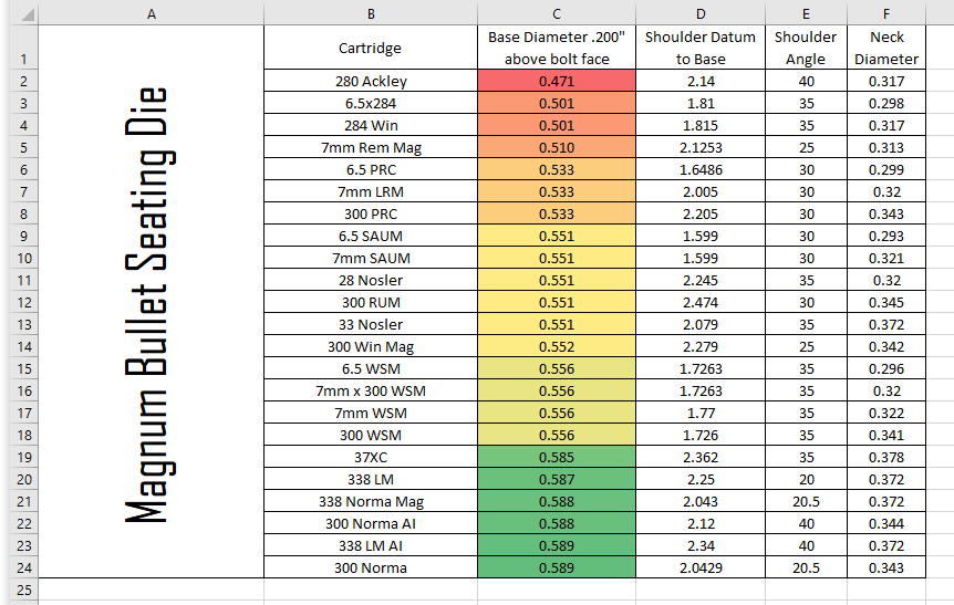

@Mgordon what plans do you have for magnum cases like the 65 PRC and 7 SAUM???
@Hillpuller I had no idea that the seating die was for families. Makes sense to invest into a extremely high quality die when it will work for more than one cartridge
I'm looking into making a die for those cartridges, but it is not going to be as "easy". I made this spreadsheet in excel to see what we would be looking at.

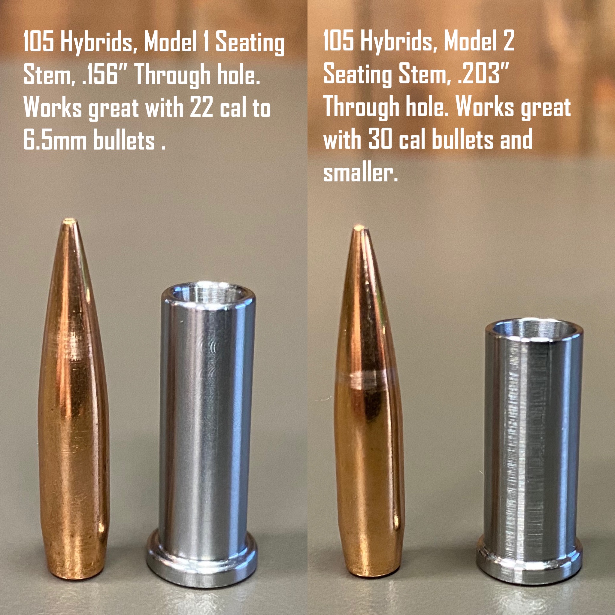

We just updated the geometry of our "Cartridge Centering Sleeve" to allow us to make a bullet seating stem which has geometry for 6.5mm to 30 cal bullets. We now have options for 22 cal to 6.5mm bullets, and 6.5mm bullets to 30 cal bullets. They are respectively the Model 1 and Model 2. On the website, there are two variants listed (Model 1 and Model 2) which are only for the bullet seating stems. The Die body, and all parts are the same, with the exception of the bullet seating stem.
We did some testing with 6mm and 6.5mm cartridges with .004" to .005" of neck tension to see how they would do with the new seating stems. All performed perfectly, even the 6mm bullets with the Model 2 stem which is designed for the 6.5mm to 30 cal bullets.

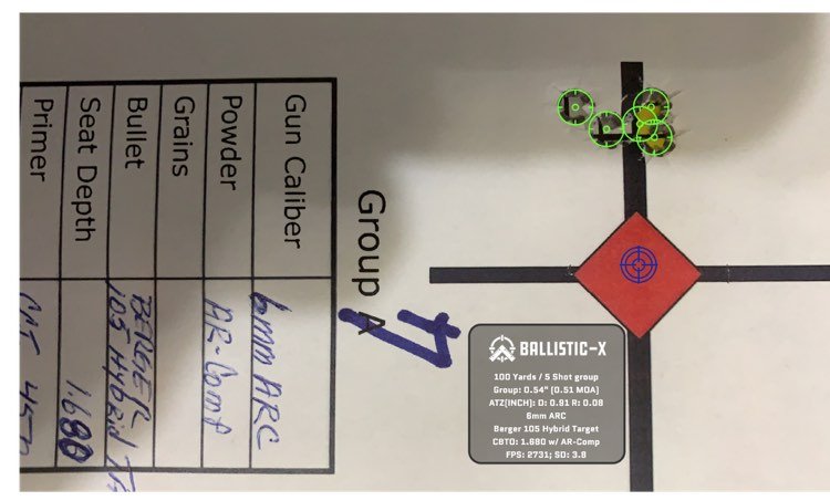

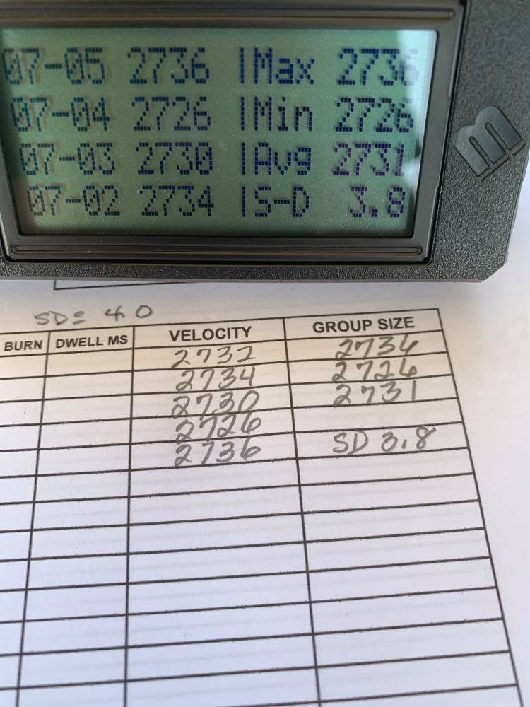

ATTACHED is today's one of my loads:
Mark, is it possible to just buy the # 1 Stem. I have your seating die at which time, it did not give me an option of Stem. I'm assuming i have the die with the #2 stem. I'm presently loading for the 6mm ARC and i'm more than happy with the die. My groupings have tighten up and my SD's have come down. It's a great product and I wish i found this sooner. thanks
Thank you for sharing your results! Every seating die we have shipped has come with the Model #1 stem, the Model #2 is something we came out with this last week, we have them on the website FOUND HERE if one chooses to order a Model #2 or a back up #1.
Mark.
