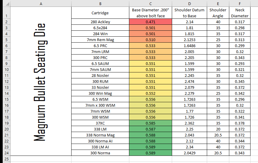

.224 V is too small. It will physically fit, but I wouldn't expect stellar results. Calling BS on the 300NM!
@Mgordon - Sending you a PM of a pretty slick idea you might like regarding the magnum case head puzzle.
