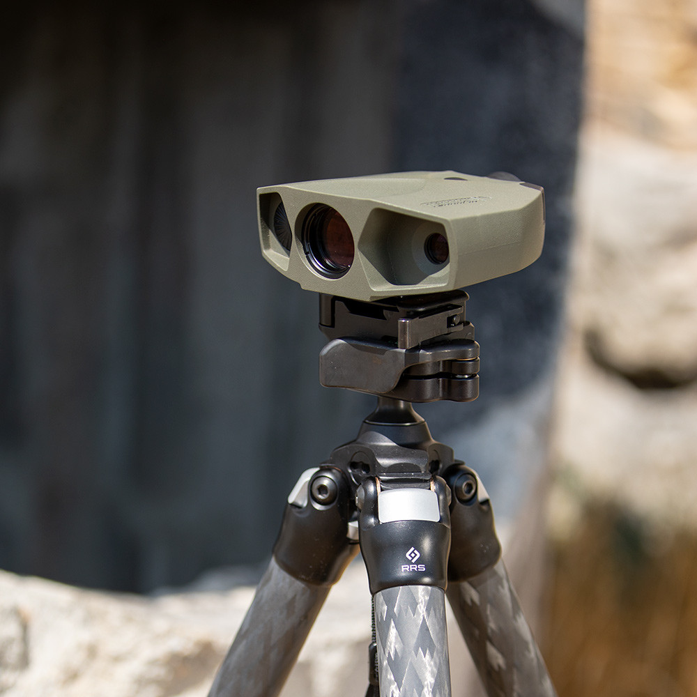

Just identified the plate we would suggest for the TerrapinX.
http://soar.reallyrightstuff.com/BPnS-Plate-for-Vectronix-Terrapin-X
BPnS-Plate-for-Vectronix-Terrapin-X.main-1.jpgBPnS-Plate-for-Vectronix-Terrapin-X.main-06.jpg

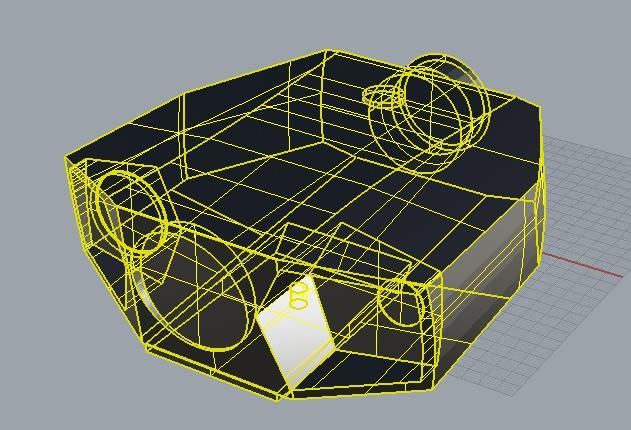

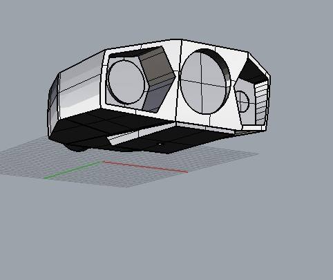

Am kinda disapointed at no response to my e-mails in regards to my questions on 3d model so , am drawing my own for some accesory development ...
Its kinda rough but more than close enough for what i need to model stuff
