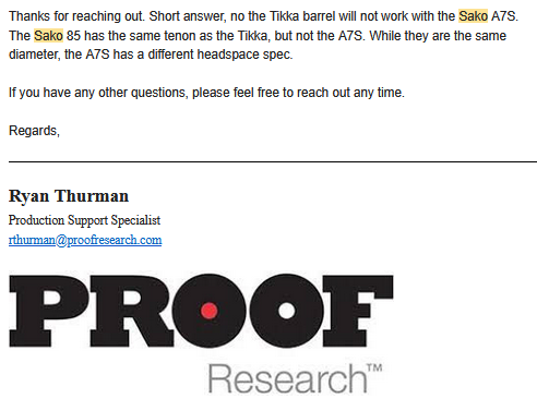

1. Does anybody make a barrel that will work with my action and stock?
2. Is this something that has to be custom fit to the action?
-If so, who does that?
Thanks in advance.
