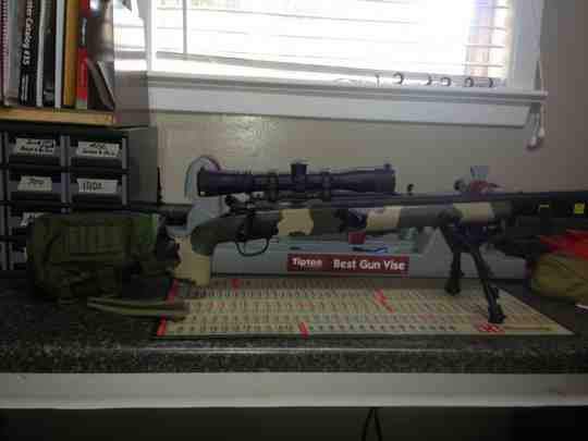

I only have 1 from my phone and it is not good, but here you go. This is actually McMillan Camo, which I have grown to like.
Rifle #1 of 49
Jason

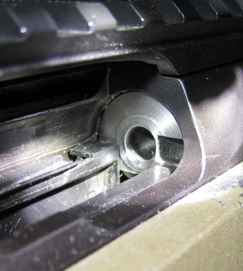

Not a very good pic but you get the idea of what the factory chamber looks like. I did this to both of my Rock Creek barrels that Chad did for me with a very fine stone. Worked great!
As for the bolt not working when the action is torqued. That happened to me in my non bedded Manners. Tom offered to help but I got it taken care of. My problem was the bolt release was getting pulled down tight to the top line of the stock. I shaved it down very slightly where the bolt release was and it worked like a champ.
Nice Geno, I no longer have my factory Sako barrels so I can't post a picture of the factory radius job. That slight radius & ramp from about 5 to 7 o'clock is what you need to try and duplicate on the straight-cut Lilja barrels. A small diameter cratex drum does a great job and leaves a very smooth surface finish.
I'll try to get a pic of my modded .22LR Lilja tonight but I simply tried to duplicate how the factory barrels were done.
I have 5 10 round .22LR mags; prior to the radius job each mag would only feed properly when loaded with 7-9 rounds (mag dependent) and even then I'd have the occasional first round misfeed into the bottom of the chamber gouging the bullet nose. After the chamfer/radius job all 5 mags run perfectly loaded with 10.
Edit: Just got home and took a pic of the chamber. The pic exaggerates how deep the ramp/radius is at the bottom, it's only about .020" in from the breech end of the barrel. This is attempt #2; the first time I made the radius much shallower (maybe .010" at most) and only around the 6 o'clock position. That improved the feeding with 10 rounds in the mag but it would still hang up from time to time so I removed the barrel, increased the radius to about .020 and also feathered it up the sides a little more just past the 7 and 5 o'clock locations. That made all the difference in the world; I now have about 7200 rounds down the tube between 5 magazines all of which start with 10 rounds and haven't had a first or second round failure to feed.
Use a fine cratex drum and take it slow and easy! Adding the radius and ramp like the factory Sako barrels leaves a small portion of the case body unsupported and if you extend the radius too far you may risk case ruptures. You only need a small radius & ramp to have a huge effect on feeding effort & reliability.

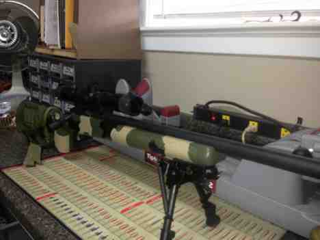

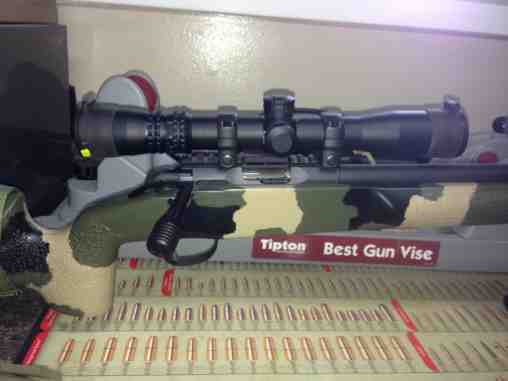

Here is mine...boy is it a shooter
