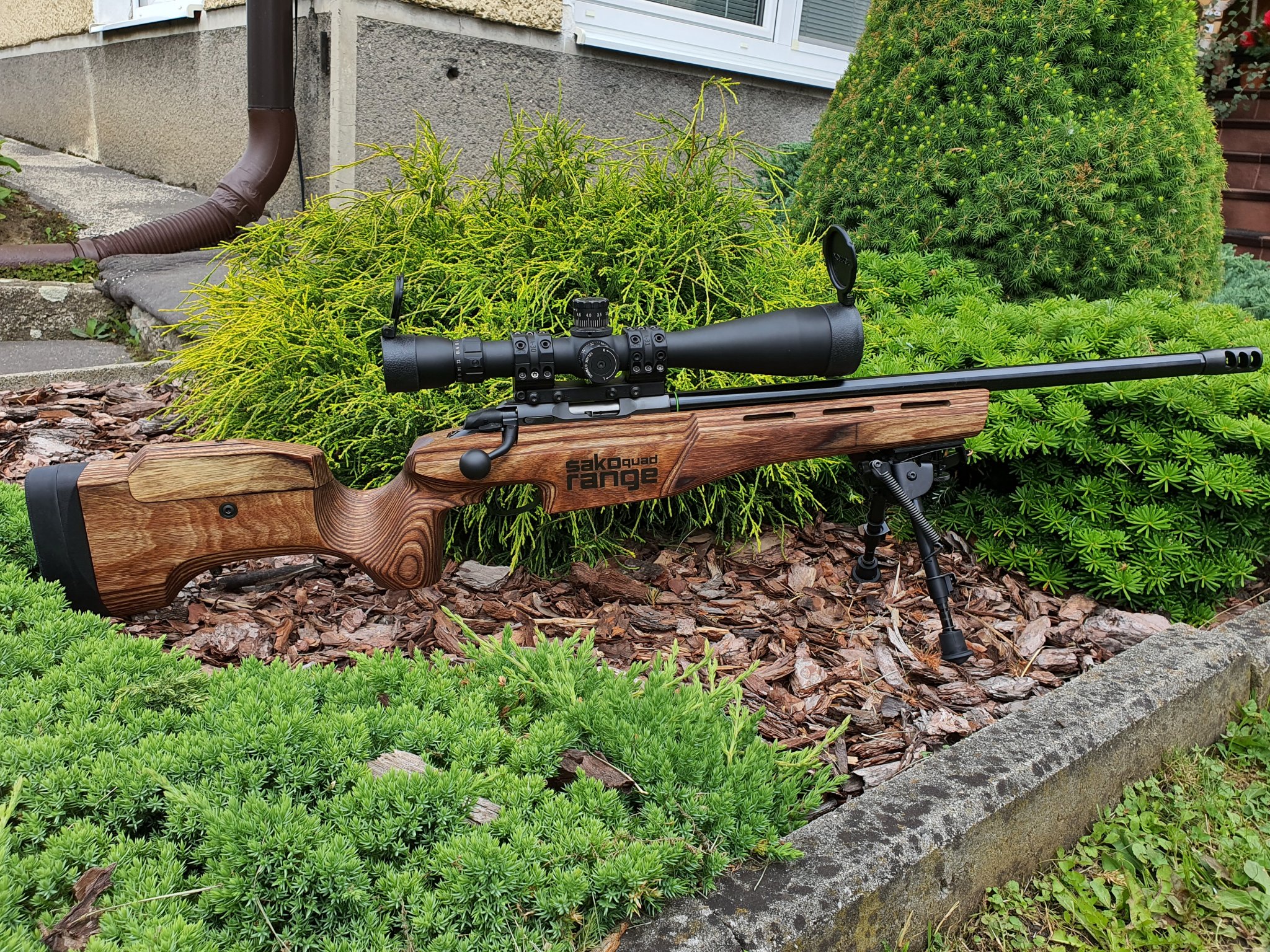

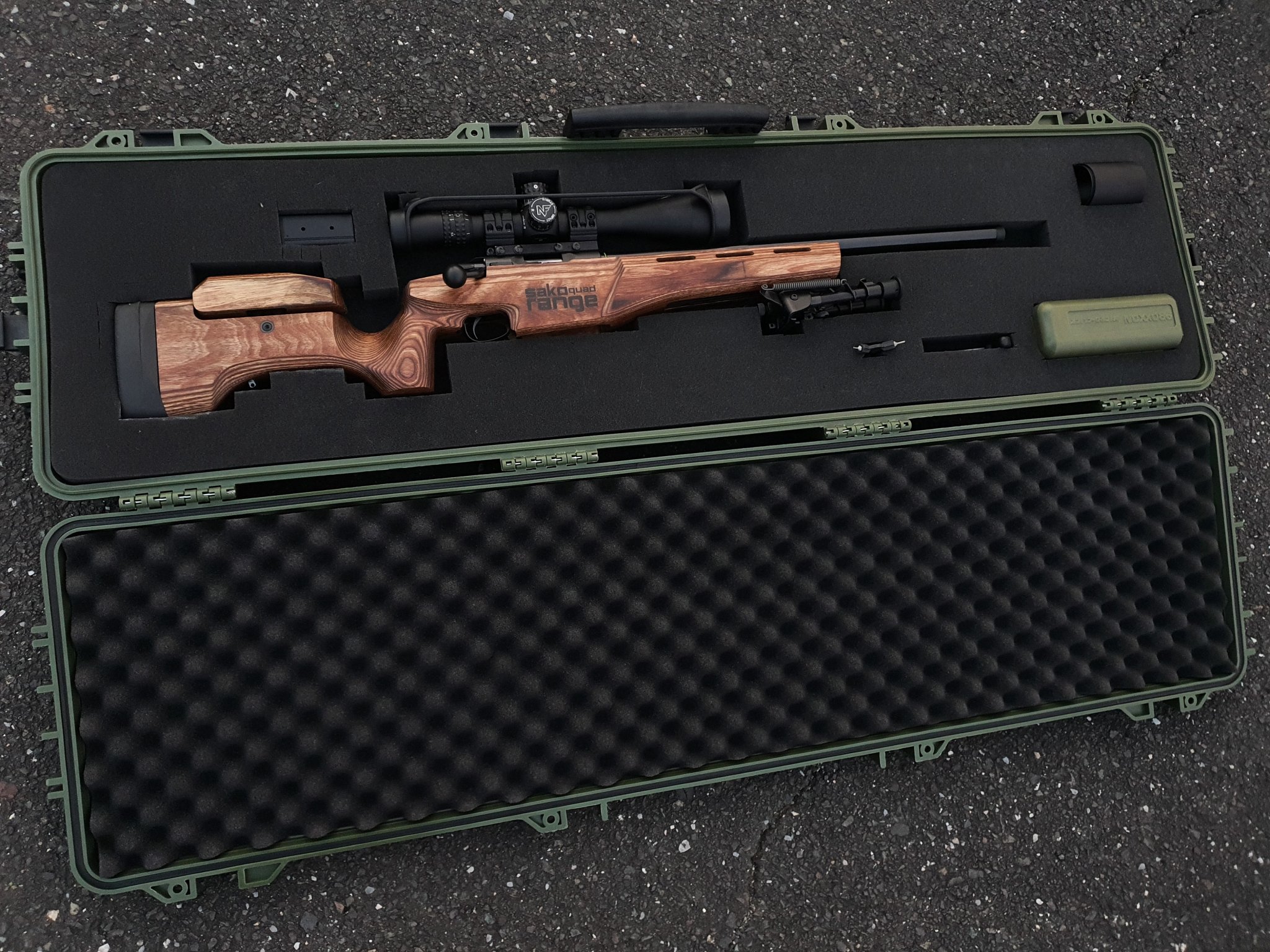

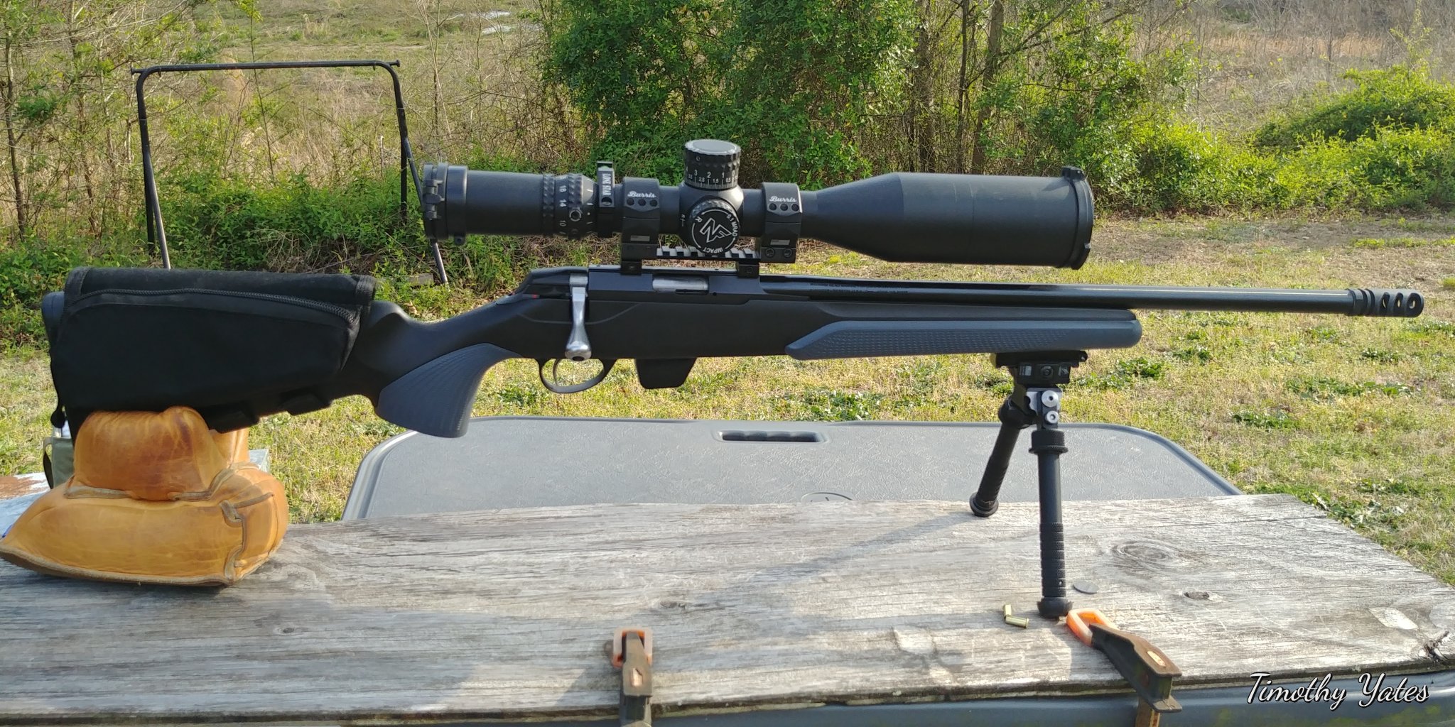

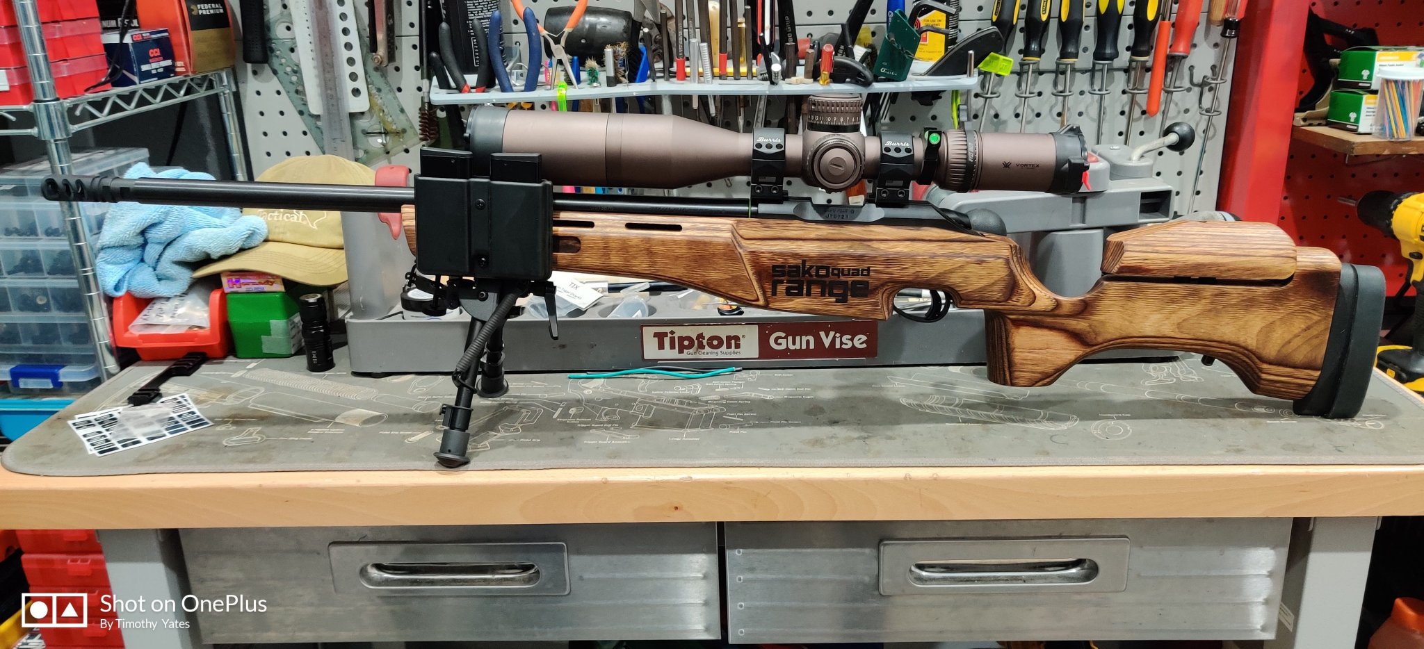

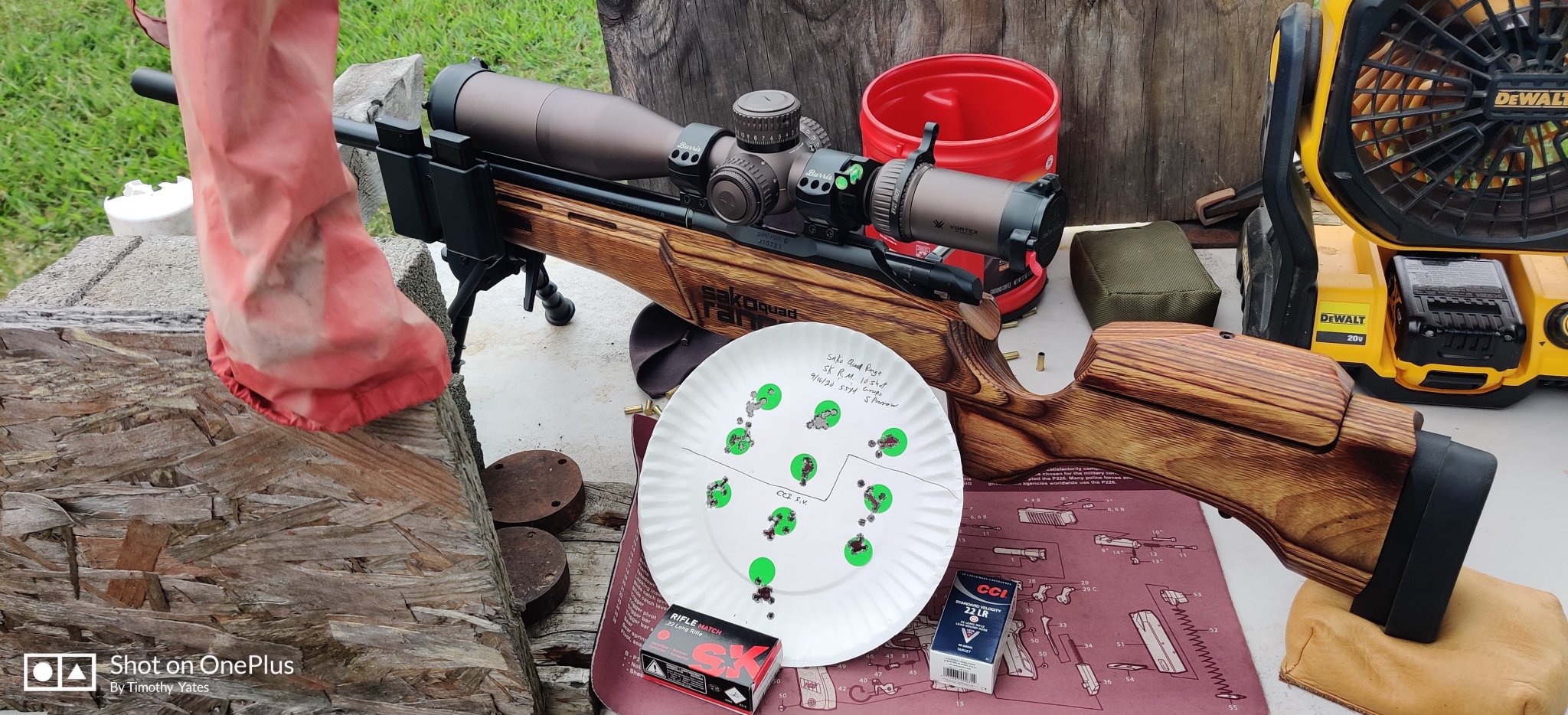

Hello guys,
So, after 5 months of gathering info, waiting, funding, waiting, funding, ordering, and waiting again, here is my rifle build completed.
Rifle: Sako Quad Range 22LR /w Heavy barrel & Set trigger
Glass: Sightron SIIISS 6-24X50 LR ZS FFP / MH
Mount: Spuhr SA-3601
Accessories: Gunbloke Max-TAC2 Brake; DIP Aluminium bottom plate; Sterk Shooting Swept Ball handle; Harris 6-9" Bipod
Glad to hear your feedback ! Cant wait to take the girl out for a proper shooting session.

Last month was kind of sad for me, as I was mostly unable to shoot due to my scope being on RMA. Sightron turned out to have a faulty parallax correction, and also caused POI change when I zoomed in or out. Eventually I managed to get my money back, and went for another scope, which might or might not be an overkill.
This is my rifle as of today, fitted with a Nightforce NXS 5.5-22 MIL-R which i got brand new for 1700€. As for ammo, i currently use Lapua Center-X and CCI Standards. Will spend some time training for a local rimfire competition season, starting in March. People mostly use old CZ's and Anschutz for these, so Sako will sure be an unicorn there.
Talking about upgrades, I must say that the Sterk Swept Ball handle was the single most useful upgrade for this gun. For now, it is in a state that I've always wanted, greatly surpassing my capabilities as a shooter, not really requiring any additional work. But you know this sport, so i might eventually get a Lilja barrel or BnA trigger. Was also looking on Accuracy 1st ball level, and I still need to convince Sterk to machine titanium bolt shroud as he does for Tikka's :D
I need to get to a shape when I can shoot 0.5 centimetre target @ 50m/55y with confidence just with bipod and no rear support. Gun is capable of that, I am currently not. 1 MOA or slightly sub MOA is my best score now.

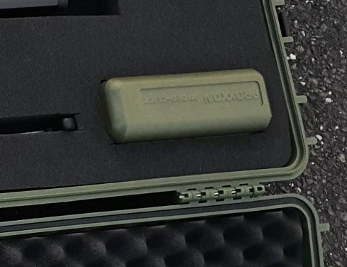

Okay, the gear hound in me has to know...what tools do you have in the Proxxon box?
All the tools i need in the field to strip down the rifle, or repair the easy stuff. There is a torque screwdriver (2-10 Nm) with a detachable T handle, 1/4 to Hex bit socket, Torx 20 and 25 + some Allen wrenches. Corrects the cheekpiece or buttstock, Remounts the scope, remounts the mount, remounts the action, everywhere & everytime the same way.

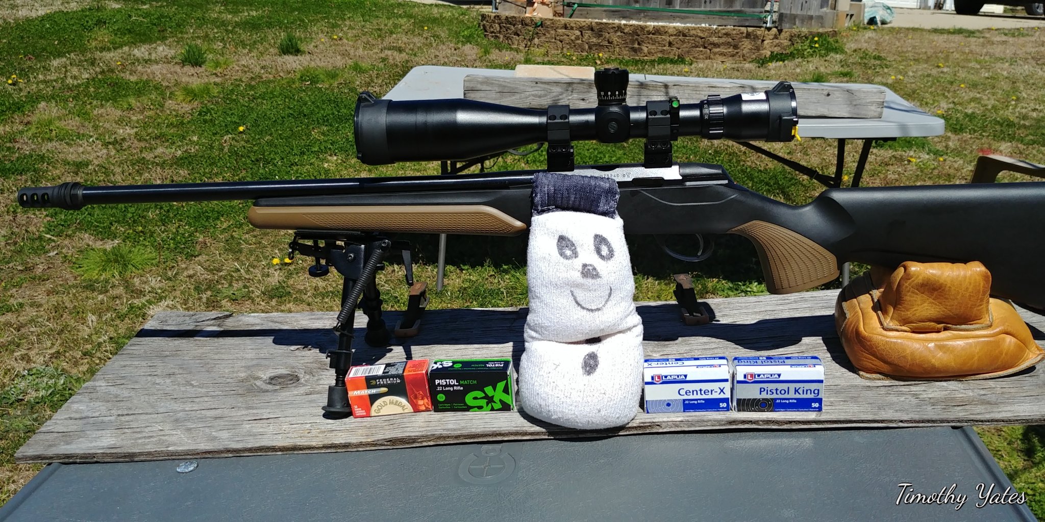

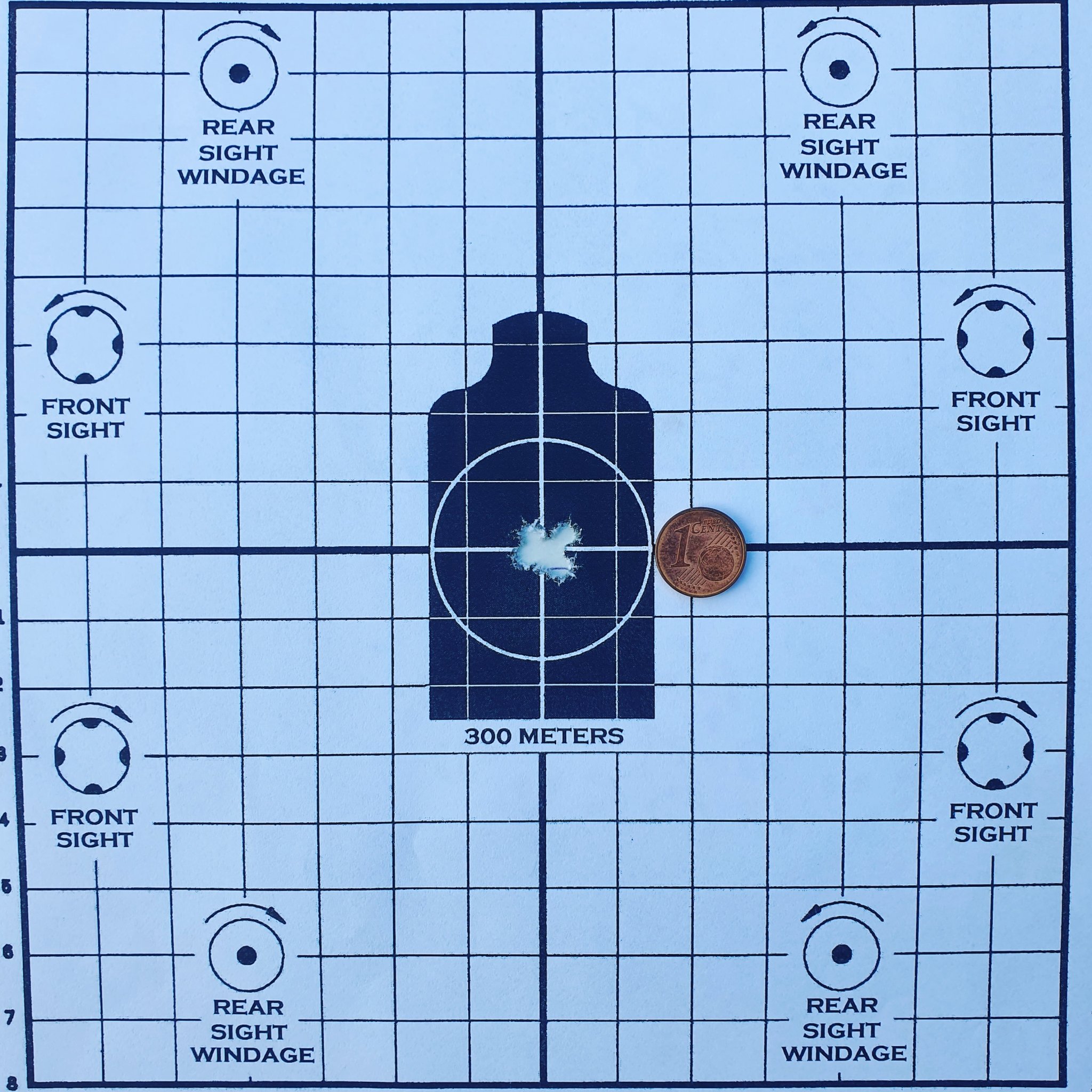

Try Eley Tenex also. My Quad likes it, I have shot it only one lot and still going, but it makes really easily sub-moa. I'd say from 0.6moa to 0.8moa. Because of the price I shoot it rarely, I bought it just to get the refillable boxes they come with. I have around 100 rounds left.
But it is economically more reasonable to buy new barrel and shoot SK Match/C-X, probably obtaining same results. I calculated that just shooting SK plus instead of CX will save me worth a lilja and more in a year. But doubts about the performance of Lilja and other aftermarket barrels keep me from buying one.
Few groups with Eley at 100m.
The flier on the second target is the first shot from SK PM barrel. Both groups were shot on the same target originally.
Here is one where I pulled one.

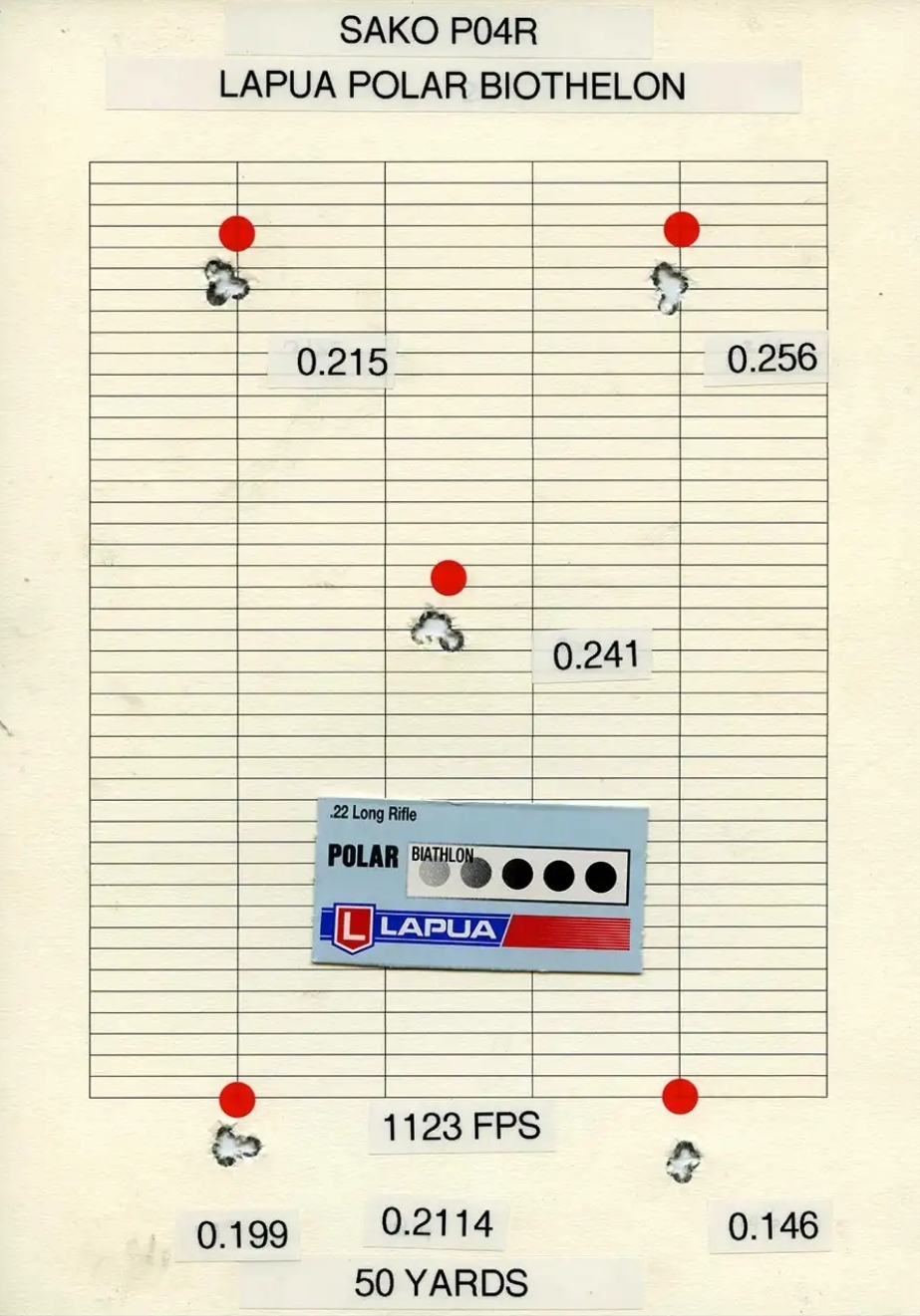

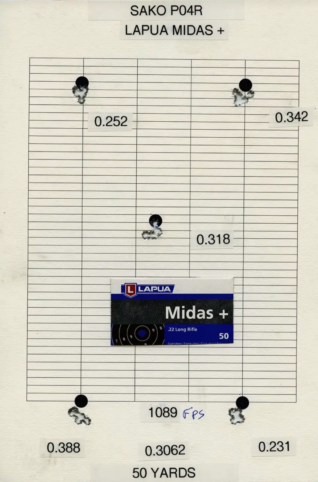

Saaed also made benching with a Quad.
Here are some photos from the thread attached to this reply. Mainly the match ammo from Quad with few cheaper included.
That said, Saaed created some controversy with his group measurements, some of which were straight out wrong which he ridiculously denied instead of admitting. And that said, it is probably easy to lose focus on measuring when you make the same repetition for hundreds of times.

The link you showed Saaed's CX groups at 0.215".
That equals to 5,5mm average for 5 separate 5 shot groups.

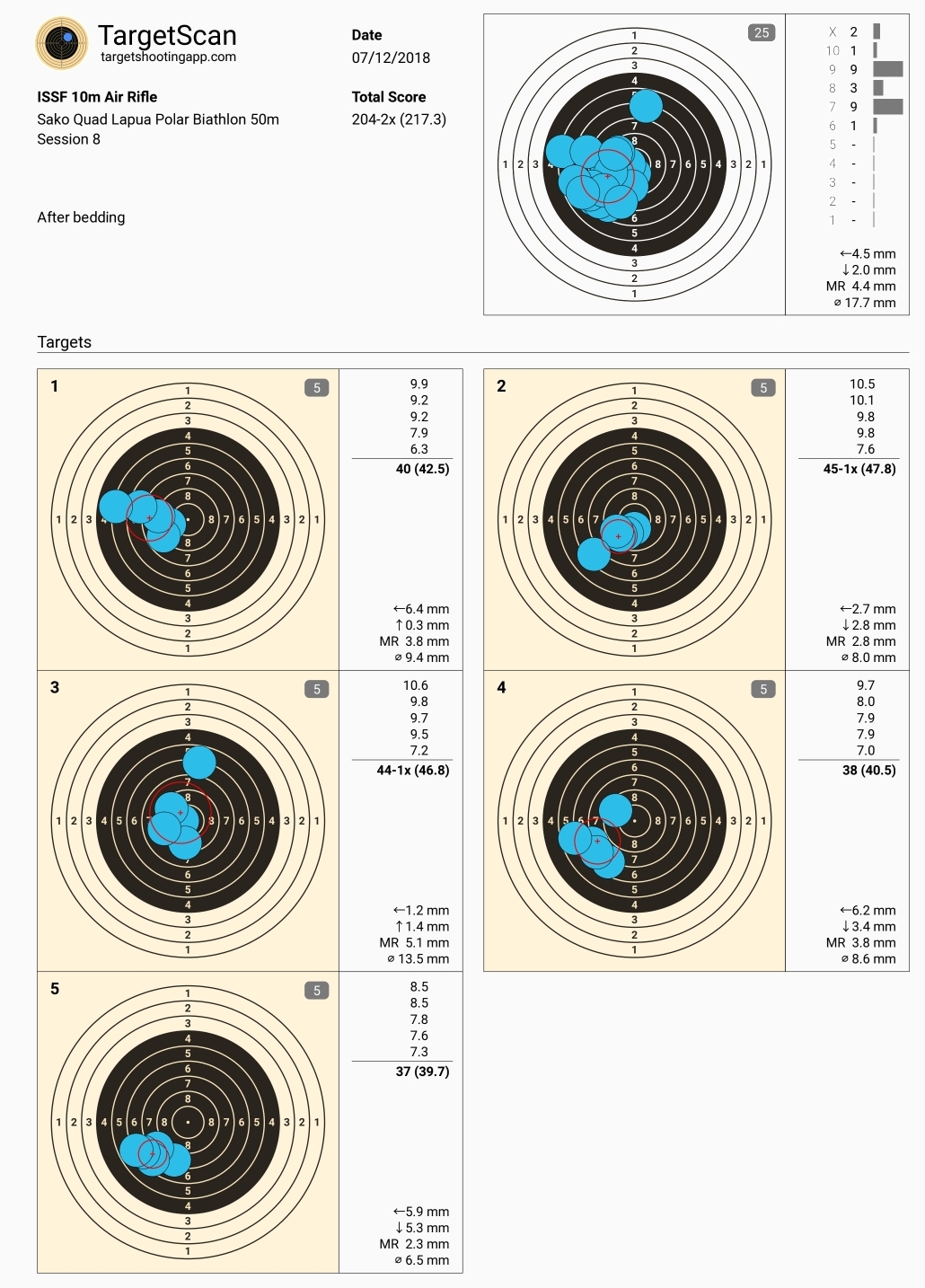

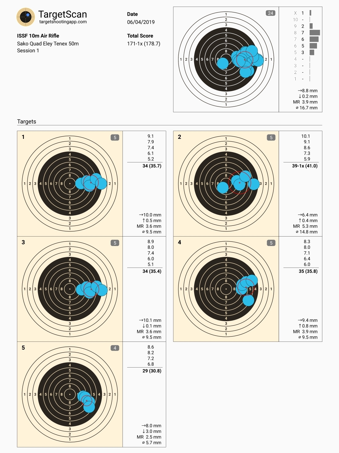

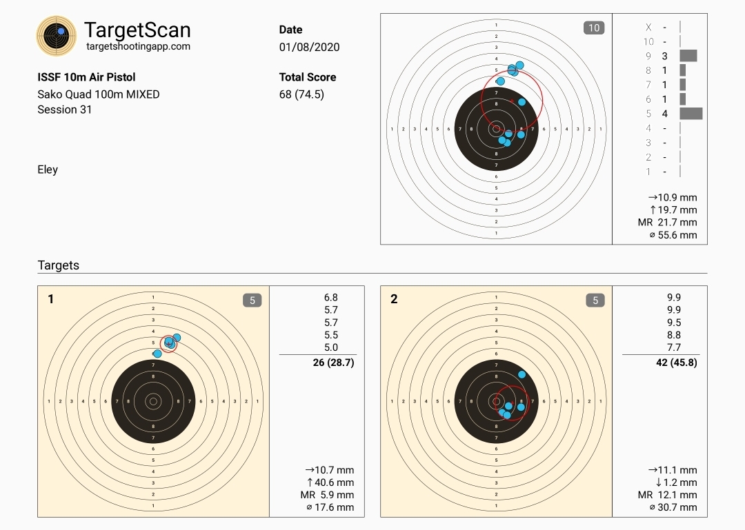

I have made the best groups with the Quad using Lapua Biathlon and Eley Tenex.
I add 2 groupings from me as reference.
Biathlon groups were shot without a rear bag, just the fist.
Tenex groups below were shot with rear bag and I think they represent the maximum precision of 0.6moa on average my present barrel can uphold - I think I do better than that - although even the target shows a clear POA change between groups..
But 19 shots (third group was accidentally a duplicate) within 10,5mm means 95% hit rate within 5mm.
If those 2 lots I have bought would not have been so good, I would have already bought a new barrel. My second Biathlon lot did 1-2moa, just trash.

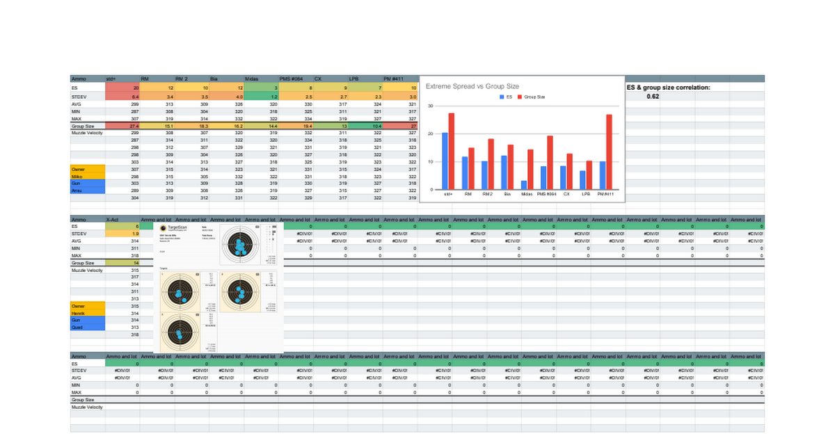

I would order many different CX lots, usually vendors have 1-4 lots in the storage with varying amounts.
I dont remember where or who (maybe jimmy) released test center data about around 10 lots of CX with different guns.
I categorized the results quickly and it pretty much went that 30% performed good, 50% average and 20% bad.
I buy and test lots with that in mind.
There are bad and good lots of everything out there.
I have measured awful SD out of X-Act with horrible grouping and then good ones.
When lot testing make real clean data, no pulled shots included. One is also easily inclined to pick the lot that did the best groups but worse on average.
Here is one test of 10 shots groups out of Anschutz on a bench. Not very admirable. But you can see the load quality affects precision.

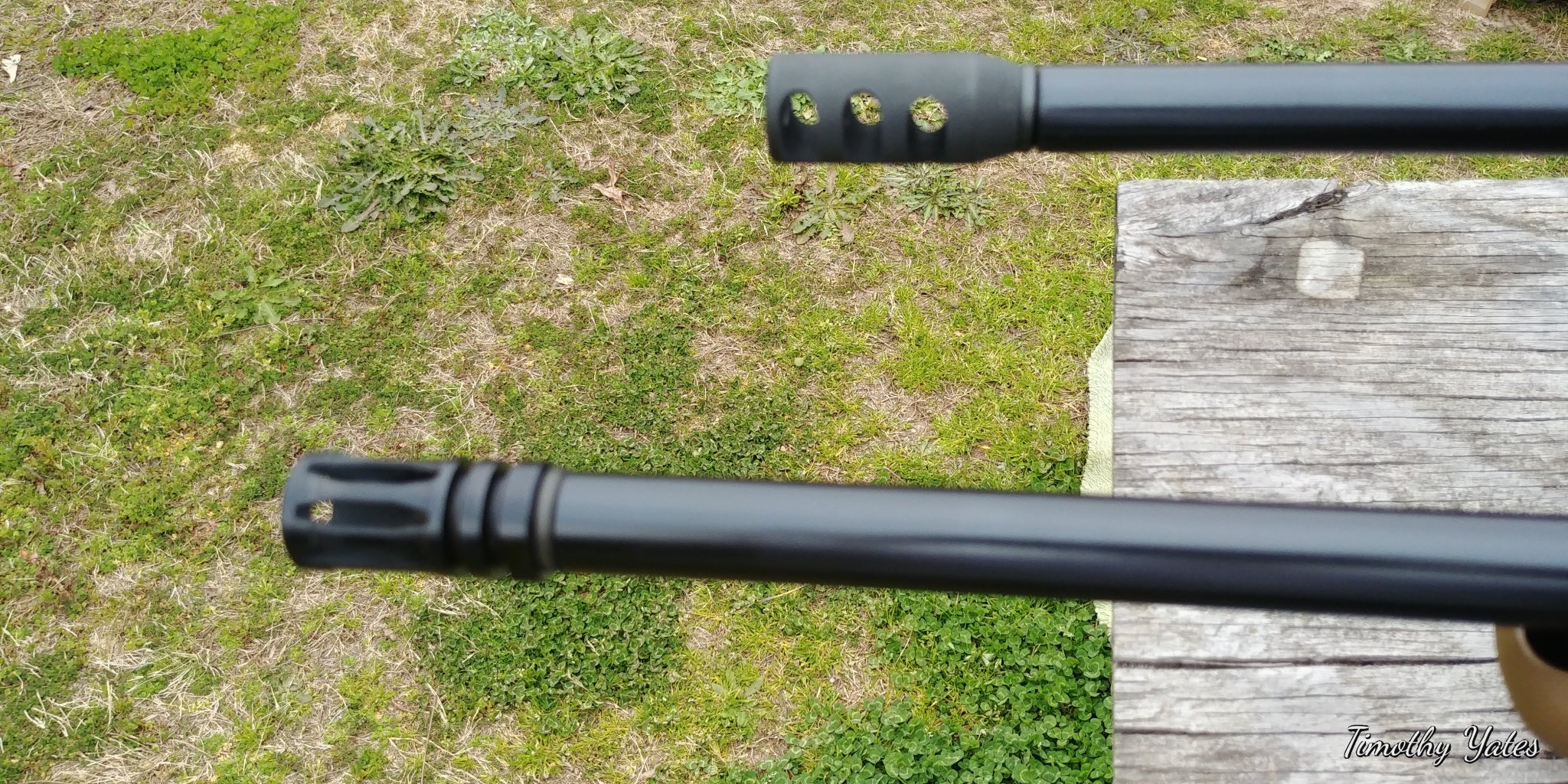

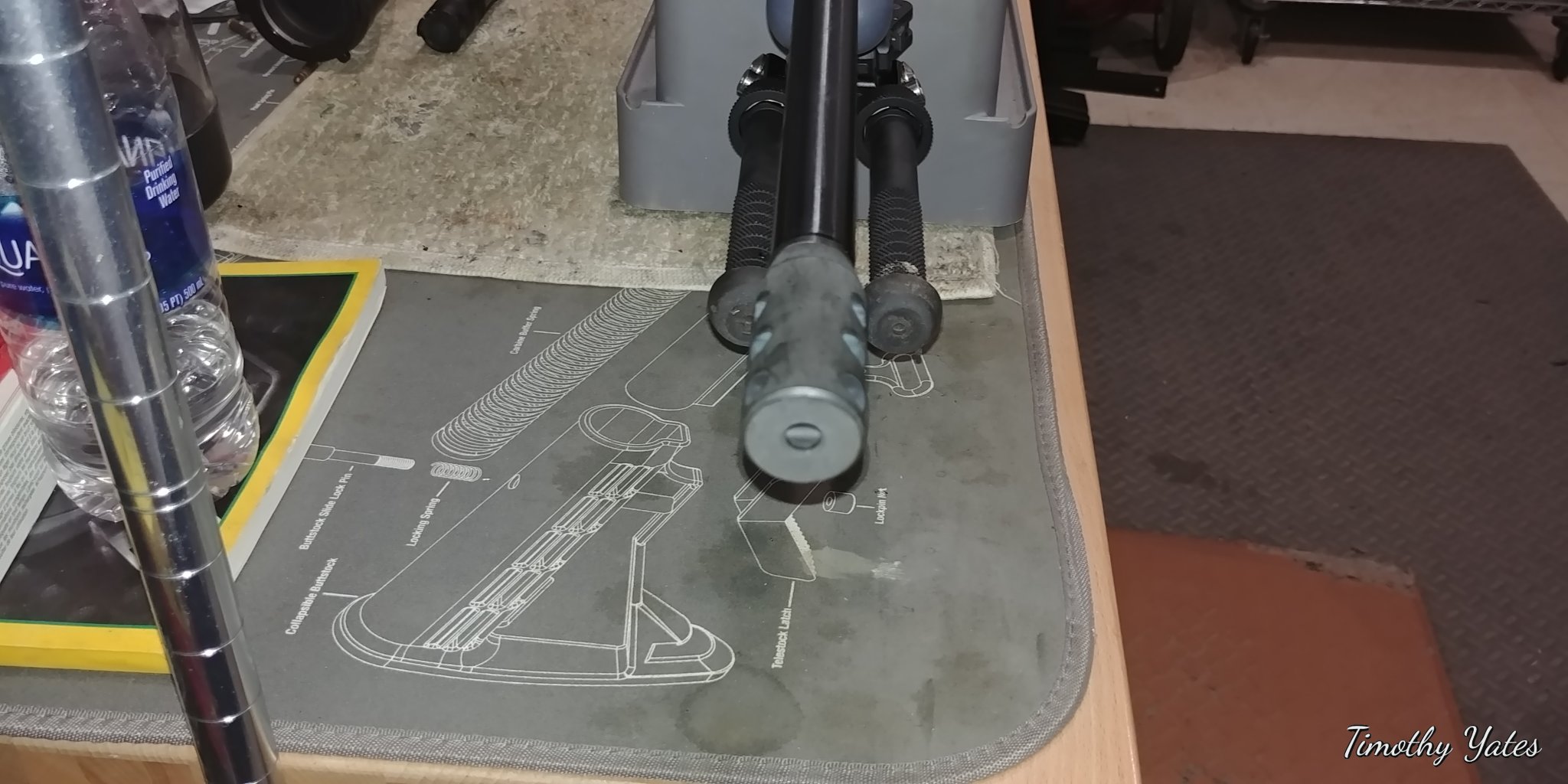

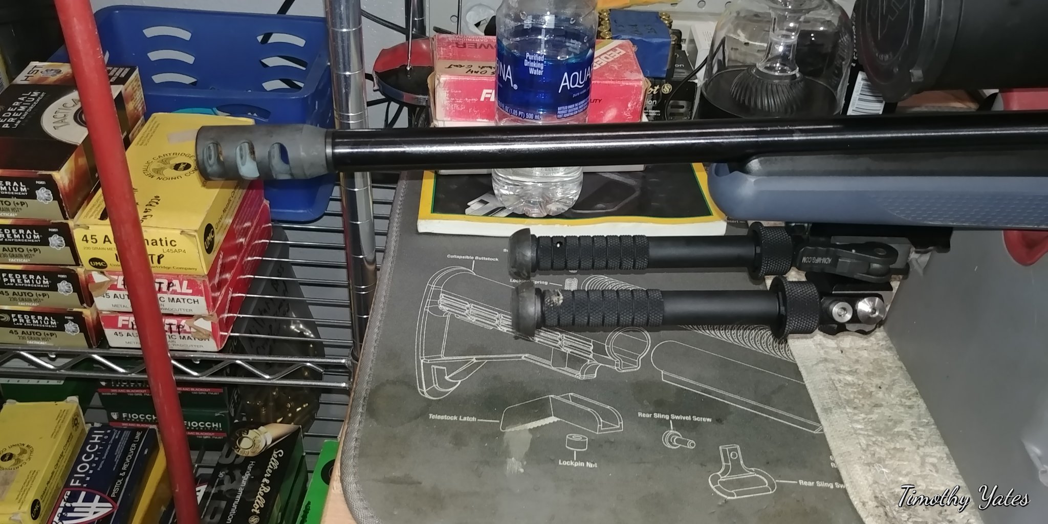

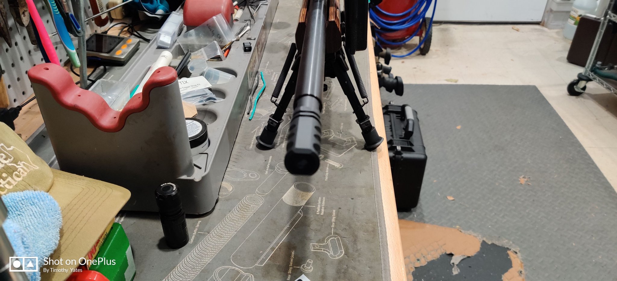

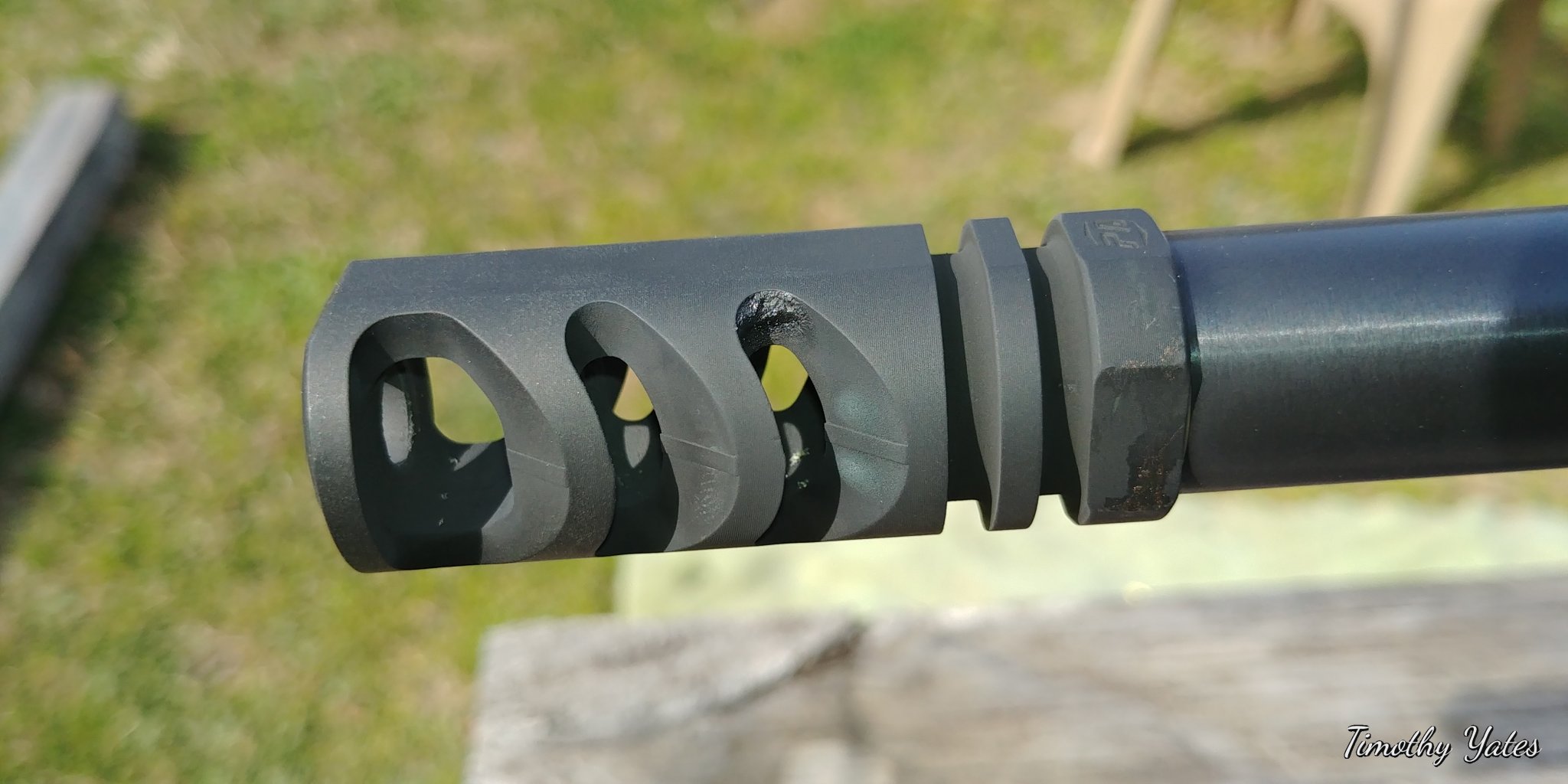

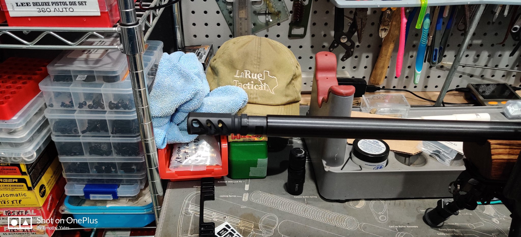

And the last thing - Can the muzzle brake affect accuracy? I have not done a proper testing on this, but I suspected that when I removed it, my POI changed and also my groups got tighter, so I do not have it mounted at the moment. It was mainly for the looks.
The brake will likely have an affect due to changes in gases being vented, barrel weight, and harmonics. A different style brake might perform better or worse. I’ve been tempted on trying out 22LR barrel tuners or dampeners.

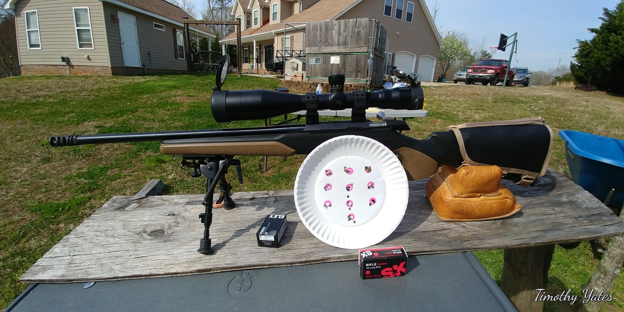

Muzzle brakes can work both positive and negatively. I tried this a few years back with my Tikka T1x's. On my rifles and a buddy of mine, the Silencerco ASR worked best followed by the Lantec Dragon. The AR Bird cage and the Miculic didn't work that good.
This is the Miculek brake.
Lantec Dragon
Silincerco ASR
Trying out different things. This is the Miculek and AR Bird cage.
My buddy still uses his ASR brake. I don't have a factory barreled T1x. Since I like shooting suppressed best, I never kept the brakes on, only experimented with them. One thing to be expected is the brakes are louder even on a rimfire. Not only that but the sound itself has a different tone. The thing is, most good brakes are not cheap so it would be an expensive test to buy a bunch and not work. I already had mine on hand so my cost to try was zero.

Since we are talking about the Quad Range and muzzle brakes come up I have decided to do a test with mine. All around accuracy has never really been stellar with mine so anything I do can't hurt. Don't get me wrong, it's accurate "it's a 70%-80% 1/2" rifle" but not near as much as my P94S Range and Varmint models or my two M 78's or P 72. All my older Sakos are more accurate.
I'm going to start with my Lantec Dragon first and see how it does.

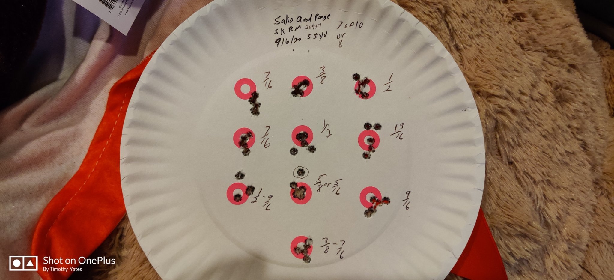

This is the target I want to be better than. This is a typical target for this rifle. How I grade all precision on all my rifles are at what percentage can they shoot 1/2" or better by shooting ten, 5-shot groups at 55 yards. Measured center to center with a ruler. This is a 70% target, hence 7 of 10.
These are 10 shot groups with the Silencerco Sparrow. For some unknown reason I broke my normal way of shooting and shot five, 10-shot groups.
Well, if we measure it center to center with a ruler, then my group posted up in the thread is 7.9mm, which is one of the best I have shot. I even had one 5 group target where 4 shots went through one 6mm sized hole, and one of them (being second round shot) was a flier maybe 10-15mm upper of them, but i dont count this one in. I hope that with selected ammo i will be able to shoot targets like that, or better said, <1/2" at 50m every time and I am happy.
That plate target, you shot that with only bipod or with rear support as well?

Hello guys,
