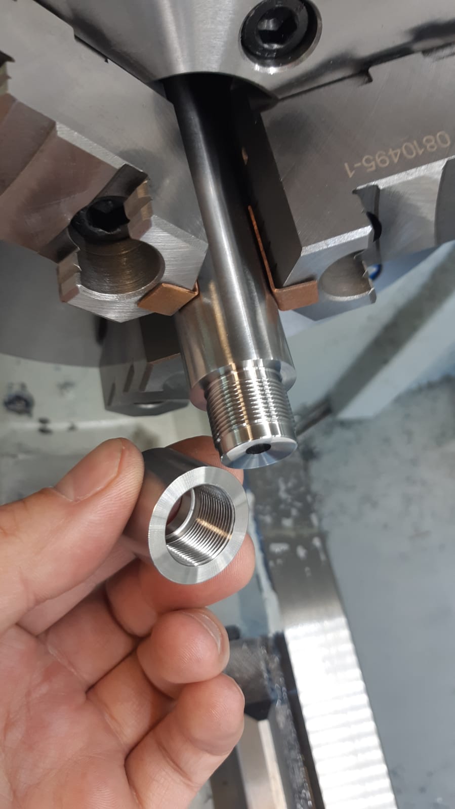

The barrel in the photo is not mine, my gunsmith is finishing T1X rebarrel project for another customer before he gets to my rifle. The customer wanted a thread cap like this, i think that is a very nice work done there.

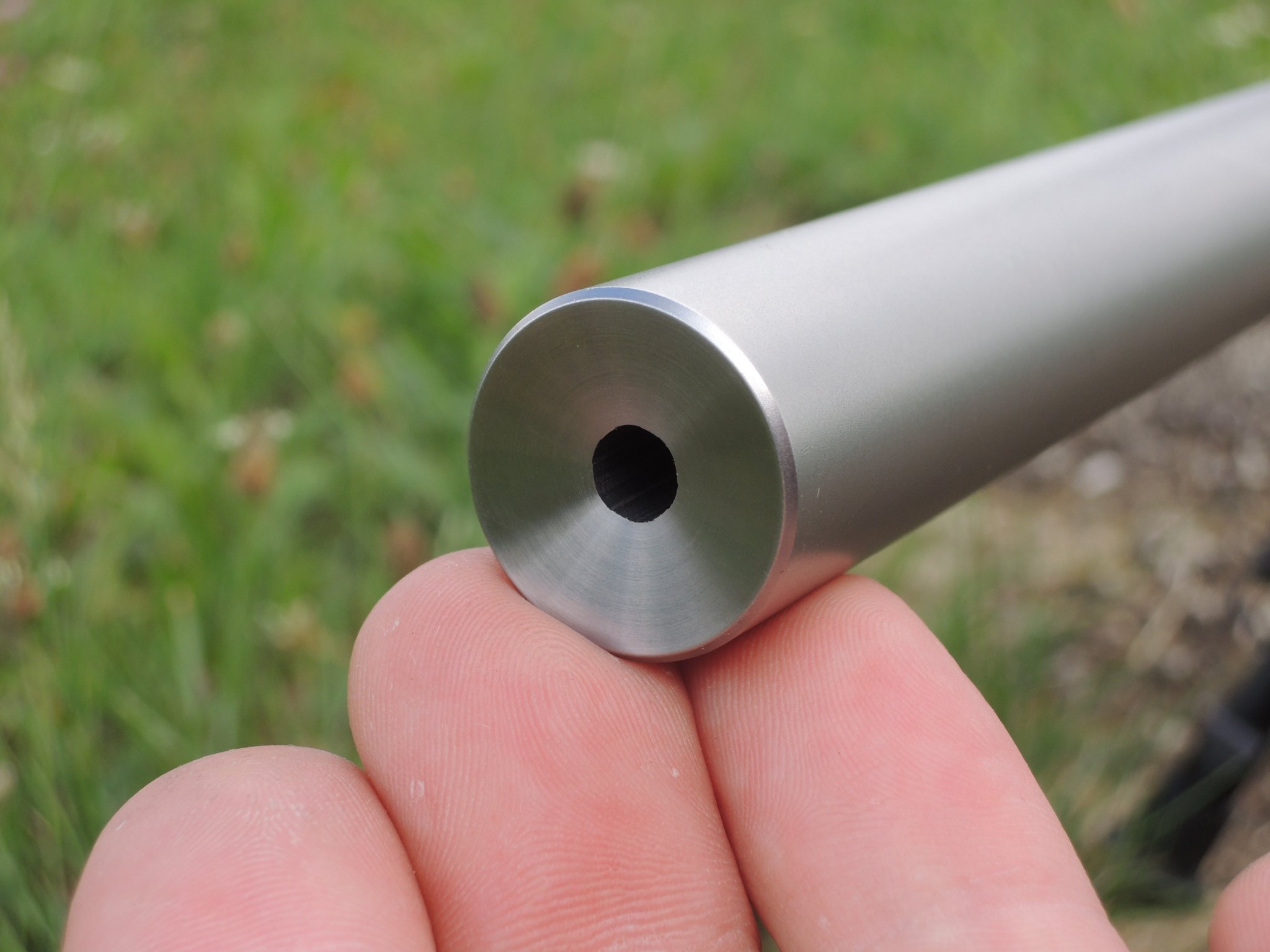

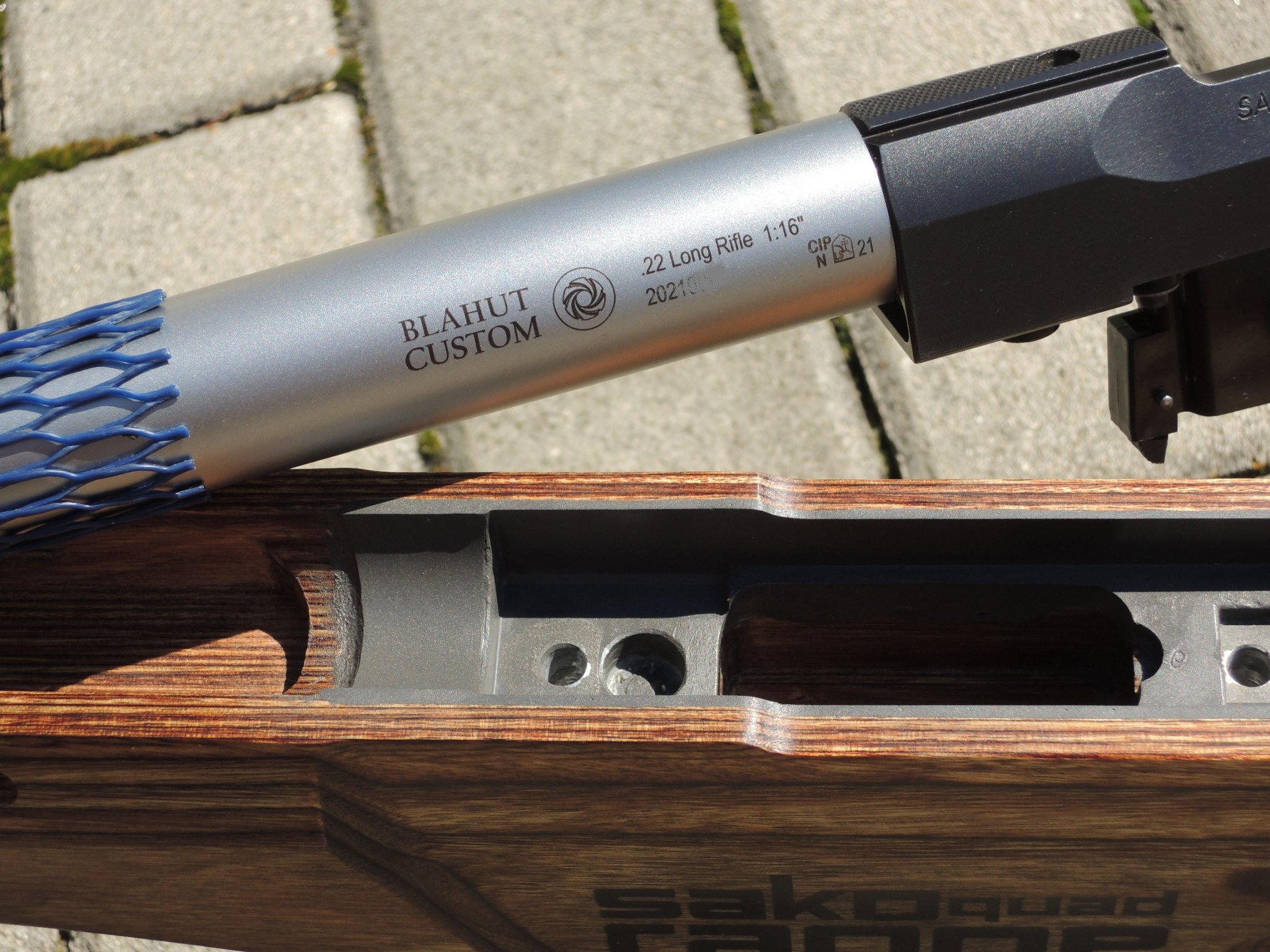

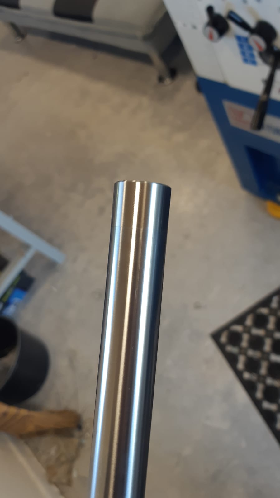

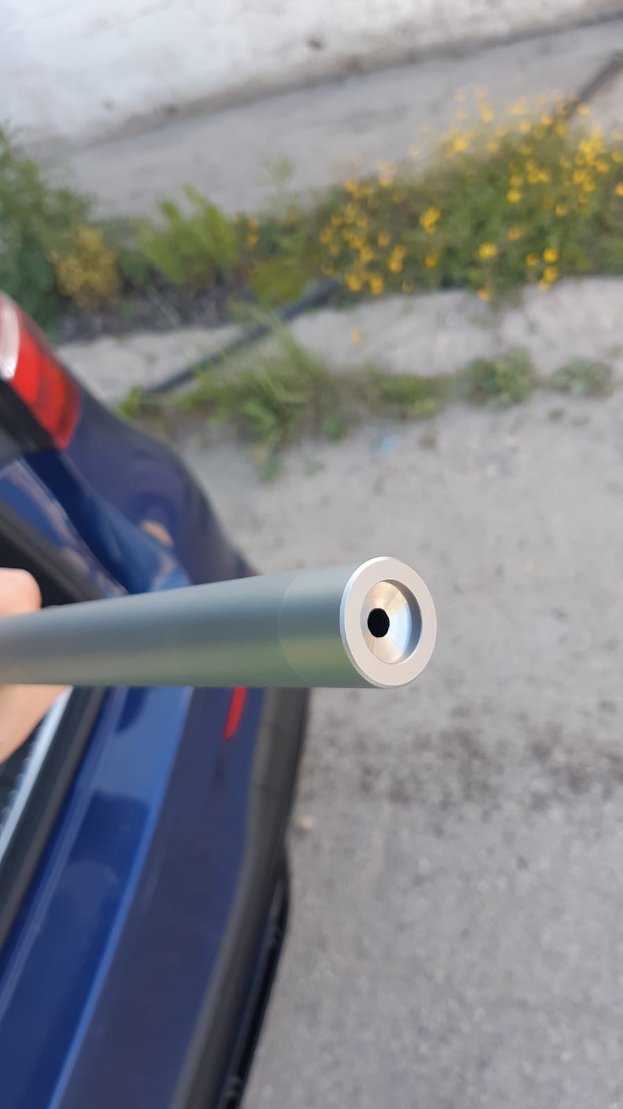

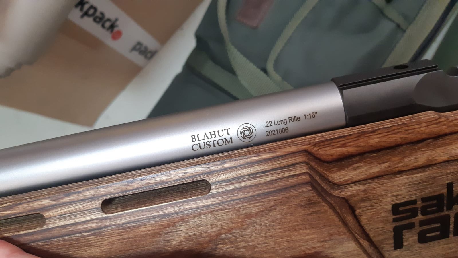

A little sneak peek here for you guys,
LW blank took an eternity to arrive from Germany, but finally, it is here. Crown and muzzle is finished, chamber was cut and the barrel is custom-fitted to the Quad action (we ditched the switch barrel system along with its retention plate). With the Lapua ammunition, the bolt works without a problem so far.
Still have to sort out the bedding, will keep you posted.

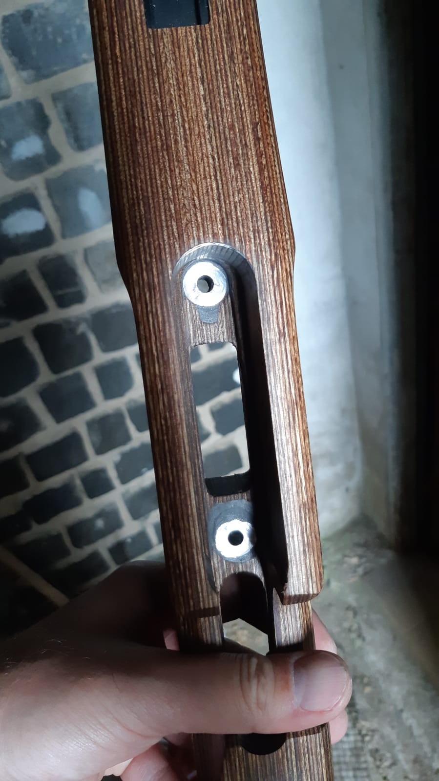

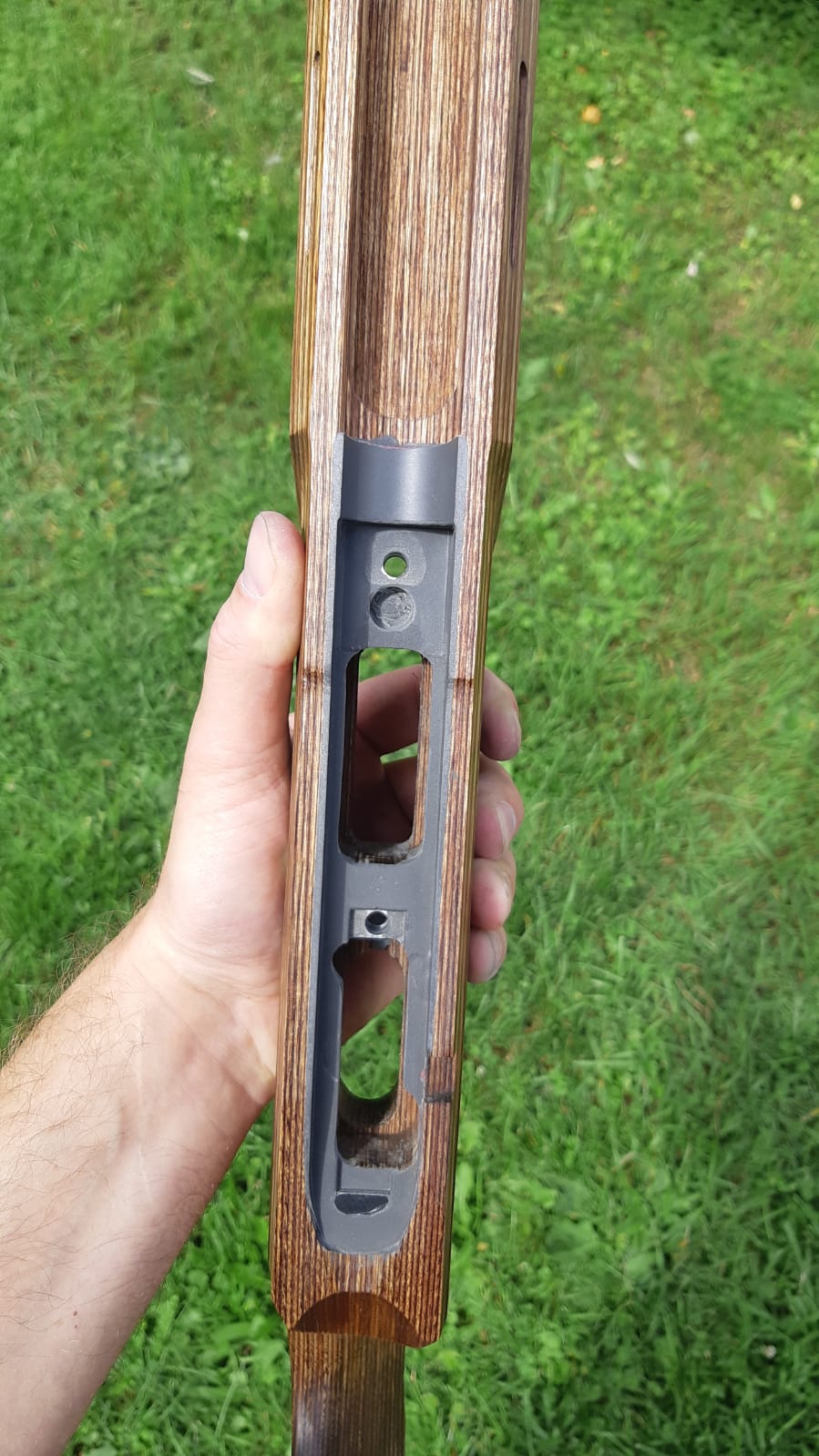

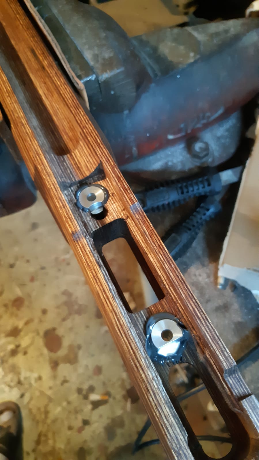

Here comes the bedding. The spacing between stock and receiver was uneven here and there, so the wood has been very slightly milled / cut out to make the layer even.

Thank you, it will take a little bit of polishing and cleaning to chamfer the edges around magazine well and trigger mechanism, the stock will receive last finishing touches tomorrow, and we are good to go. After that, my GS will shoot it for a few days using Lapua and RWS ammunition to break-in the barrel, and to find out and correct any problems that may rise, particularly about proper feeding and extracting.

Congratulations on building up a fine rig Easa. I’ve been planning on installing pillars and bedding my Quad as well, since it’s apparent that the action isn’t resting uniformly in the stock. Make sure to post some accuracy results once everything it’s all said and done.
Regarding the Bix- I have no experience with their triggers, so I can’t offer any firsthand opinions. All I know is they’re pricey; a little too much for me to justify purchasing considering I’m pretty happy with my Sako’s set trigger.

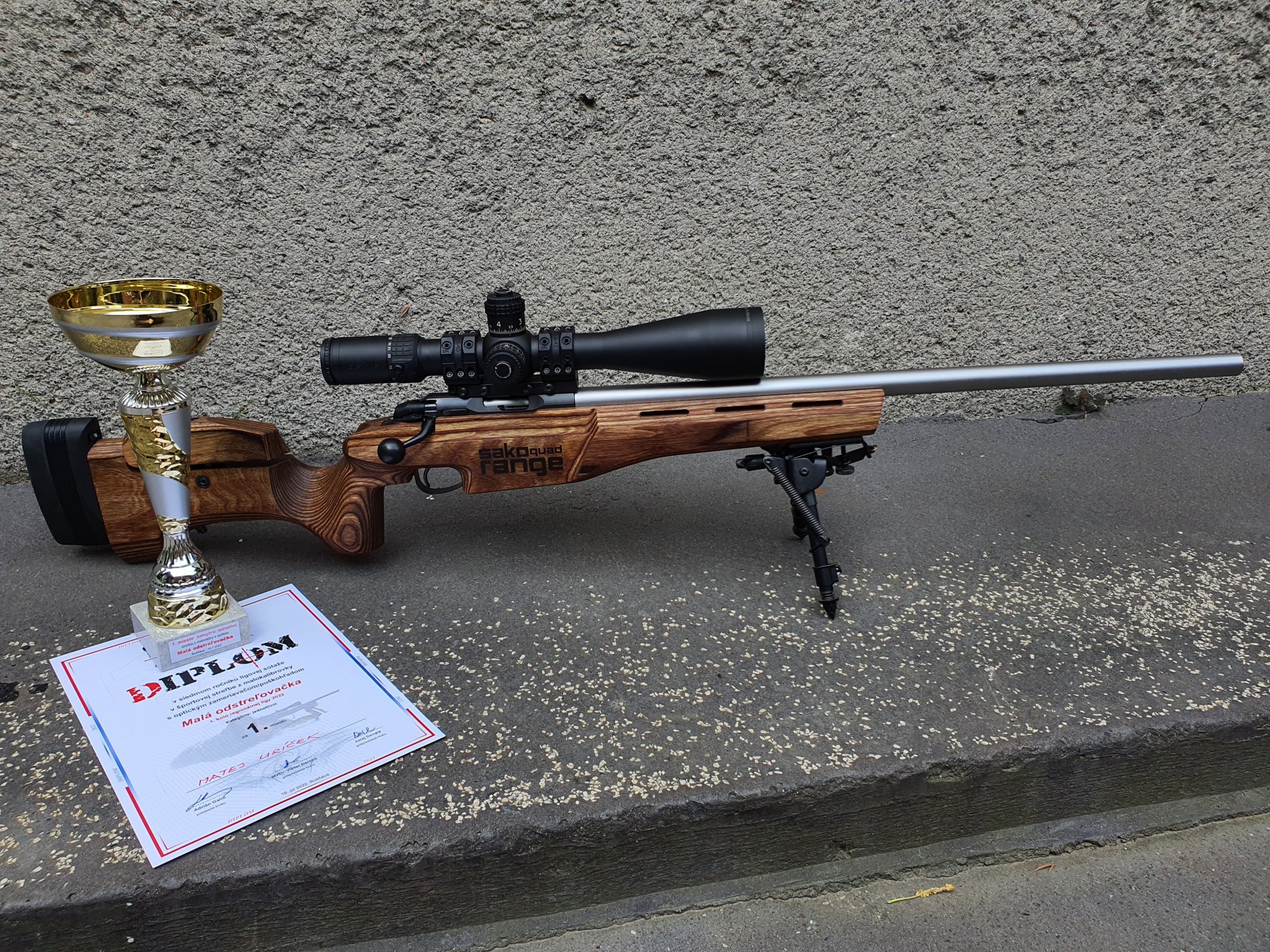

Hey guys, greeting from Slovakia! Long time no post again. To sum it up:

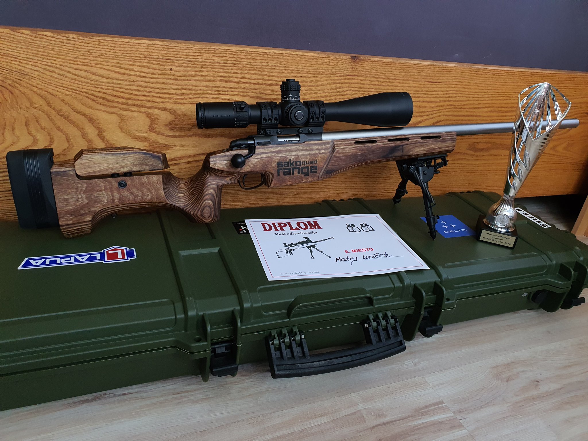

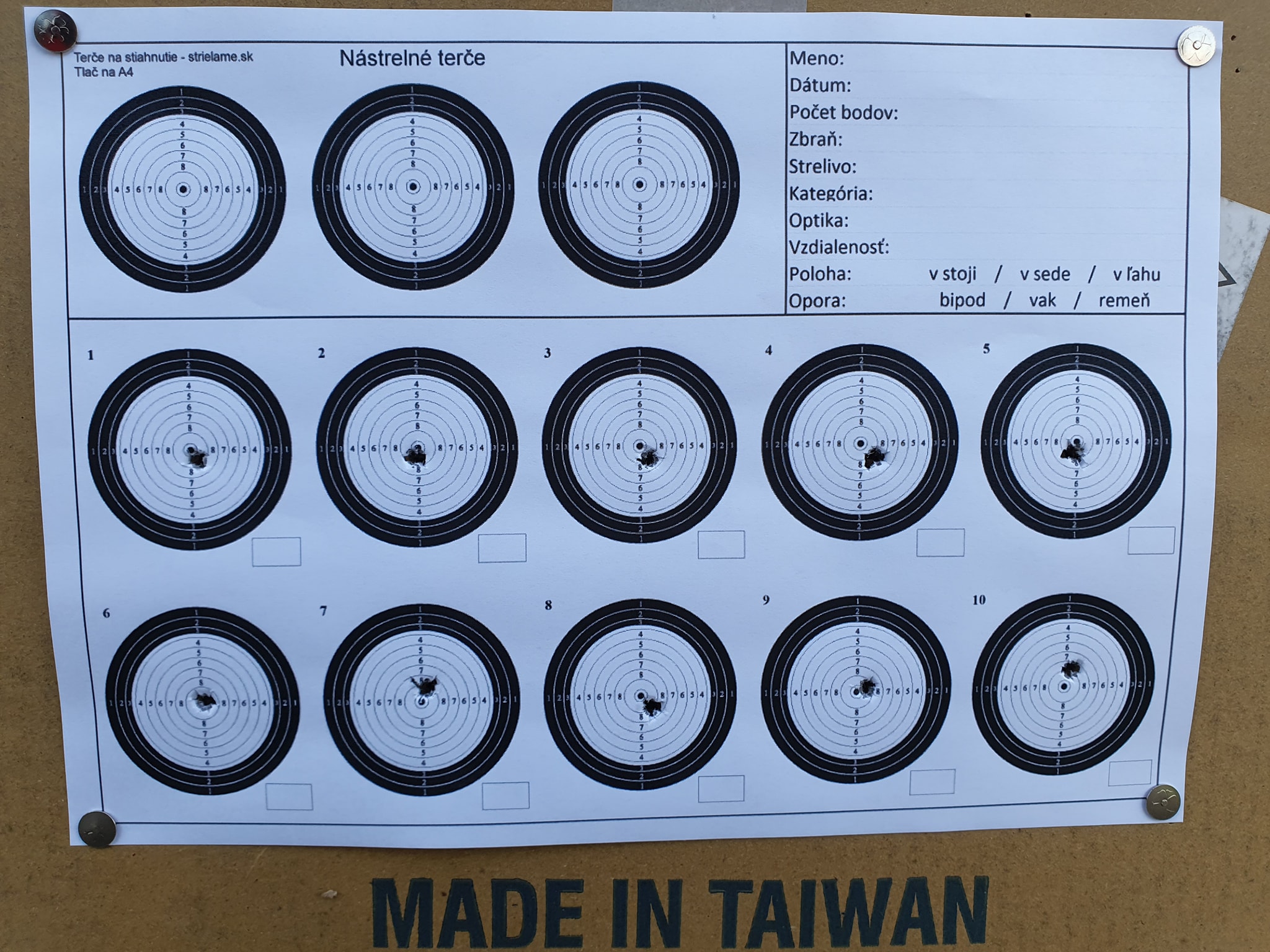

With the rifle fitted as you see in the upper post, Ive managed to participate in a rimfire competition (various targets @ 50 meters), ended up 5th (out of 25 shooters). Without a lot tested ammo, just off shelf center x. Lying on an old slippery quilt, I really needed a decent shooting mat. Eventually found one under christmas tree, GF takes care of me :D
Sadly, I have missed the final competition of 2021 year due to a friends wedding. Last time I was at the range was back in November, but that was just plinking with a friend. Rifle sleeps in the box since then. I sold the NXS for the same money I bought it. I need something with better glass, finer adjustments and better parallax correction.

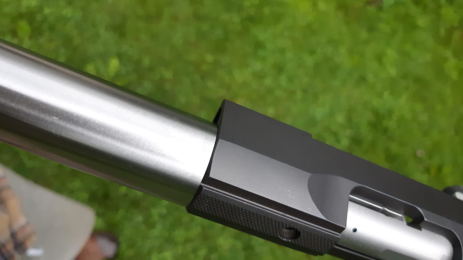

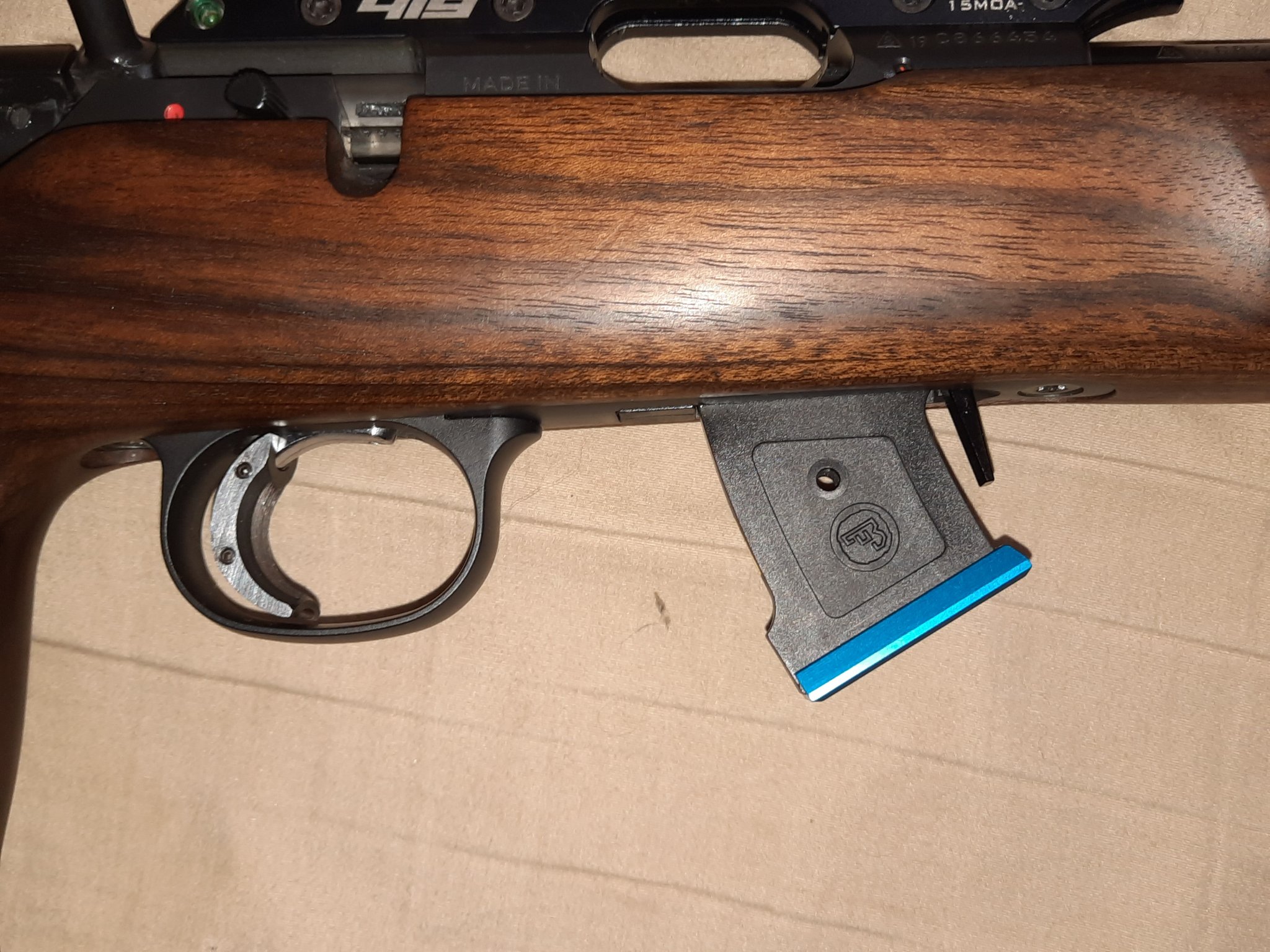

Can you explain precisely what you did In terms of modifying the switch barrek system? In retrospect was it worth it?
Reactions: Easa
I do not know if you are familiar with that switch barrel system, in the terms of actually disassembling it, so i will elaborate here.
The Quad has a retention plate that is pushed upwards by two springs on the left and right side of the receiver. That is the reason why you have to "break" the barrel upwards and then remove it when you are switching between calibers - it pushes the plate down and allows you to pull the barrel out. There is also that barrel screw near the magazine well that needs to be removed - that one is fixing the retention plate in locked position so your barrel holds in place. There is also a fixing pin that is pressed into the receiver from the top side that "countersunks" into the upper part of the barrel when its locked in place.
There are several negative aspects of this concept. First and foremost, one screw (that is not even in actual contact with the barrel, it only pushes a steel plate that has about 2-3 square centimeters of contact with the barrel) is not enough to properly fix the heavy barrel in its place - it would be, if there was no front to back headspace/breechface play when the barrel is locked in the receiver unscrewed. But there is (or was) a lot of play, almost wobble i would say, due to large manufacturing tolerances between the barrel, the receiver and the fixing pin. As a result 1) not only the POI can change every time the barrel is switched, but also upon impacts, shocks, bumps or any pressure applied to receiver or barrel - or just upon shooting, harder bolt throwing etc; 2) the headspace becomes a variable.
Therefore, the springs and retention plate were ditched, the pin was removed, breech and the whole part of new barrel that is inside the receiver was milled with almost zero tolerances and fitted into the receiver tightly from the breech to the "lip" at the end of the receiver. The barrel has a exact drillout for the pin from the upper side, so it has been pressed back in, and is additionaly fixed by a stronger screw directly from the bottom. It fits so tightly that the screw is almost unnecessary, only acts as a backup now.
Was it worth it? For me, absolutely yes. I never inteded to switch between different calibers, the rifle was meant to be a precise 22LR competition repeater from the beginning, so I dont mind that it lost the ability to do so in the process. Apart from that, nothing was irreversible changed to the receiver itself, so I still can revert every modification done and stick the original barrel if I would want to.
PS: As for the barrel, I do not know if every Quad out there has this problem, it might be just me and my lemon piece from the friday night shift, but i strongly recommend to all of you here running stock quads with stock barrels to just remove the barrel screw and check the wobble / play. You might end up surprised. As for the stock bedding, the Range stock is an absolute tragedy from the factory regarding this (words of my GS) and simply needs to be modified and bedded if the rifle is meant to shoot seriously.

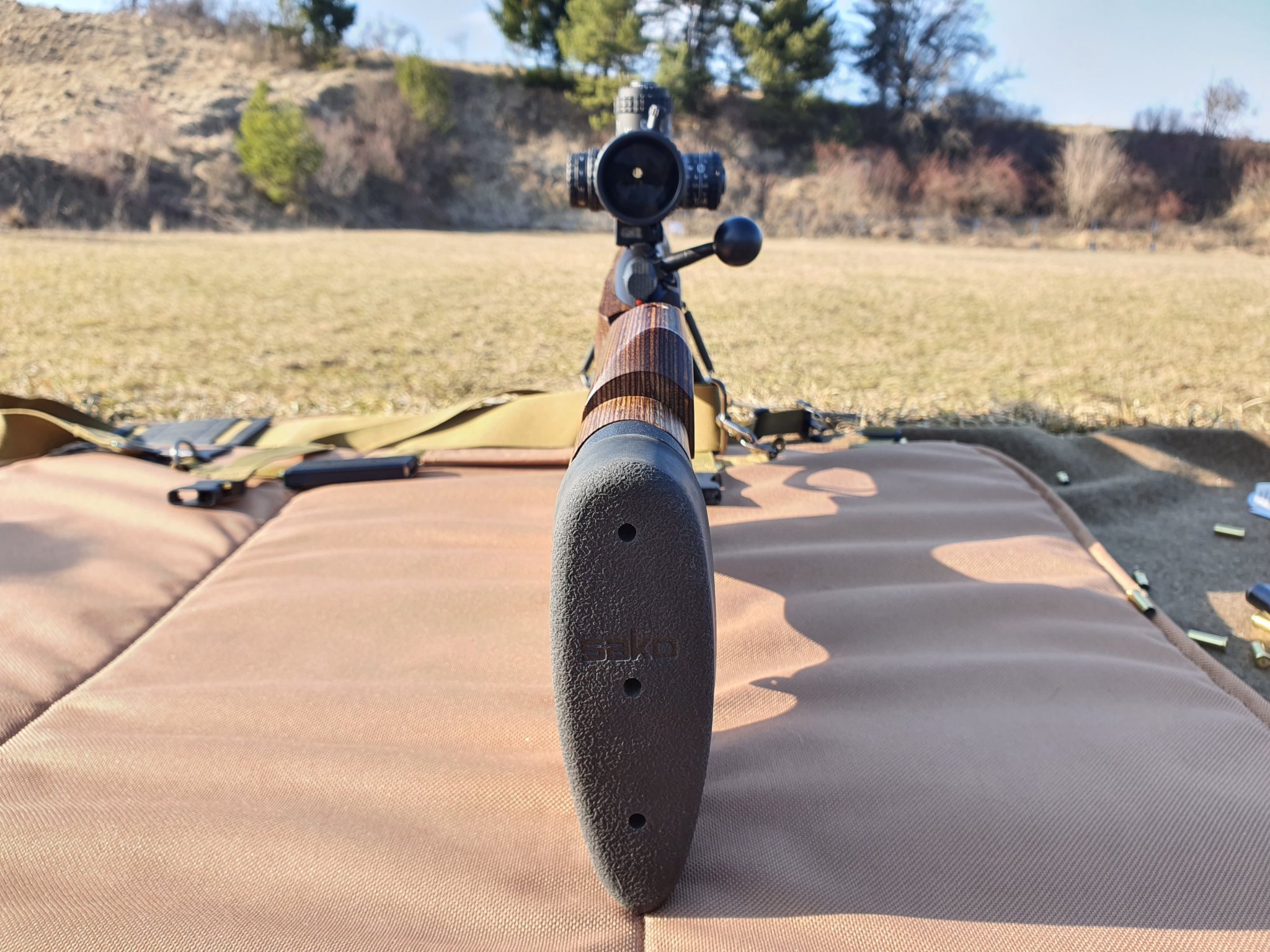

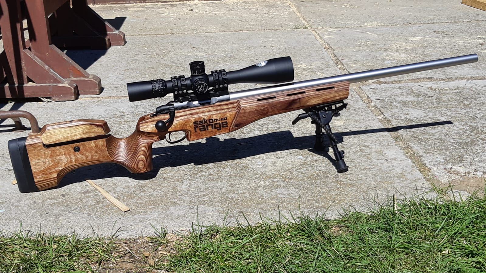

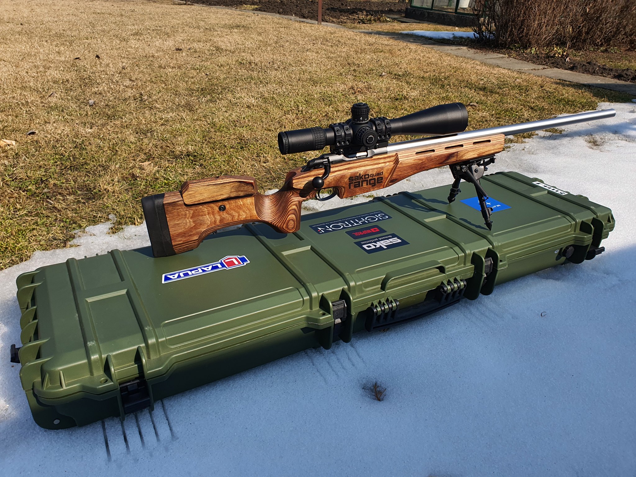

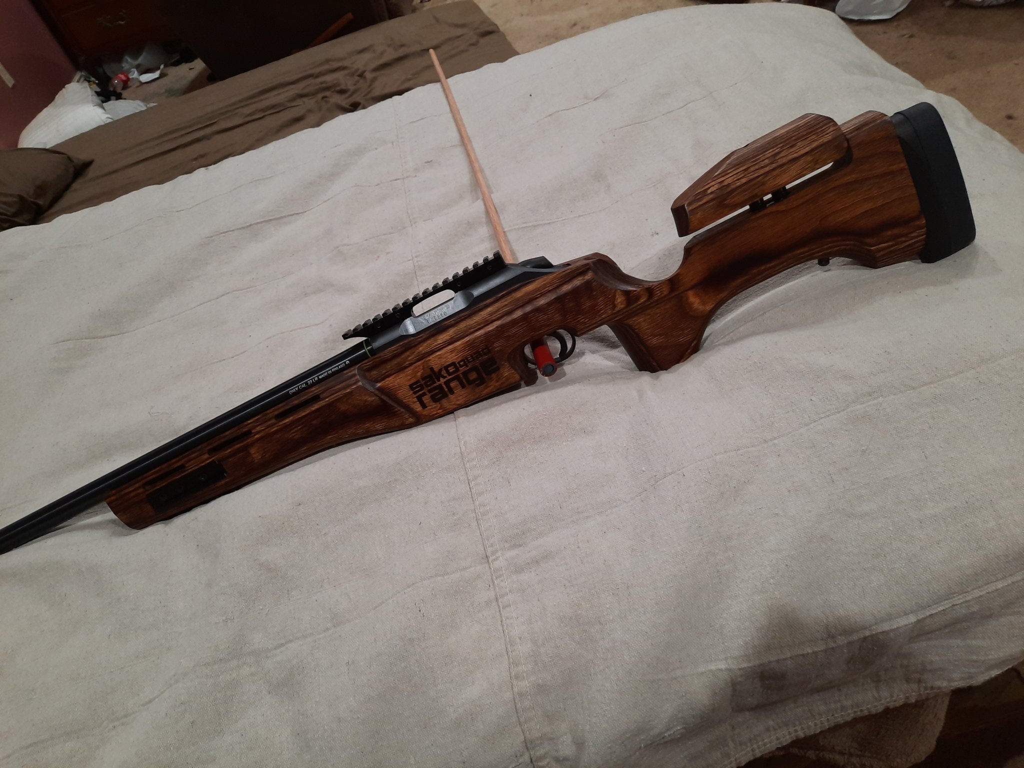

New glass fitted, spike feet on, 2022 Season ready!

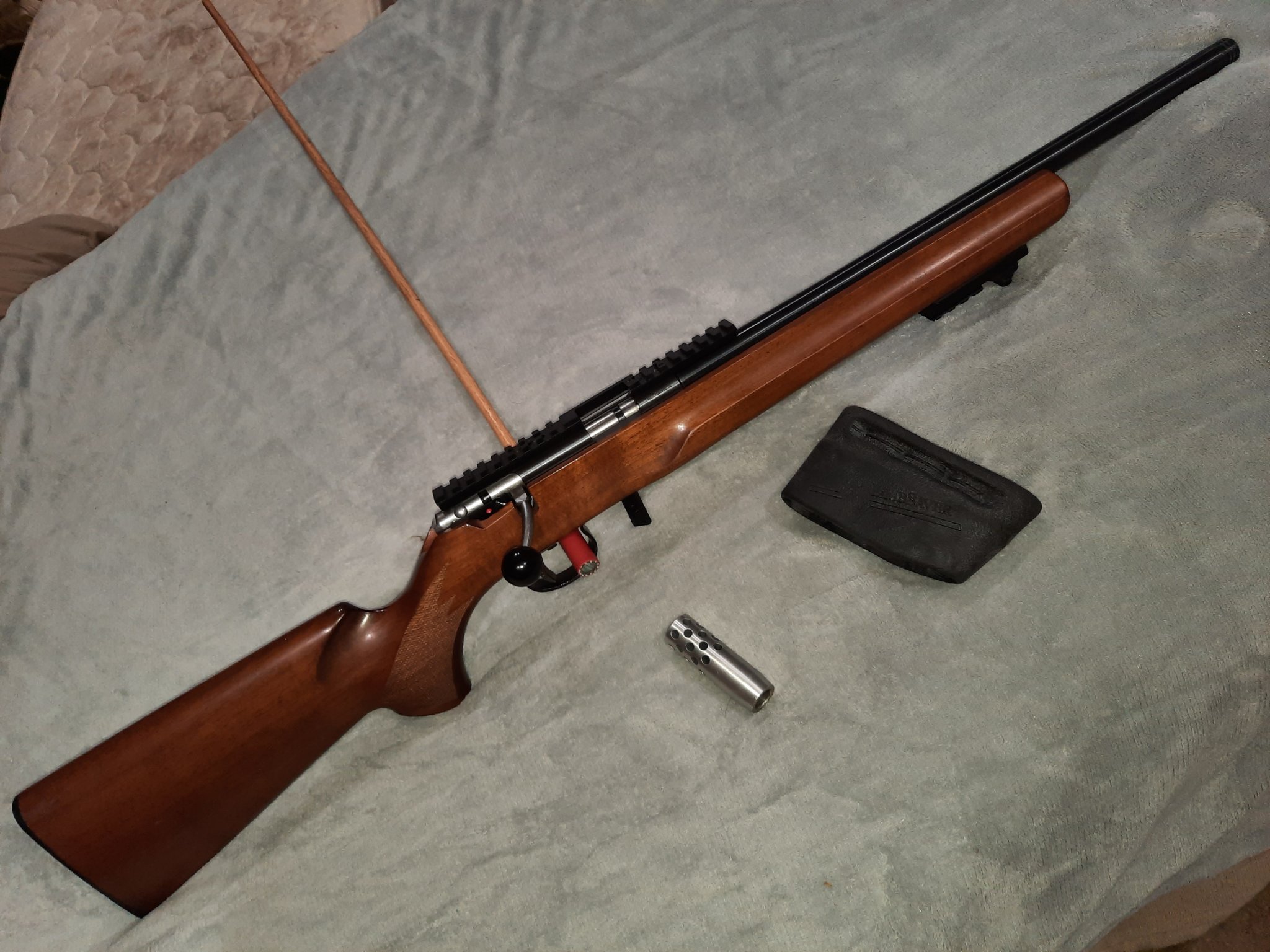

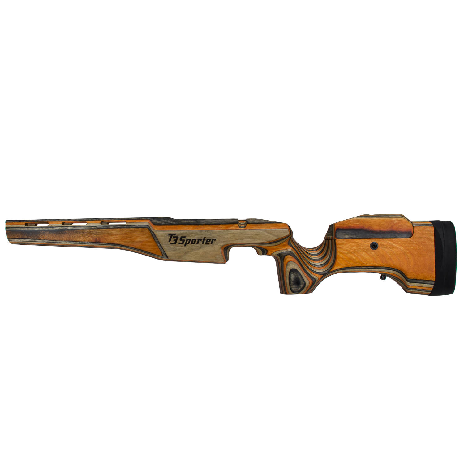

If any of you guy's happen to be left handed and like Tikka's, MGWs has these in stock.

I had found mgw awhile back and they only had the left , no more sako range stocks ,no more sako range imports , I had a guy a couple of hours from me that had a sako range but his schedule didn’t match the weekend we were supposed to finalize the sale and he sold to someone else a couple of days later

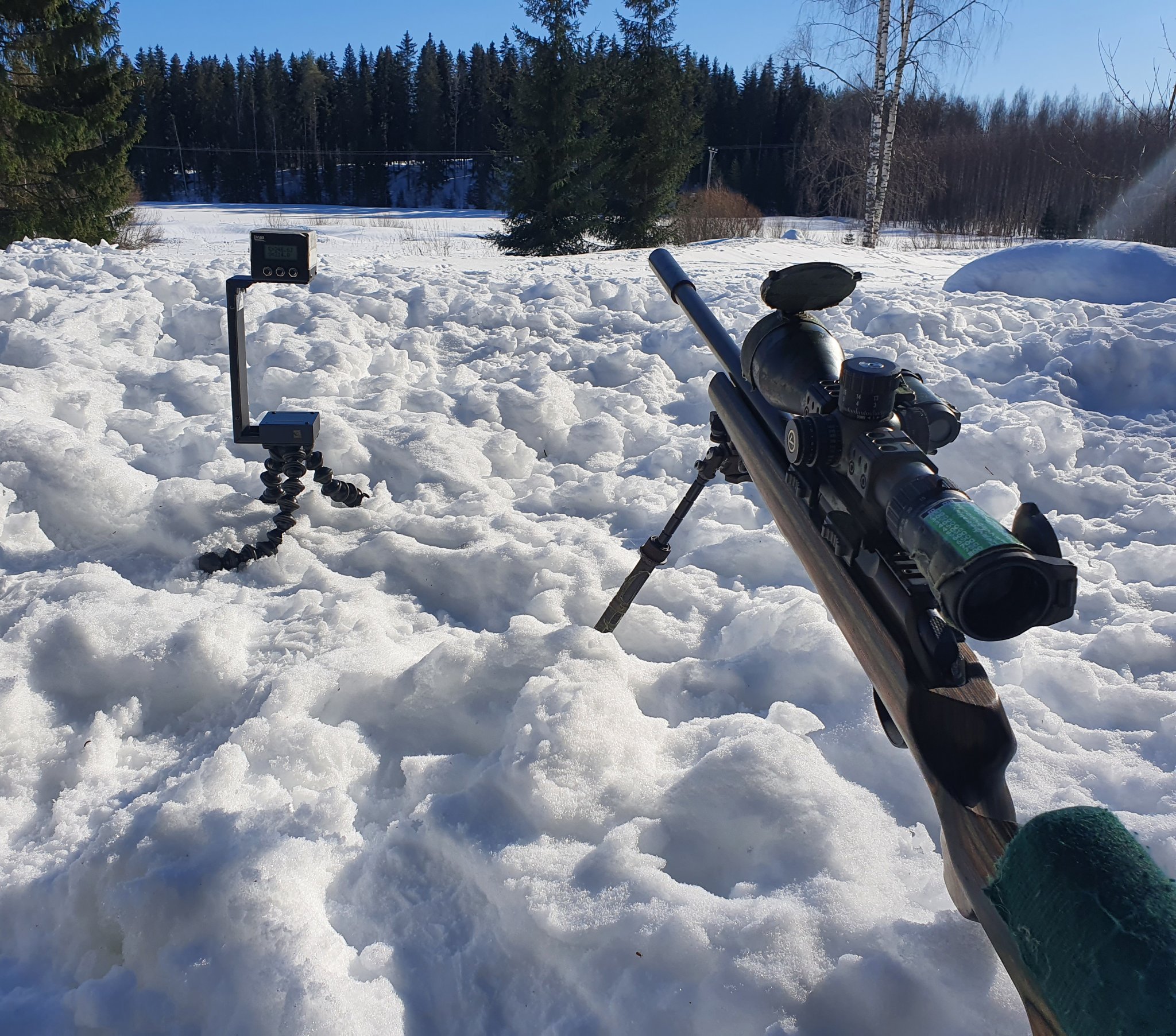

The season never stops :)
I recommend to add a washer under that spike with epoxy. It will help keep it from digging in by a lot!
What on earth do you wear when you lie down in that snow? :D Like, i do not mind being cold but being wet and cold, thats another story.
@Easa what glass is that? Looking good and ready to go
The glass is Delta Optical Stryker HD 5-50x56 HD SFP. Extremely fine reticle DLS-1 and turret adjustment 0.05 MRAD. 34mm Tube. I do not know if Delta scopes are sold in the US, but if not, Delta is an European, Polish based company, they do their designs here but the manufacturing is done in China (for the low end models) and Japan for their better models. This is de-facto their flagship scope. The cost is about 1750 to 1900 EUR, i had it for 1650, and for the price, it is probably the best bang for buck you can do. It has a very clear ED glass, optical quality is on par with some S&Bs that are almost twice the price (i had the chance to compare). We will see about the reliability, but they have a good track record here.

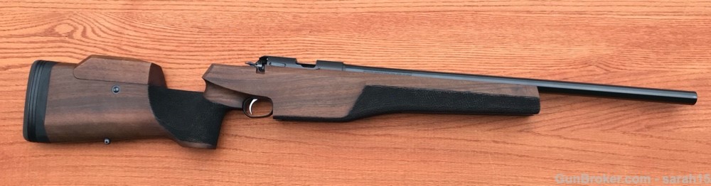

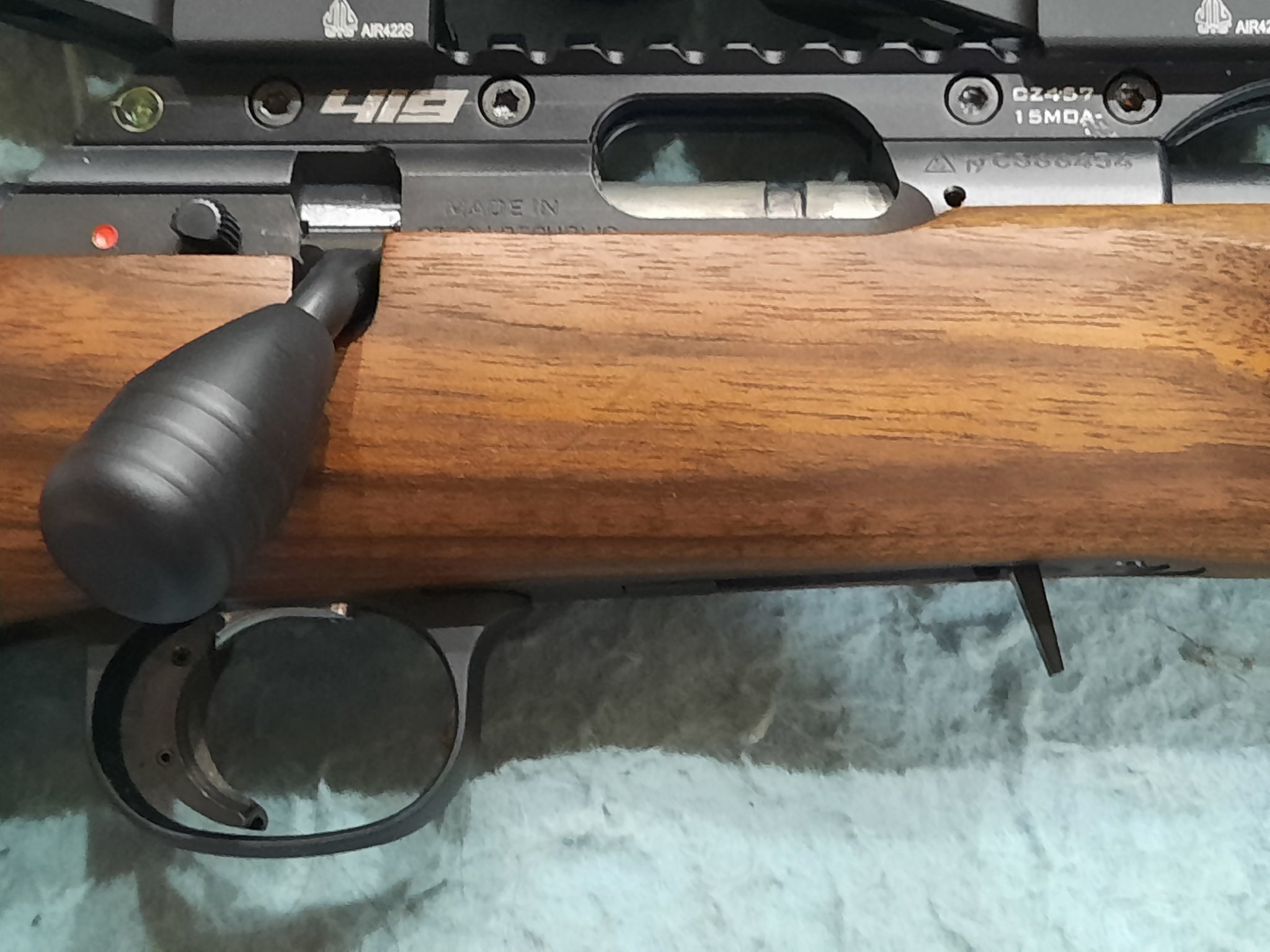

This is my SAKO that I recently sold. The mount is an AREA 419 that clamps onto the dove tail. The clamp design eliminates the
possibility of damaging the gun with set screws. You cant see it but It also had an ACE trigger shoe fitted. I believe it's trigger spring was
also replaced with a lighter one. Any parts removed were kept and transferred to her new owner.

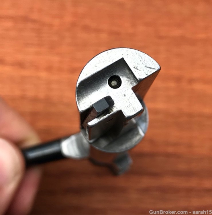

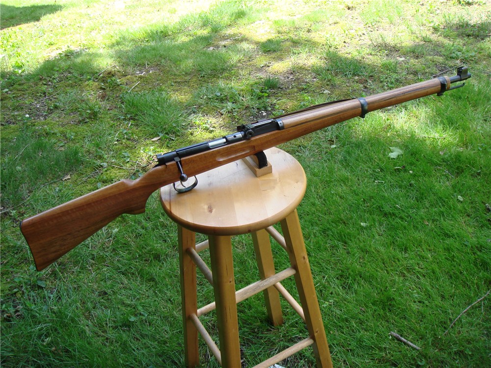

I was never able to snag a SAKO Finnfire P94S Range Sporter which I find to be a very handsome rifle. The P94S is a single extractor
finger bolt design. This one was on GB some time ago.

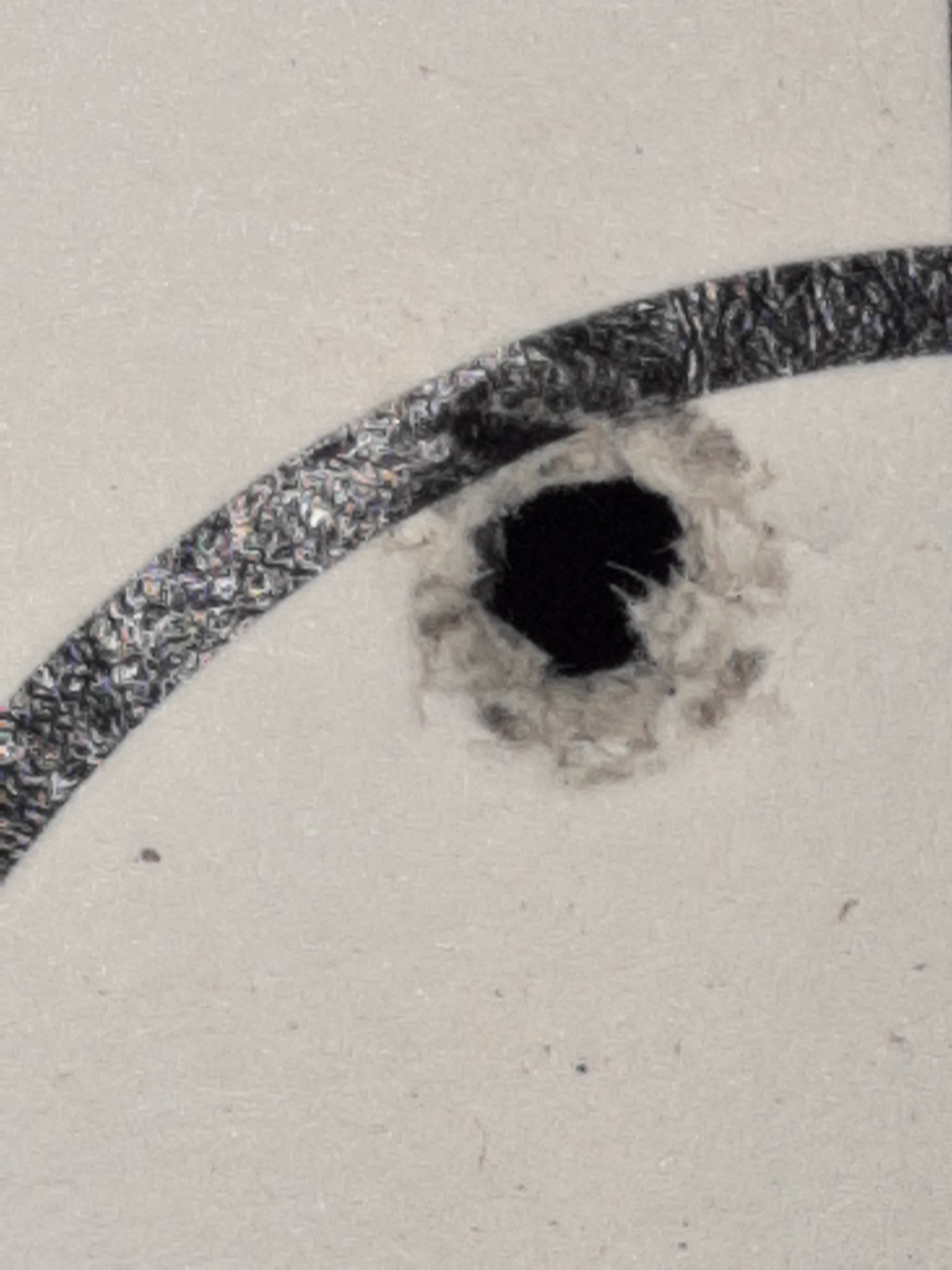

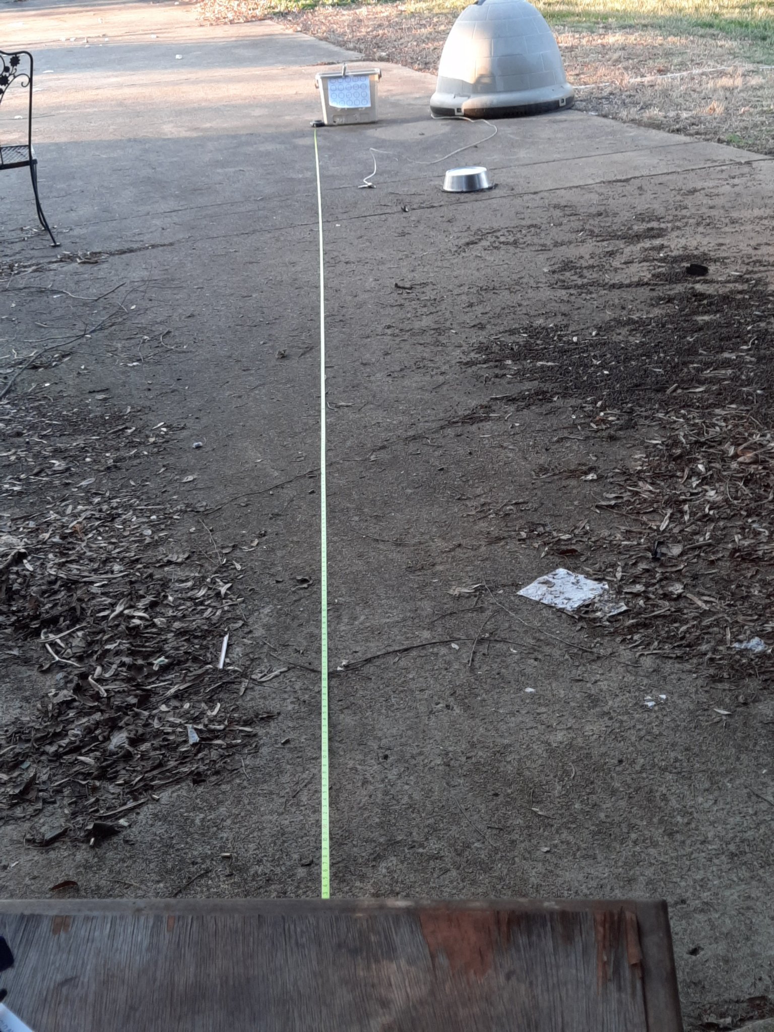

Anyone looking at a nicer scope like the Delta Optical Stryker HD 5-50x56 HD SFP may want to look at the Trijicon Ten Mile
5 x 50 x 56. They have some very nice creature comforts like the tool less zero set. It's has zero stop for windage and elevation.
They focus clearly at 9 yards even while at 50 power. The phto is from my phone camera but the scope has the same resolution
at 9 yards. You can see the card stock texture and tiny hairs from the torn paper pulp.
I have never regretted buying nicer high end equipment.... Any financial sting is soon forgotten.
I bought the first one from B&H Photo primarily because they offer a 30 day, on your gun test drive policy.
It was so nice that I bought the second one 30 to 60 days later.

Easa, that appears to be a very nice bedding job! Is that bedding reversible?

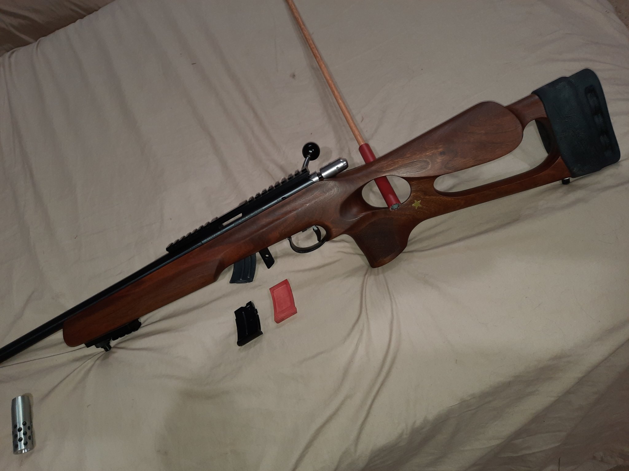

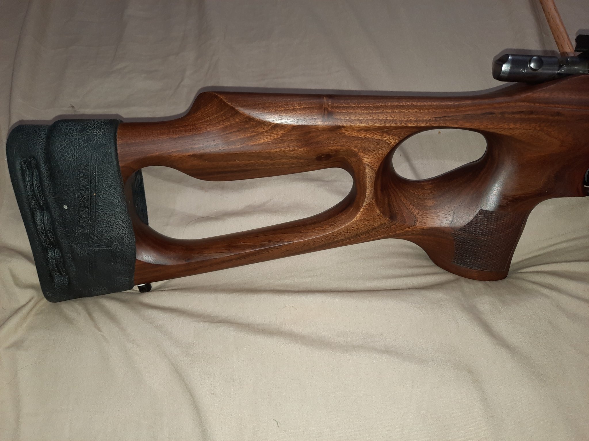

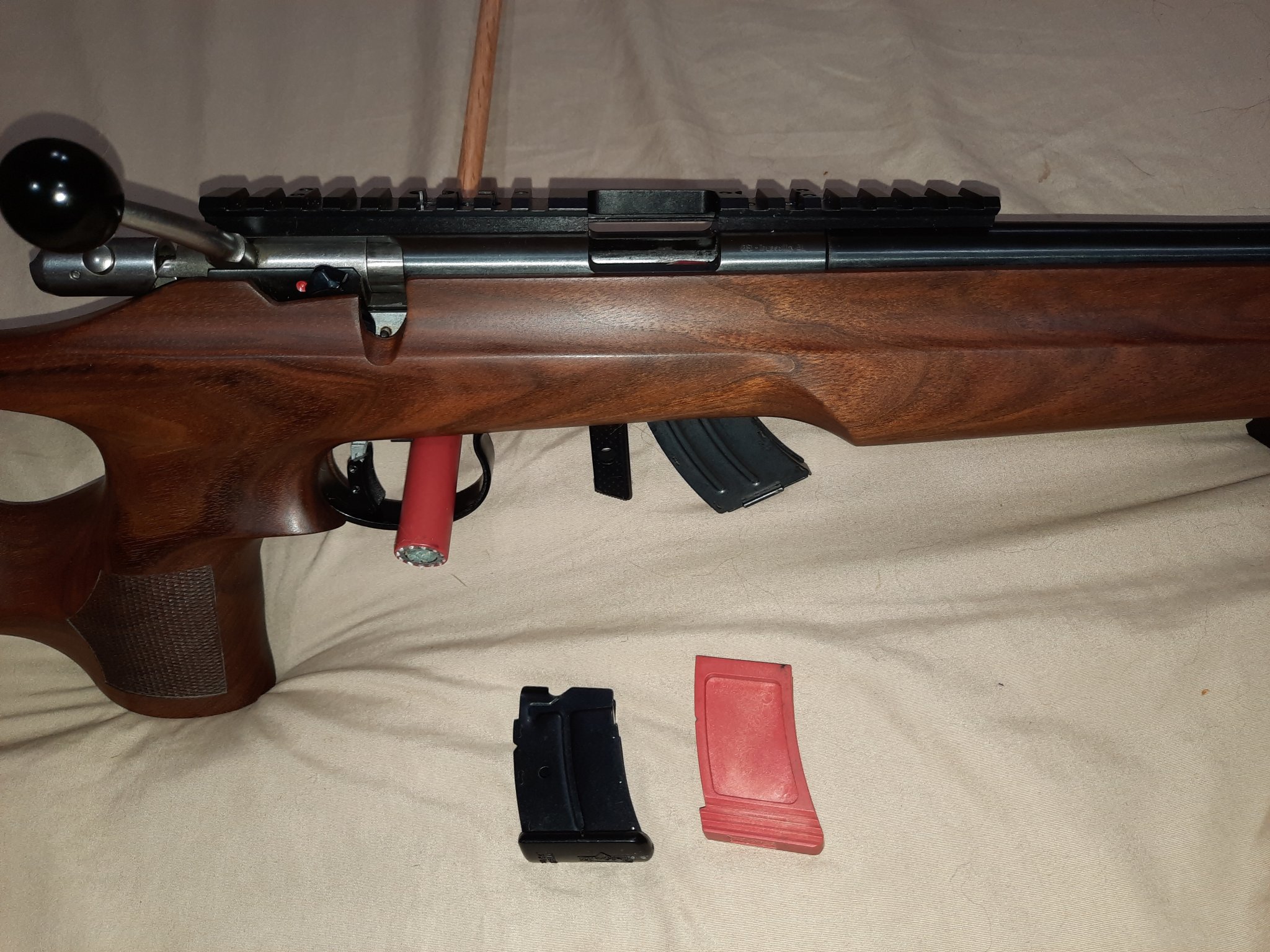

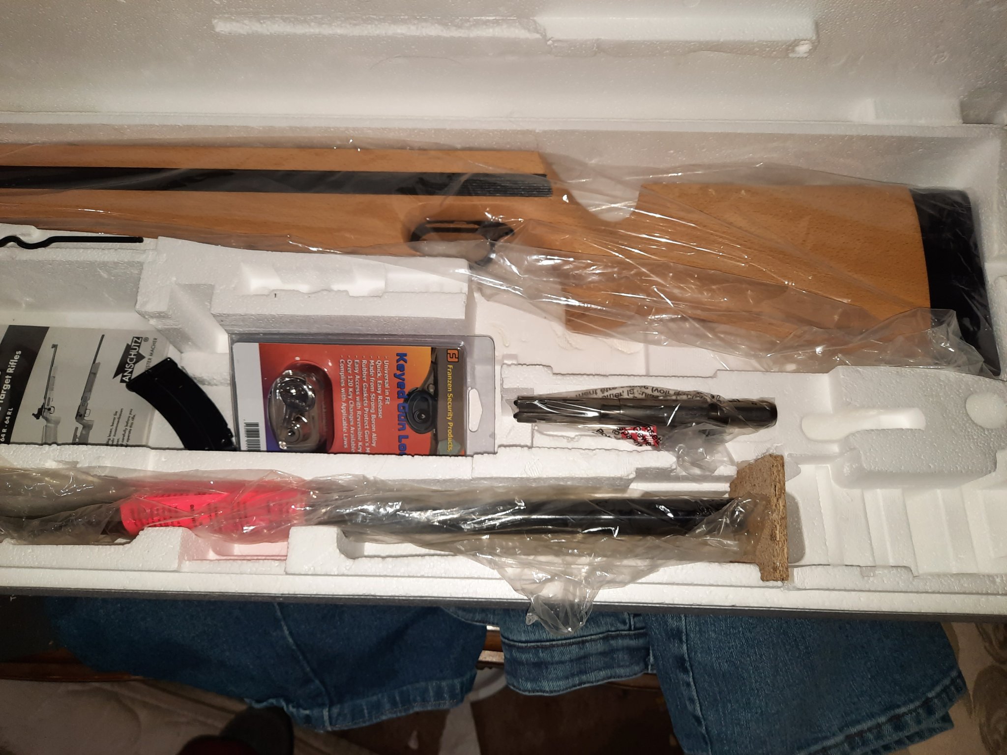

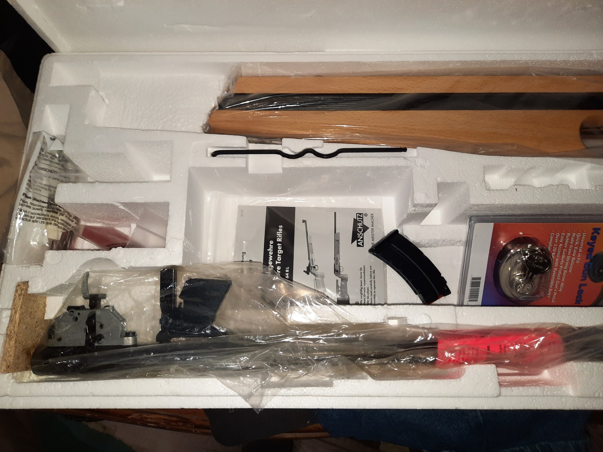

The Anschutz is NIB and is labeled 64R. It is virtually Identical to my 1903 single shot except it is set up in
a repeater configuration. She came factory drilled and tapped with filler screws ready to mount.
Here is a different photo showing the trigger, mag well and the factory installed extended magazine release.
I was surprised when I found the 1416 thumb hole and the beaver tail were not factory tapped.
The extended magazine release is a $75.00 option but I have them on all of my other Annie's because they are
so darn pleasant to use. I retain the factory release for the next caretaker.
The scope rails are a screw down DIP type. Bob made them custom for me, they are longer out the front and the rear.
It is now a standard product. I believe it is called the Scout. The ACE trigger shoe is just the icing on the cake of an
already fine trigger. I had the brakes made custom as well. They are .75" at the barrel and have an .860" OD.
I use an ugly Limb Saver on the butt to keep it from slipping around. The factory butt plate is a fairly smooth plastic.

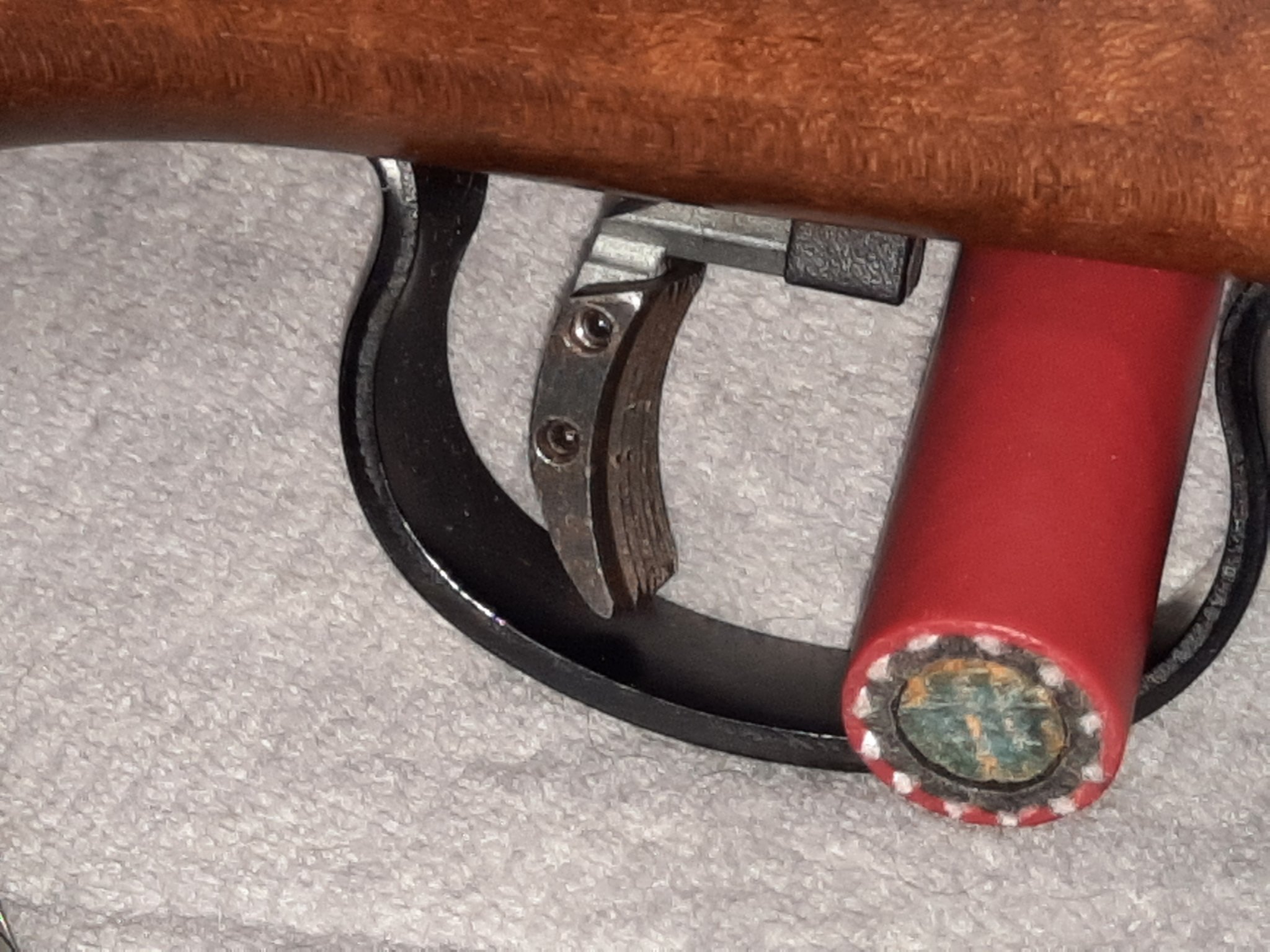

It's difficult to see but the Anschutz trigger shoe shown in post #133 has a crown and serrations. It feels very nice.
I also use the ACE trigger shoe #21 on my CZ457s. A #22 works but is a snug fit. An Anarchy Outdoors aluminum extended
magazine release makes mag withdrawal virtually seamless . A pinching motion between your thumb and index finger
and out the magazine is out.
No more digging for the stubby factory or DIP release that is only 2mm longer.

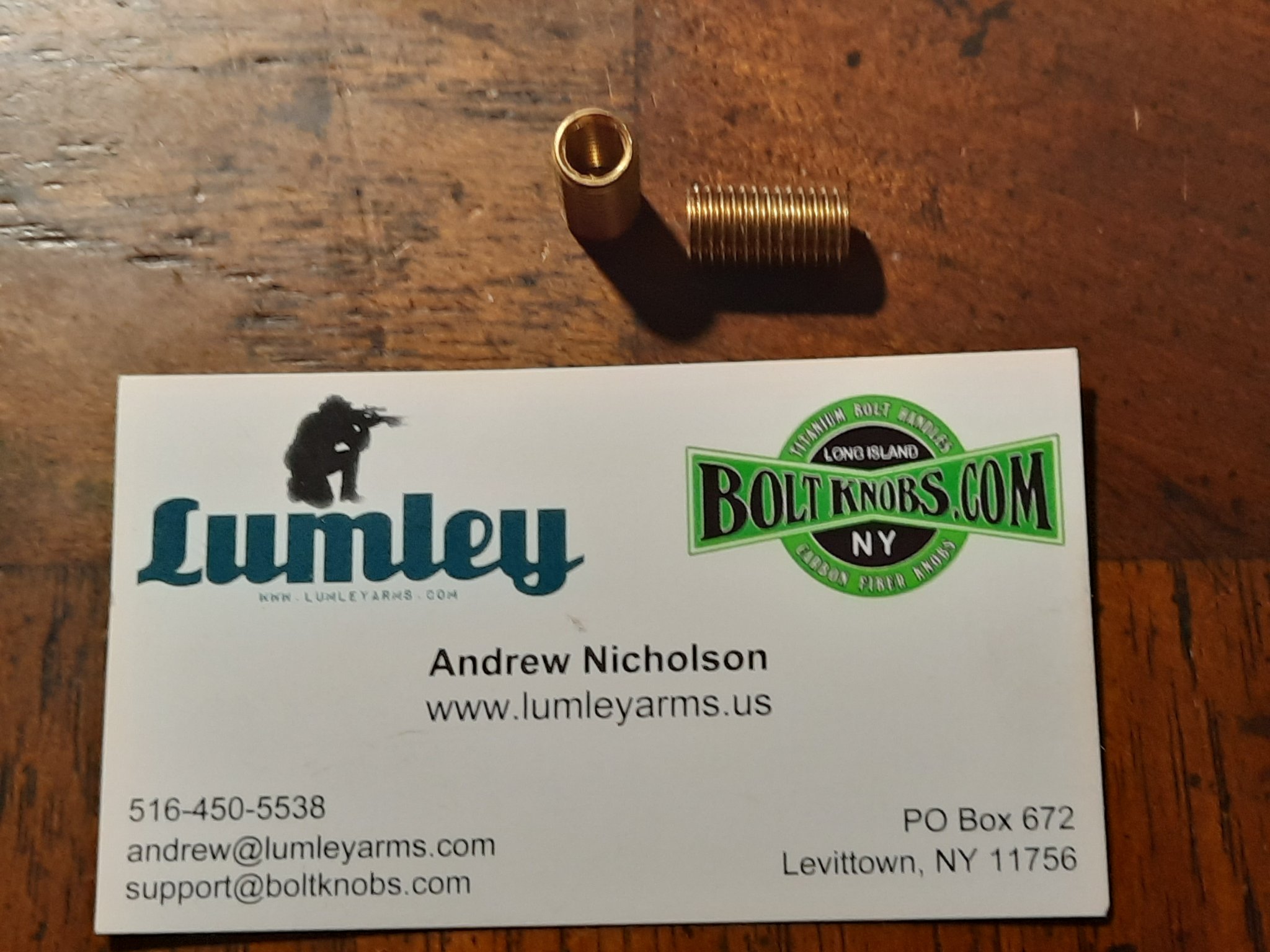

I liked the AREA 419 bolt knob but the Vudoo knob was slightly longer and has a nicer feel.
I don't recall if the Vudoo needed a 5/16ths -24 to M6 thread converter.... here it is in any case.

If the lilja is expensive to get where you are it might be cheaper to get a KS arms blank from Canada. They shoot excellent. Have a new rimfire blank going to be chambered up once action arrive

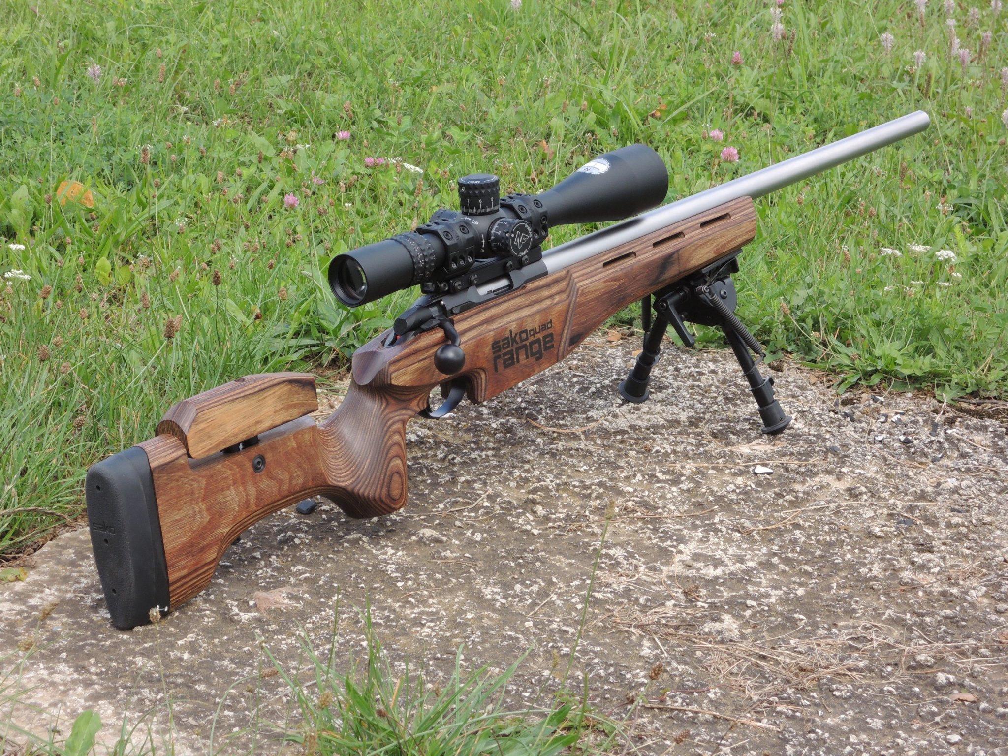

It is a solved thing for a long time now, we used a Lothar Walther Match grade blank. Also, there is now option to use Bix n Andy barrel blanks which should be on par with Krieger etc, but I am happy with mine.
Oh I would definitely grab a P94S Range if I had the opportunity, but to my knowledge they were never sold in my country. I keep looking out for them on AT and DE used gun sites though. This week I almost ended up with a unicorn that has probably never made it to the States, an Anschutz 1907 Rep., yes, a repeater based on 1907 action with 10 shot magazine and a very sweet blue laminate stock. They were done in an extremely limited production run. Unfortunately, I was late and the seller sold it before I had the chance.
Bedding is not reversible, pillars are now the part of the stock and so is the epoxy. Could be milled out, but why would anybody do that right.

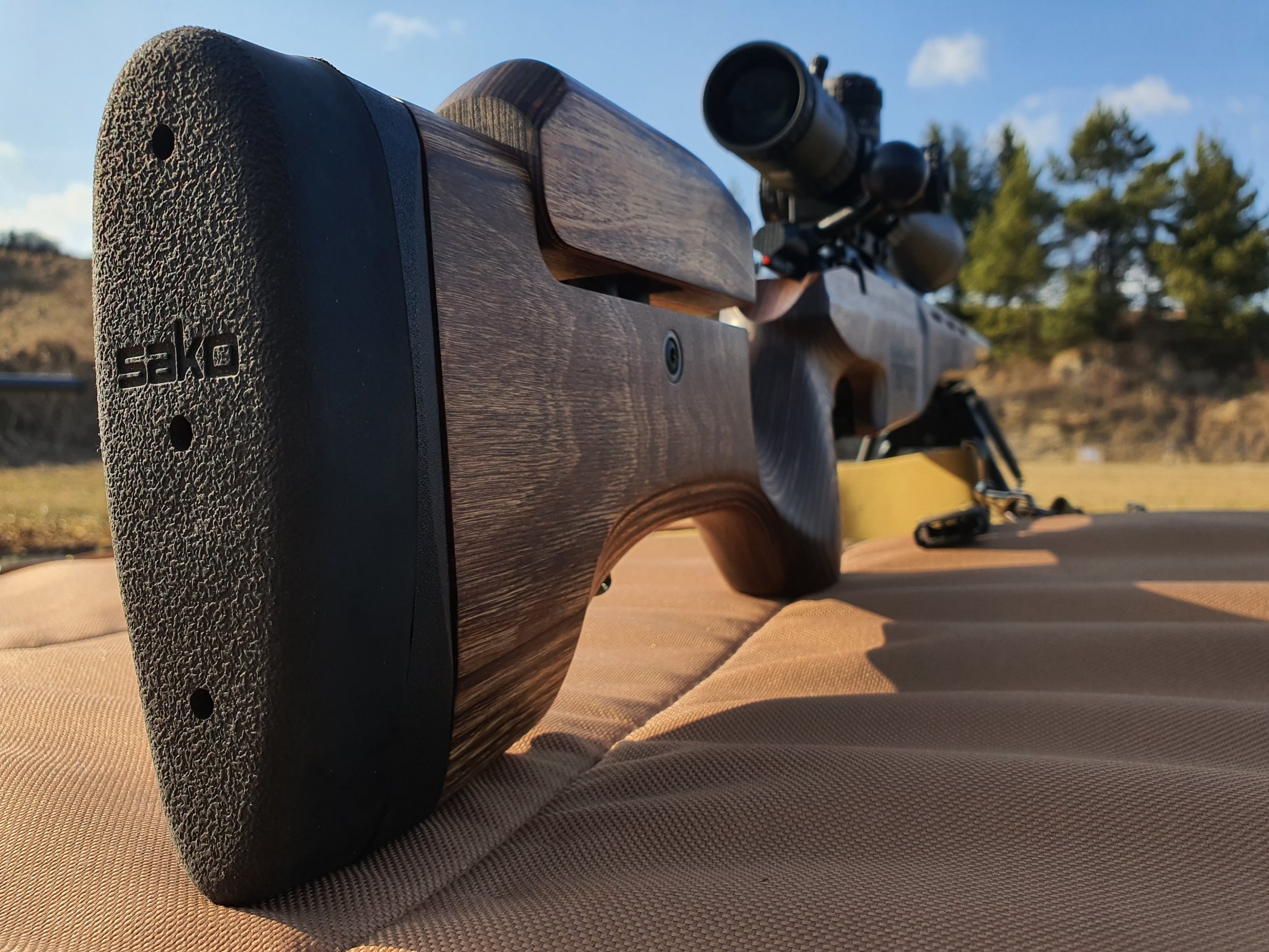

Little update, took the rifle out for the classic 50m biathlon range where i shoot mostly. Weather was great, warm and sunny but boy what a windy day. Wind kept changing every few seconds so the groups were nothing to brag about, apart for one 10 shot group that was all fitted in a hole with 10mm diameter. I used SK Rifle Match ammo, as the brass and bullets are same to Lapua. No rear rest, only bipod with spikes. OOOH BUT THOSE SPIKES, what a game changer they are! No more movement upon bipod loading! Praise the spikes, totally recommend if you shoot on anything other than concrete.
> New scope has a little bit different eyebox, i found out that I need to be about 1-2 centimeters back on the stock, so i ordered the butt spacers for TRG / TAC A1, it is the same part.
> Also found out that I only use about 1/3 surface of the buttstock in my arm, completely forgot that it can also be moved vertically, after adjustment it is noticeably better fitting into my prone stance.
> Ordered one more 10 round magazine just for the peace of mind.

Order a firing pin, an extractor assembly and probably even magwell to have some spare parts as I do not know how long they will be available.

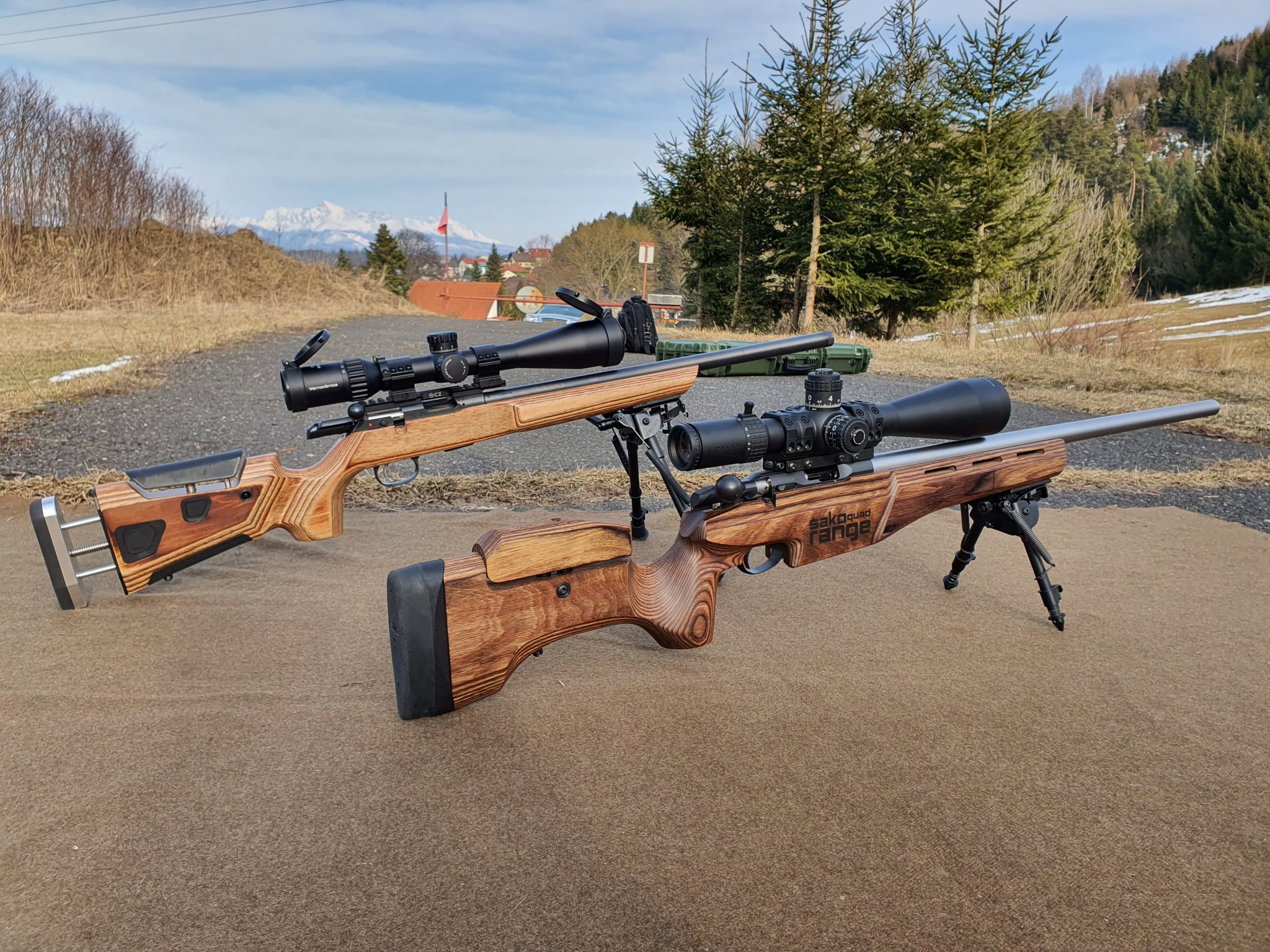

Last thing, some photo spam as always. My shooting buddy all new 457 AT-ONE and "Krivan" (which can be roughly translated to Crooked) , a mountain that is sort of our national symbol in background. Elevation 2 495m :)
Seeing this thread get resurrected got me thinking about taking my FinnFire Range and Quad Range out.
I need to get a Sterk bolt handle asap and also can't seem to find a DIP rail.
In the past, I used the 11mm to Weaver adaptors from J&P, but they're so tall that even with lower rings, the scope just seems way too high...
If all goes according to plan, I'll be shooting my Quad later today and most likely in a modified silhouette match tomorrow.

Just get an AI dovetail mount, knock the roll pin out and mount it up. Like this:
Reactions: Rolltide
I've used AI Dovetail mounts on my Sakos (Finnfire and Quads) and Anshutz 22rf. They run like a champ and there are several MOA cants (0,18,28,45MOA) and scope ring sizes (30mm,34mm) available. You can usually find them here on the hide for a very reasonable price.

Competition report again. Finished #3rd out of 17 shooters with one noticeably weaker round and three errors that were purely my fault. Lack of sleep took its toll. The better shooters that I have managed to beat back in the first competition were not present, otherwise I would probably end up a bit lower in the chart.
Next there will be a special two day competition event in the couple of weeks and two more in July. BixnAndy trigger is still tempting me.

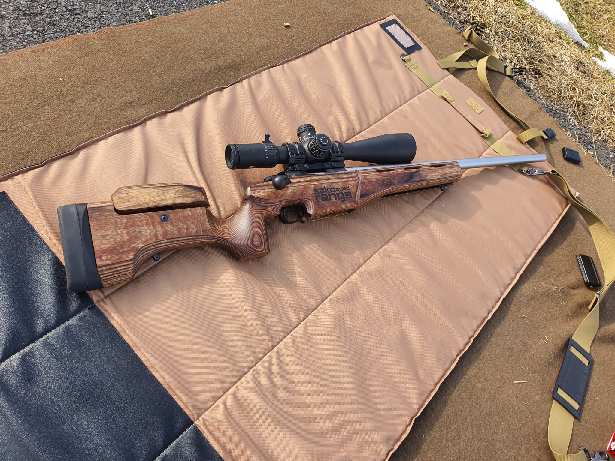

Yesterday visit at the range. This was shot prone with bipod, no rear bag or support other than my arm. No windage flags, wind mild to none. Distance 50 meters / 55 yards. Paper size is A3. Scope set at 18x. Sighters were shot with SK Standard Plus, Competition targets with Lapua X-ACT. Apart from the #12 and #13 i am quite OK with the result. What is your opinion? Is it bad or not?
I have noticed that the rifle itself is actually quite laser precise and is 100% able to stay within the inner circle (like #6, #9, #11,#25) when i shot other targets with rear support, the problem with vertical dispersion lies in my breathing. When sightining in, I see how my breath and heartbeat moves the scope on the target. Then, I do not breathe consistently and tend to hold breath for longer that I should. Also, I have noticed that my trigger pull has a noticeable impact on accuracy. When I pull the trigger with just the tip of my finger, and I really mean the last few milimeters of finger, I have noticeably better groups horizontally. As for the former, that could hopefully be improved with training my breath and some physical exercises, but what about the other part? Is there anything that I can do, or I am doomed to buy the BixnAndy? :D
Two other things:
=> I do not have the lever to lock my Harris bipod and prevent it from tilting, so there is another movement that I need to adjust after every reload. Do you have a tip on which lever to purchase? Something that is not made out of cheapest plastic.
=> Thought about adding some kind of padded leather "pillow" on rear end, bottom side of the stock, to flatten out the stock shape and get something simiar to CZ457 MPR stock. Thoughts about that?
This was a training for the two day competition that I have mentioned, there will be three stages with two of them having paper targets like these at 50 meters, third one will be shot at silouettes and gongs @ 100 meters. This saturday I am finally visiting a 100 meter range to train for it and sight in the rifle.

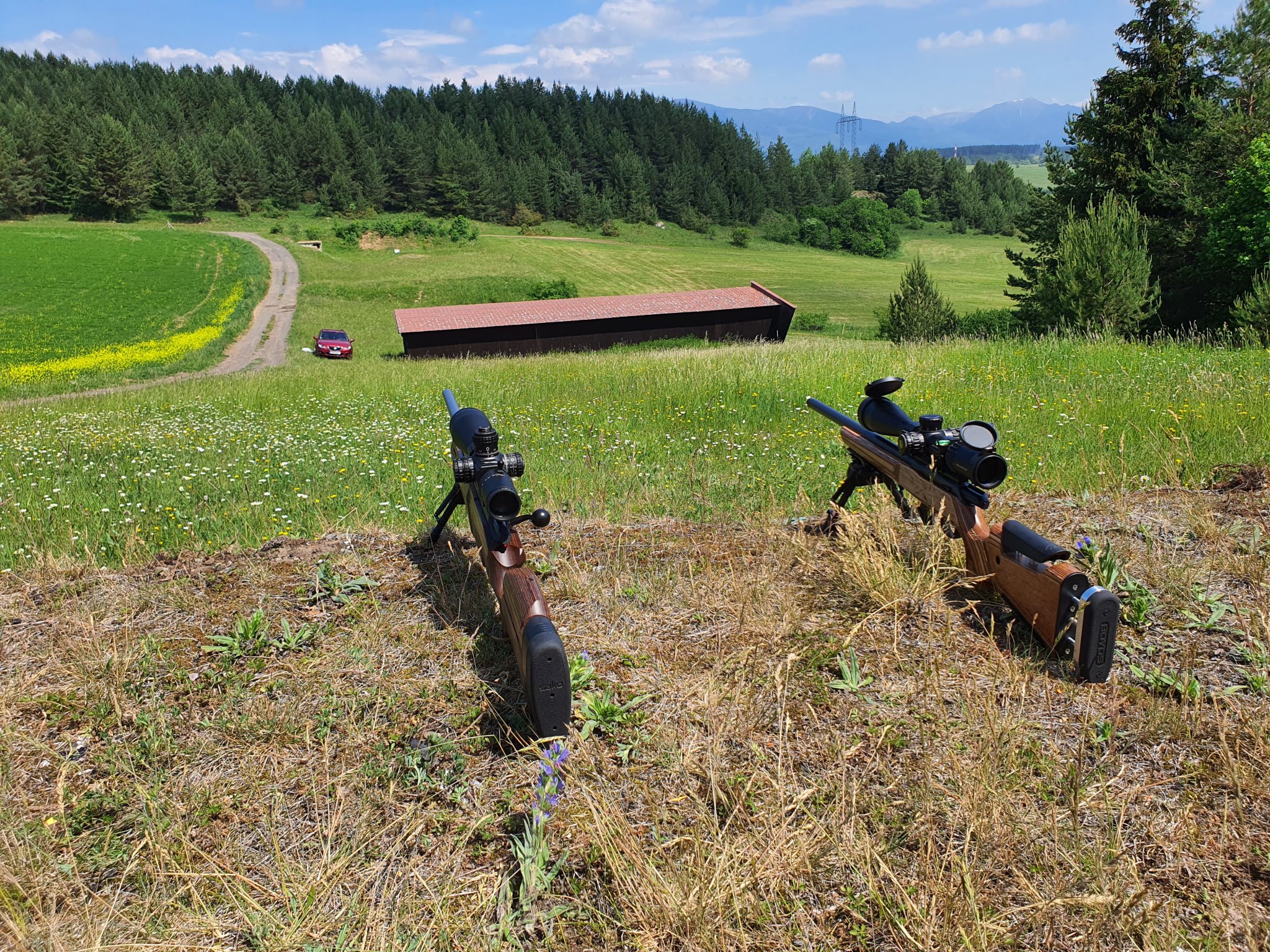

Some fun from the saturday range visit. We took rifles all the way back to skeet & trap stage, from here it is 150m / 165yd to the end of range. Target was a 2" steel plate. Quite windy day. Fired 30 shots, 27 were successful.
