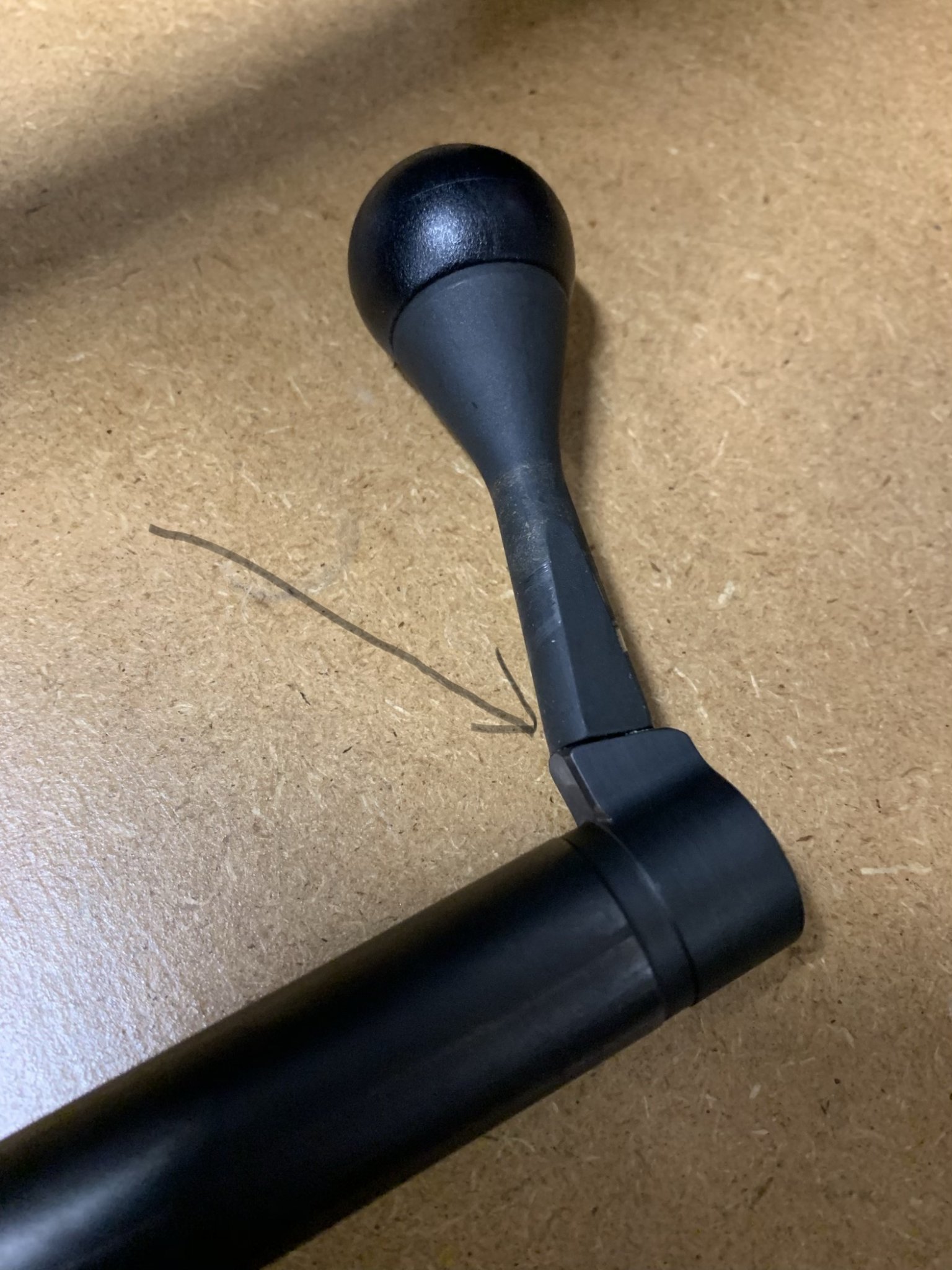

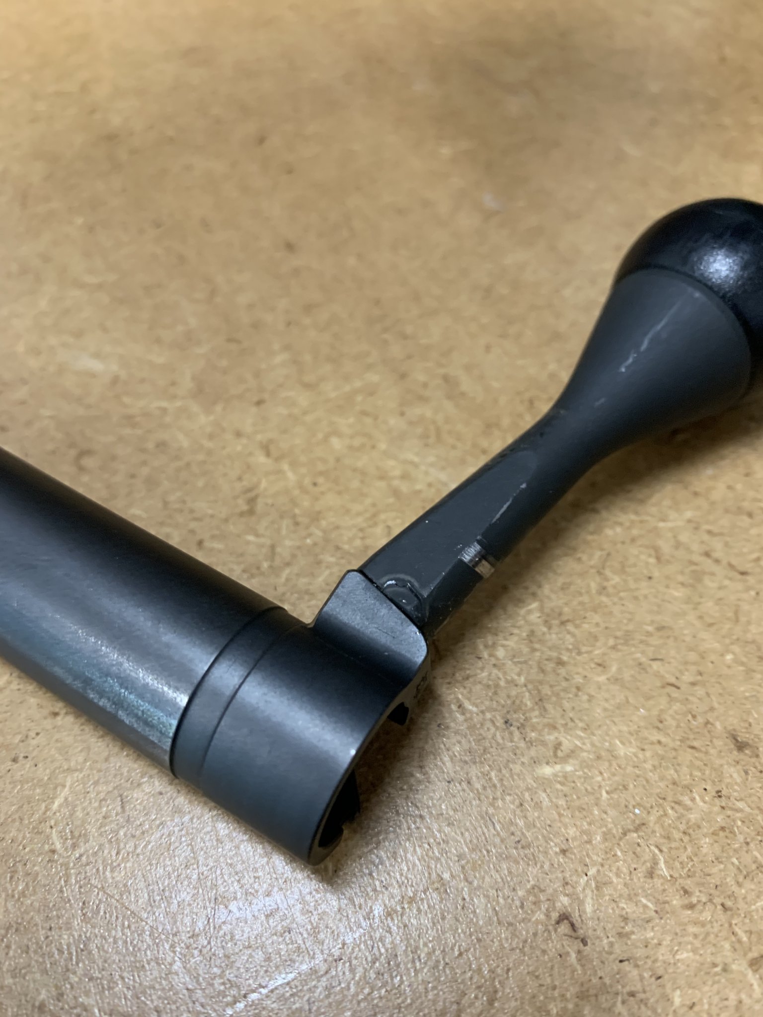

Gunsmithing Sako TRG 42 & 22 bolt handle attachment method
Re: Sako TRG 42 handle thread size
Keith, I have played around with these and I'm not sure they are threaded on.
If my memory serves me correctly the knob is held on there by a machine screw or a set screw. I think the only way to do a conversion on them is to drill and insert a stud, then build off of there.
I dont know if this is a road I would go down! Good luck!
Mark
The reason I ask is Im making one for a customer. He told me the handle has threads. I figured a google search would turn up an answer but I couldnt find one. Cant seem to be able to contact a Sako dealer that knows either.
Not planning on offering them. I just want to get a knob made for him. Maybe his was threaded by someone. Ive never had a TRG to look at in person.
I dont doubt at all what you say is true... can any one confirm this?
If thats true I'll either have him send me the bolt and I can measure the threads or maybe he can take it to ACE hardware and figure it out(they have a thread plate for matching threads)
Thanks Mark. Your Howa installs look sweet.
They have a long set screw that goes down in the plastic knob and the steel handle. I'm not sure if the plastic knob is threaded or not. I couldn't get mine off w/o fear of breakage.
Odd design, it would be very easy to just turn a one piece knob AND handle, the handle just threads into the bolt. The handle is also totally straight w/ no bend.
A friend and I would be interested in a couple if you want to make some.
The handle is threaded into the bolt body, unfortunately I'm not for sure on dimensions.
It seems the knob is threaded into the handle and a set screw interfaces between the 2 parts.
Here is my field repair of my TRG22 that broke. I replaced the set screw with a cap head bolt countersunk a bit.
IMO it would be better to make a part that is one piece, handle + bolt knob. It confuses me on how this would be a good design. Only option I can think of is if there was a factory knob choice.
Thank you. Perfect pics!
I think I'll turn a new handle, and make a better knob attachment point than what Sako did(in my opinion). Then I'll attach my knob to that.
If the customer wants that done.
Thanks again for the pics. I've never gotten to see a TRG handle.
Im going to change the thread title so its useful in people searches.
Please also note that the the pics are a TRG-22 handle, not a 42.
Maybe someone with a 42 can chime in if they are the same??
When I get to my owner's manual, I will see if part # is the same.
Actually after thinking about it, it would probably be best to design a knob that would replace the factory knob without altering the bolt, you could cnc them and sell them as an upgrade, I would imagine they would sell better that way rather than modifying the bolt as these are guns that are worth quite a bit of money and making permanent changes usually detracts from the value.
Threads will be something metric like everything else on the Sako. Regular owners manual does not tell you what threads any of them are.
Have your customer go to a decent hardware store with the bolt and try threading on a few metric nuts to it is probably the easiest way to tell. When one that fits is found, try a few more of that same size to make sure nobody put the wrong size nut back into that bin (just because I am paranoid).
Just keep in mind the polymer (plastic) knob LOOKS LIKE it had threads on it. Those threads screw into the handle. Then the set screw is though the center of the plastic into the handle.
Mine broke off where those threads would screw into the handle.
If you were to make a knob that was the same, the knob itself would have threads on it (male), then the hole through it would be threaded also (female), for the set screw.
I would not attempt to make one unless I had a unbroken dis-assembly in hand.
I'm sure anyone that has worked on a TRG knows how much thread locker is applied. It might be a pain for most to spin the handle off the bolt.
If I had the handle I would take some more pics, sent for repair though.

First post here, reviving an old thread. Jumped right into the deep end of the precision rifle game with my first bolt rifle, a Sako TRG 22 in 6.5 CM. Out of the box the bolt handle is loose (at point marked with arrow in photo) and for the life of me I can’t figure out how to tighten it or remove it from the bolt. No assembly diagrams that I’ve found. There is a small retaining screw on the end of the knob but I believe that is just to hold the knob in place. I cranked on the base of the handle pretty good with a wrench but nothing budged.
Called Beretta, they said please mail us the entire firearm. Seriously? Hoping to hear that there is a quick fix for this.
Thanks all -David
The bolt handle is loose, but you cannot tighten it or remove it? So is it really loose and moving, or is there just a gap than is unsightly to you?
It should be threaded on, with some loctite on the threads. If it is stuck in the current position, I would wrap the rest of the bolt handle with a wet cloth towl, and the bolt also. Then gently take a torch to heat up the handle close to where it threads into the bolt body.
Reactions: specopsbrooklyn
Thanks for the reply. Yeah it’s loose. Wobbles maybe 5-10 degrees in each direction.
I tried unscrewing the bolt handle with heat and it didn’t go so well. The base of the handle cracked and I managed to mar some of the bluing in the process. Guess it’s going back to Beretta after all.
